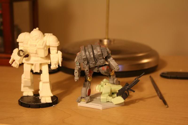

Here's proof, made this guy myself out of Smoothcast 310.

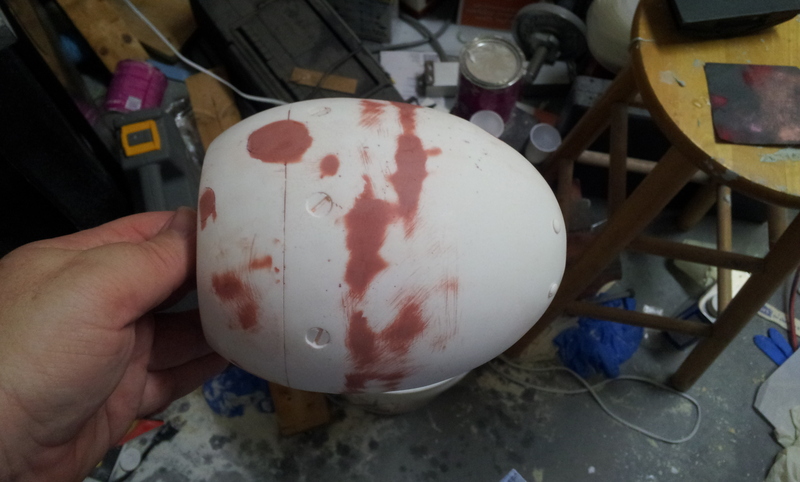

I used the red stuff to fix some serious problems I had with a part I was casting in SmoothCast 65D and I did like Mak is saying: I fixed the problems and made a new mold from that. There are still problems, but it looks ok.
This is it before primer and making a second mold:
