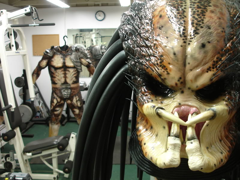

My DBP1 G2 came with sculpey quills, some of which have already broke off right at the base where they were glued to the mask. What are you guys making quills out of these days? I want something that's a little more bio friendly, that will bend freely without breaking off. The quills on my mask are somewhat thick, I'm looking to make/buy quills like these:

Can you guys tell what those quills in the pic are made of? Latex ones sound promising... unless I can find somewhere that sells just black bake & bend sculpey, that doesn't come in a kit with a bunch of different colors.

I'm wondering if those are latex or what, they look hollow in the middle I seen an old thread saying his quills have broken off right where they're glued on, just like sculpey quills :)
