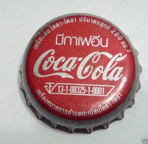

here is an example of a real Coca Cola Bottle Cap.

Bottle caps are screen printed while the metal is flat, then crimped on to the bottle.

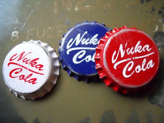

Check this out on etsy.
http://www.etsy.com/listing/98485194/nuka-cola-bottle-cap-set-fallout
These look fantastic. How! lol
