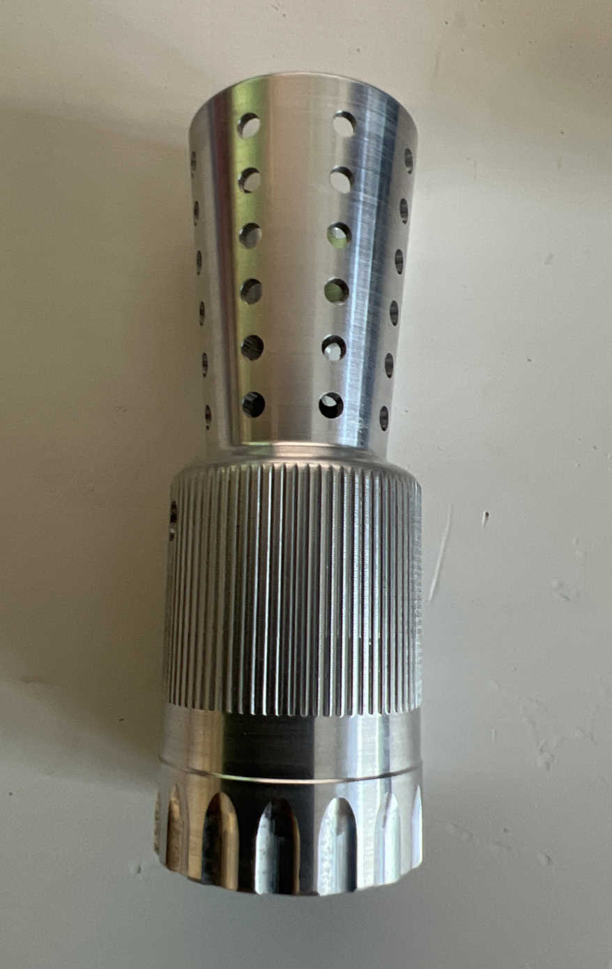

Hi, I‘m working on a Star Wars costume at the moment (see my other threads) and found a nice way for weathering Aluminum parts. Just put them in the dishwasher. Something you should never do with aluminum kitchen stuff.
Here my DL44 flash hider before, new and shiny:
And after one round for an hour. But be careful, to much and it could be overdone. Then you have to polish your part and try it again.
7-11 Jedi

Hi, very interesting. I’m using these little dishwasher tablets. Maybe your have different ingredients? Could be. I also have to fill the machine with a special salt from time to time. On the package it’s written that’s the ingredients are phosphate, polycarboxylate, bleach and soaps.
It’s a store brand. For the German folks:
Ich nehme die DM Marke von Denk mit.
