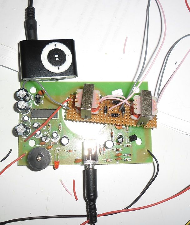

So I tried a bit of slimming down of the unit:
The carrier sine wave is recorded onto the MP3 player at this stage - not an ideal solution but it helps:
Wearable Cyberman ring modulator: Setting the distortion - YouTube

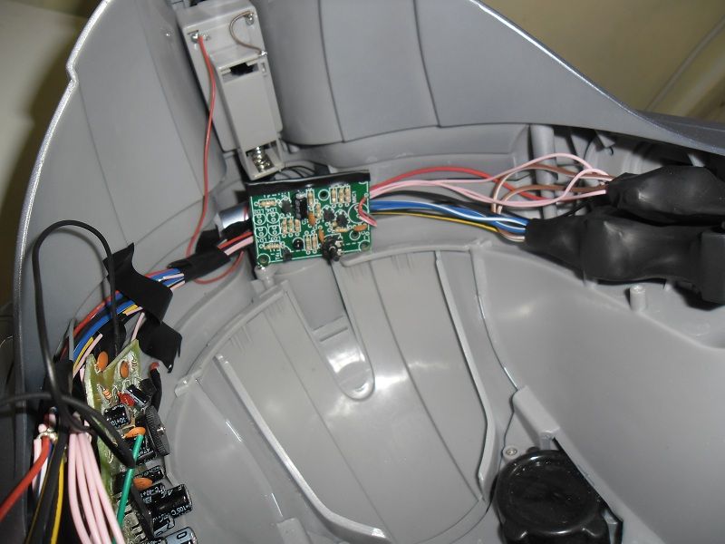

Eventually I managed to find a digital oscillator to provide the 120 Hz sine wave carrier tone which means I can power everything off one power source and I can now start installing it into a Cyberman voice changer:
And here's me trying out the final unit:

To be honest, building the thing isn't the hard bit. Getting it to fit inside a helmet or shielding it from interference and feedback is the difficult bit.
