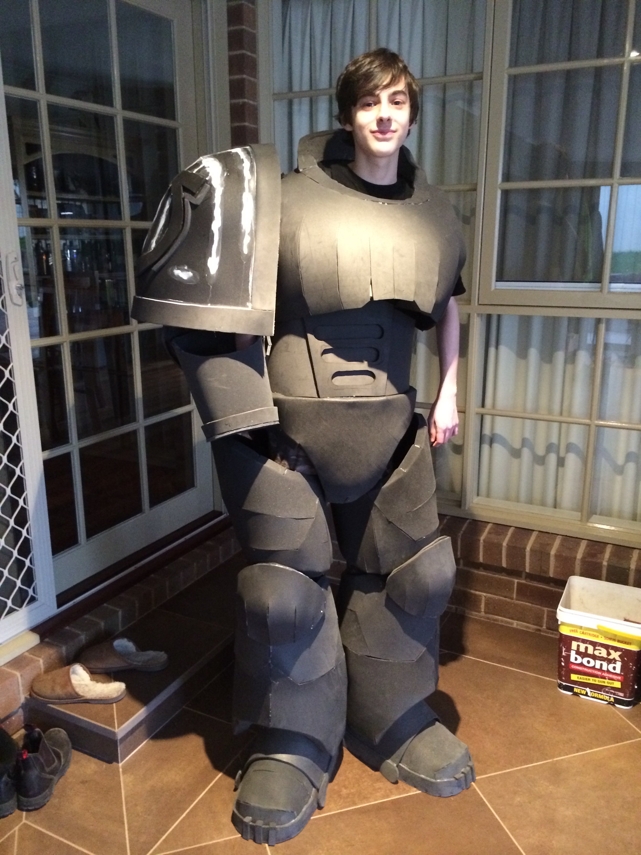

So this is what I have accomplished thus far: (sorry don't know how to rotate images yet.)

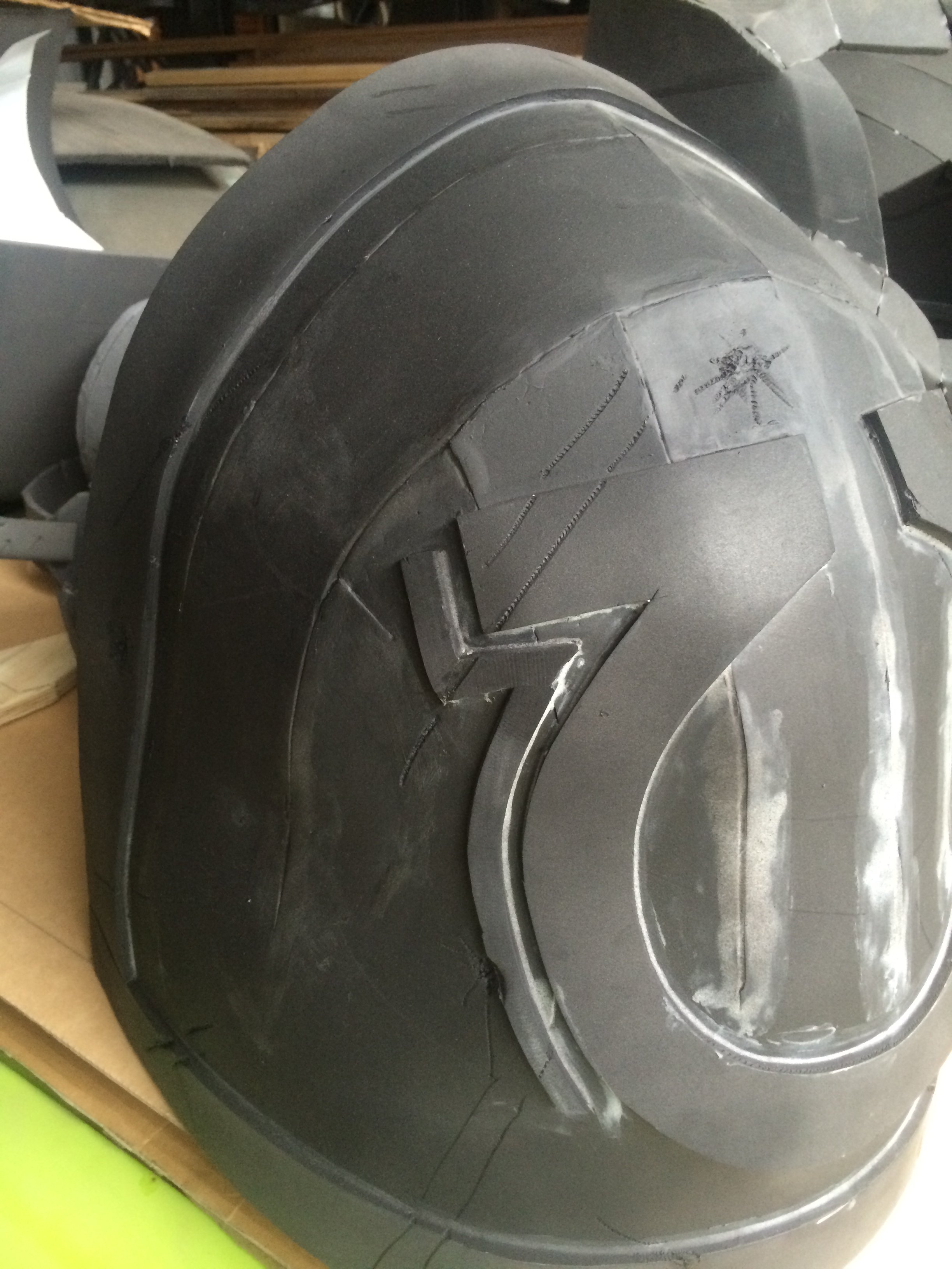

As you can see, my join work is totally crap but I will be working on that. My join lines maybe bad but my filling is good, gonna need HEAPS of no more gaps!
If you are familiar with space marines like me, you will notice the shoulder cap needs to be higher. So far I am going off Gary Sterley's build for now, he uses ball joint on brackets to support his shoulder bells but for now I don't have a 3D printer. My birthday is in a few weeks so I should hopefully have one by then. so that's 1 problem solved!
the other problem is the height. I have come too far to restart though :( I was aming for a 7 foot model which is the actual size but the pep file I got was already scaled to around 6.2. at this point I still use stilts because Im a scrawny little thing. but because the whole thing is shorter so are the arms, so as I grow my arms will be able to come through and I wont have to shorten the position of the arms. Sounds like Im venting at this point huh?

First thing I did was do a bit of detail work on the shoulder cap. while filling with no more gaps its hard to see if you filled the line marks properly because of the color contrast, so I gave it a coat of black to see show proper distinction between the filling and the foam. I was only too P.O'd to find that the no more gaps shrunk while it dried, looks like one more layer should do it though. I then started to screw around with my soldering iron on it but I was pretty happy with the outcome.

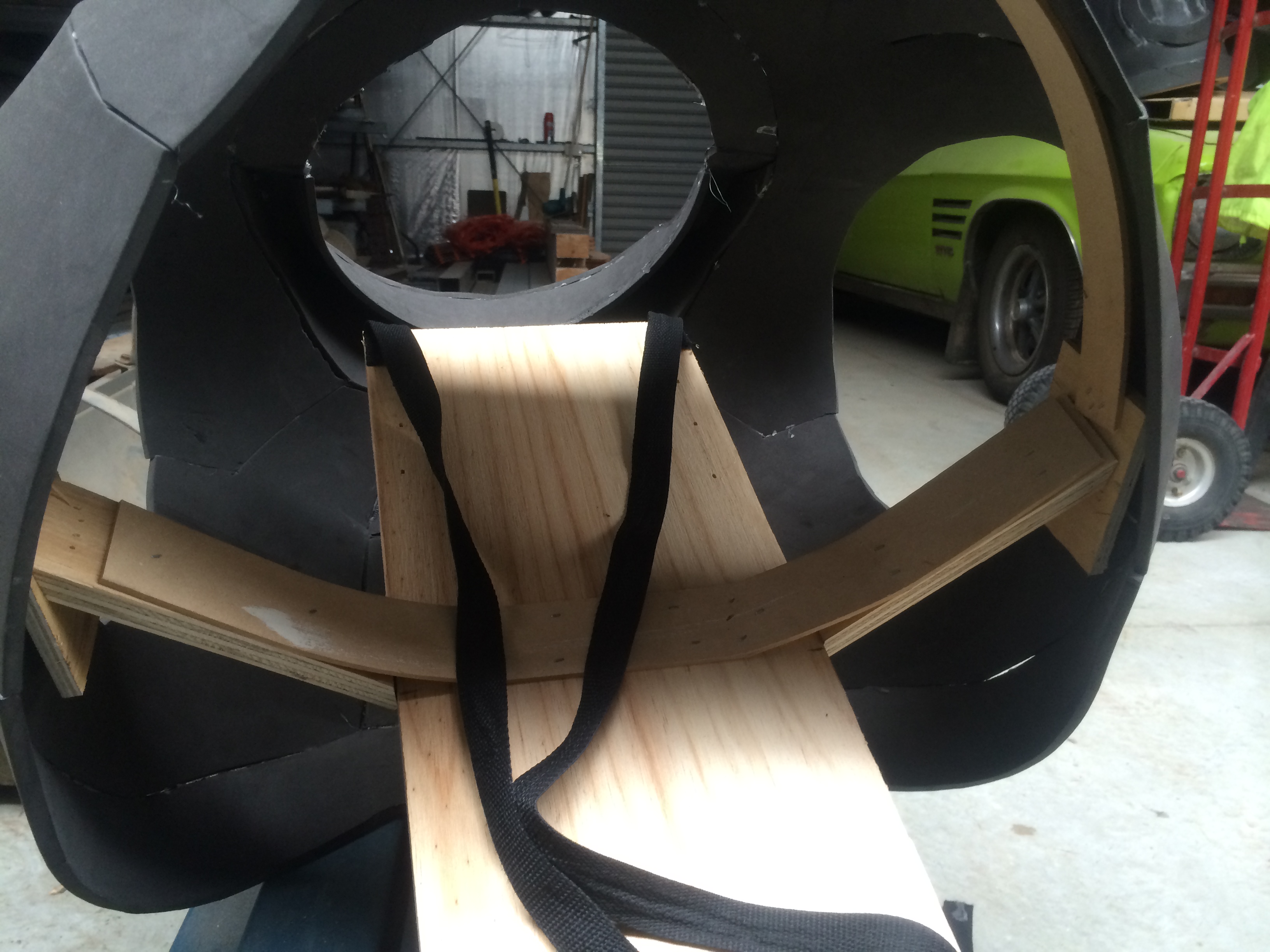

After that I began doing some work on the internal structure.
I used 3 mill MDF to brace the convex of the chest because it was the hardest flexible material I could find besides 1-3 mill acrylic, but i went with MDF because it was cheaper and I didn't have enough acrylic. Im starting to think though that I should change it because acrylic has a greater tensile strength than MDF and is less likely to snap, I've already seen some hairline splits start to appear so I might revisit this section. as for the strapping system I will add more padding and back cushioning because at this point the back plate digs into your spine and its hard to stand straight.

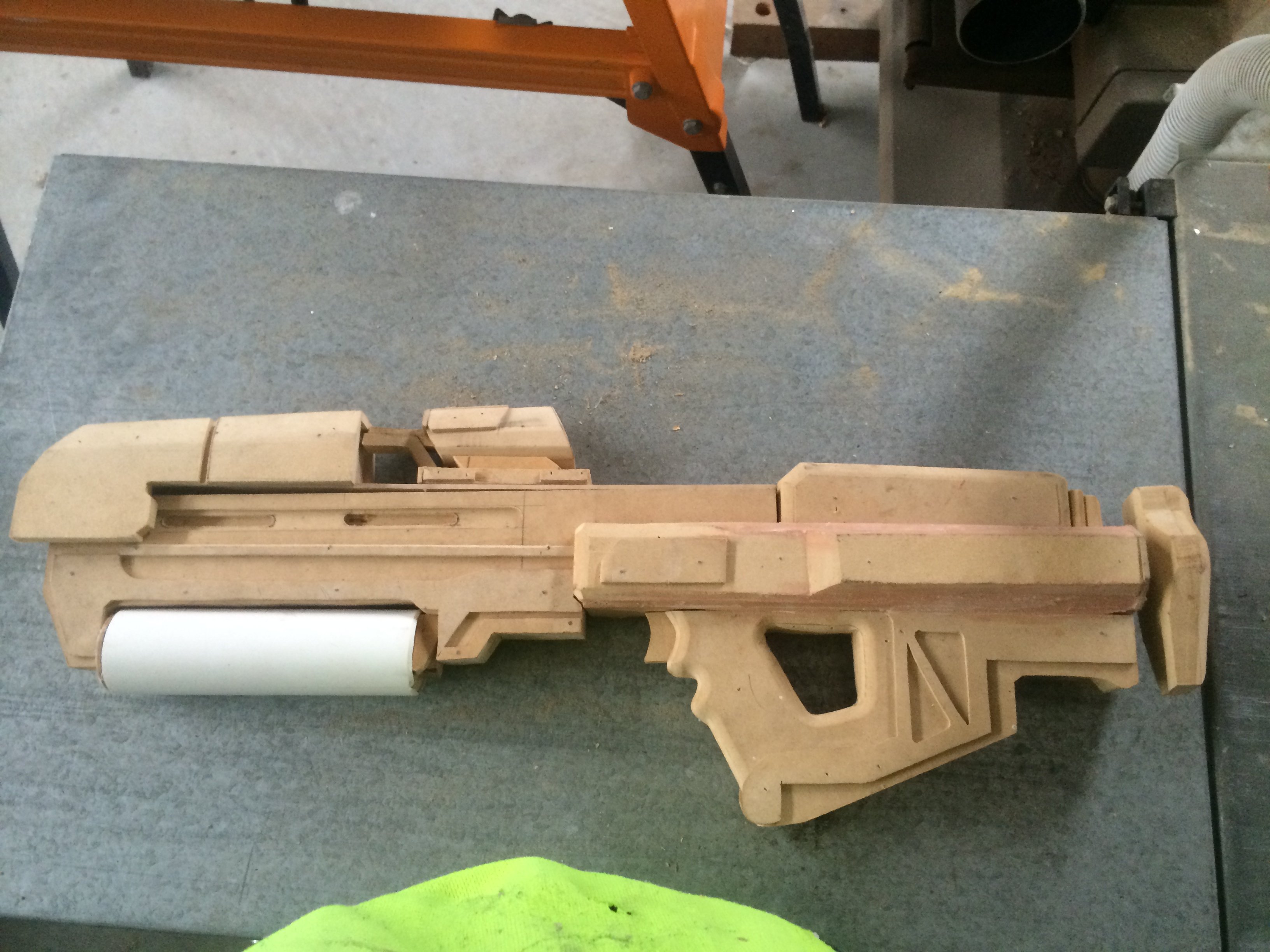

I started a while ago on an MA5 assault rifle from HALO Reach so I will be doing it on and off until its finished. this will set posting for this thread back to about once every 2 to even 4 days depending on circumstance. Here are some pictures of what I'm up to so far: (its nearly finished so it will only take about 1 more week)
I will make a thread soon for this and put up some of the templates I've used. I'll post a link soon.

but today we did a bit of work on the cod and abs area, I did the internal structure and made a strap system that hooks up to the torso.
