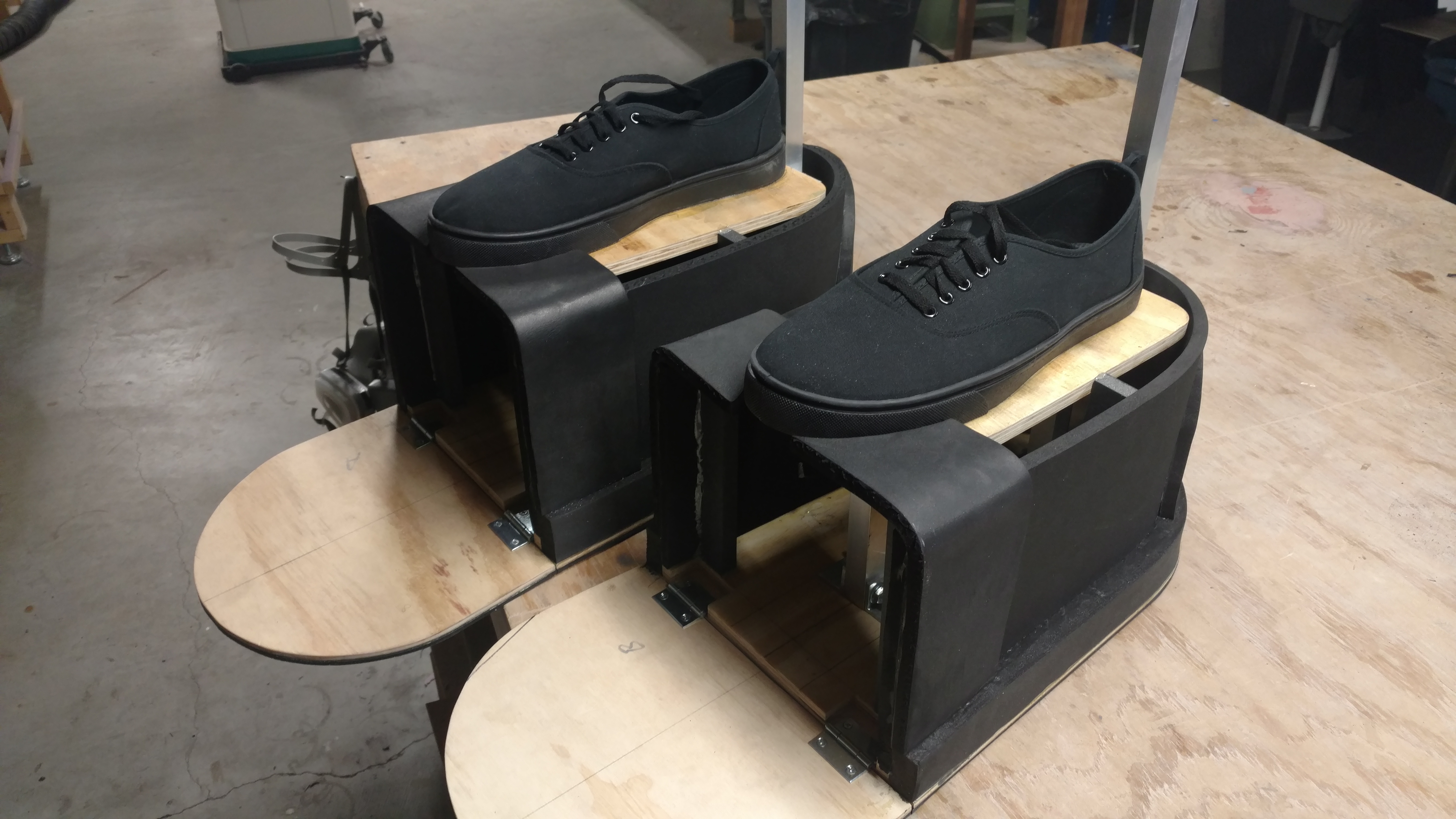

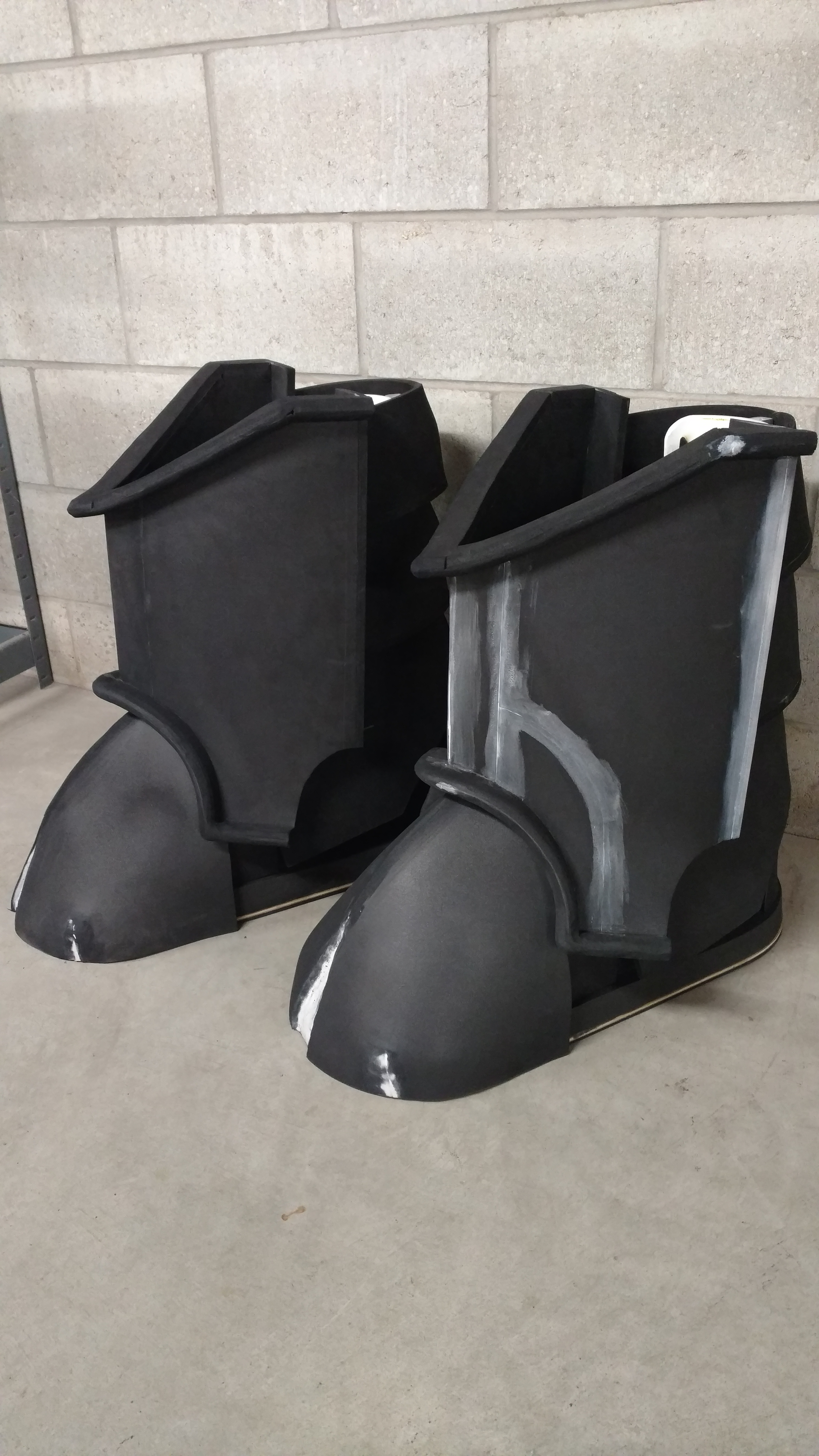

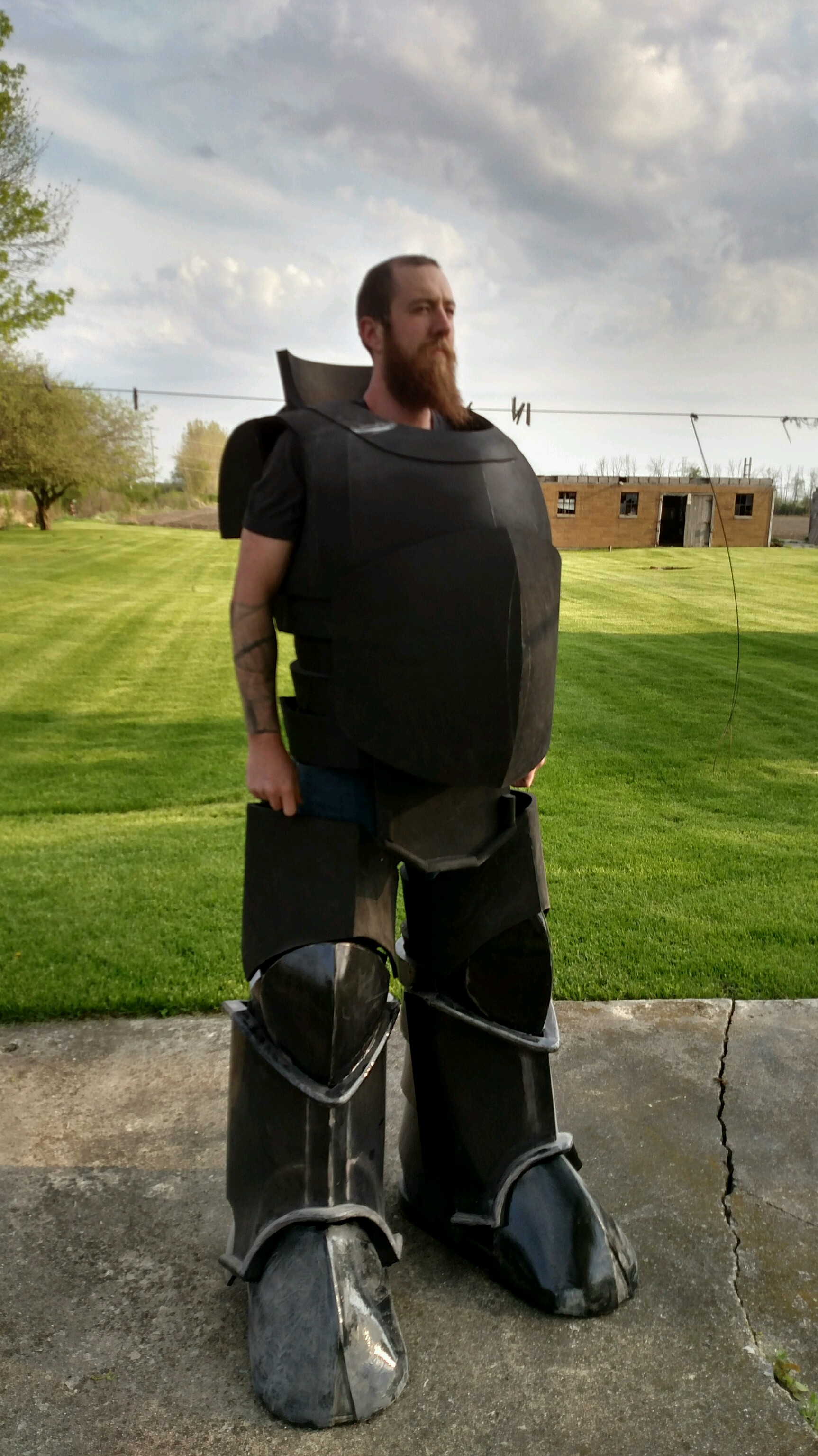

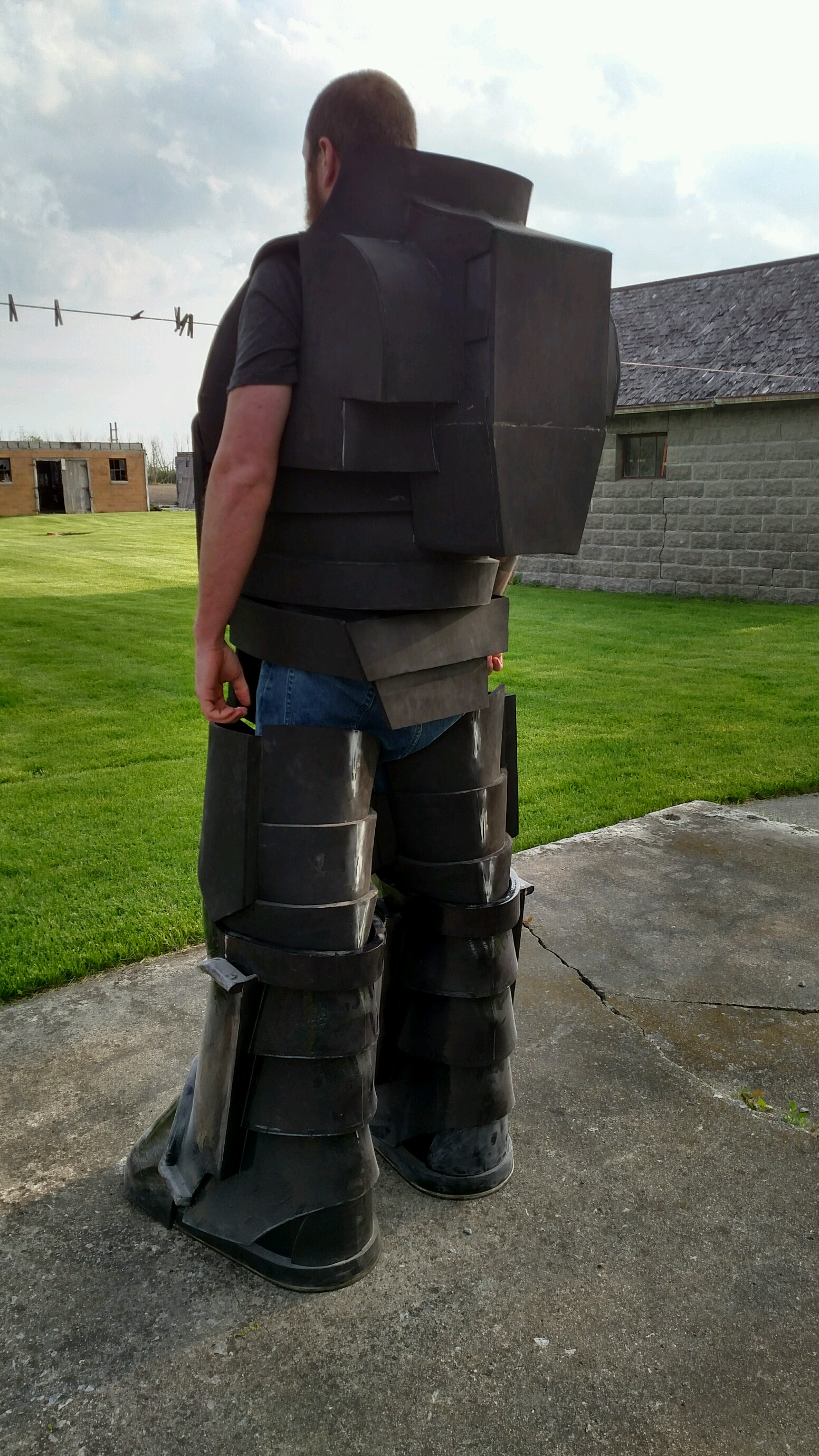

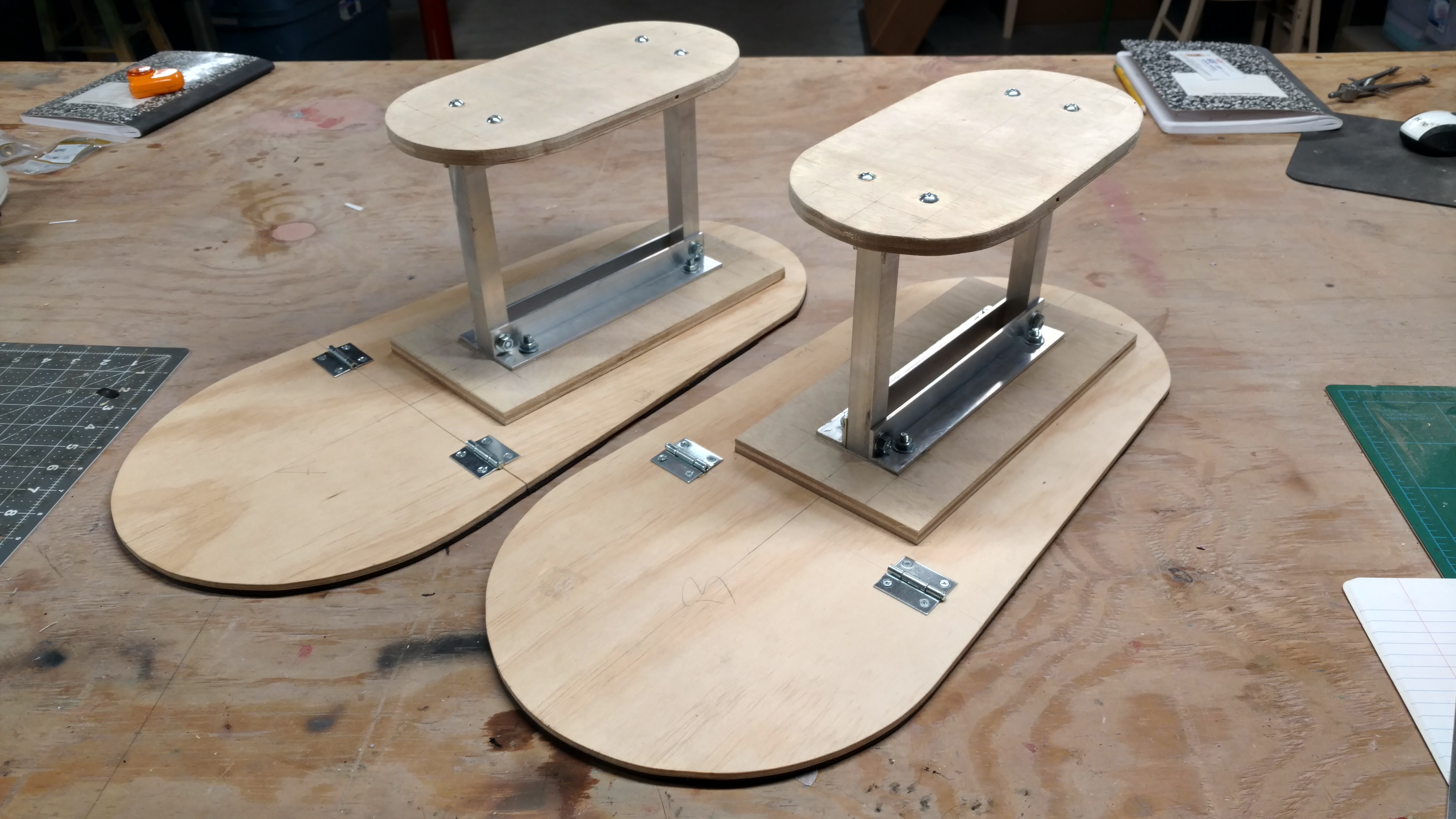

The bulk of the Plague Marine build will be done with EVA foam (for cost and weight), then coated in Smooth On's Epsilon Pro. The build started with the boots/stilts. Being 6' 4" I didn't have to make the stilts too tall to get myself to the average Astartes height (between 7' -8'). The build will also centralize around the MKIII pattern armor, which was favored by the Death Guard during the Horus Heresy for its extra resilience:

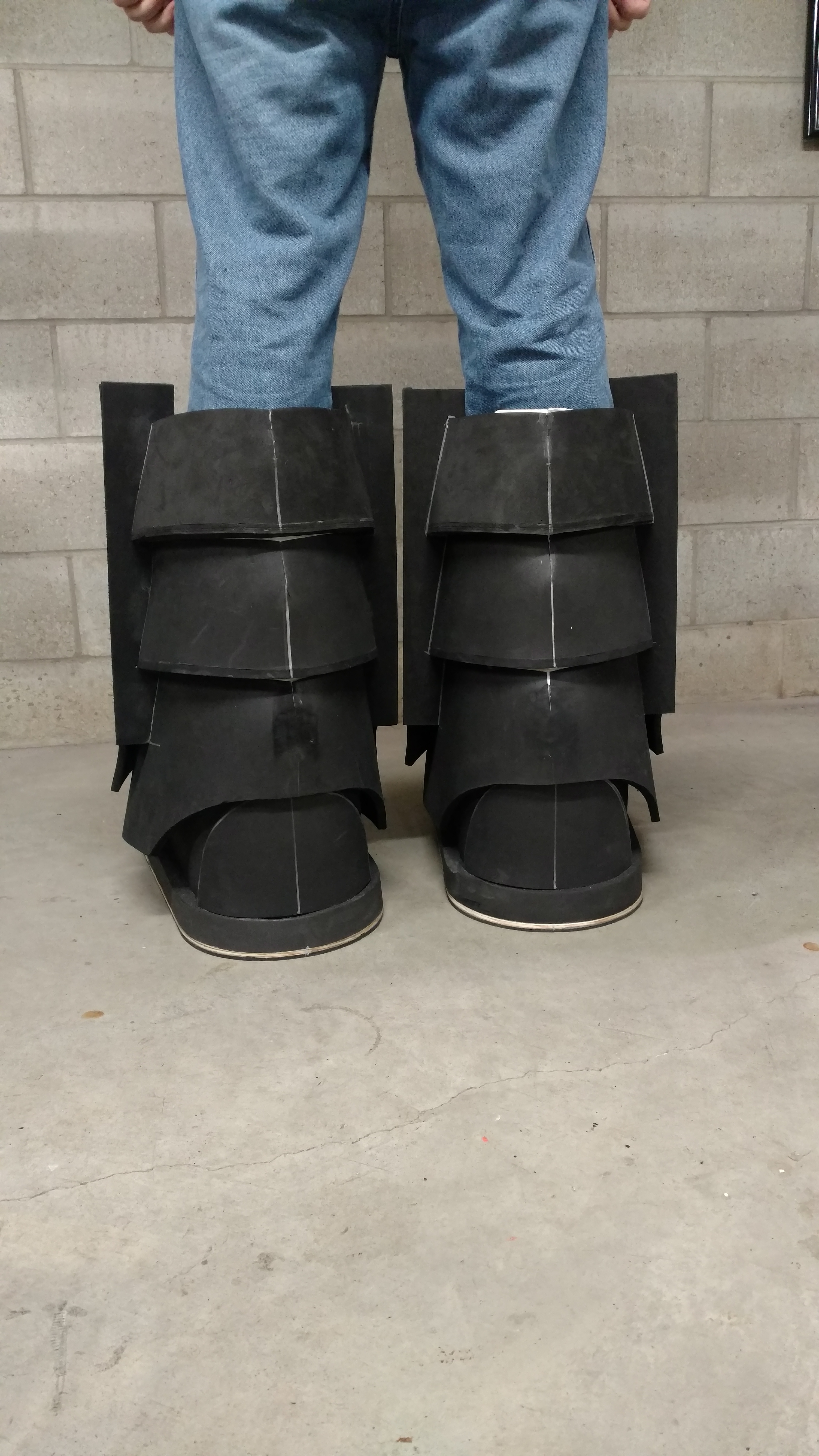

From there we worked on up (scaling from a Games Workshop model):
The "soft" exposed joints of the armor were created from a ridged master, molded and cast with Smooth On's FlexFoam-It! X (dyed black) and assembled as a series of stacked rings. (Test fit the first few above).

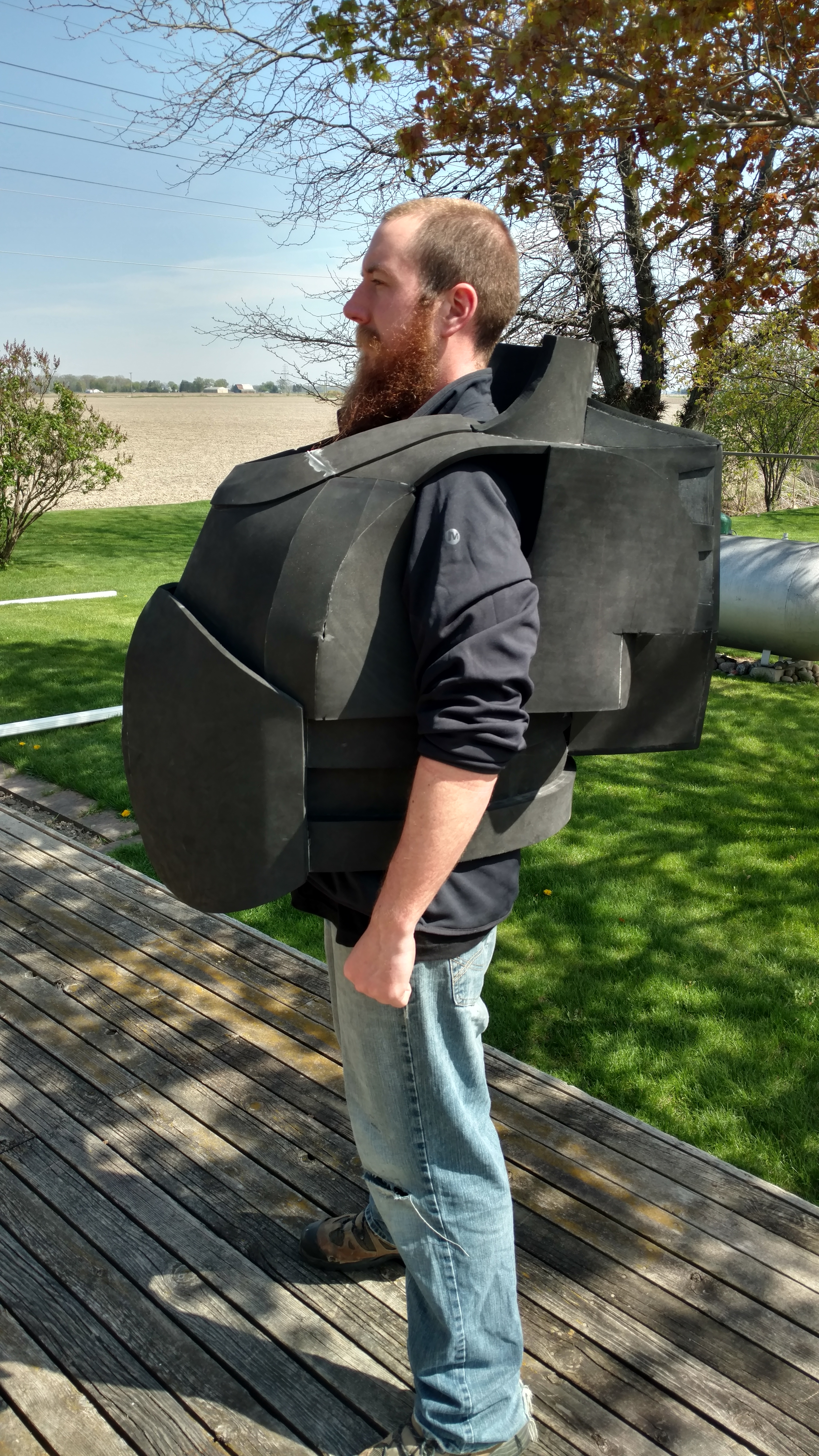

We modeled the body after the MKIII with the modified gut plate (added post corruption to hold back/in the marines mutated bloated body and guts). This will eventually have a large exposure added with intestines pouring out.
Arms and shoulders are well underway, but we don't have any photos of them yet.

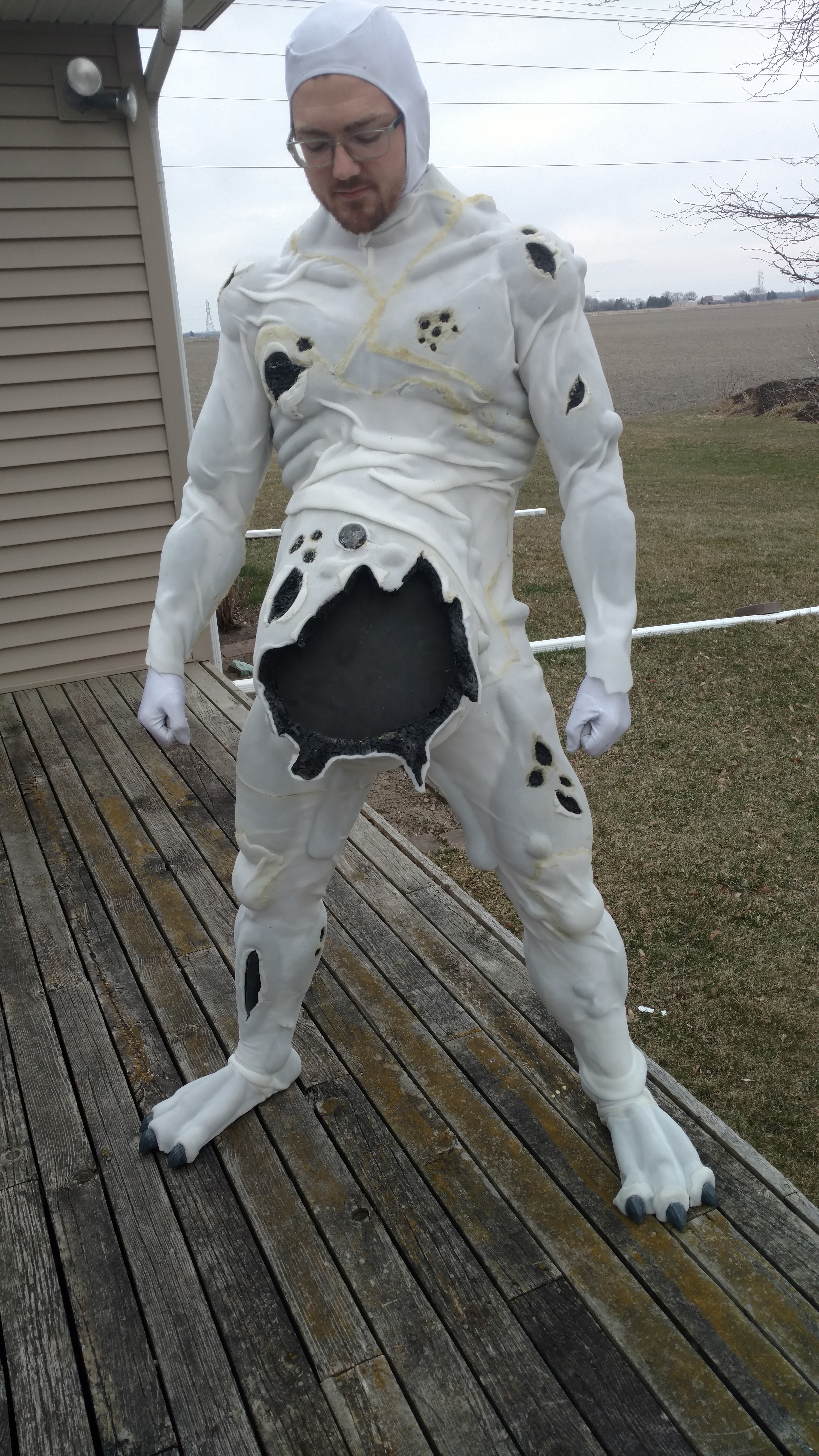

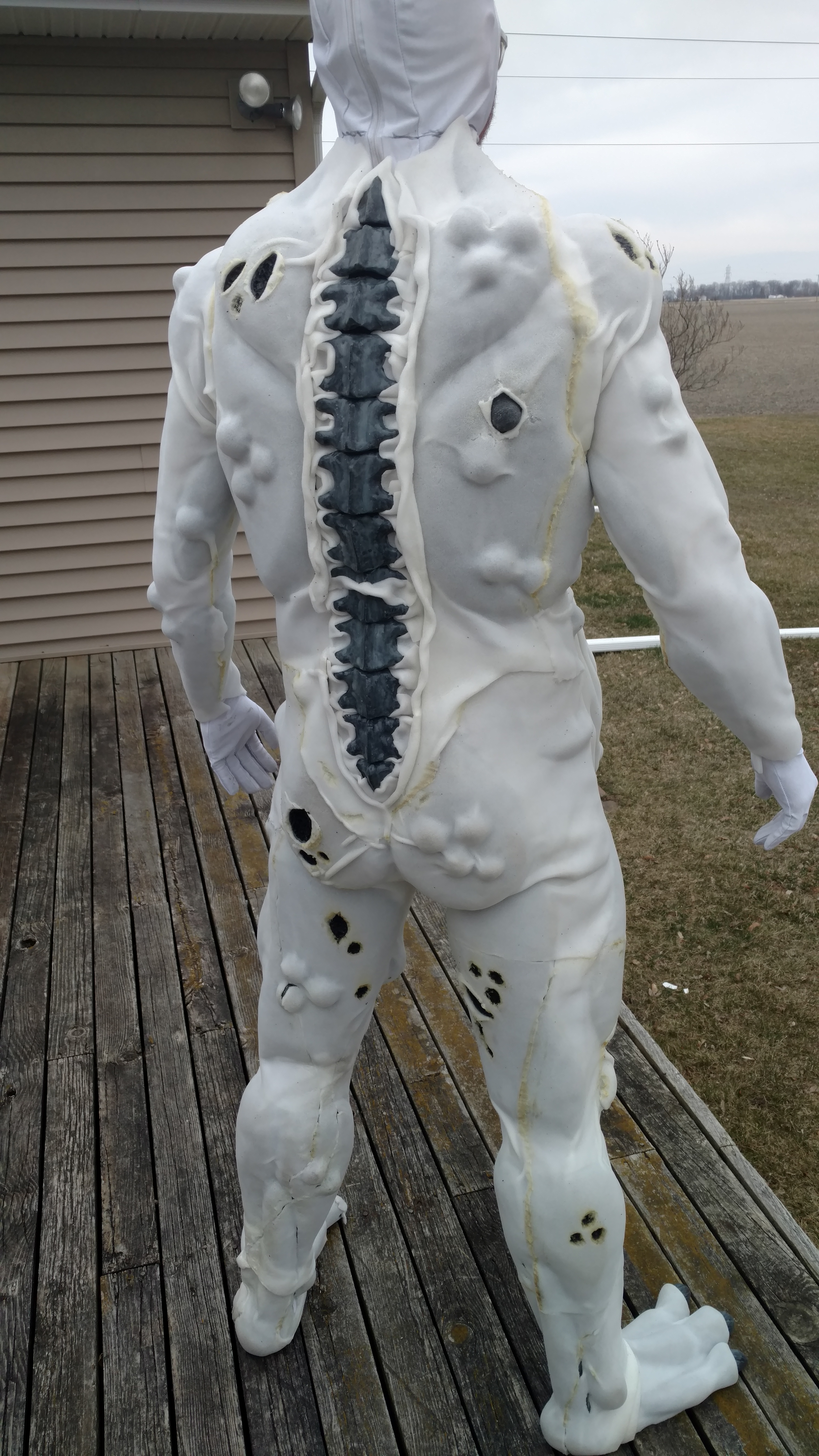

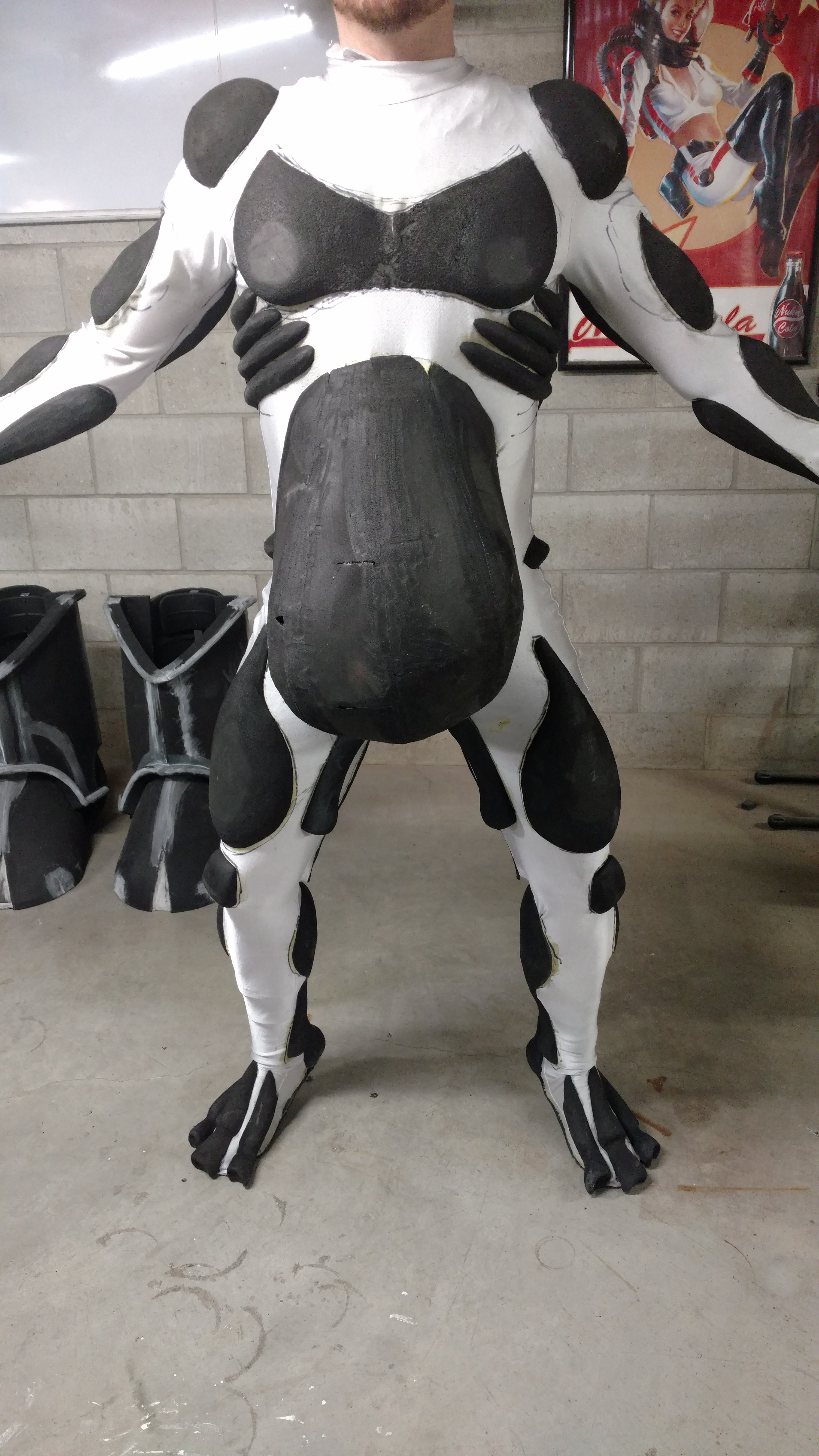

Chris' Plaguebearer started off of a white zentai suit and a bunch of muscles sculpted from L200 foam, skinned with 1/8" upholstery foam and layered with latex. Plaguebears also have bloated, grotesque stomachs and exposed spines.

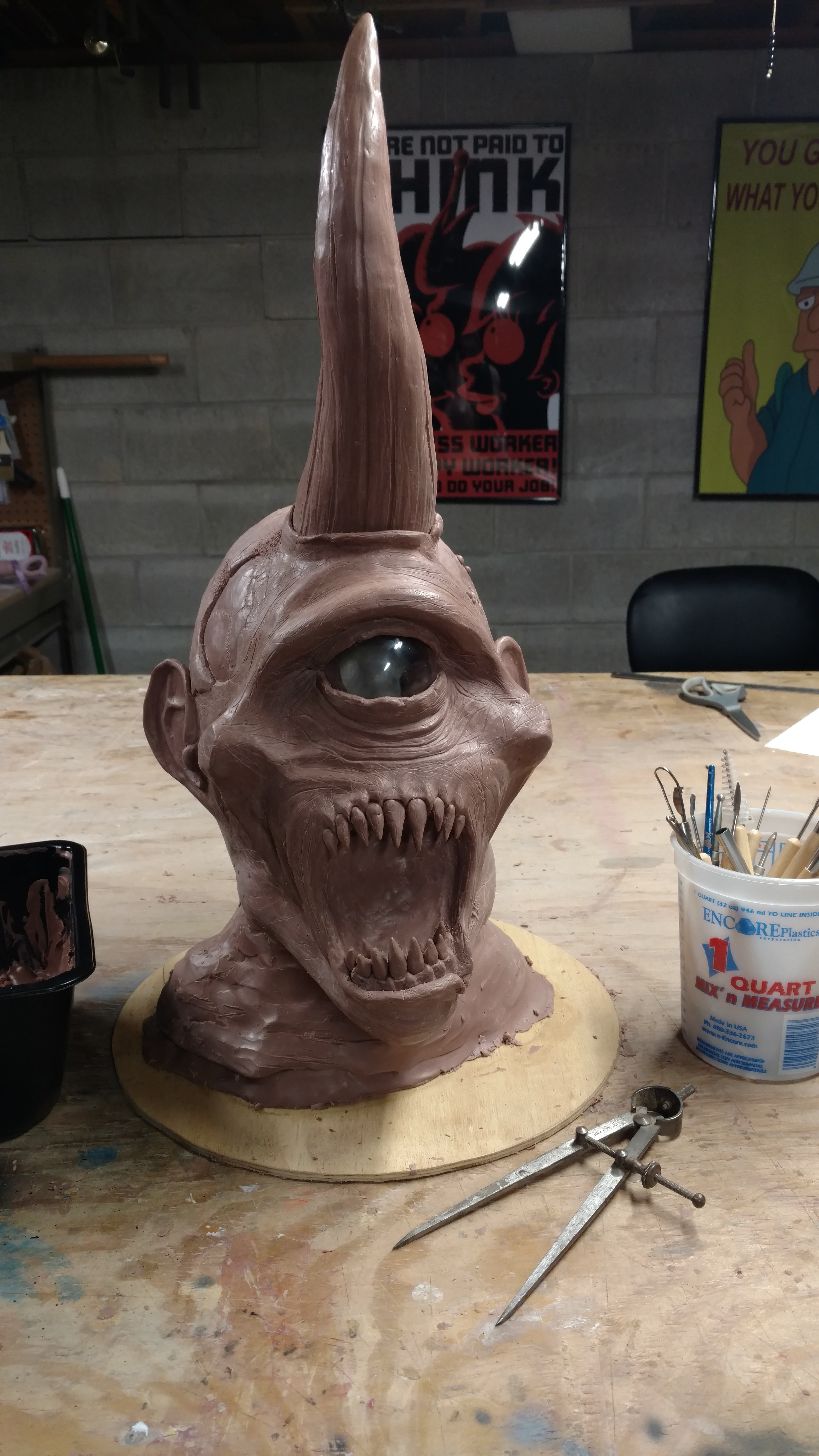

The Plaguebearer required a lot of sculpting for the hands and head. These were sculpted in Monster Clay and stone molds made (Ultracal 30) so they could be cast with latex.

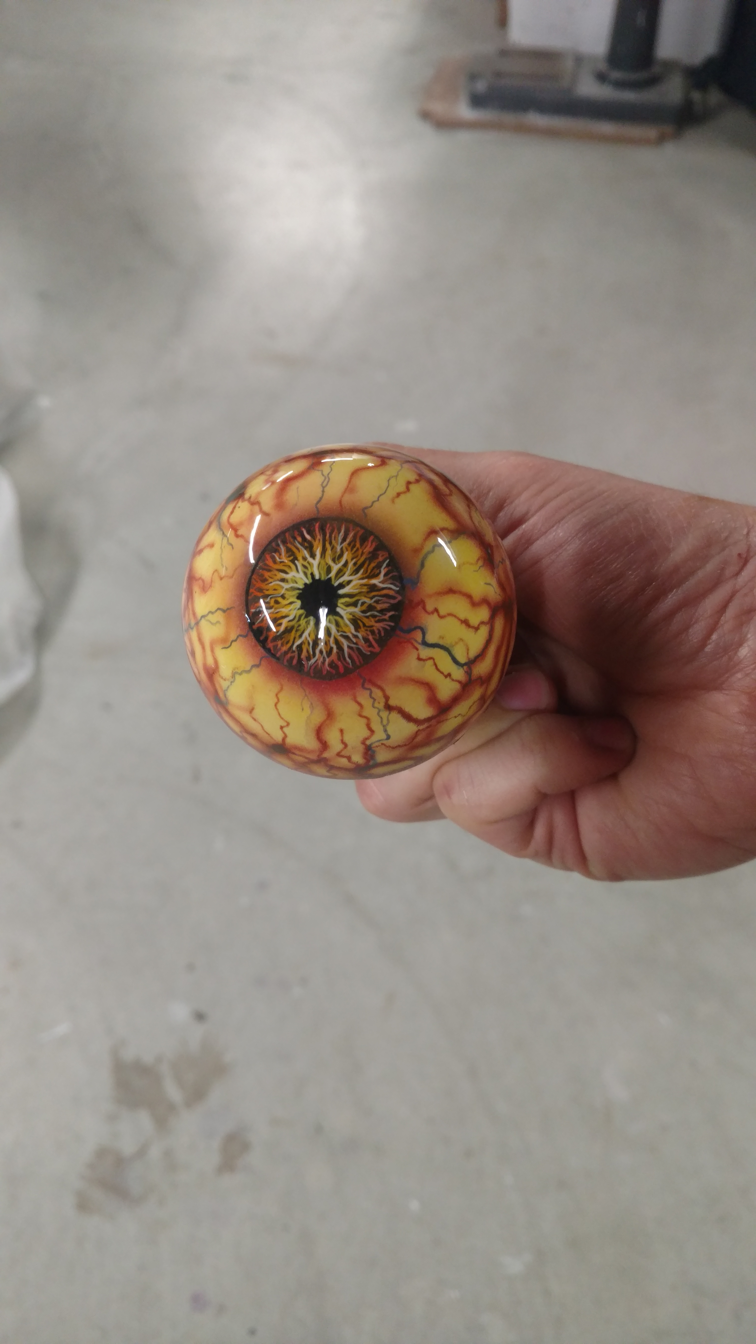

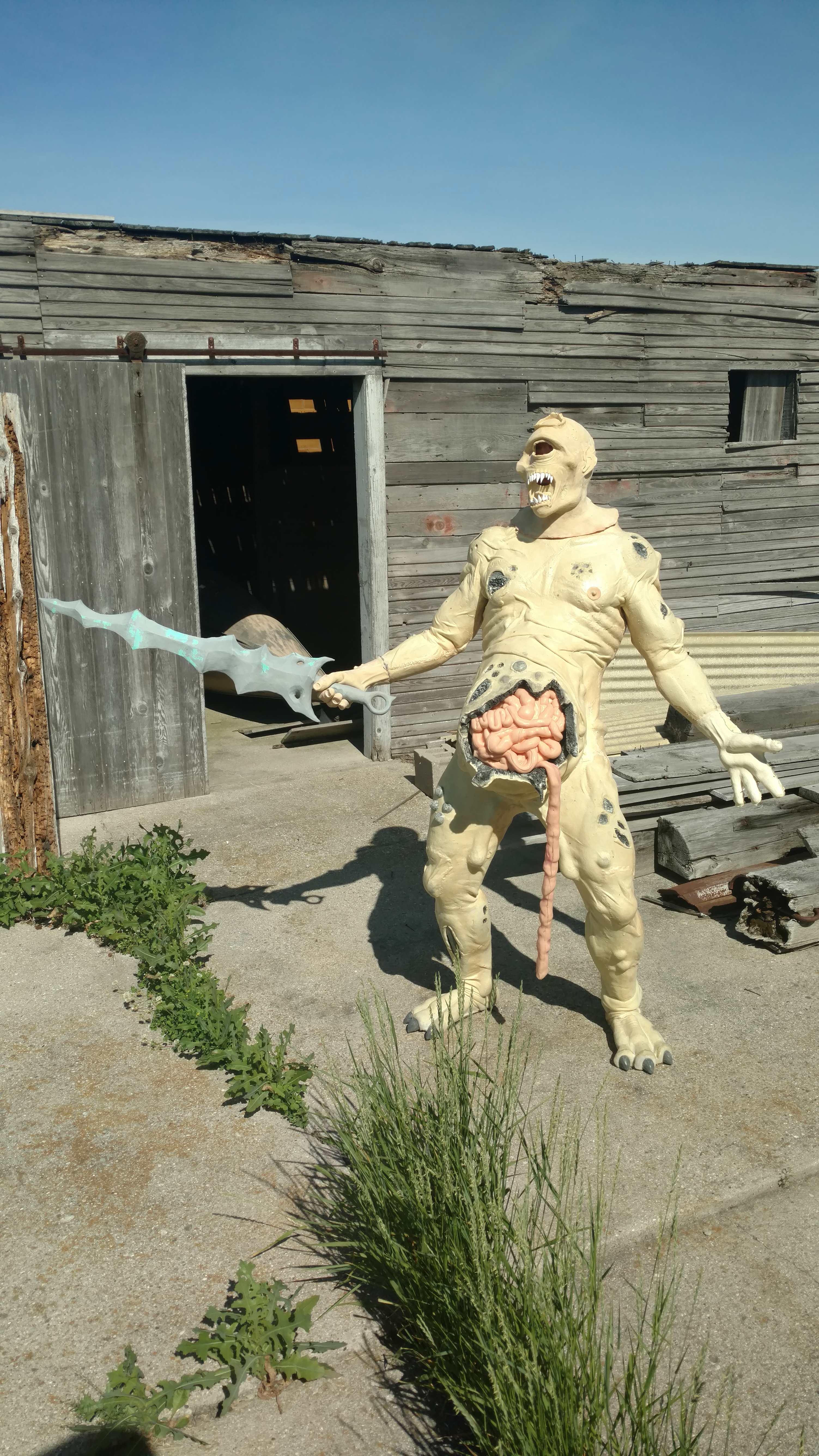

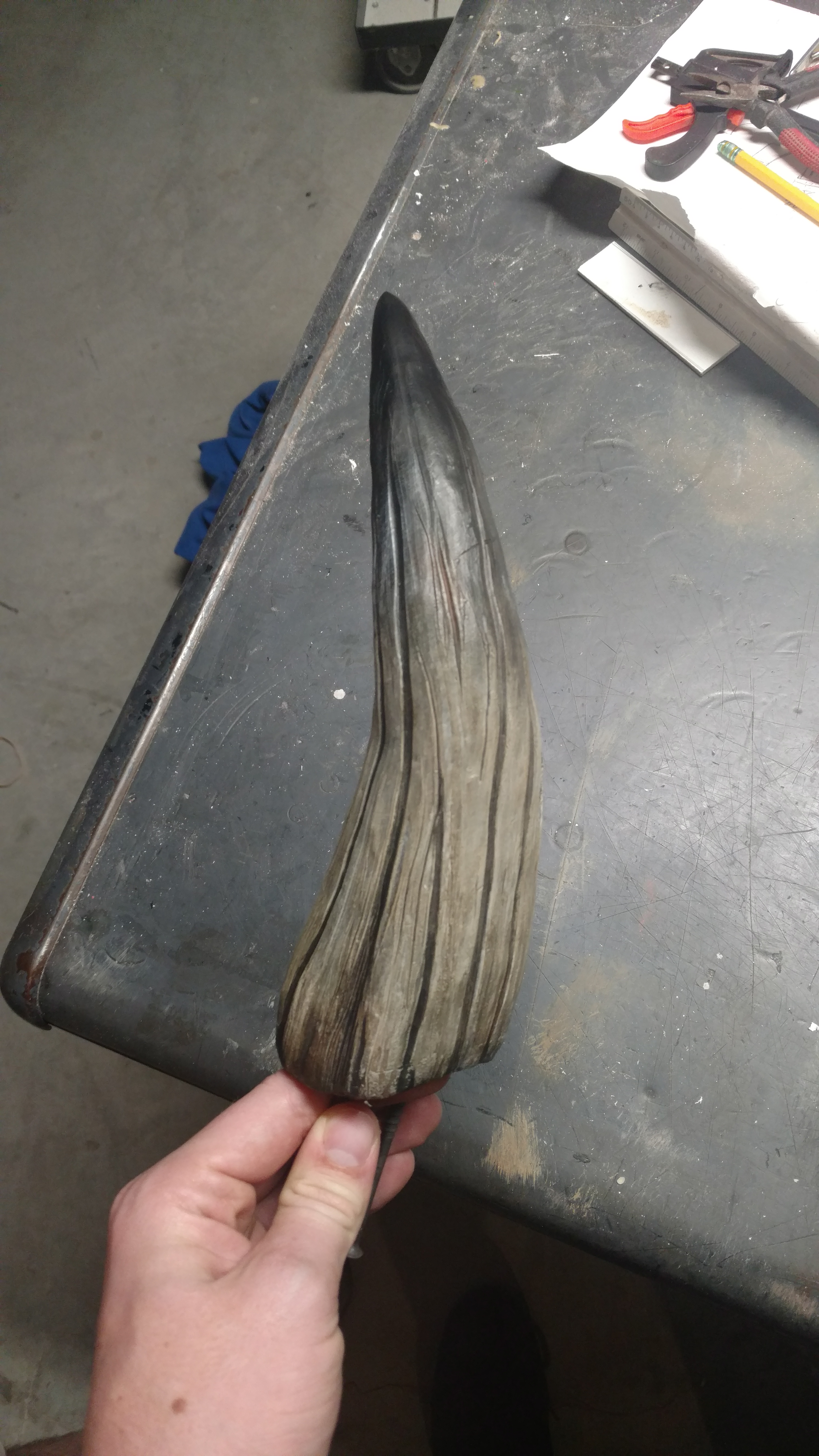

The nails, teeth, and horn were all molded and cast separate with Smooth On's Smooth-cast 305 resin. We also sculpted a heap of intestines and cast them with Smooth On's Dragon Skin silicone (the above cast had too much flesh pigment added), these will appear on both costumes.
