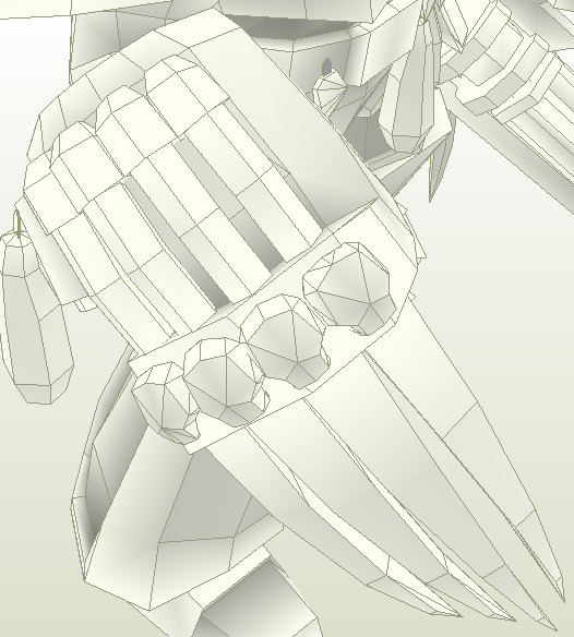

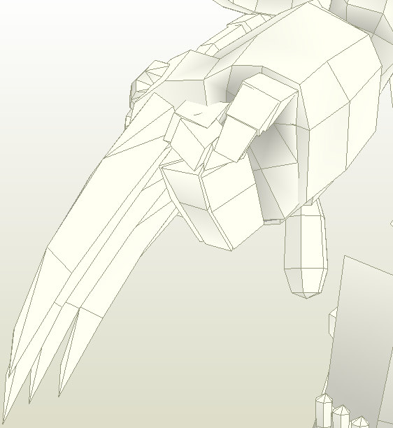

Here is the file I am working with:
Original claw was INCREDIBLY off in scale, so I had to change it, this looks much better now.
Here is what the hand looks like so far. Really liking how this is turning out.
So I have made the pepakura to the scale I am looking for, and now I can see what I need to do to get this where I want it.

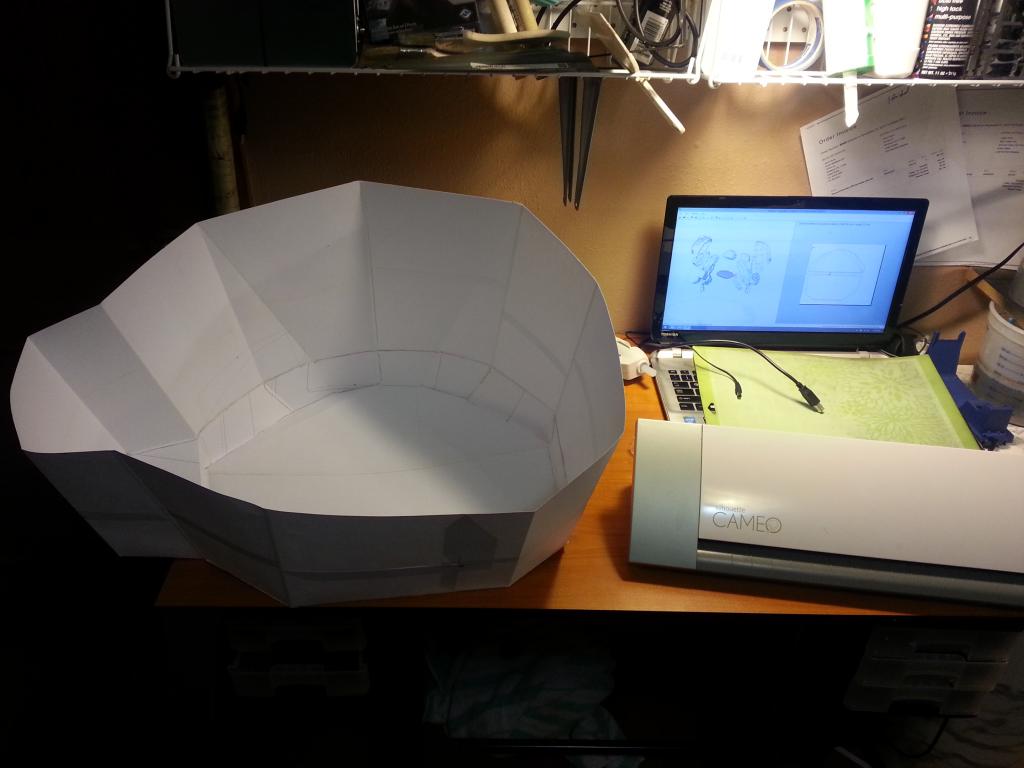

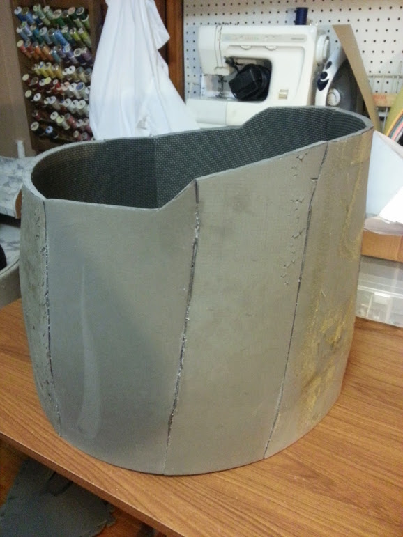

I now have cut it apart and I am using the pepakura to make the hand from foam. I will leave the fingers and claws as cardstock.

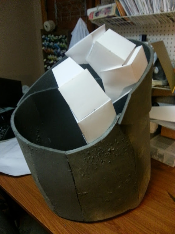

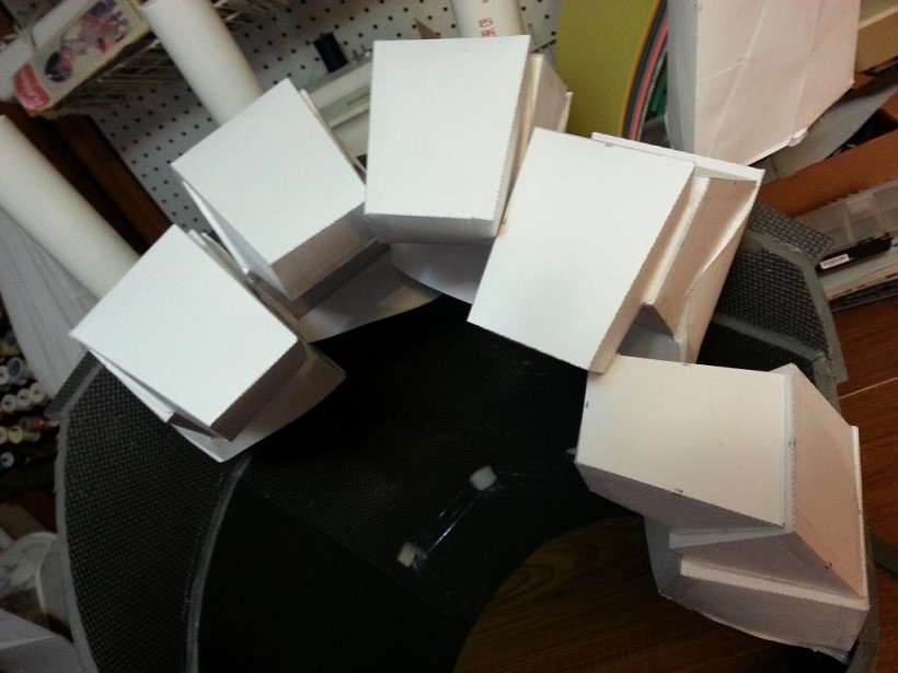

So after making the remaining fingers, I attached and lined them up to install the claw supports. I then attached blades.

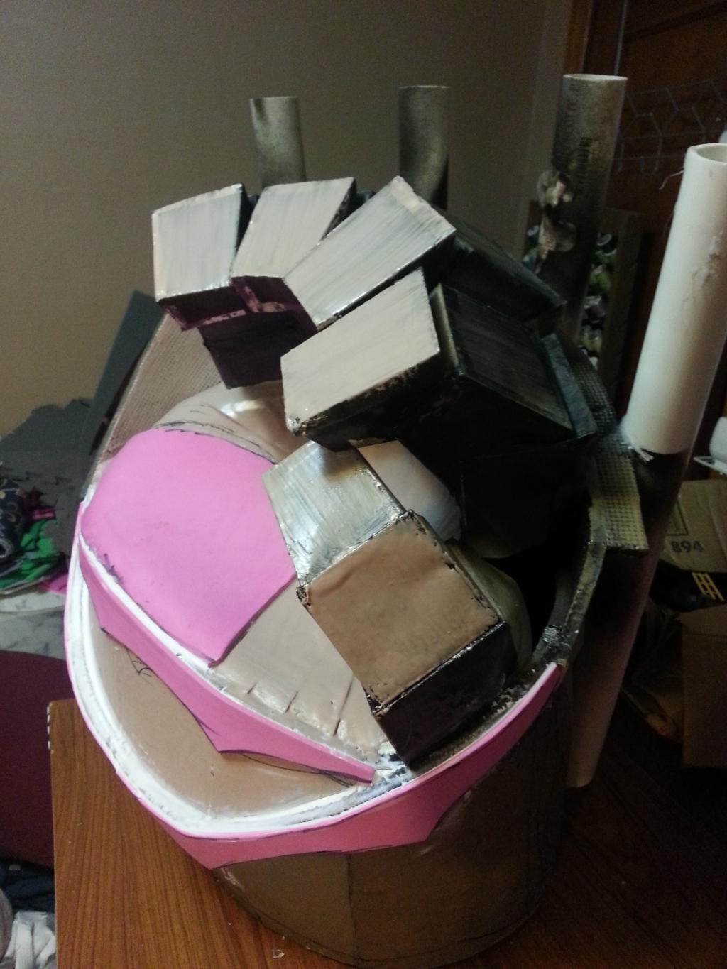

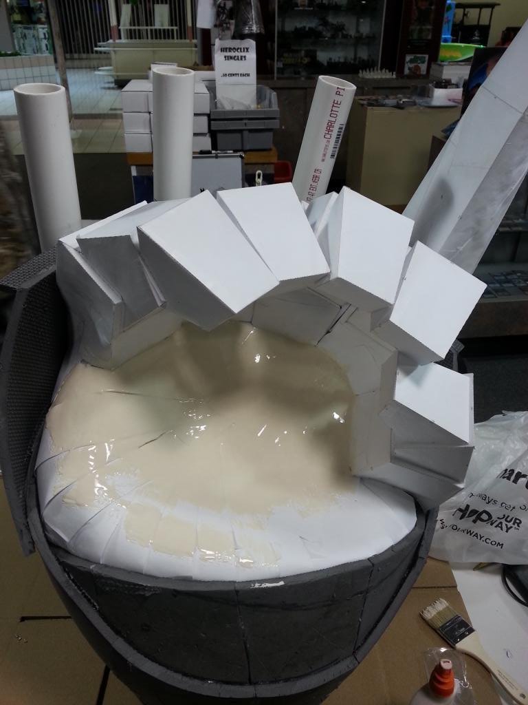

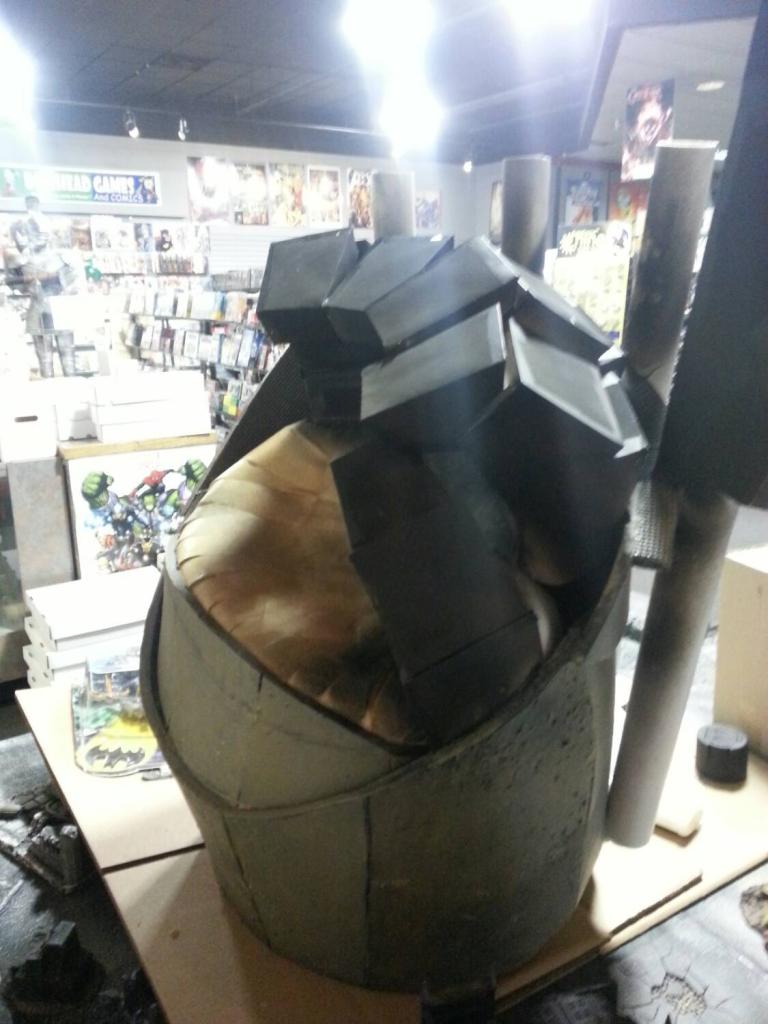

I next used strips of paper to create a palm, stiffened with a spray, and then added Bondo/Resin misture to seal it.

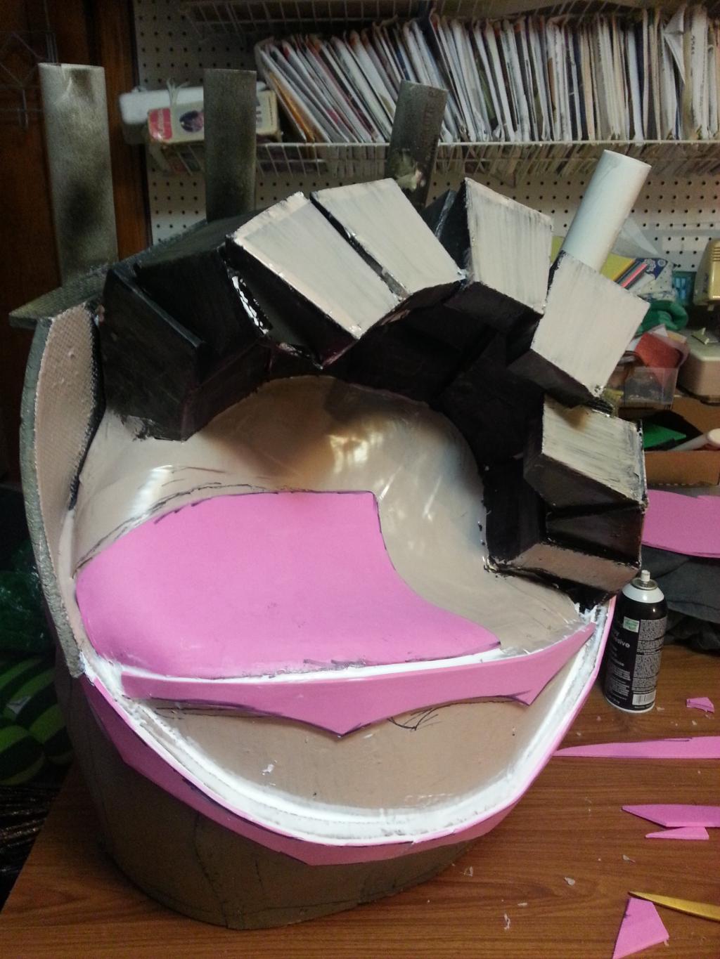

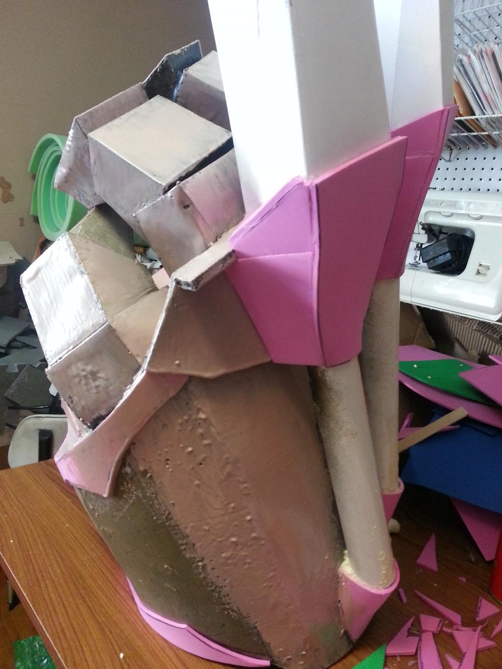

I decided to use 5mm EVA foam for detail work. I used 3M spray adhesive on the resin, and hot-glue on foam to foam.
20150226_211112_zpshpbqnz2p.jpg 20150226_211121_zps123i0vq8.jpg 20150226_222759_zps7wf0y78i.jpg 20150227_082457_zpss0bkfyns.jpg
I used a resin brush on mixture to seal the rest of the suit before painting.

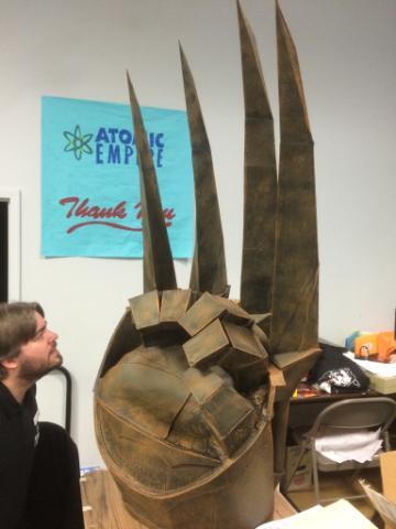

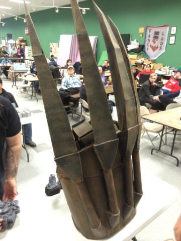

I did a bronze paint job for a local event. Starting a second one this week and will look awesome!
MG_9515_zpsak1wt8jg.jpg MG954899_zpsqn0zdy3h.jpg 11008447_1599346243644515_6544539612602146991_n.jpg
