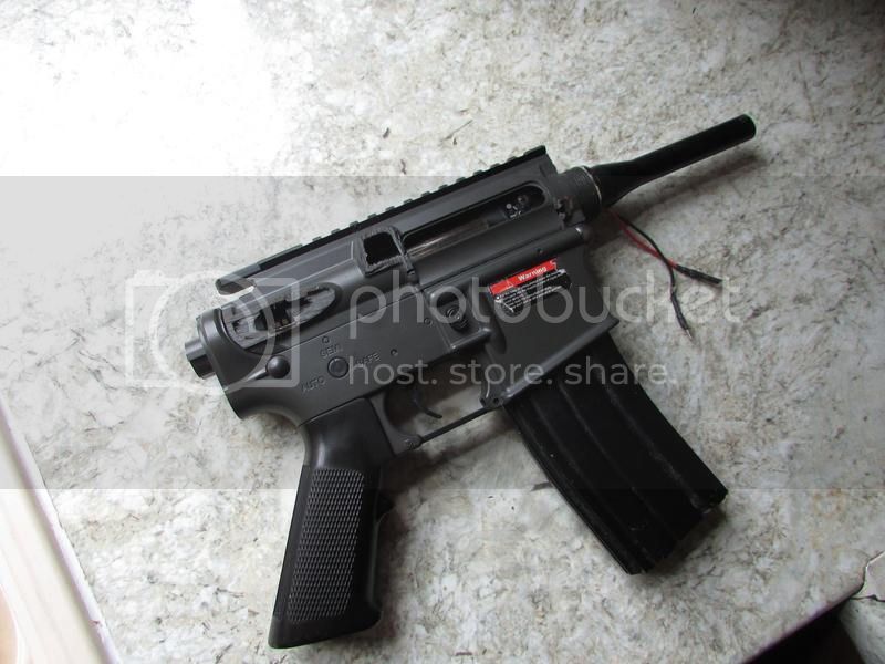

Start point: an Chinasoft plastic bodied M4
Why an M4? 2 Key factors (availability and construction)- The front end comes off in one piece as does the stock- that makes conversion easy. Unlike the G36 (another possibility) or G3SAS (another choice) the HOP unit is inside the body, meaning however I decide to build the new body I won't have worry about how to keep it functional.
Plastic bodied for the reason of lightness. I want something I can reasonably use one handed.
So: Hacked the outer barrel and inner barrel down to about 5" (No shorter than the many G&P Tank CQB models). Cut off all the sticking out bits, as we're going for slab-sided. Pull out the cocking handle to save weight.

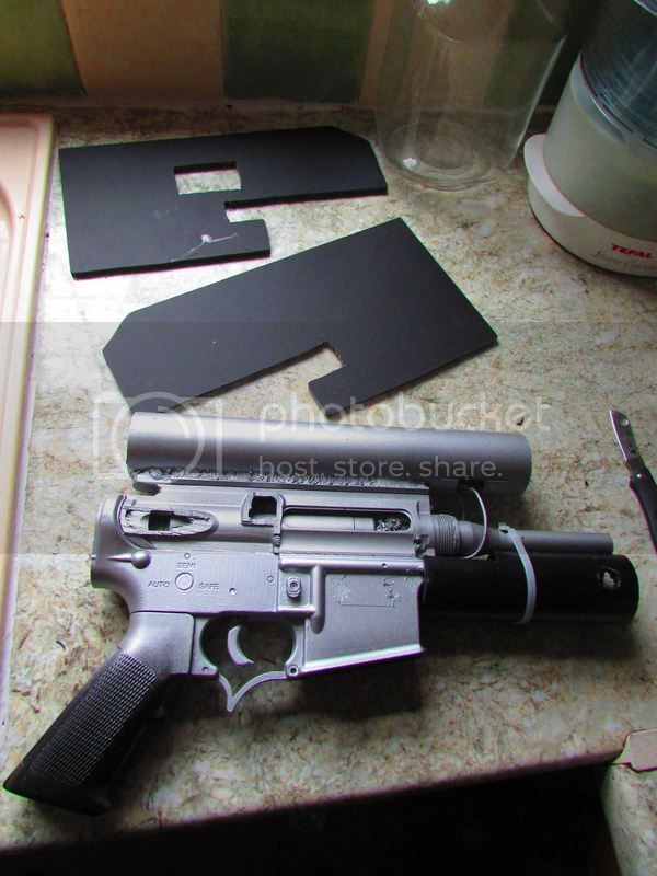

38mm PVC wastepipe becomes the fake bolt-pistol barrel- the real barrel becomes a fake 'gas tube'
To increase the 'chunkiness' factor, I'm adding another length of tube on the top using miliput straight to the top rail. It's also a place to hide a battery. This gives me a solid core to bolt the 'skin' around....This is where the big profile of the bolt pistol pays off.
Added a trigger shoe and funky trigger guard to mask the classic 'M4' profile a little. Cableties are a temporary measure while building.
So- Lots going on here.
Body has been fabricated from 5mm matt black acrylic sheet- as with the PVC barrel- my aim is something I can actually LIFT and use all day.
Guts have been sprayed satin silver so that when the 'skin' is bolted on, there's a pretty contrast between the two.
Mocking up stage- waiting for the paint to harden off then glueing in place. Also note I've added a 5mm eye bolt to the rear- this keeps the gearbox supported (no stock bolt) and gives me a locating point for a single point sling....It's screwed into the aluminium of the gearbox, not the plastic of the body.

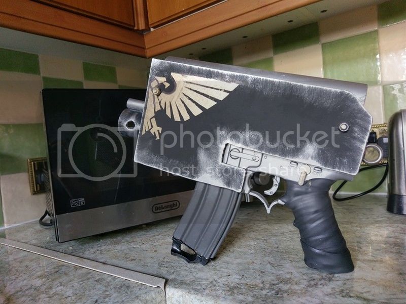

Hand cut Aquila stencil from standard paper- gold paint sponged on as I'm aiming for the 'mass produced' issue arm look.

Port side. Some work to do here and at the front....Purity seal needed and a little brass name plate (on it's way
Purity seal/ parking ticket Wip- This produced using the magic of Milliput White and a strong cup of tea for aging the paper.

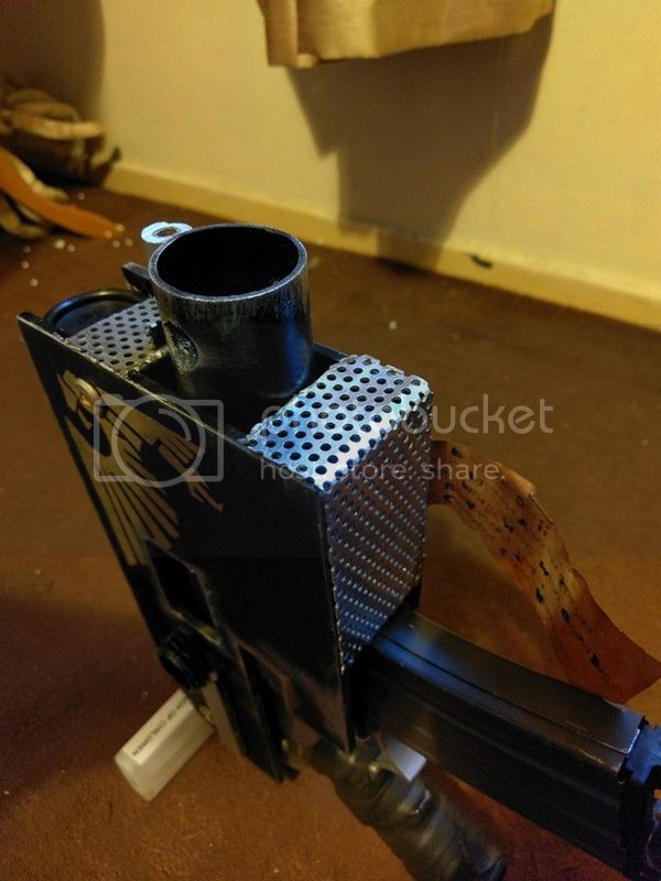

More finishing- ally perforated plate finishes the spaces without adding weight. And looks badass.
Rubber bungs added to the battery tube.
So- got a brass nameplate made on Ebay for a couple of quid and a shotgun bead as a rudimentary sight
And here she is finished:
