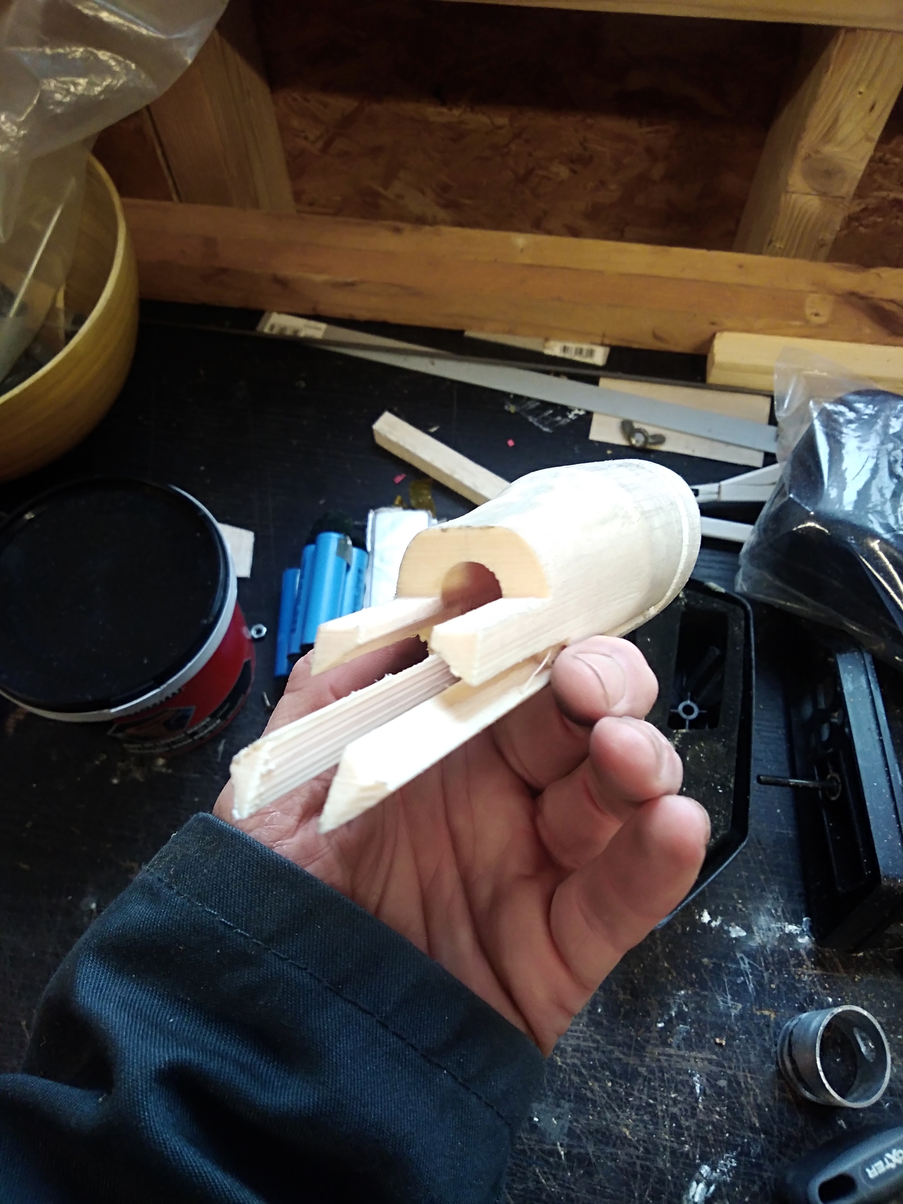

I'm currently working on the claw. It's an organic feature, so I'm making it out of an exotic heavy wood found on the basement. All I had on hand was a tiny table saw, so I had to find out how to shape the claw with limited possibilities. Layering seemed to be the best solution. It's a bit messy but I'll show when things will get a little more precise :)

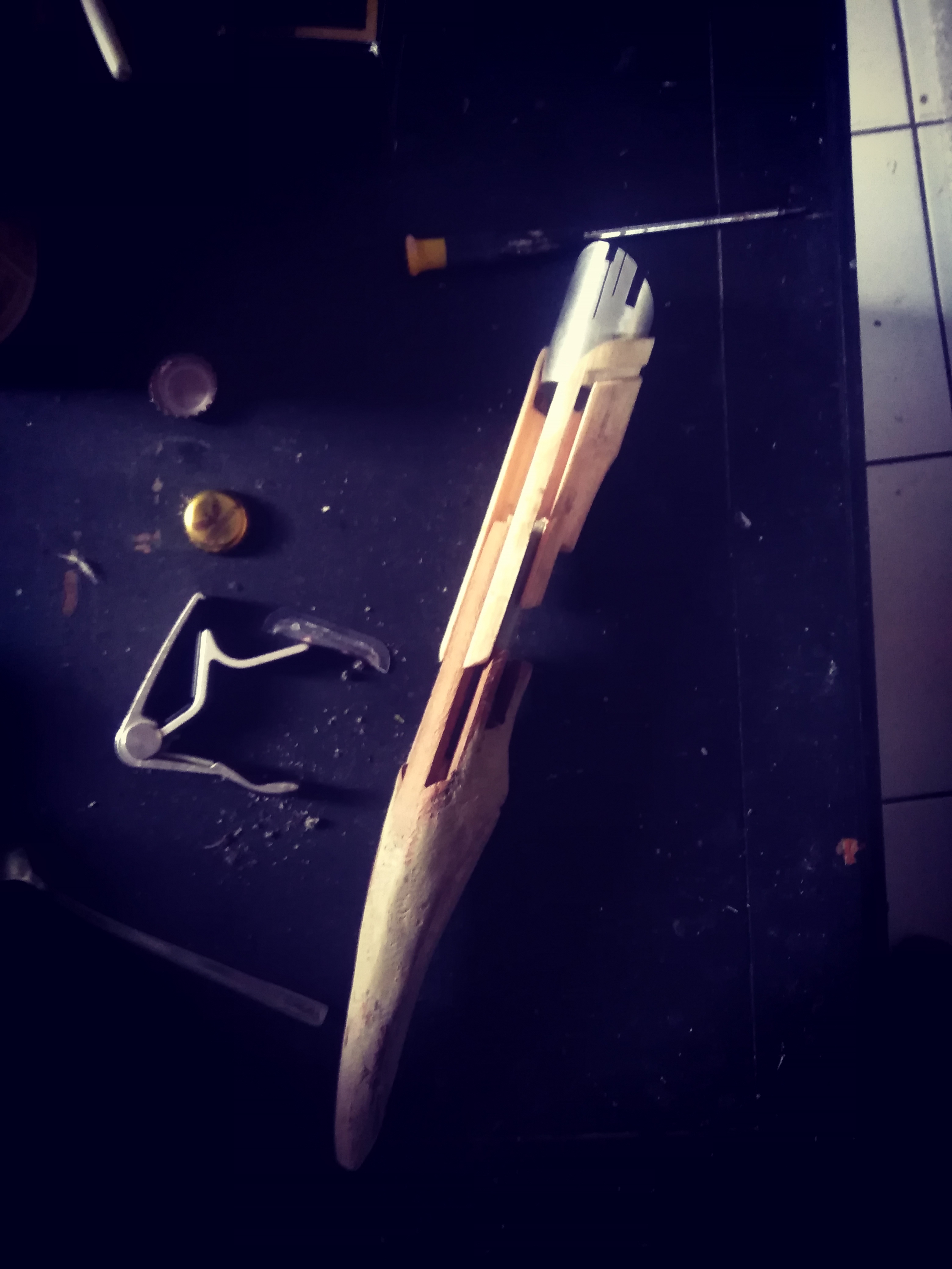

Things are currently very messy but I wanted to share the building steps. I'm currently experimenting a few things with the claw.
I don't want the claw to be nice and smooth, I prefer it to have the same rough texture you can find on real animal claws. I took inspiration on dinosaur claws grainy texture.
Here is the thing. The claw has been roughly sculpted out of layered Mahogany wood with a rasp. A thread rod is inserted to add weight and tighten the assemblage. It's still very rough but I don't want the junction between the two parts to be perfect as it is a technological object mounted on some kind of bone (sorry for the poor quality pics)

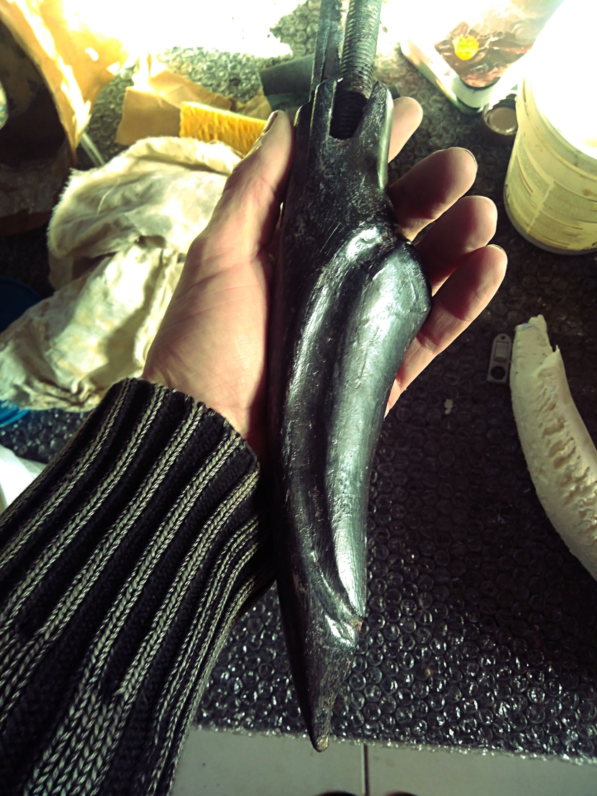

To get the claw texture, I'm currently trying to keep rasp marks on some areas and I have used putty to get a grainy texture on some other areas. That's a try, next step will be to check the result with paint and, maybe, try things differently.

So, I've done a few tries with the claw and it turned out not that far from what I wanted. It's all about keeping flaws, rasp marks and unsanded areas.
I first gave it a black satin basecoat and had to weather it with usual weathering stuffs: dry brush and acrylic paint mixed with water. The trick is it has to look natural, not like a painted object (that's why I hate dry brush, because it always looks like nothing but dry brush)
