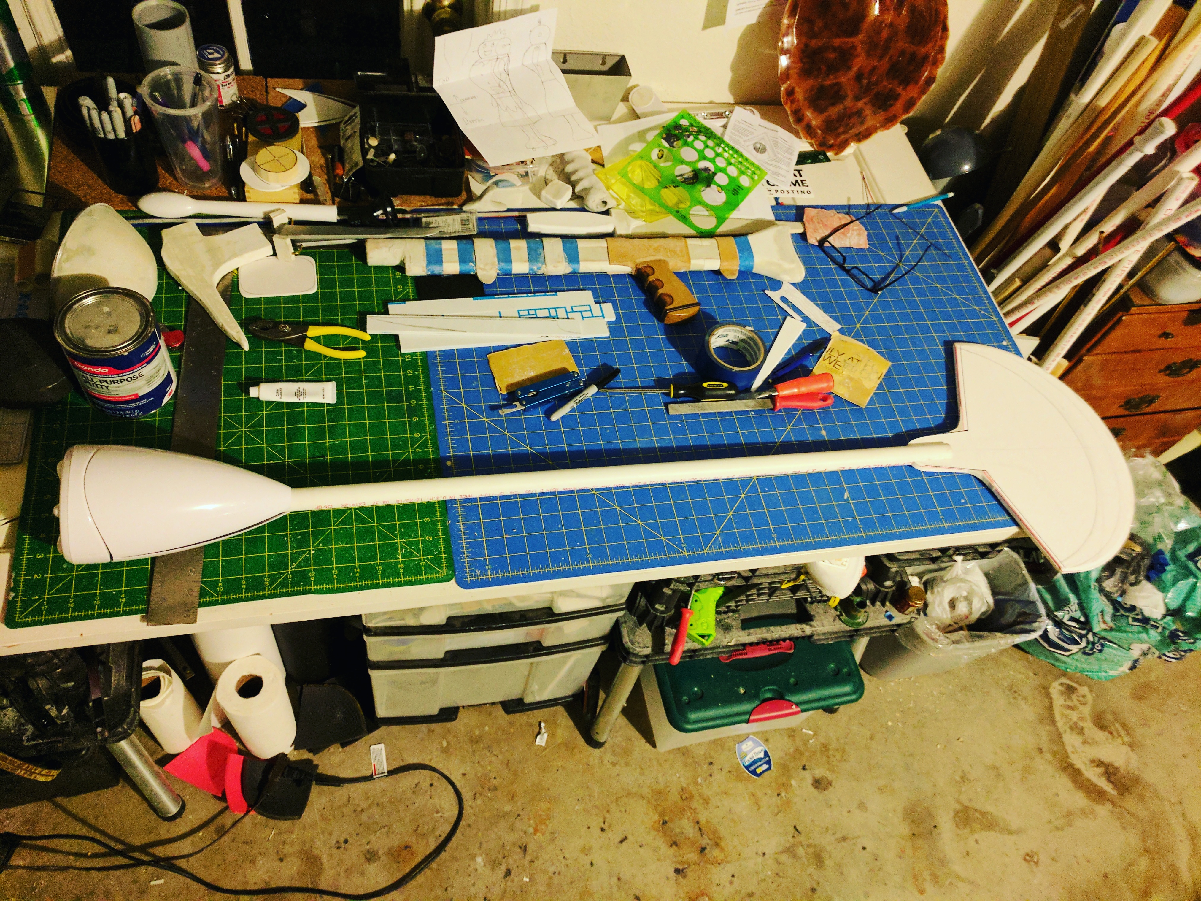

Top photo is the initial mockup (second photo is what it should look like)
Vulcan Lirpa build for WonderCon Anaheim. . in . . .11 days.
Blade = 3 x 1/8" Sintra
Handle = 3/4" PVC
Bottom = OXO brand toilet bowl brush holder

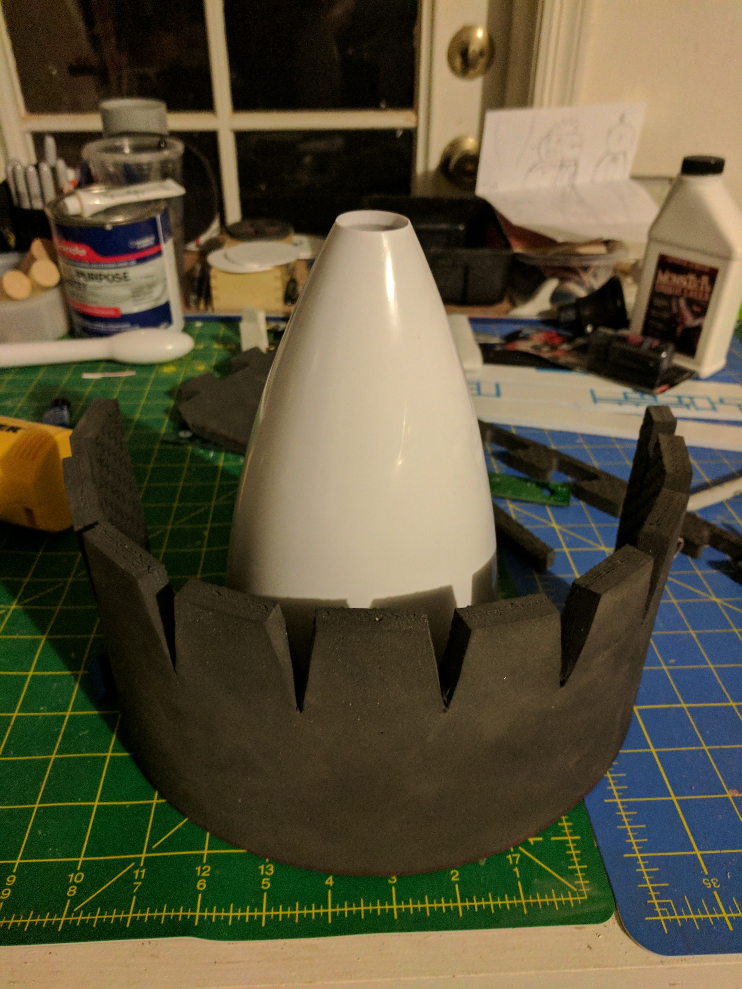

Indeed, the base needs some width, which I will add via EVA foam, wrapped around and tapered at the top, to get the finished shape I will cover with Bondo (bondo-sand-bondo-sand-bondo-sand) until the approximate shape.

Just a few in progress. . .

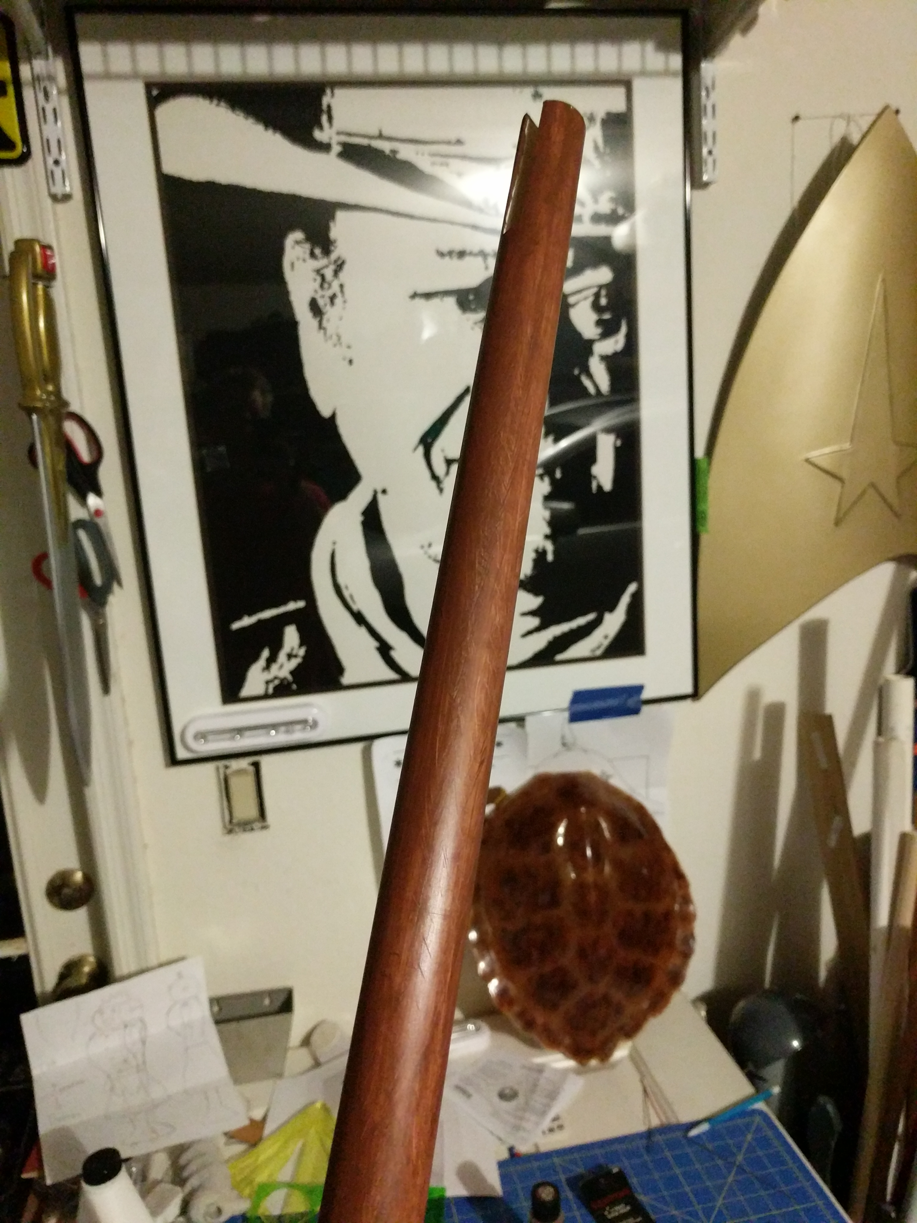

Finished up the distressing and painting of the PVC pipe handle, looks passable at 6 - 10feet (cosplay close photo range). Removed the ink markings and then ran a rasp up and down the pvc pipe, took simple brown acrylic paint ($1.00 at Michaels) and rubbed in with a paper towel. Going to clear coat it for durability.
Cut some EVA and will wrap the base of the toilet bowl brush holder then add some triangles of EVA to get the shape all the way to the top. Then bondo-sand-bondo-sand.
