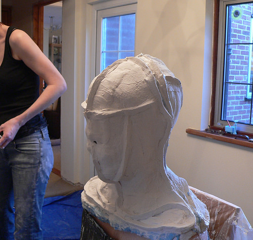

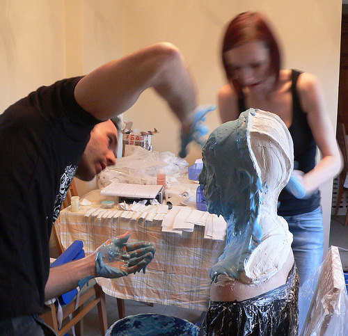

Applying layers of plaster bandages:
Adding support ridges for extra strength:
Applying the alginate:
(Note the thickness of the plaster bandages on the back - you want lots of strength, but try to avoid too much weight on your model)

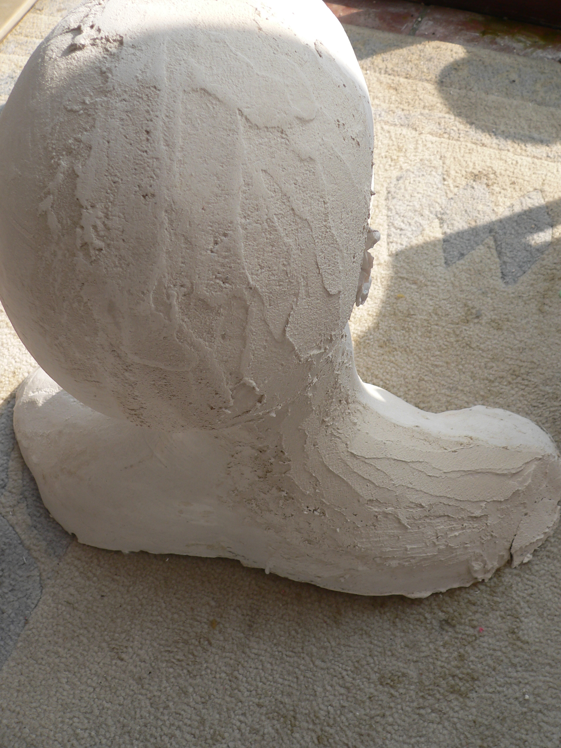

(We did the back just in plaster bandages, but if you do this, be very very careful to add loads of release!!! Plus it can get very very warm)

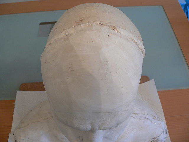

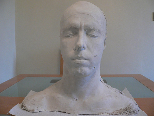

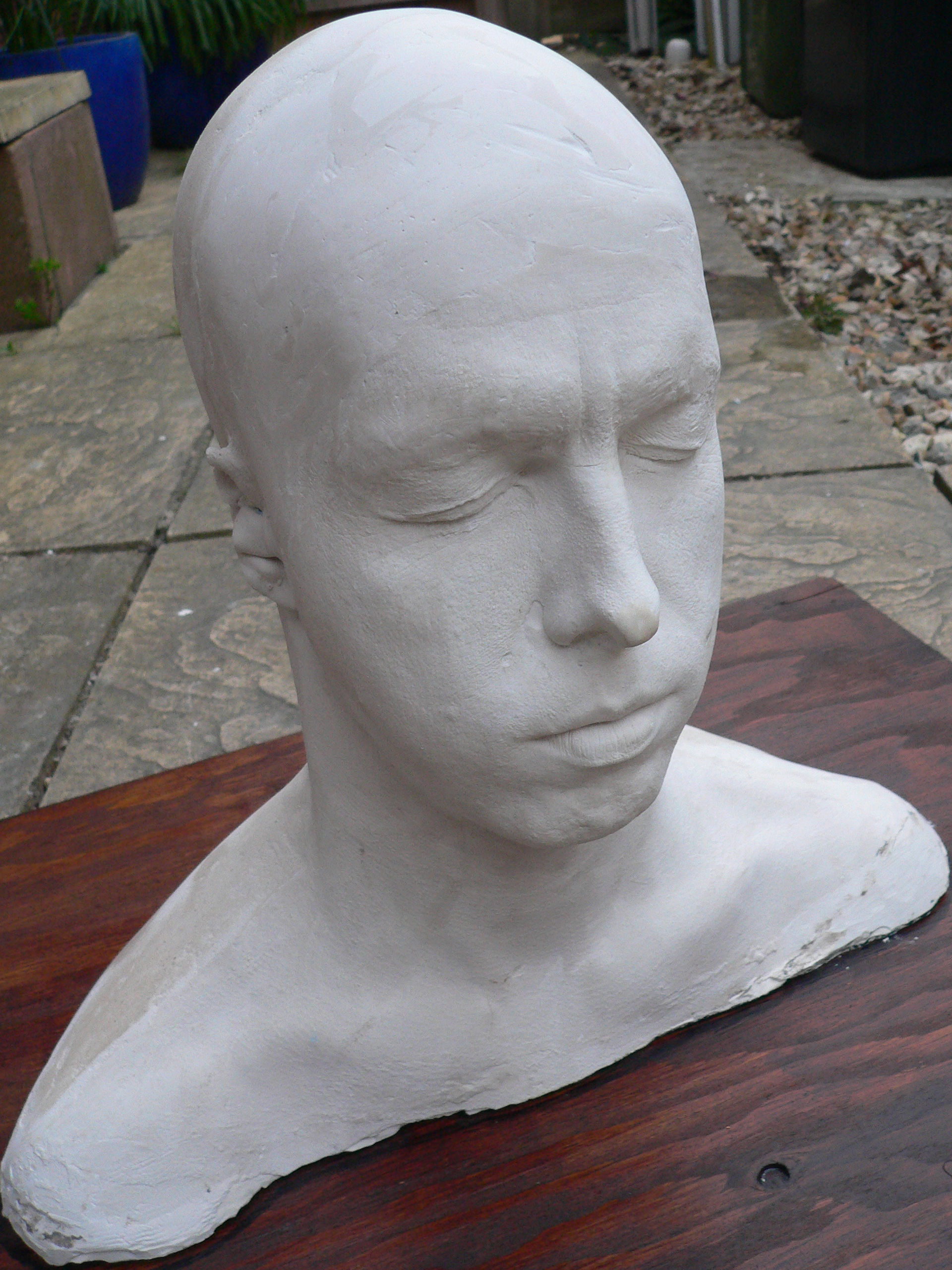

The finished cast (pre-cleanup):
Top down view - it looks like the mould may have shifted, so note for next time - try to make some kind of key's for location.
The definition with Alginate is still really good:
(Although I think I may have something up my nose :lol )

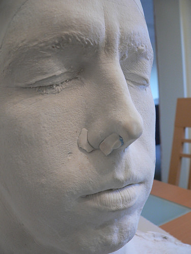

Starting to repair the "step" from the mis-alignment
(Note: I'd run out of casting plaster so had to use some normal household plaster. Tip.... dont!
It worked OK for me as an emergency workaround, but I wouldn't recommend it as it makes life a lot more difficult later due to household plaster being a lot more absorbent)

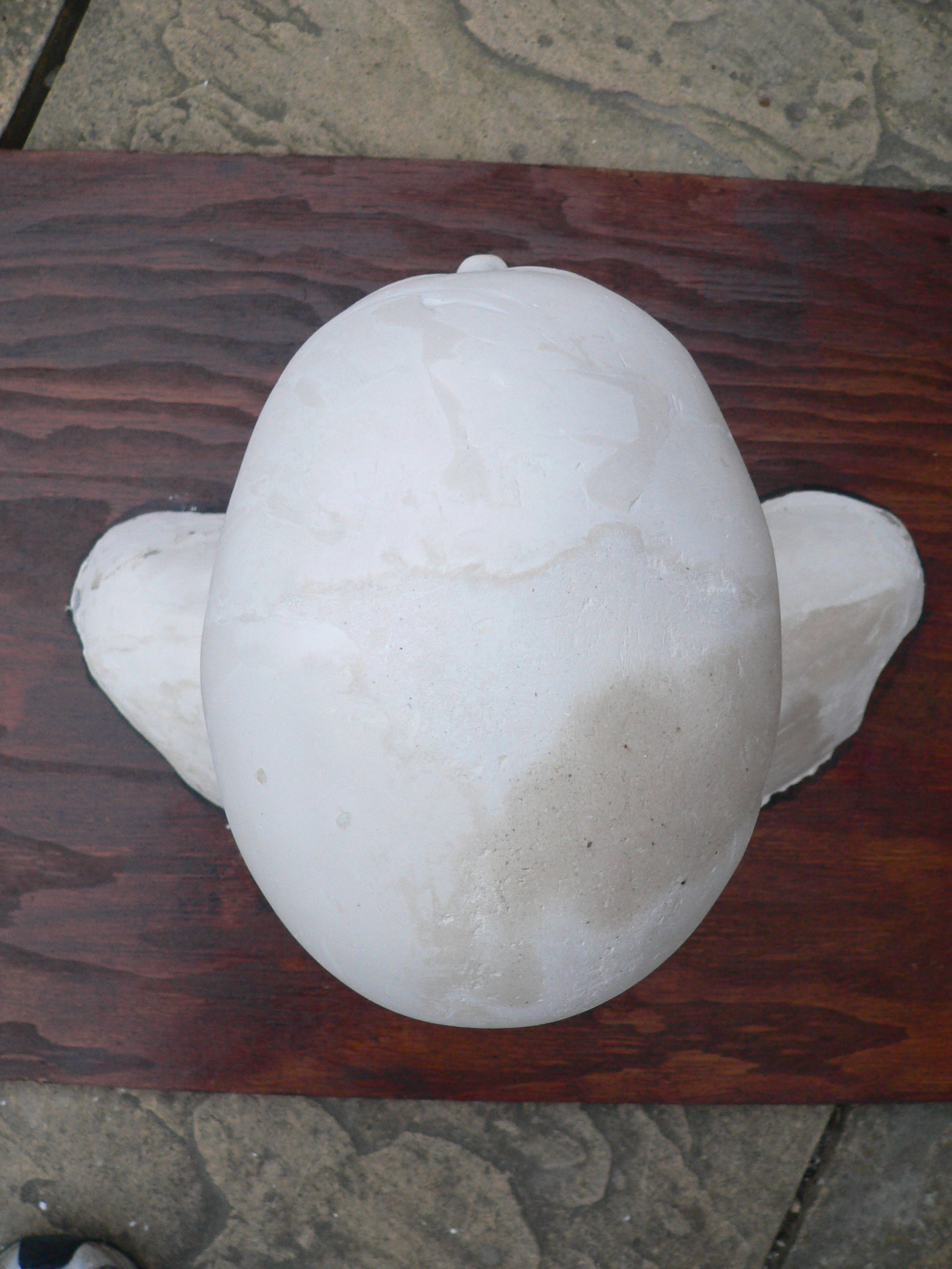

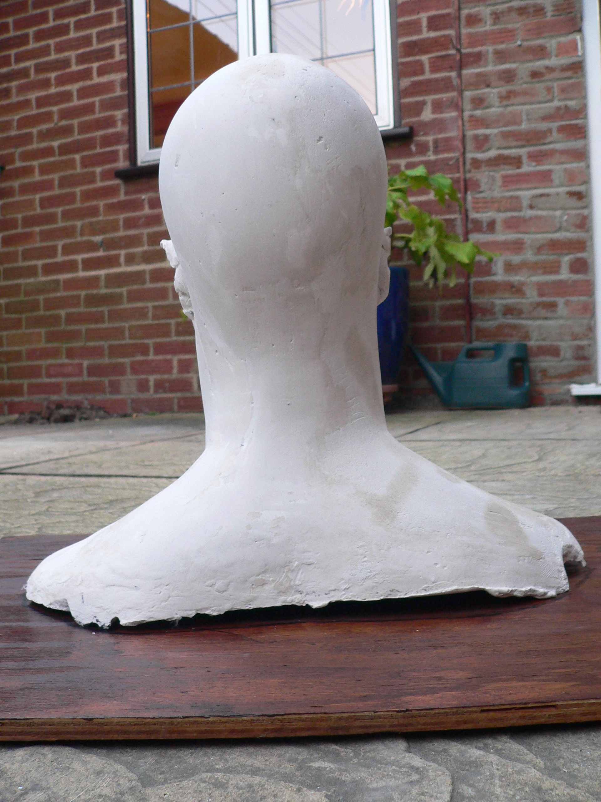

The cleaned up head (front)
Cleaned up head (back)
Cleaned up head (above)

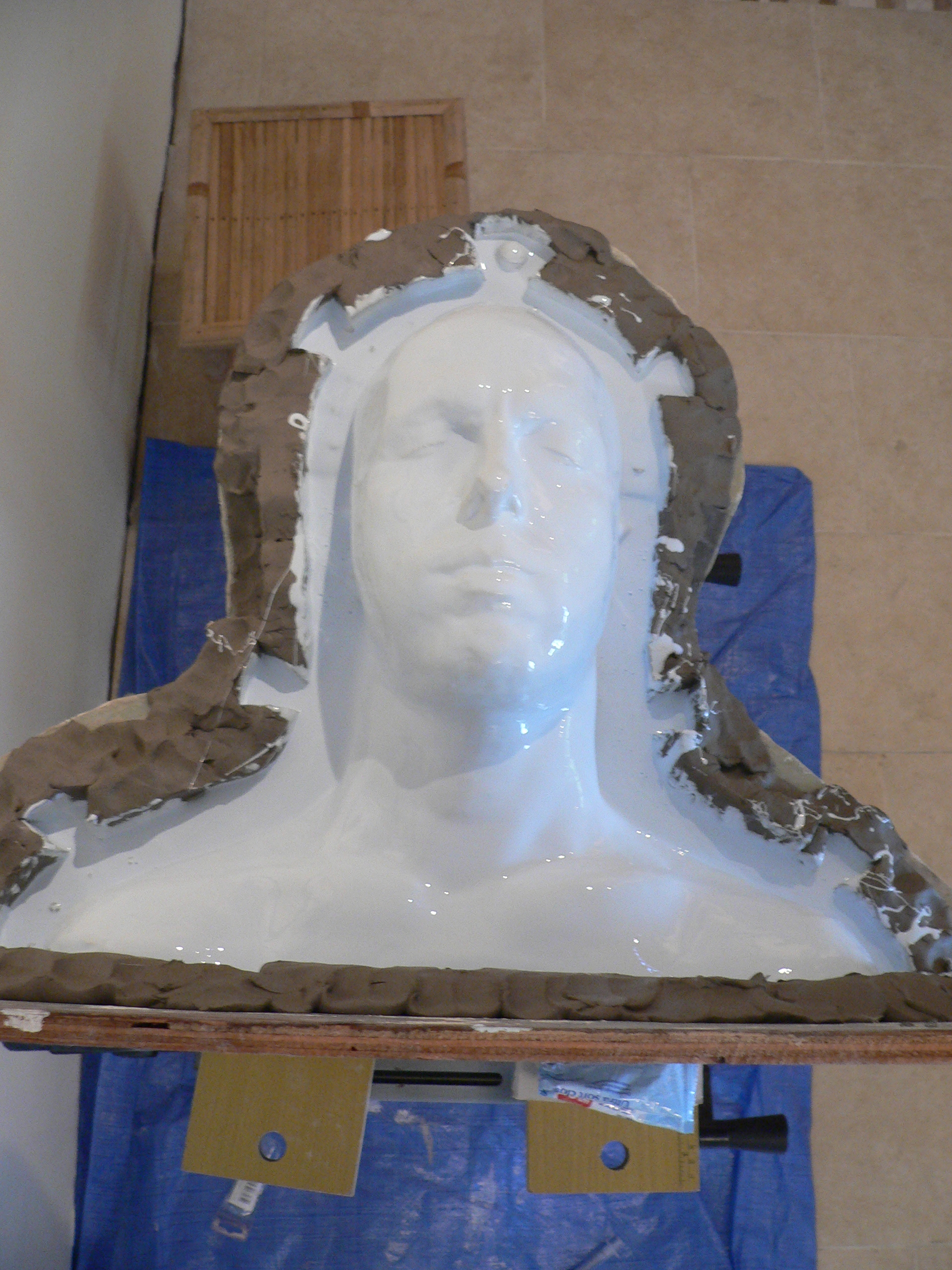

Building the clay wall
Eeeeeeek! :eek
If like me, you can only spend a few hours on this a week, this is what happens if you leave the clay wall for a few days (even covered with damp towels)
The re-done clay wall:

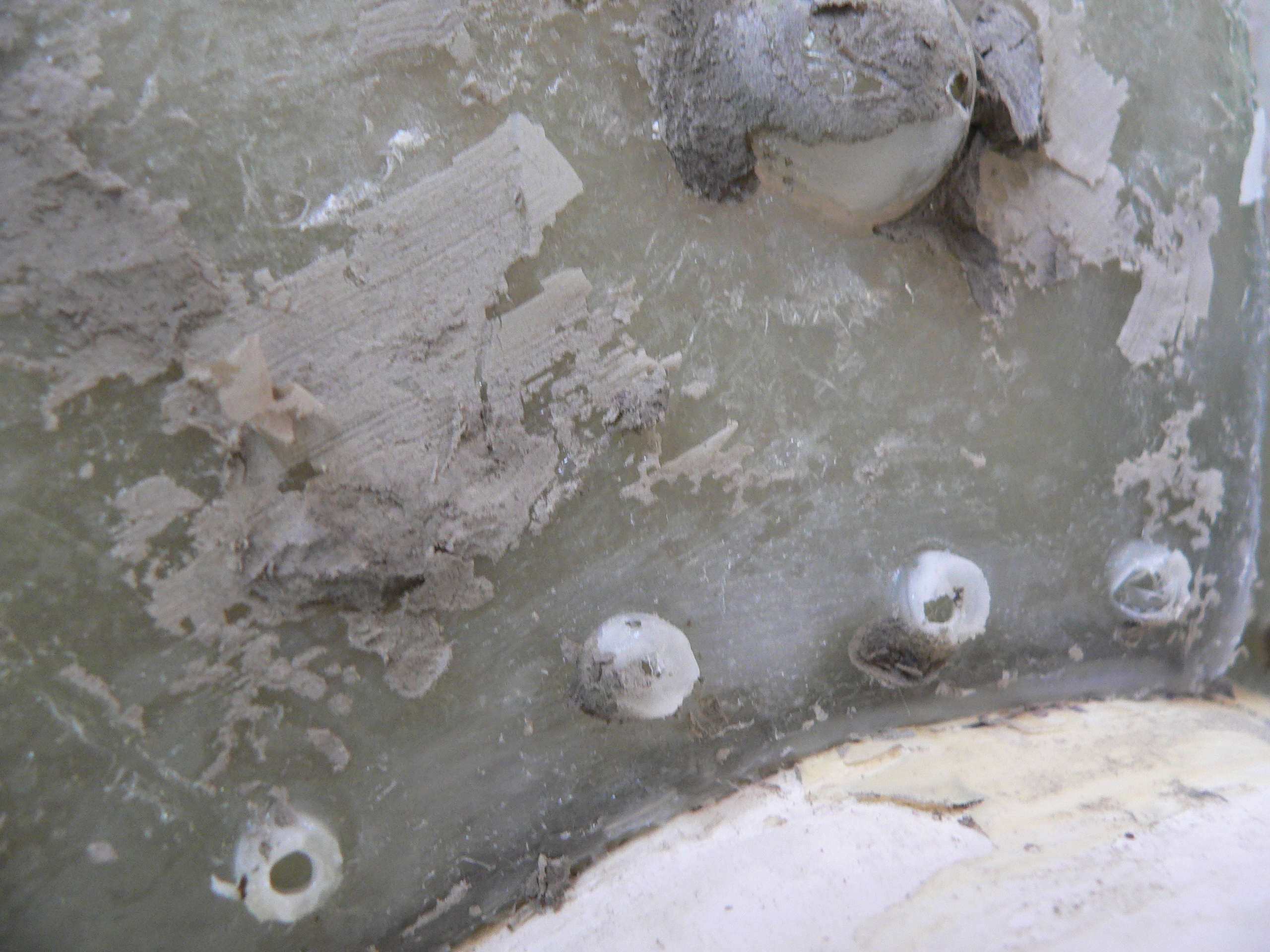

Air bubbles in the gelcoat:
Again, a pic of a mishap - this time, it's the fibreglass not fully supporting the Gelcoat, but in my defense it wasn't for the want of trying. I just couldn't get the bloomin' fibreglass to take hold in each of the keys

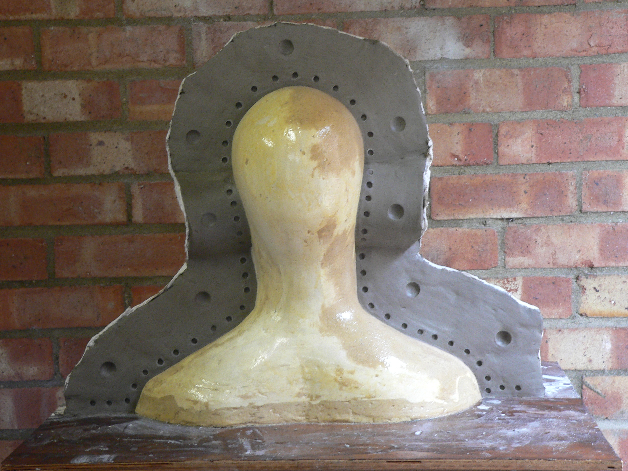

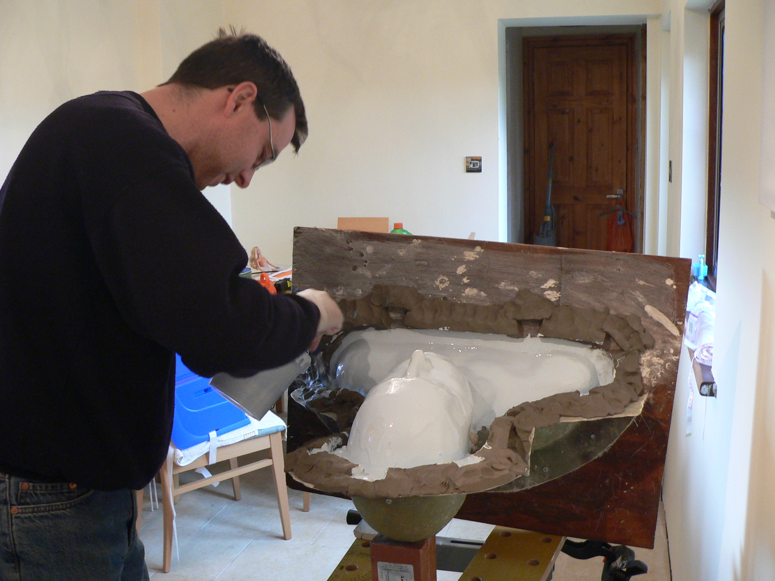

Yeay! I finally get to play with some Silicone!
Here you can see the fibreglass negative on the back of the head, and the supporting clay wall for the silicone on the front
(note the location keys)

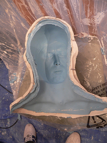

A thicker layer of a different silicone:
3rd Layer (back to using the same as the first layer)

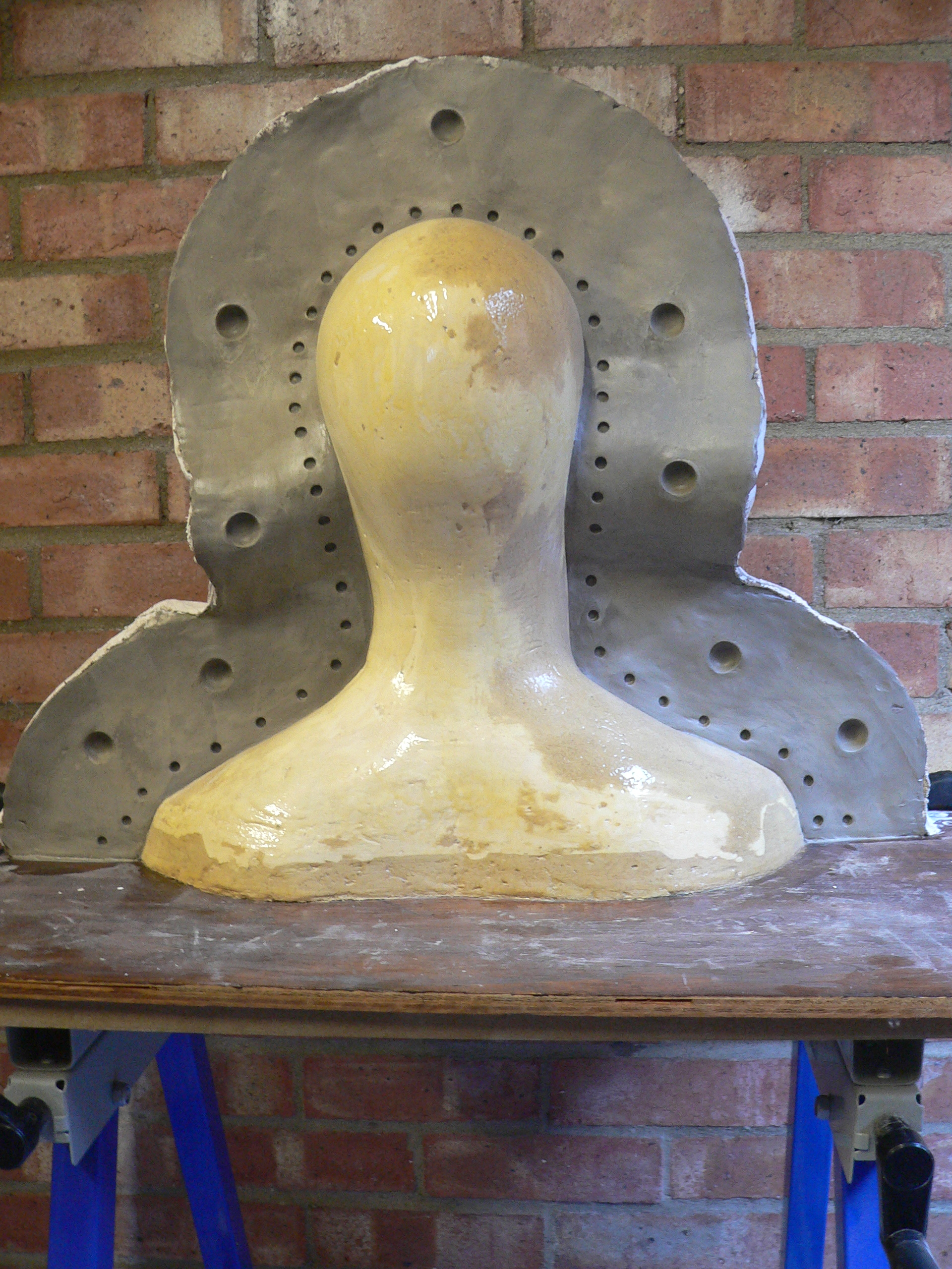

With the clay wall removed, and cleaned up ready to make the fibreglass outer for the front:
The completed negative outer mould (front)
The completed negative outer mould (back)
The completed negative outer mould (side)
On the whole, it came out really well. However, I did get 1 or 2 airbubbles where I just couldn't get the fibreglass matting to stay down

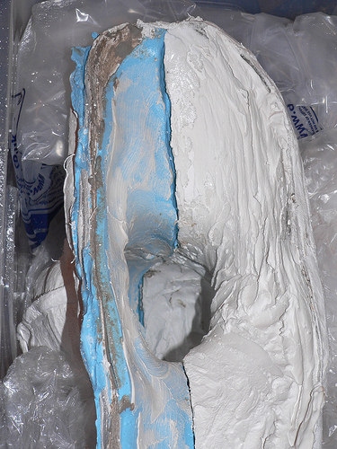

Removing plaster from the back of the negative mould
The cleaned up negative:

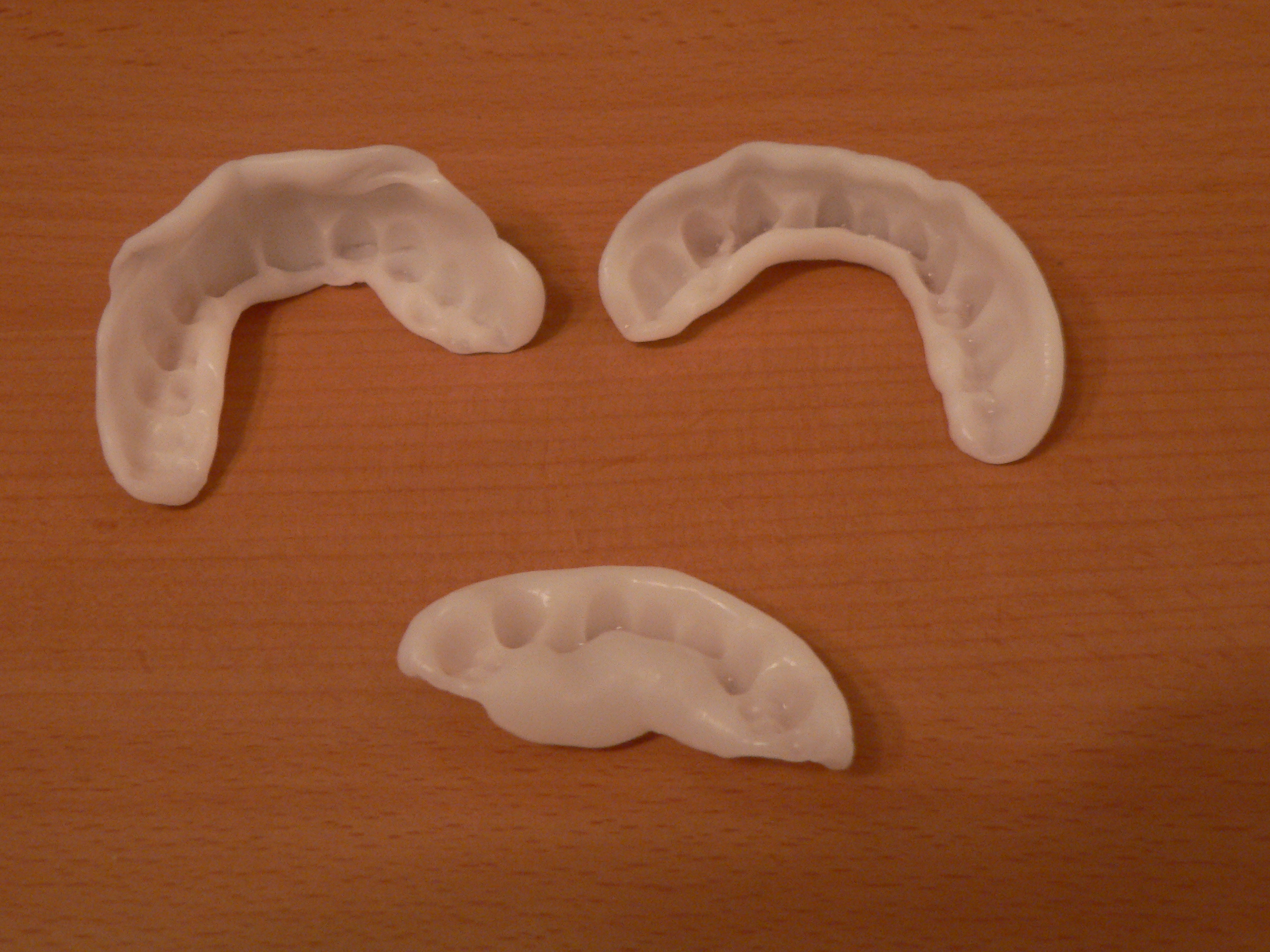

Thermoplastic casts

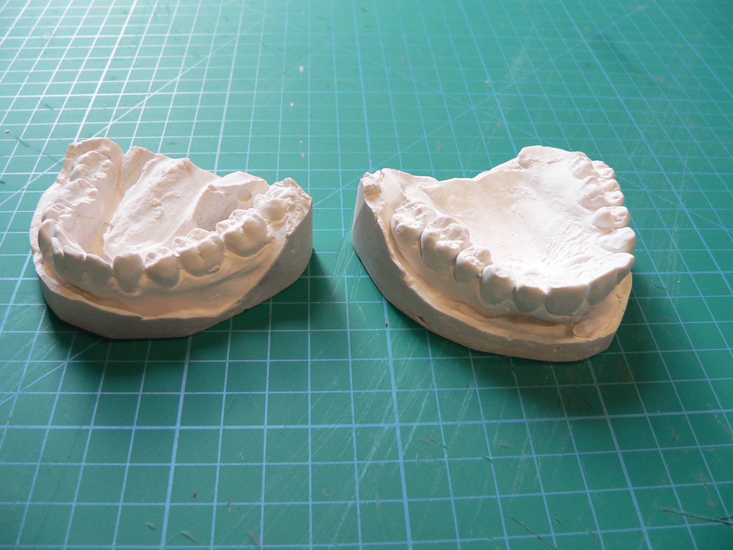

I also got my dentist to do some plaster casts for me too:
A comparison of Voldy's screen teeth and my fake ones (inset)

Applying the baldcap
Applying small bits of plaster bandage around the nose area to begin with

Inside the lifecast
The 2 halves together
Eeeeeeek! :eek

Thermoplastic casts
