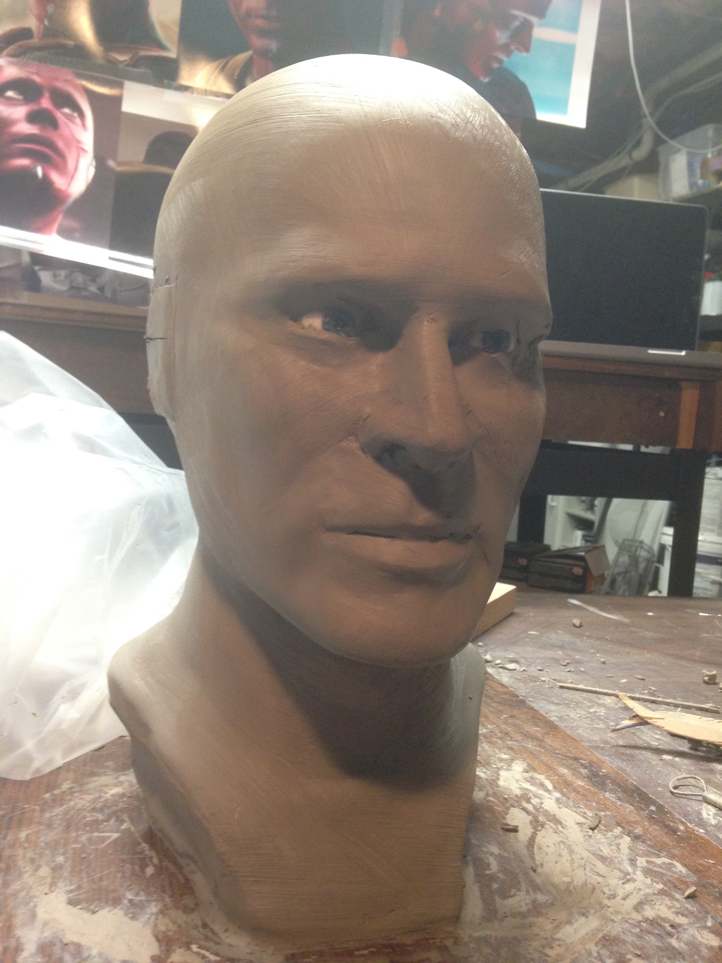

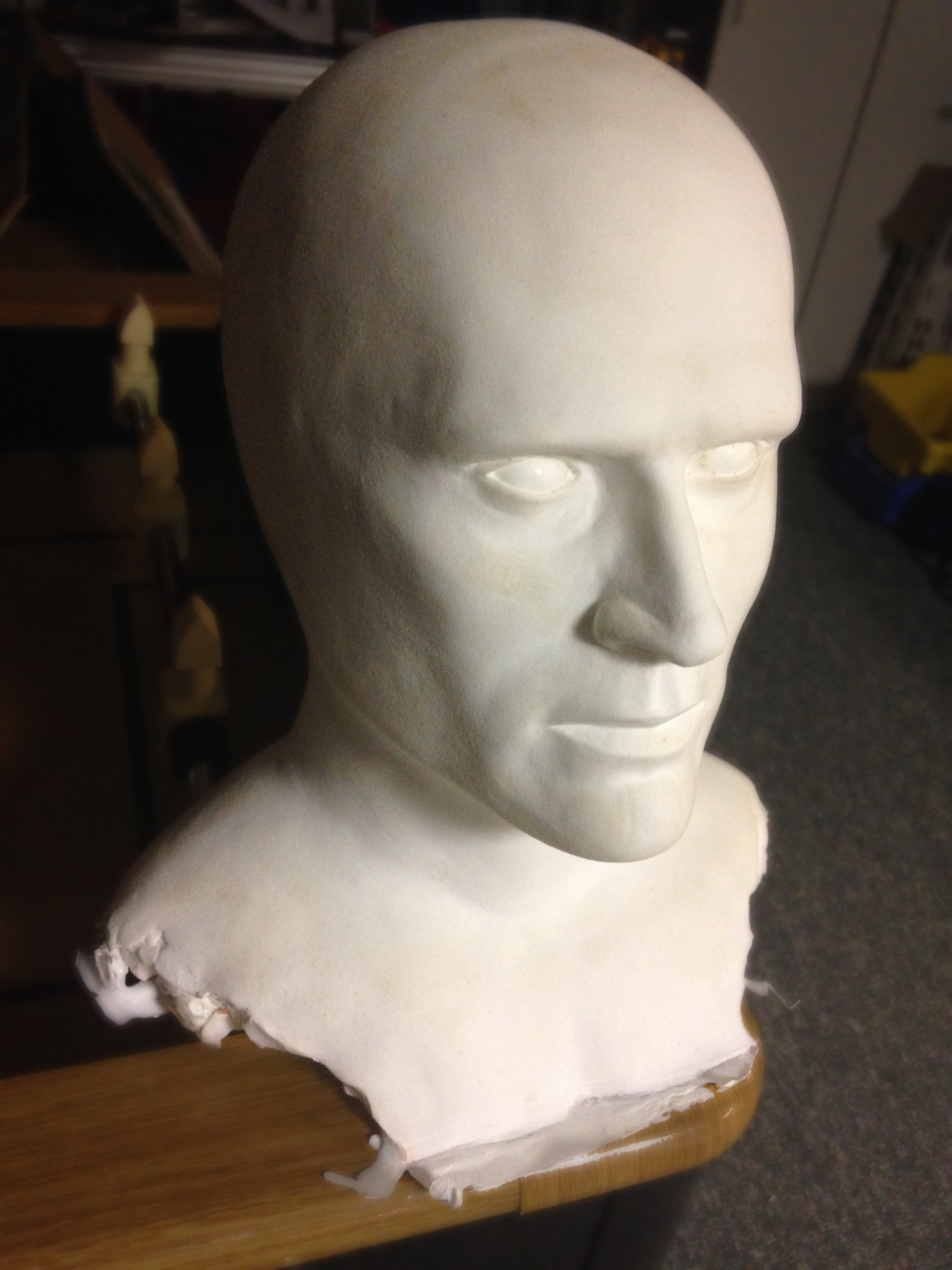

    I'm sculpting Paul Bettany as 'Vision from Avengers: Age of Ultron.
    The plan was to sculpt as much of the sharp details as I could, make a casting and then sand and engrave them to a more polished finish.
    But the more I sculpted the more I realized it would be easier to just sculpt a likeness and then build up the details using hobby store styrene strips.
    This likeness was a challenge to work out because the CG effects work they did on Vision actually shrank the sides of his head in. It also means the shape of his head changes slightly from shot to shot.

  2. imnotahero
    imnotahero Active Member
    Trophy Points:
    412

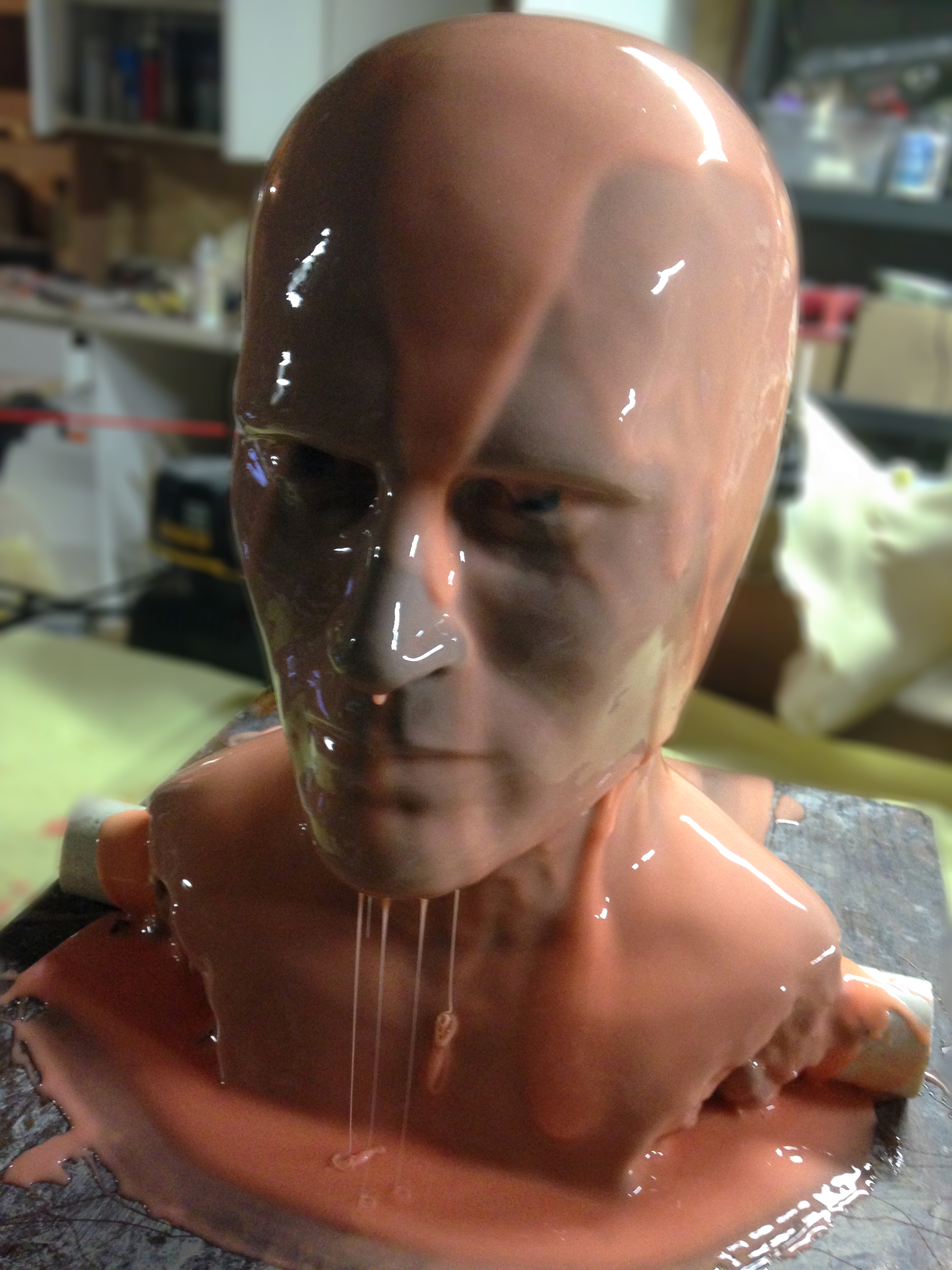

    Made a mold of the WED clay sculpture with Rebound 25.
    Slush cast with Smooth-cast 320.

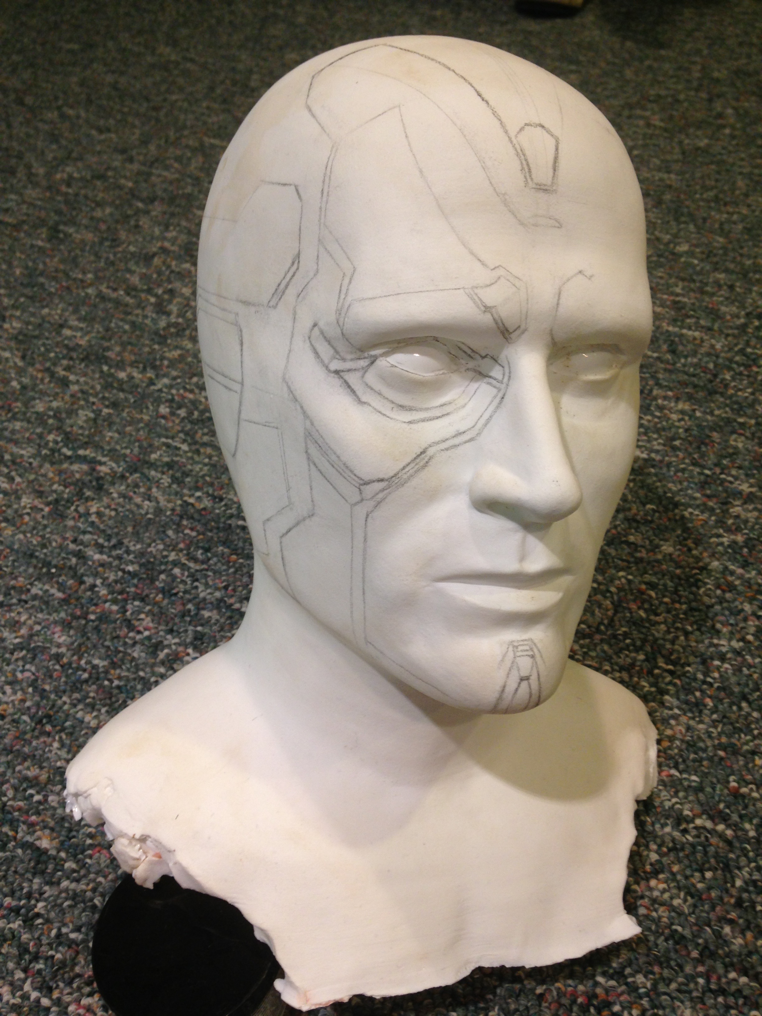

    Began to draw the different sections and panels on the face.

  4. imnotahero
    Trophy Points:
    412

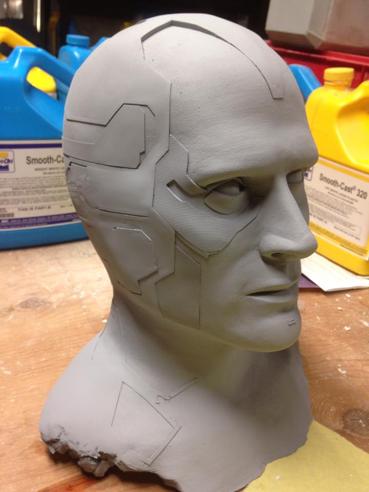

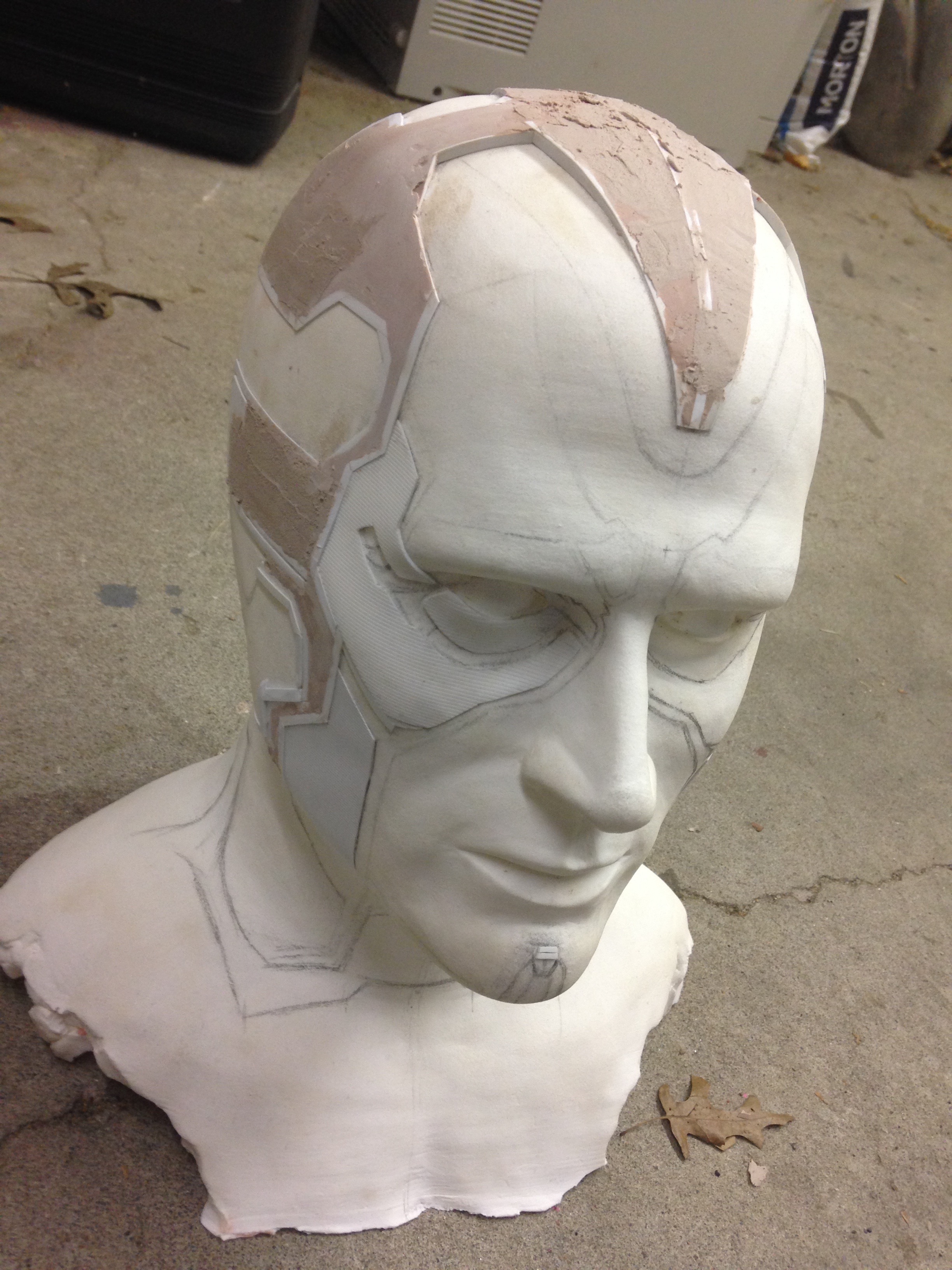

    Some progress I made. Lots of time devoted to drawing and making things straight. I've started gluing on styrene strips to mark the edges of "panels" and then I'm filling the empty spaces with bondo.

  7. imnotahero
    Trophy Points:
    412

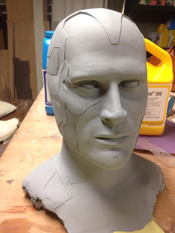

    Small progress, but everything looks cooler with a coat of primer:

  8. pitchforknumb
    pitchforknumb Sr Member RPF PREMIUM MEMBER
    Trophy Points:
    1,016
    This is looking spot on man. What did you use to get that texture on the cheek panels?
  9. imnotahero
    Trophy Points:
    412
    I found a flat piece of styrene with those grooves at a hobby shop. I tried using a heat gun to make it soft so I could press it on the bust, but I had trouble warming the plastic uniformly and keeping it from warping.
    So I took a quick silicone mold off of the grooved styrene and then I cast a very thin layer of Smoothcast resin from that mold. I peeled the resin off the mold after it had turned white but before it became rigid. Then I pressed the sheet of resin onto the bust in place. Then trimmed it to the correct shape.
