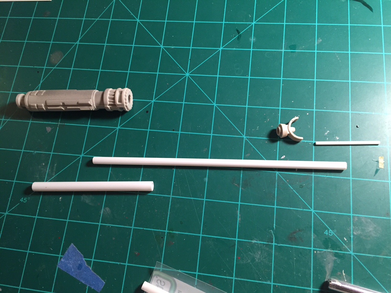

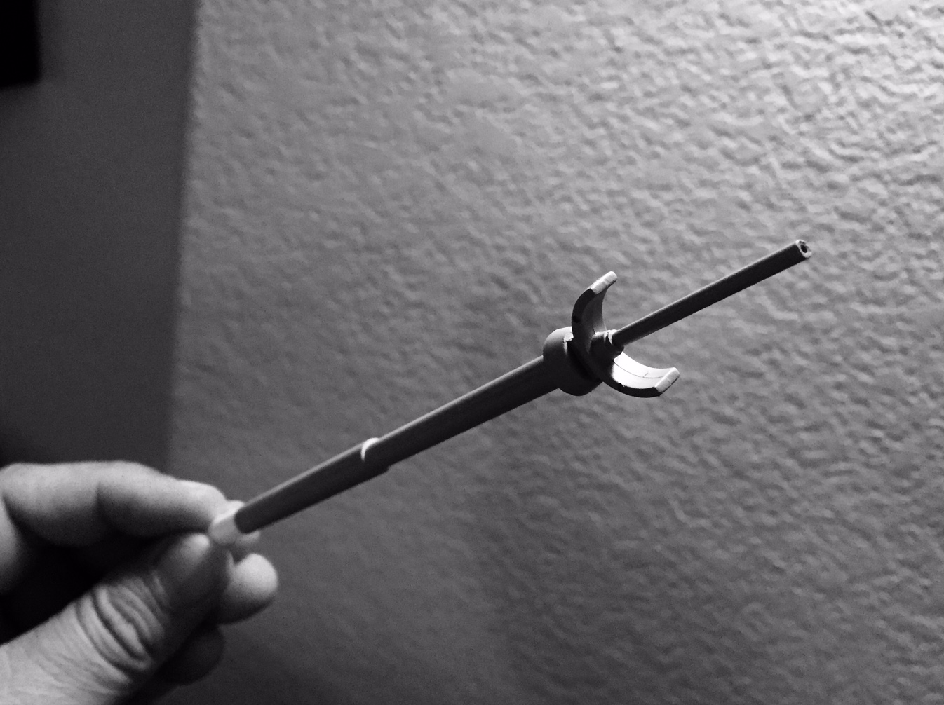

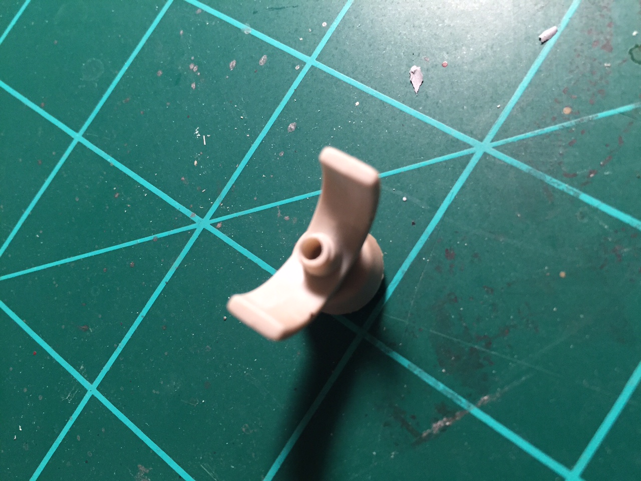

I took the cannon from the toy and decided to keep the little half round part and details and rebuild the barrels out of straight cleaner Styrene tubing.
laid out the matching sized Styrene tubes cut to length.
Drilled out the appropriate sized holes in the "keeper" piece so I could thread the new tubes nice and tight.

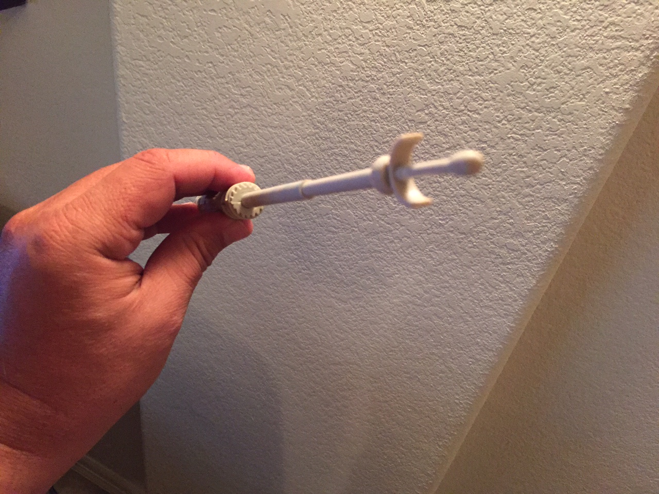

and WALAH!! not 100% accurate but again but WAY better looking for what I want to accomplish with this:)

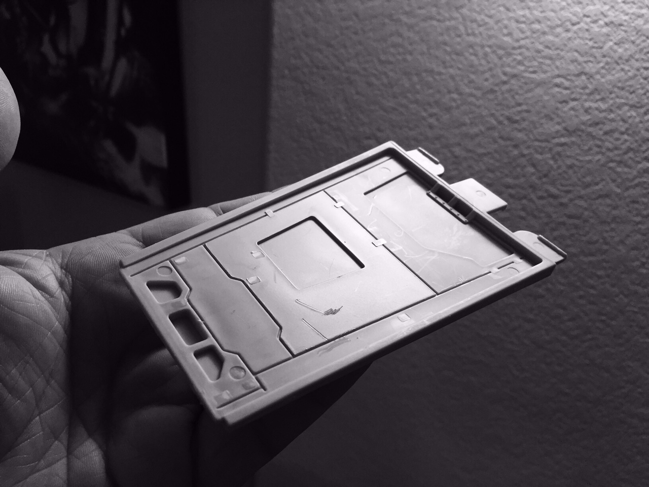

onto the wings!
wow, yeah these are pretty bad, gonna rebuild these best I can.

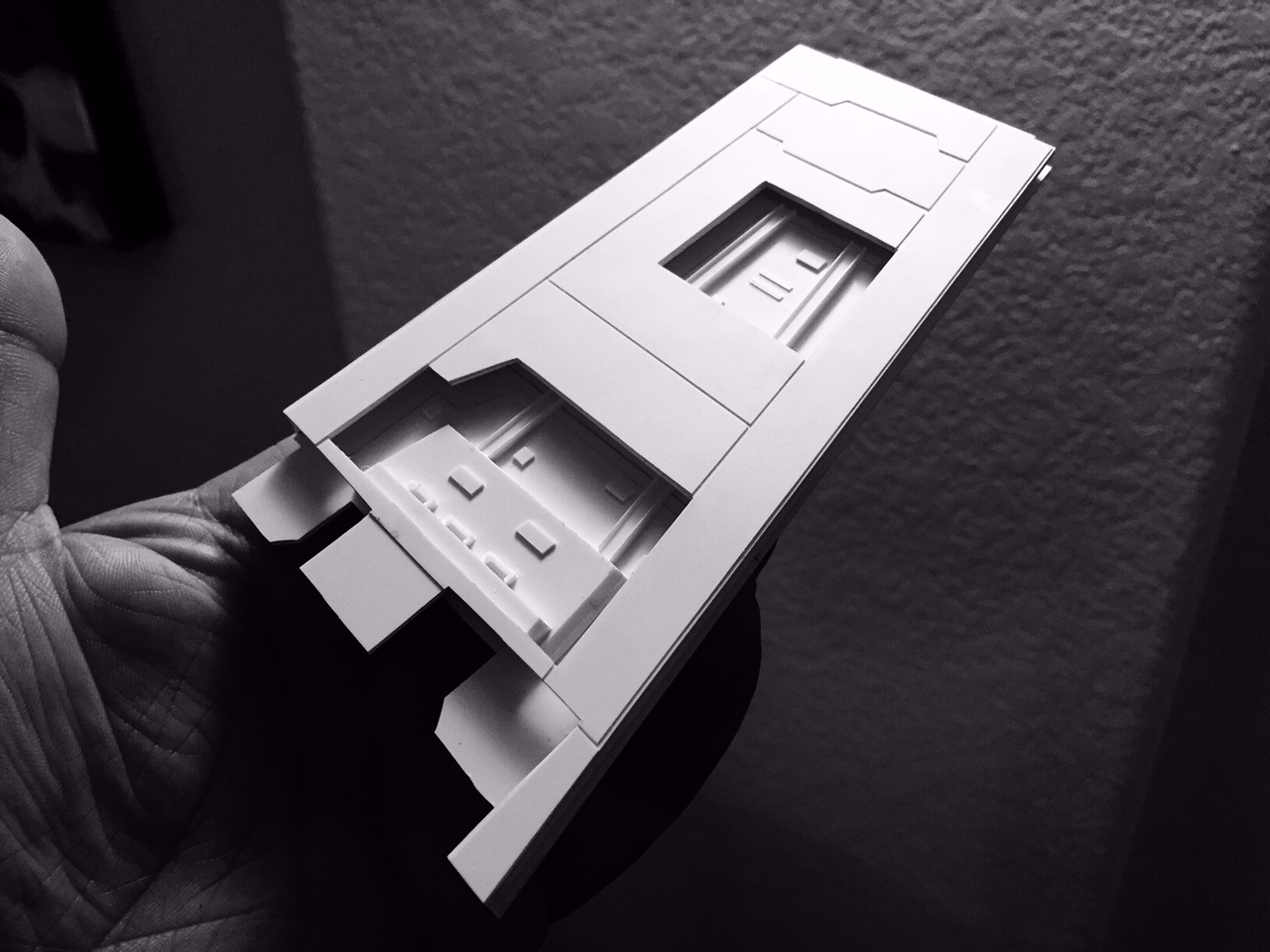

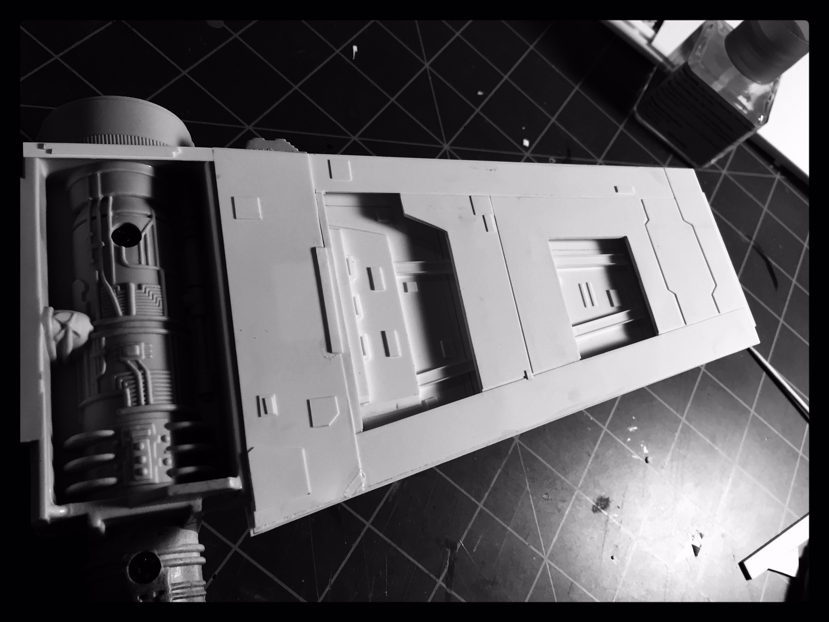

Here are the rebuilt wings, still some little panels and details to add but this is the main wing rebuild!
Top, attached back to the engine pieces

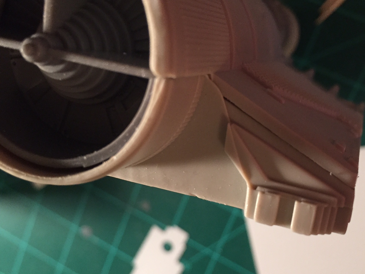

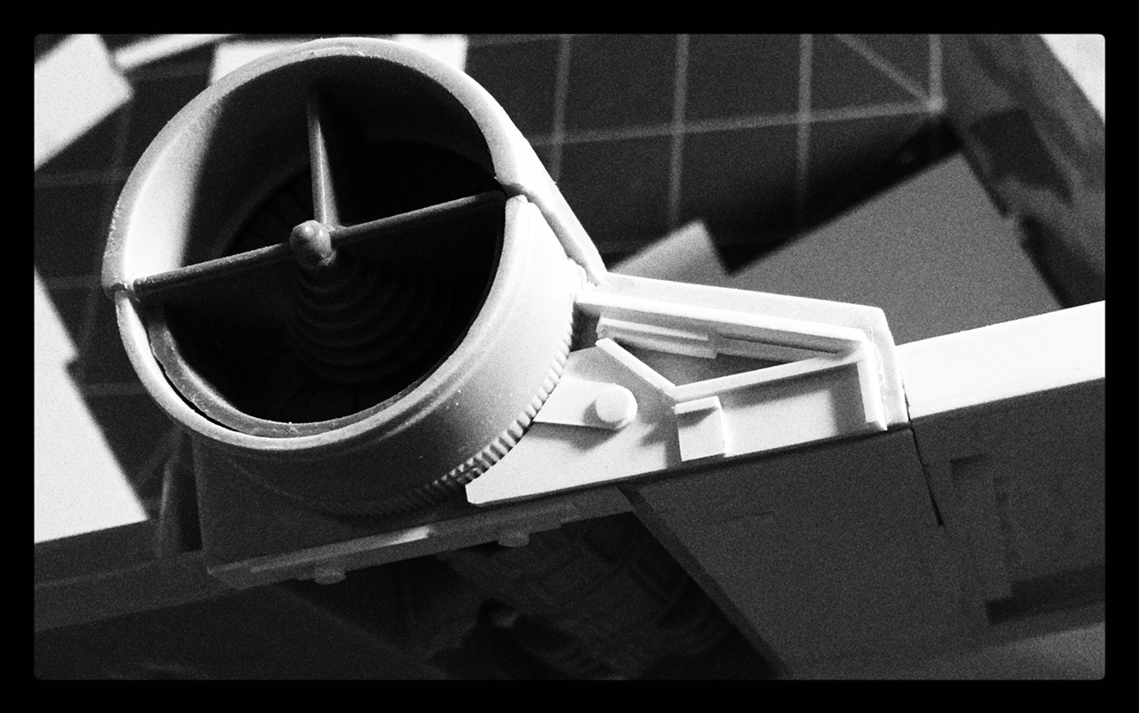

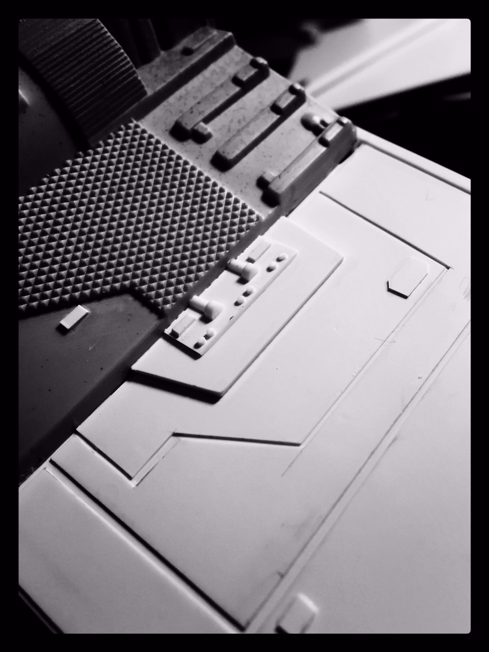

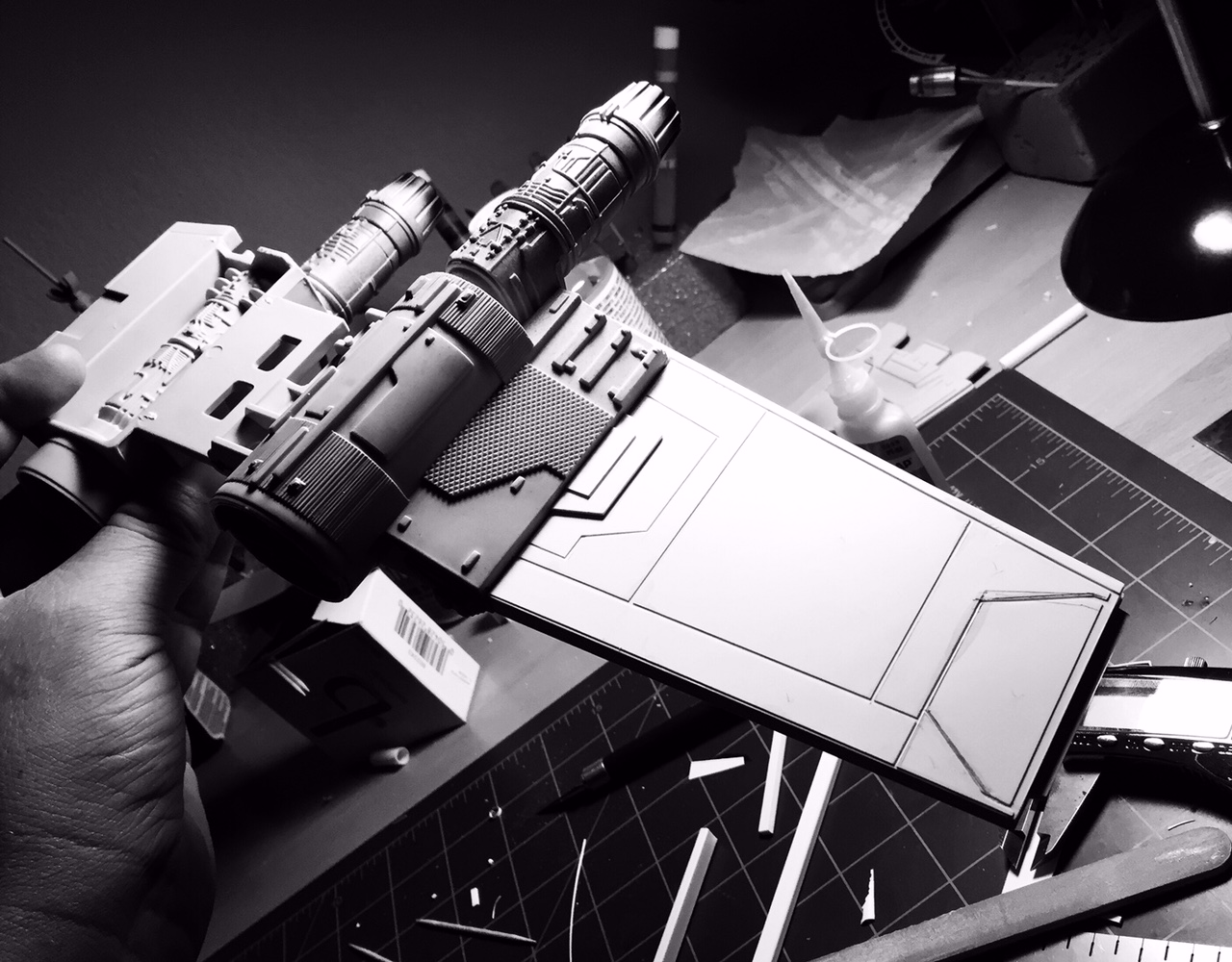

Did some more detail work on the wings, mainly just little panels and some top detail where the wing connects.
hmmm I seem to be doing more to this than I planned on! haha
