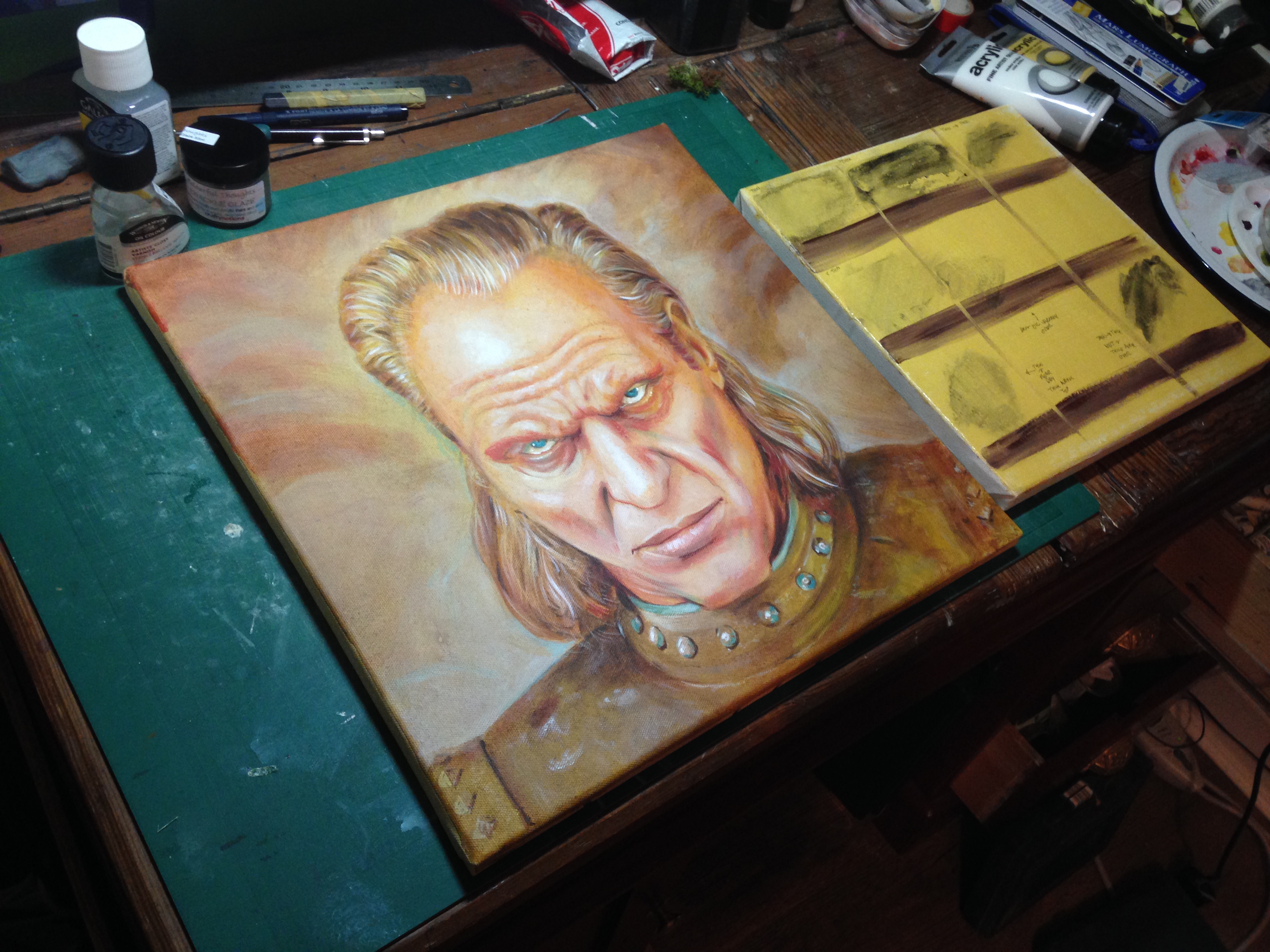

I've been toying with this idea for a while to recreate the painting of Vigo the Carpathian (aka Vigo the Butch). To this end I've been trying some techniques to see how feasible it is:
Anyway, I've hit a bit of a wall with the ageing. I've been looking at creating a cracquelure finish using a glaze but so far I've been unable to achieve the desired results. So far I have tried:
Painting Oil-based varnish over water-based varnish
Crackle Glaze from Fred Aldous:
Painting various types of varnish over this crackle glaze
Multiple coats of glaze​
Drying the glaze naturally and drying under heat.​
But all to no avail. You can see one of my test canvases on the right. I'm currently waiting on delivery of another crackle glaze from the States but in the mean time, I was wondering if anyone has any experience or advice they could offer on creating an appropriate, aged finish on a painting?

Cool!! that is really good painted. I have the full sized painting on my wall

Hah! That's awesome. I'm enjoying researching and painting this project but I gotta say I haven't really thought through where I'd put an eight foot canvas when I'm done :)
Anyway, this was a quick draft to see if I could achieve a reasonable likeness. Now I know it's possible I want to try some different styles for working it up (think it would benefit from a darker ground) but I'm still stuck on the finishing. I've never tried to make a picture look old before and the information on the internet seems to focus on the accurate forging of oil paintings... which might be interesting now I think about it:
1) paint picture on canvas with oils over a soluble intermediate layer
2) when finished, abuse canvas to introduce damage and cracks
3) float painting off canvas
4) apply to antique board (wood from old door or something)
Would have to be smaller than the original but would still be a time consuming process. Might have to wait until the new year.
