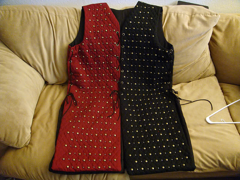

Honestly, I think her jacket is just a quilted gambeson (as seen below), made into a short jacket, with small studs or such added at the intersection of each pad.
Gambesons were worn under armor like mail and helped offer more protection from weapons as well as getting pinched from armor.
In any case, I'm also a Witcher fan and can't wait to see this through.
It could be that. But I prefer to think the rivets have a function like they do here.
Also the bulkiness of her sleeves, and the way they are attached by a strap at the top of her shoulders (probably able to separate from the vest, since you can see they are not connected at the seam and other references show red string ties there), makes me think it could be armor plated. With the bonus of not having to sew them to the armhole.
