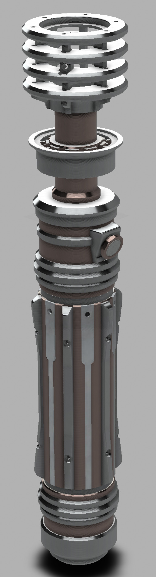

I have made sufficient progress to start putting feelers out to gauge interest in a hilt run for this saber.
many thanks to Valor for getting us a good and healthy start.
having procured Valor's initial model, I have been studiously making adjustments and converting the model to a machinable set of structures for an FX based saber run.
In the same vein as the "MoM of all Heroes" hilt, BRRogers and I are teaming up with Lewis (Malaki Skywalker) from 7 Chambers to look at producing this hilt.
based on a rough cut the internal cavity would be 1.15" for most of the cavity for electronics components (and incidentally chassis modules exist at this size). These are all subject to change however as we continue design.
we would be looking to machine this from 7075 just like the "MoM of All Heroes" and we would be adding the coppery accents using natural copper and a limited set with that copper rose gold plated. Based on our research it also appears that the flatter parts of the grip fins that are not ridged actually look to be pearl like iridescent and as such we're looking at doing mother of pearl inlay for these pieces. This all supports the saber of a princess and royalty.
more details to follow as we work out design and logistics and timing.
caveat: we know some other are also racing to produce this design, so this will be a competitive market however we think with the precious material elements as well as BRRogers' and my obsession for detail, we think we will have a compelling offering.

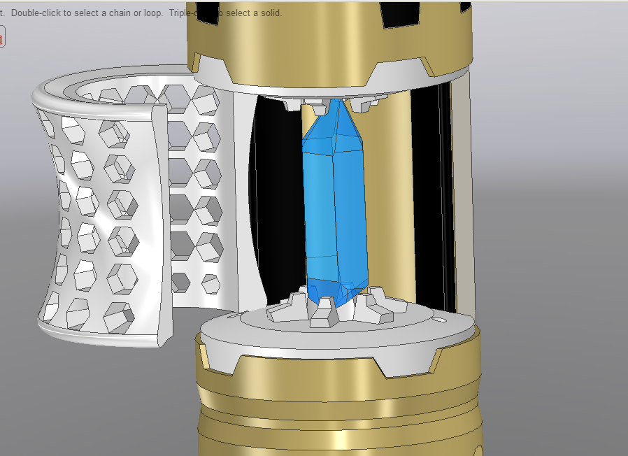

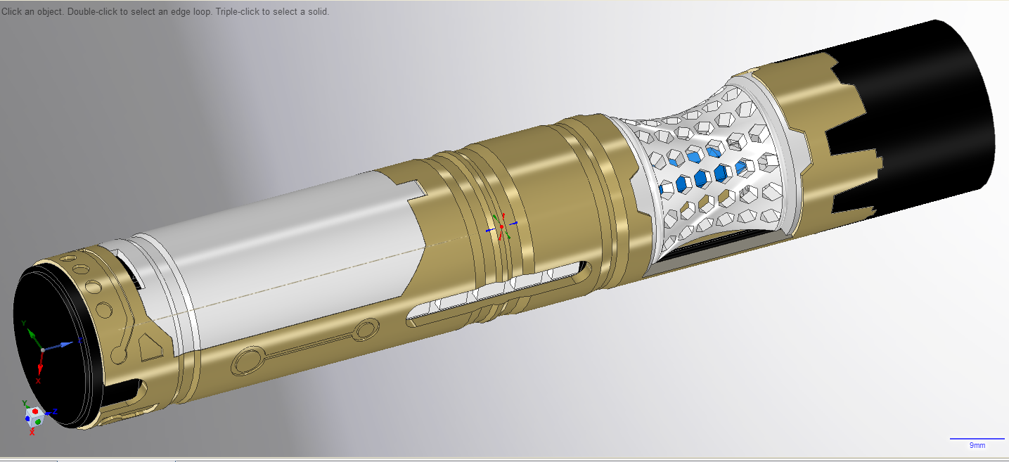

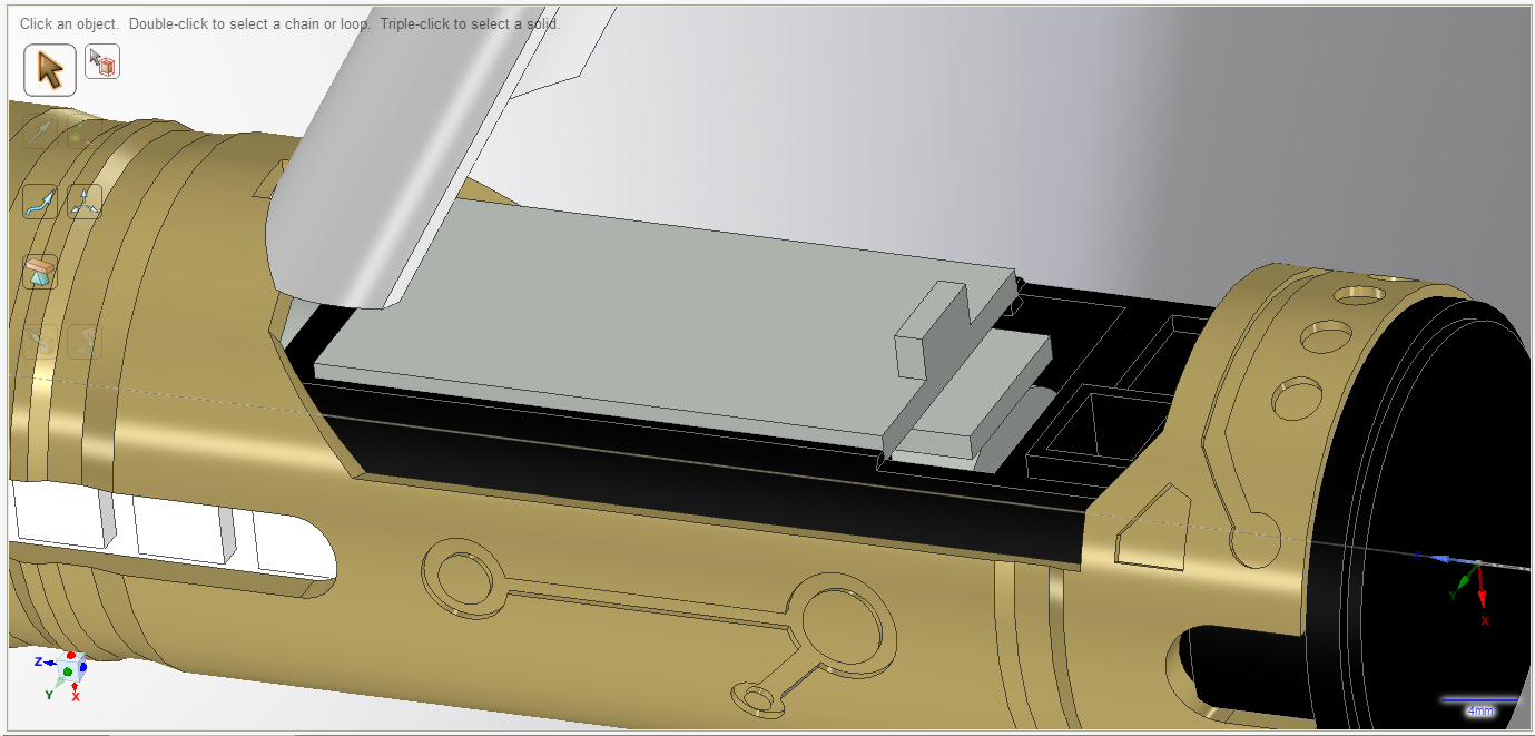

Like Verity said I've got a chassis in the works and I hope y'all like it as much as we do!
Still a work in progress and it's going to slow down for a bit, but this is what I've got so far.
Please let me know what you think!
Specs:
Proffie V2,
18650 Keeppower
28mm bass speaker
1.3mm recharge port
high amp kill switch
2 spaces for 5 accent pixels based off trimmed WS2813
2 slots for pixels to illuminate the crystal chamber(one on top, one on the bottom)
View attachment 1289506View attachment 1289507
My goal is to have the cage surrounding the crystal swivel to reveal it but I can't guarantee it atm so the CC might change.
