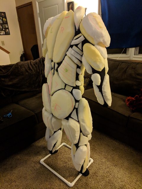

The start of adding on chunks of foam in vaguely muscle-like shapes. This is the earliest and roughest stage. I had several reference images up of Venom in the comics, body builders and weight lifting charts to guide me. I used a couple different thicknesses of upholstery foam. My logic was to use a thicker size than I'd *think* I'd need to account for the carving I'd do later.
Roughing in the back muscles. There is a zipper that runs the length of the back that I had to be sure I left space for.
A little more built out, a little more detail but still very rough. You can probably tell it's my first time doing this :whistle:
Same for the back. I struggled a bit with the ass pieces. My Venom's got buns, hun.

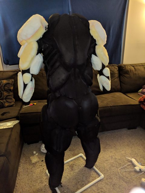

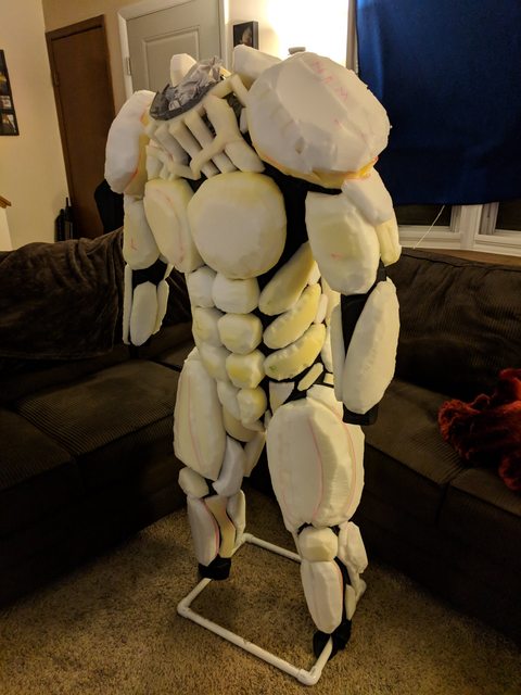

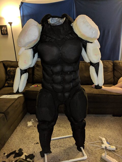

The 2.0 suit, all built out. I refined the placement and sizes, and added in all the details I felt I'd need for the next phase. I basically started with the Pecs and Thighs and built from there. It's sort of like carving a turkey, but the foam has a tendency to chew through blades quickly. I felt much more relaxed doing it the second time, and I was able to reuse many of the pieces so I didn't add much cost. All that holds the pieces to the body suit is regular hot glue.
I wasn't totally happy with the shoulders on this version, but I was happy enough with them that I didn't see the point in starting them over. Are they a bit football-pad like? Yeah. But Venom is this big, roided out dude and well, I'm not. Need everything I can get to make me look big!
And the back. The thin,smaller in-between pieces are important; though they won't be seen directly, they allow an anchor point for the fabric I'd be skinning the suit with before coating it with the UreCoat. If I didn't have those, they material would potentially leak and seep past the outer skin, in between the gaps and then onto the base layer suit, which would not be good!

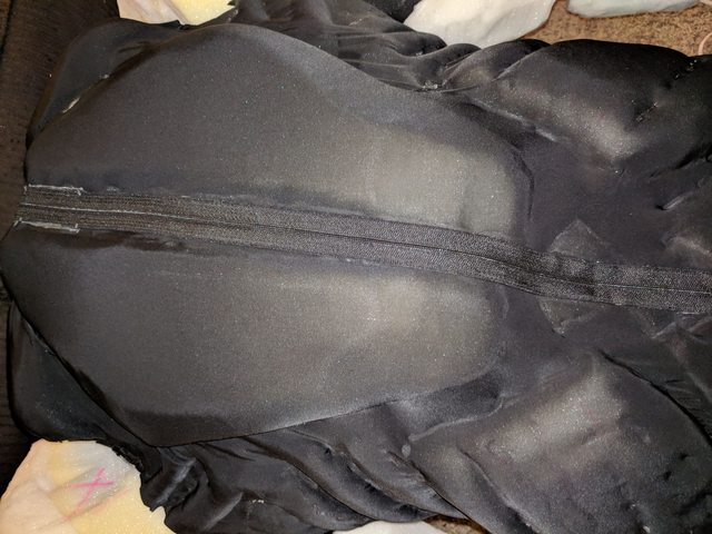

For the back, I purchased a long zipper and simply glued it down the back of the outer skin. What you can't see, is that part of the skin is ONE piece-not two. So, at this stage, if I opened the zipper it would just be a single piece underneath with no separation. I would cut the line later, after it was coated with rubber. I did this because I wanted to ensure the zipper was bonded to the fabric tight, since I could not sew it into the fabric and foam. It was a risky gamble, but it worked in the end. In hindsight, I should have opted for a longer zipper to make getting in and out easier. Oh well!

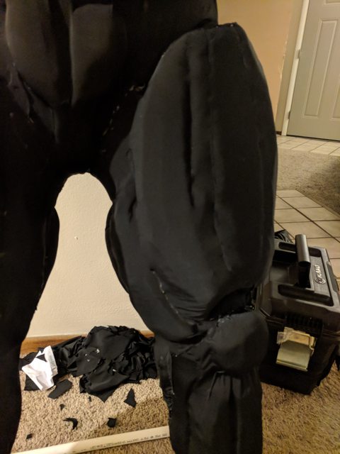

Here is a close up of the knee and thigh. I purposefully cut recesses and slats into some areas of the muscles to allow me to "tuck" the outer skin into with a bead of glue. This gives the muscle more depth and the appearance of variations in the fibers when moving around. In hindsight, I could have added more of these to get the look I was thinking in my head, but live and learn.

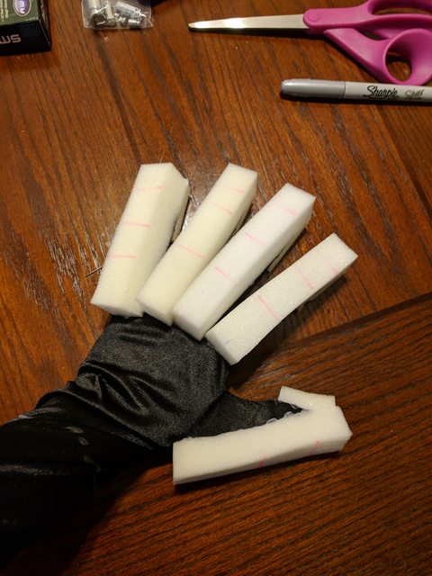

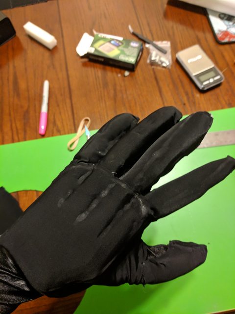

Ahh the hands. I wouldn't look right to have this big chonky body and then little girl hands like I do in real life. So, I followed a similar process as I did on the body suit. Venom is big, and has big hands. Boy I was all thumbs on this part. So, while WEARING the glove (and I'm only right handed, so it was hard as hell to do my right with my left) I glued on big strips and carved them up. I think my idea was in the right place, but my execution was a bit off.
I didn't add any to the palms because I didn't see a point. This at least allows me to kinda, sort be able to hold some things. I added some bulk to the tips to round out the illusion.
After they were carved. You can see some of the recesses if you look for them, where I tried to give detail or aid with movement. They didn't work. The urecoat does not stretch. It will bend, it will compress, but it will not pull like your skin or silicone. So, my hands had very limited movement. To correct this for next time, I'll try to not coat the joint areas (knuckles, elbows etc, arm pits). That way, I can bend.
Ahh that's much better. Still bulky, but passable. I thought I did well here, as when I'd test them I could bend my fingers and hold like a cup and stuff. That would later prove to be a lie when I put the rubber on. No bending for me!

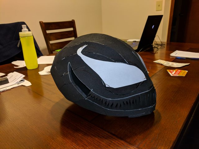

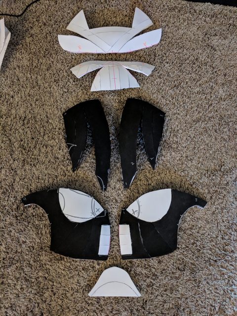

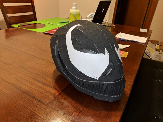

Here is the point I started really working on the mask. The design I had in my head, I wanted the mask to be removable so if I wanted to walk around without it on, I'd still look "in character". If I had more money and infinite time, I'd have attempted something like a true silicone mask that would move the jaw when I talked and stuff, but that wasn't an option. So I leaned towards making it more like a helmet. I found a SpiderMan face shell template online, scaled it a couple times to get a fit on me (trial and error). That is the Black foam you see above. I then converted that into a full helmet by manually adding in hand drawn templates, which is the white foam.
Once tested that the scale was right and it fit me as close as it could, I then cut the helmet into pieces you see above and then update my templates. I took those new templates, and cranked out two additional masks. Because I was in uncharted territory, I wanted to a have a practice mask in the event I messed something up, but I wanted to play it cautiously so I could potentially make two different face styles. So I made one more mask for a total of 3 :p
By this point I started trying out different styles for the eyes. Venom has very distinct eyes. I was really happy with how he was looking in the movie trailers so I used those and some stills from the comics as my guide. I tried several different styles until I settled on two that I liked best- the one above is what I call the more cartoon like of the set- like you might see in Ultimate SpiderMan cartoon. The other set I wanted to look closer to the comics, like Mcfarland or Bagley. I spent a lot of time here, making small changes to the details and trying different styles. So many choices!!
With the eyes settled, I moved onto roughing out the jaw. Normally I would have agonized over ever single little tooth, but I did different this time and just went with the flow and drew them in super loosely. I wasn't going to sculpt them (no time) and so they would have to be foam. Foam can be cut once, so i was careful to give a little more space than I thought i need so i could carve them a bit if needed.

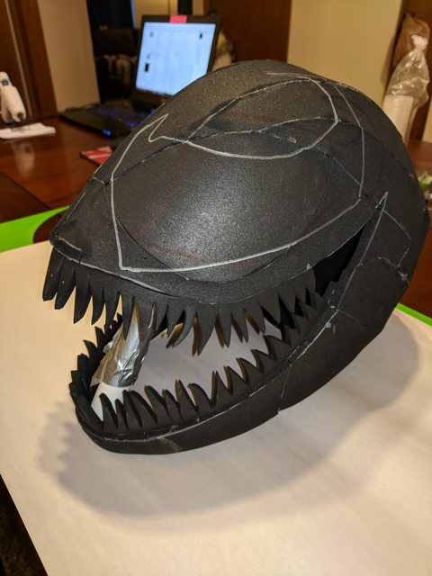

WE ARE CHESHIRE CAT
I cut out the teeth on some white EVA foam I had. This allowed me to get an early sense of the contrast and how it might look when finished. As with they eyes, I wanted two styles. One cartoony, and the other move scary. The above is the cartoony shark teeth.

Close up of the zipper. I carefully applied the material here so that it (hopefully) would secure it to the layer of fabric skin, while keeping the teeth safe and clear.

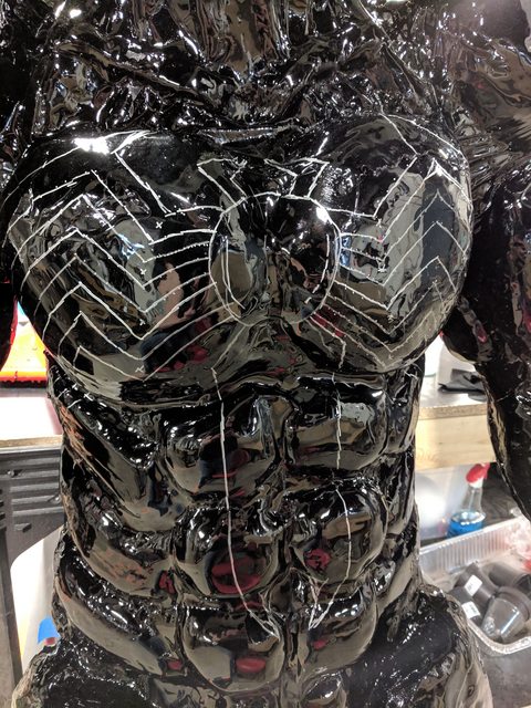

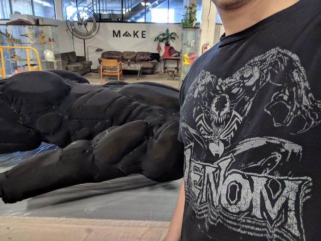

Look at the difference from the uncoated front to the coated back! Look how shiny and gross! Imgur kinda compressed my GIF, but in person, the finish was mirror like in some places.
Here is the neck and collar areas. The good thing is any time the brush got away from me, it would just make it look like a vein or slick that honestly worked more in my favor than against me. Adding bulk to the neck also makes it look more proportional to the rest of the body, and I was really pleased how it turned out.
LOOK HOW SHINY. YOU CAN SEE ME IN MY FAKE ABS.

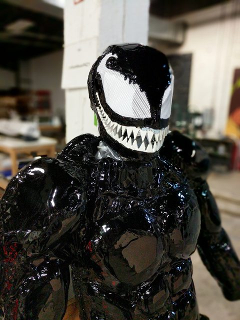

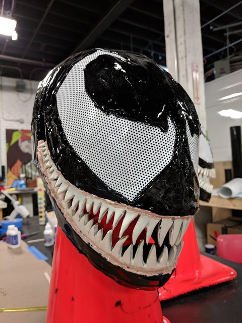

For the masks, I decided to do the teeth first, since they required a delicate touch and it would be easier to mask them off from the black coating later. I rigged up a couple pieces of PVC to hold the mouths open so I could play dentist.
I applied two coats of white per jaw. UreCoat cures naturally to a clear amber, so to get it white I had to add a TON of SoStrong white colorant to the mix, which made me nervous because if you add too much, your material won't cure and will remain gooey. Fortunately, that didn't happen to me but it did take a lot longer for these to cure. It had a consistency like frosting mixed with jelly. It could spread easy but wouldn't drip. That made it easy to take a small brush and Popsicle stick to put it on.

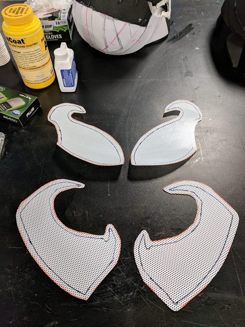

I took my eye templates and transferred them to some sheets of perforated vinyl I had from a previous project. This allows me to see out, but others can't see in. Vision is very good while wearing.
Cut out. The space between the orange border and black line ie where I planned to apply a very small amount of glue to stick the material to the mask, and to allow the rubber coating to rest on top, essentially sealing the eye to the mask, since the adhesive on the the vinyl doesn't stick well to the eva by itself. A clever work around, IMO.
Here they are before going under a coat of black rubber. Cartoony on the left, scary on the right.
I had to elevate them with something, so I borrowed a couple traffic cones from the shop for that purpose. I then masked the teeth off in preparation for the black coat.Why?
Gravity. The material is kinda watery at first, then as it cooks and cures turns more like syrup, then honey, then frosting. You have great control with it for about 60 seconds to brush it on, then it gets harder and harder. At some point, you have to STOP touching it and let it set, or you'll capture streaks and other flaws. I let this run down, and then figured I'd simply cut it away with an x-acto later. Some of the dripping worked in my favor- see the eye on the left above, vs the cleaner one on the right. The eye on the left looks more organic and Venomy. I wish I had let the other eye do that but didn't notice until it was too late lol

The second mask, much better. I even mixed up a batch of flesh coloring to add a gum line on this one. It looks really legit in person. I thought about adding some green "slime" but didn't want to get too fancy on my first attempt. I honestly really like the "clean" look.
Oh man, it's happening. I was so elated by this point. So happy!!!
Ahhh!!! He looks so GOOD.

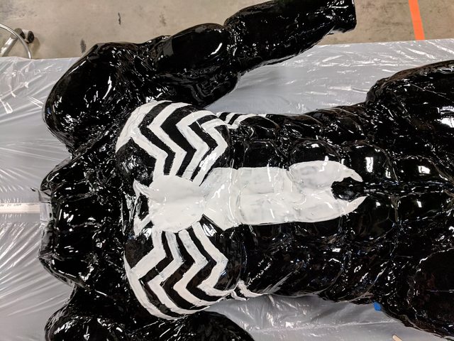

The next day I set out to do the detail, the center piece, the spider. I considered several things for this part, such as using a projector to put an emblem on I could then trace. Or painters tape that I could then fill around. Neither of those worked. The simple solution was the best one. I just pulled up some reference images, got a silver sharpie and drew it out by hand. It didn't turn out bad, and I could wipe the sharpie lines off with alcohol and some hard scrubbing if I messed up. This is again one of those times where a "mistake" can actually work in your favor.
I mixed up some batches of white, and then carefully drew and painted on the signature spider. It was slow and nerve wracking , but I did it and didn't make any mistakes or errors. I could have added another layer to make it pop more, but honestly liked the semi-uneven tone better.

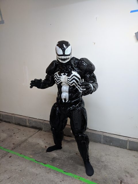

Done! I was so beside myself at this point. I had to leave him alone for a couple days to cure fully, but I did it. It was in front of me. I made the thing. NOW. Would I be able to actually wear it?
After a week or so passed, I worked up the courage to start removing the dummy and skeleton frame. The good news is the suit upened up with out issue, and though it took a while, I was able to successfully remove the paper stuffing and frame. None of the material made it through to the inner skin layer. What you see above is how rigid the suit is, even without the frame. It stands up! You can see where the muscle is attached. I weighed it, and the suit is a whopping 12 pounds :D
The bad thing is that to get in it, I have to lay him on the ground on his stomach, then shimmy into it like a hole in the ground. Had I made used a longer zipper, I'd be more able to easily "fold" the suit in the front and just step in, like a jacket. The first time I put it on I was super delicate, but after wearing him a few times, I figured out how rough I can be and seriously, I can beat the crap out of him and he holds shape.
Here is the first test fitting. He doesn't breath well, at all. That is to be expected since I didn't leave any vent spaces and it's fully encompassed. It was December at this point so the cold was good, but I would likely not wear him to say, Dragon Con. Well, maybe... at night. with some ice packs strapped to me.
Happy dance! I have a neck seal to hide my skin, I just didn't put it on for the test run. All in all, this was a fun project, one I've wanted to do for years. I'm not super tall, only 5'7 and was worried that I wouldn't look right as the character but honestly, I'm glad I got over myself because I still think this looks great for a first attempt.
