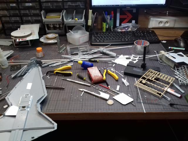

Part I: overal view and drilling and drilling and drilling and.....

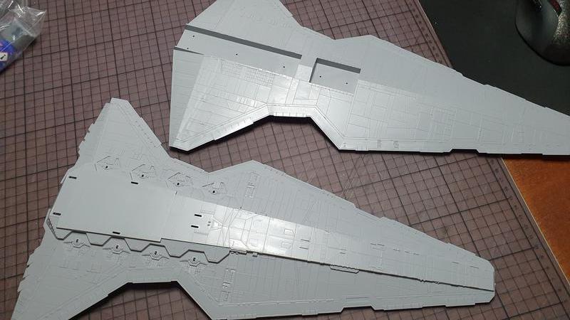

I started by giving all the parts a good wash and cutting them all out. I did not worry about the numbering, this is a really easy model to put together, followed by dry fitting some parts to get a sense of scale.

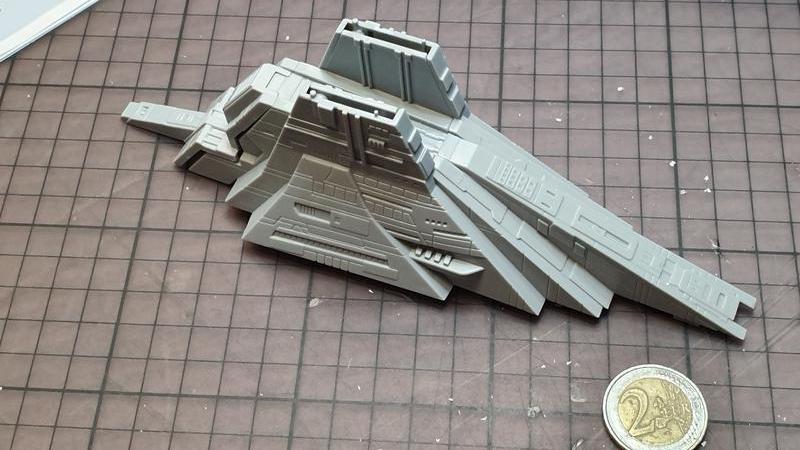

The bridges (one for star ships, troops and backup and one for the actual cruiser itself)
The tower for the bridges:
The hanger:
The detail is nice, but it was apparent quickly that it can improve allot. Many area's are dull and empty.

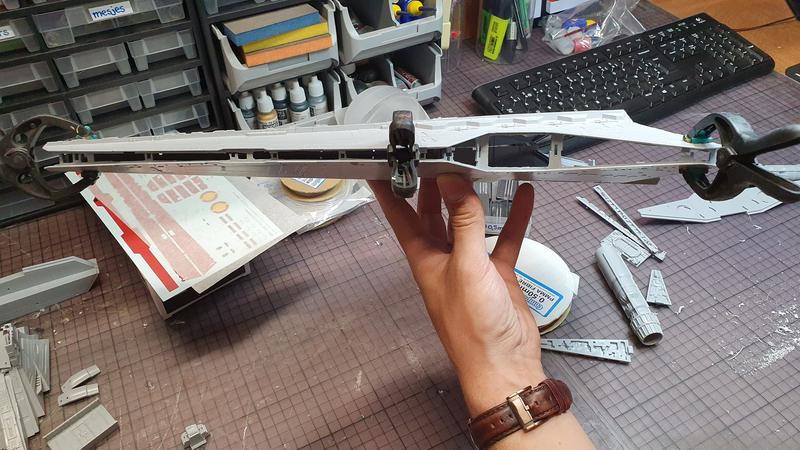

I was a bit shaken by the amount of ways to start this project, and finally settled on starting to drill some fiber holes in the port-side trench. The trenches have allot of detail but it isn't that sharp, also really repetitive. I will try to rectify this with styrene parts and drilling holes at more random positions.

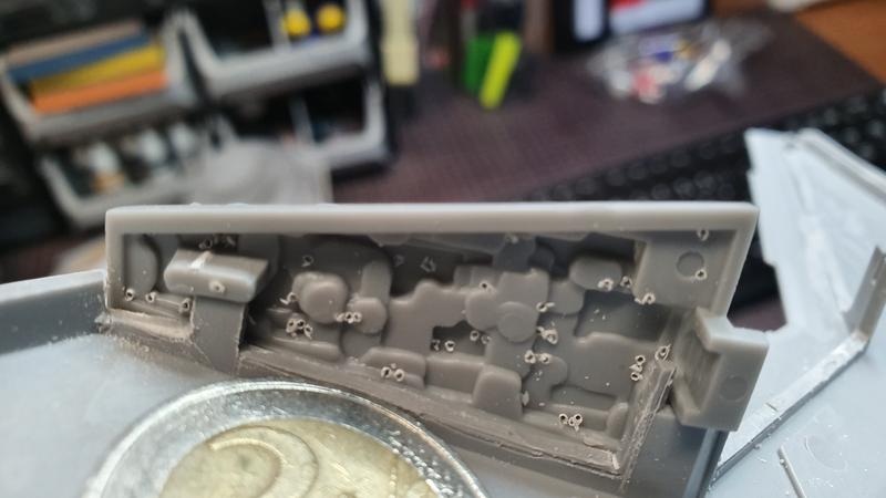

At first it tried the drill press setup I have for my rotary tool, but even the lower speed melted the plastic now and then, filling up the just made holes. this proving to be a hassle I switched to hand drilling and putting up some SW series / movies in the background.
I'm using 0.5 drill bits, the fiber fits perfectly.

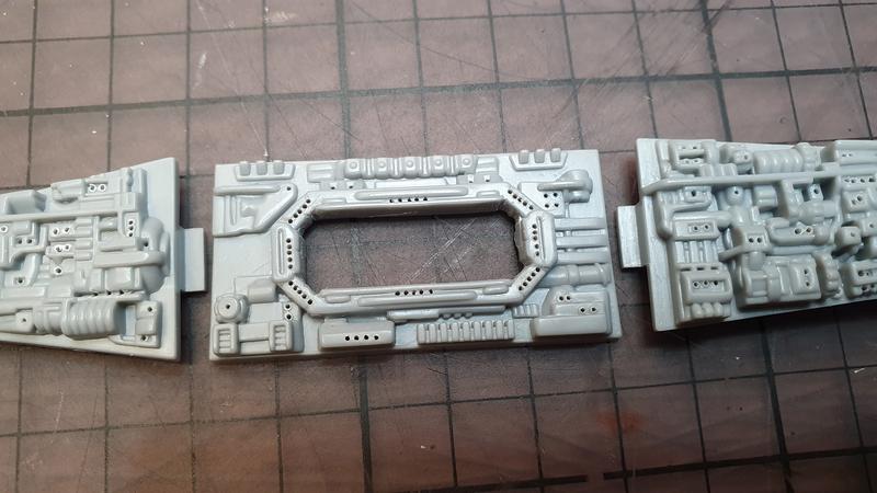

My plan was to drill out all the windows made by the model itself and then add allot on other locations to break the repetition. Here is a good example. The first picture is a part of the trench with just the windows drilled that the model 'provides'. The second picture shows how I added more windows at random locations to break the symmetry. I intend to make even more difference with styrene later on.

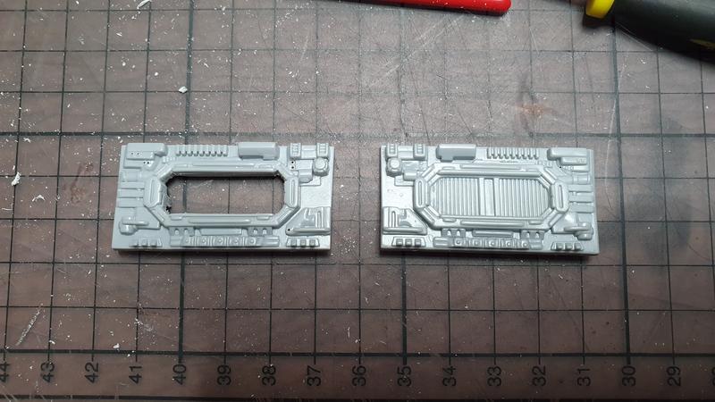

I wanted to add a few more features to this model, deciding not to open up the big hanger on the top but wanted some interior I cut out the port side hanger bay door.
Here it is next to the original part:
The starboard side will stay shut, or lend itself to the mount for displaying the cruiser.
One more detail view of the many holes I drilled in the trench parts. Probably going to do even more.
So this is where I'm at!!!! I'm really motivated for this model and many updates can be expected!

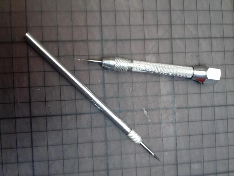

Looks fantastic so far, it's a great kit! Out of curiosity what are you using to drill holes? Mine always end up not lining up because the bit tends to drift. I use the blue Tamiya drill
Hoplitespear
Thanks!
I use a simple exacto style hand-drill, but to make sure it doesn't drift I first press 'pilot holes' with a exacto-pin. That way I can just simply seat the drill in the dip just pressed and it won't drift at all. So basically every hole I drilled (and holes to come) have been pressed in beforehand with a pin. I'll try and take a picture when I work on the next parts.
-hopli

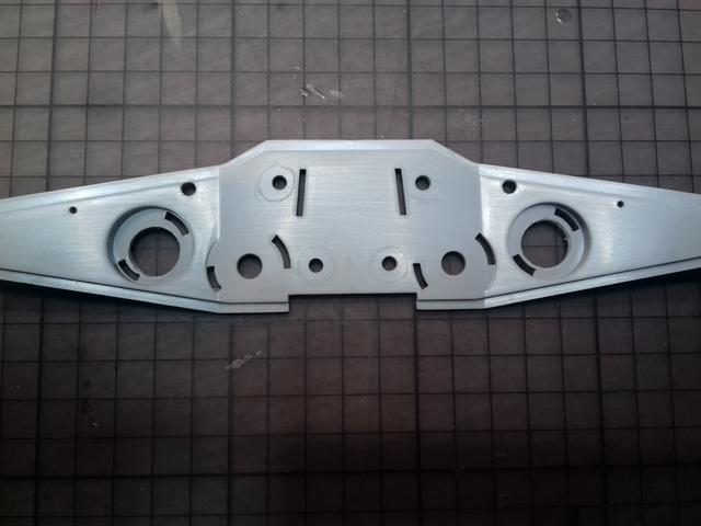

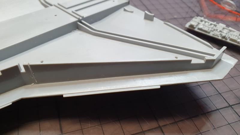

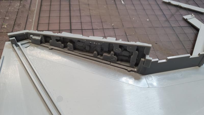

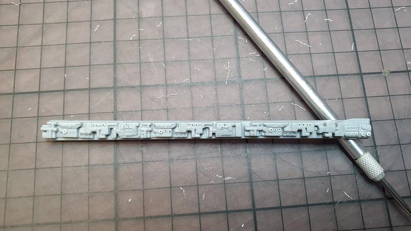

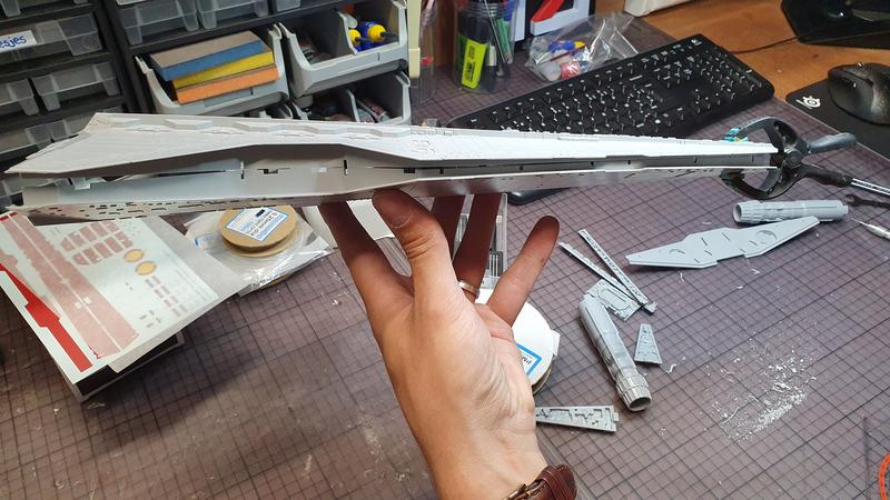

So to make room for the fibers to travel into the hull I have to take out the wall that lines the trenches. This wall sits behind the trenches and provides a gluing surface and structural support for both hull pieces.
I tried to keep key points and a bottom and top edge so I can still get a strong bond when eventually bonding the whole thing together.
This is what tonight looked like in pictures:
The evil wall that has to be torn down:
click on the spoiler tag to see the pictures and progress
Torn down and showing the fitting of the trench piece.
Another area cleared:
Port side done:
Starboard yet to be cut open:

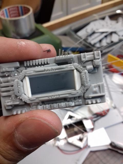

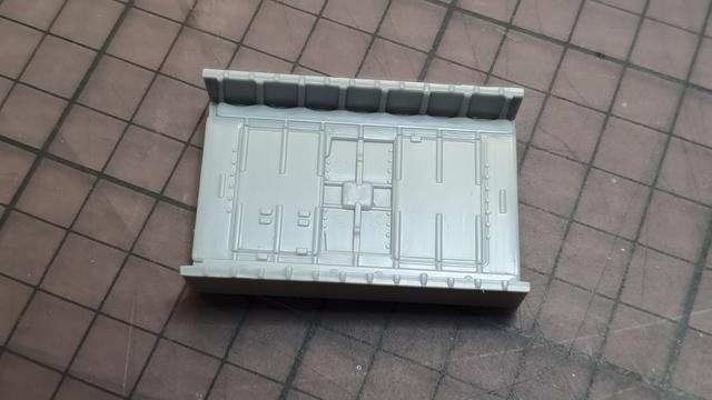

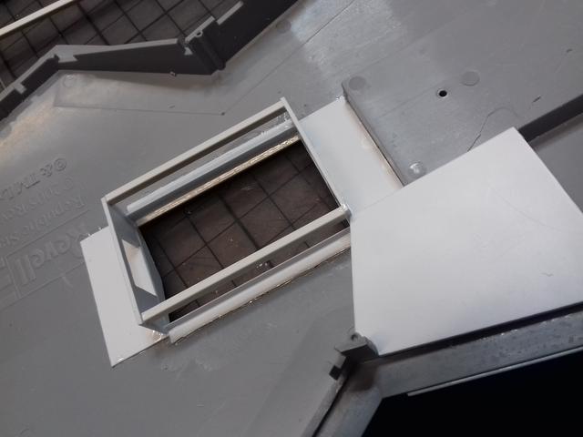

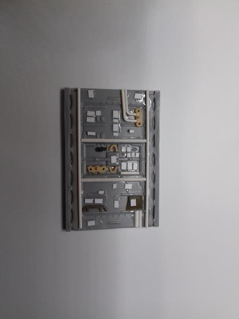

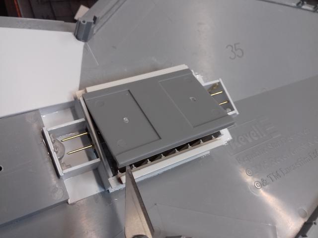

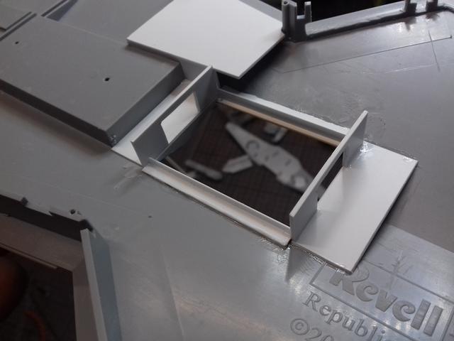

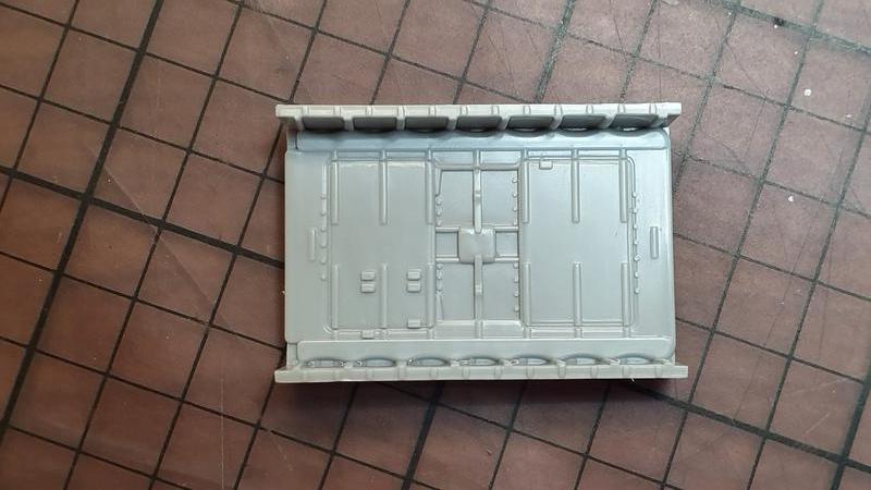

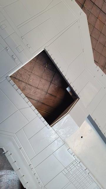

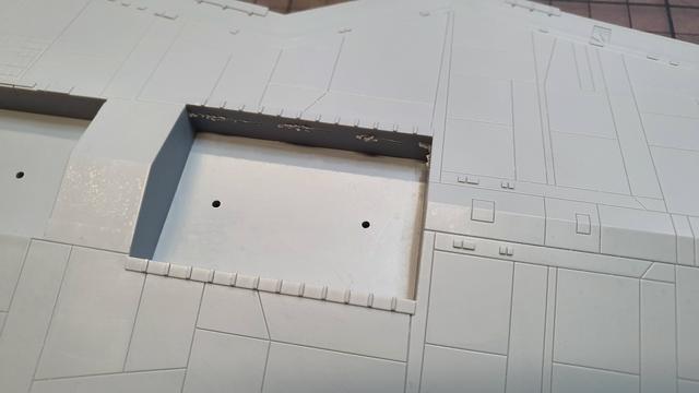

So this is the original piece, which slots into an opening on the bottom hull:
Not enough surface detail, a bit to low, no crane and side hangers. I am a fan of allot of pictures so I'll reduce the size a bit and keep the higher resolution for the 'finished shots'
here are my steps of today:

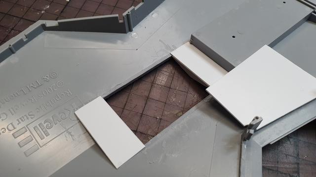

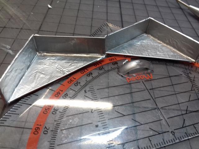

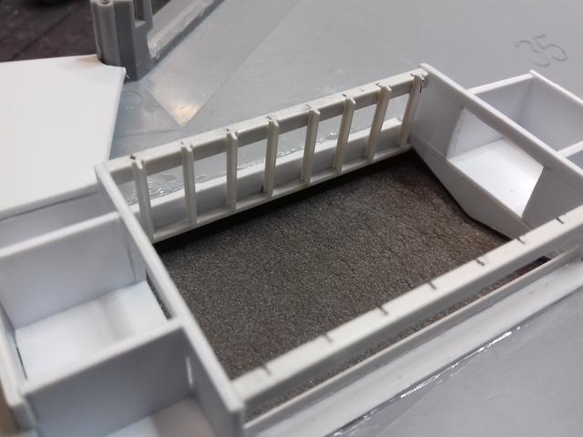

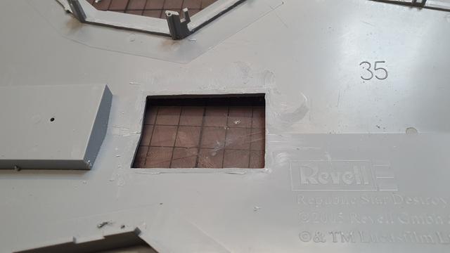

Cut out the hole where the hanger piece sits and sand flush:
Add floors and side pieces to fill the triangular hole. Note you can also see my 'floor' plan for the side hanger on this picture:
Adding walls upper struts with spacing (for light to shine trough)
Its starting to look like a hanger!!!!!!! At this point I am very pleased, being my first time doing something like this.

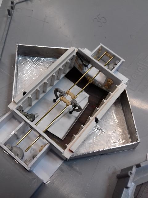

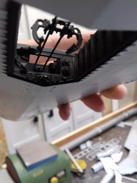

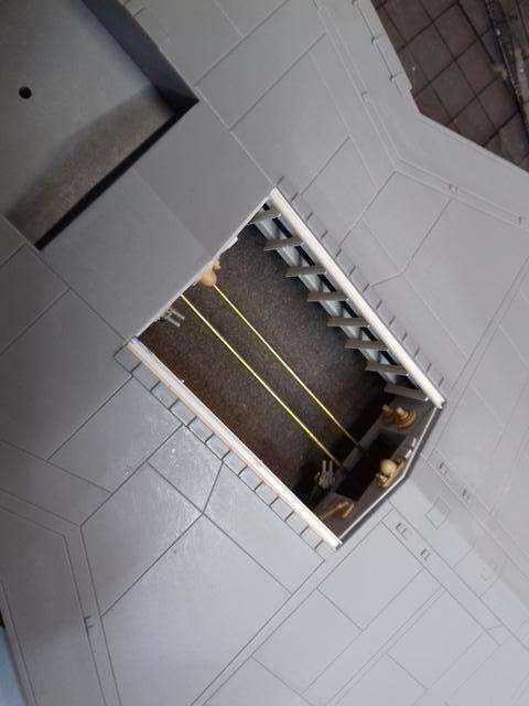

At this point the big structures where finished and I started adding greeblies from my bin. (rests of stuff I used on my FH truck)
Guns:

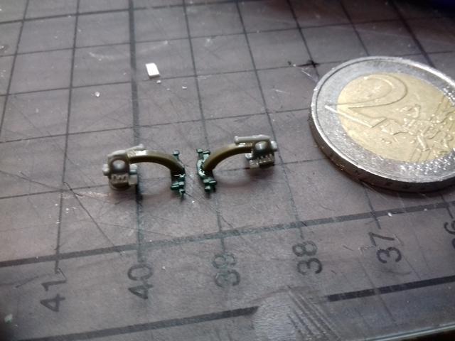

Rails for the crane/docking clamp.
and the clamp itself and in its position:
I cut the sides of the old hanger piece and plan on using it as a lid for the new 'hole'

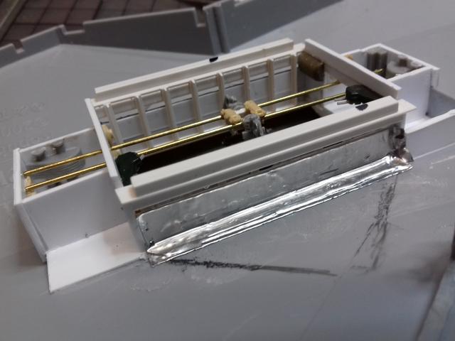

First thing I did this evening was finish of the detail on the hanger roof. It is my first time with tweezers and really tiny styrene parts. Since this is a place that won't be that visible its the best place to practice. Need to find a way to have less glue, won't be visible after primer tho, but still would want to work 'cleaner'.

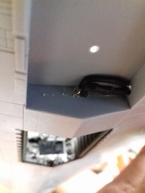

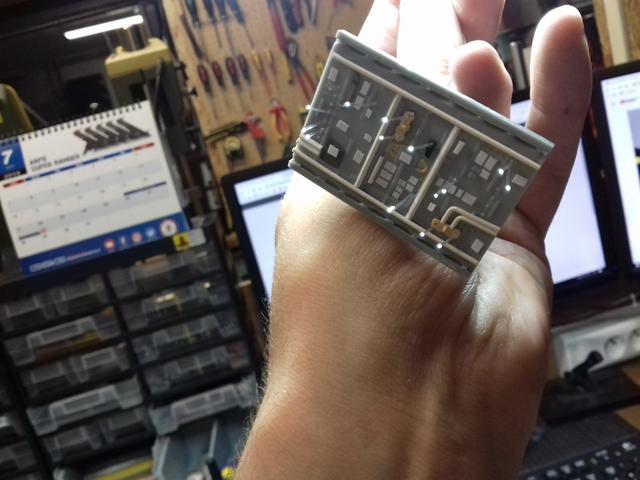

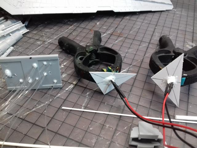

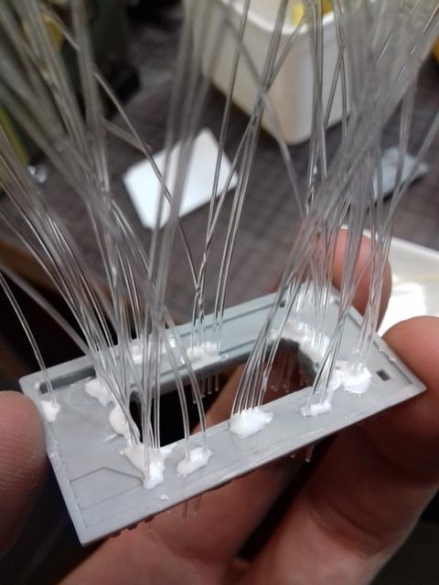

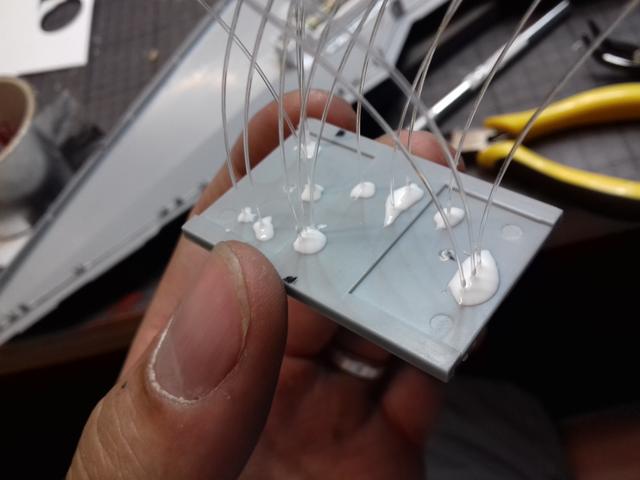

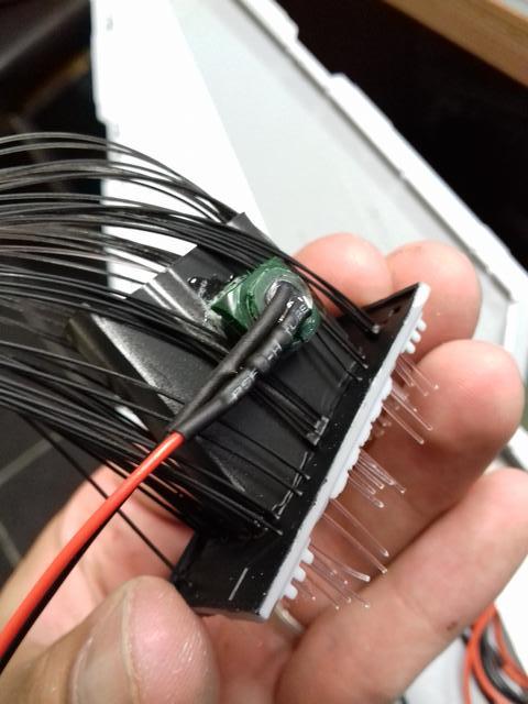

I also added some fiber on the roof, I secured the fiber with woodglue, will have to dry a whole night there is probably a better way.

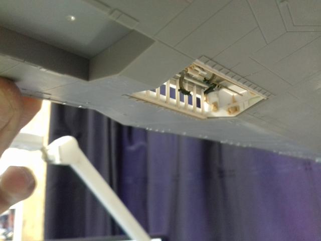

After that It was time to light the hanger itself, I had the idea to let light escape at the top, bit of indirect lighting. I closed up the sides with pieces of styrene leaving a 1.5mm gap at the top, and covered them in alu tape.

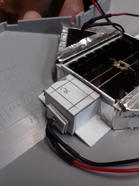

After that I created two 'light boxes' and glued them next to the hanger, they will receive a lid with an LED inside. The boxes are also coverd in alu tape. I also secured the LED's in the lid with woodglue, so i'll have to wait until tomorrow to test if the structure works.
Small thing about the LED's, they are pre-wired LED's with resistors that take 9-12V. I plan on using 12V power supply. The pre-wired thing makes it really easy, no thinking, not to much soldering (I love to solder though). Just install and connect.
Tomorrow we find out if these hold and work:

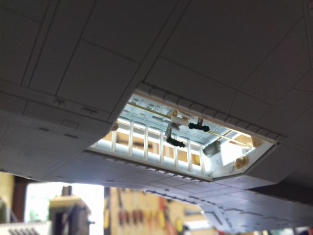

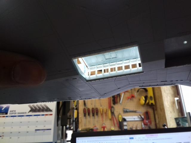

So I Finished the lighting for the bottom hanger today!
Part V: Coooool ... lights....

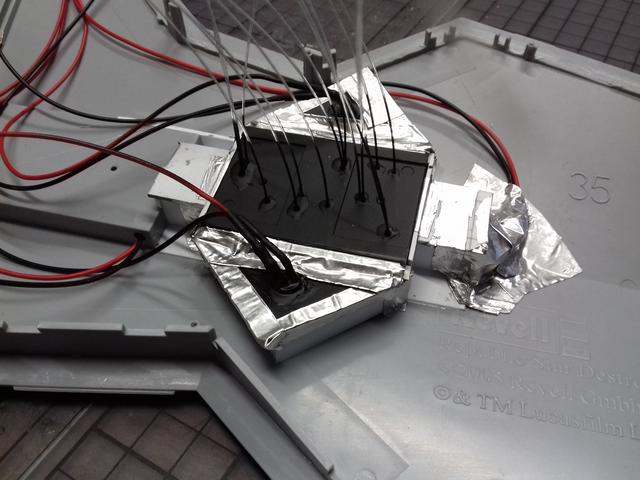

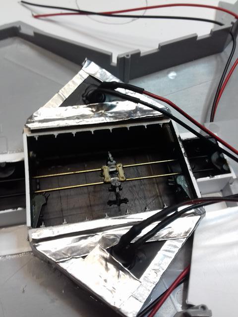

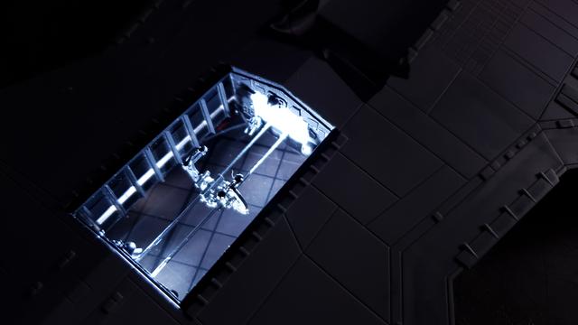

So starting today I gave the hanger and little side hangers a coat of black primer.
After that I painted the little hangers in a light gray, they will barely be visible, followed by trying to find out where I would place the LED. Wanting light to shine out of the hangers into space I placed them at the bottom in the back wall, which is also the place less visible when peering inside.
The Fore one was easy, the aft one needed to come in from outside of the hull. When placing the bottom plate I'll have to improvise a cover for the LED.

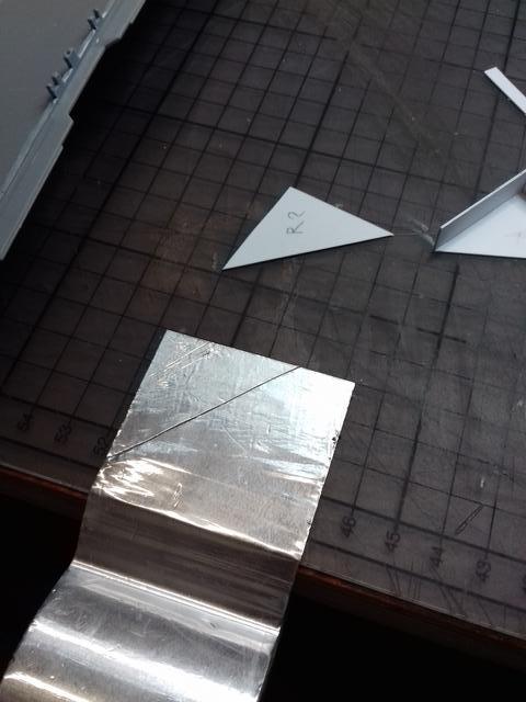

Also needed was more alu tape to keep the light bleed to a minimum.

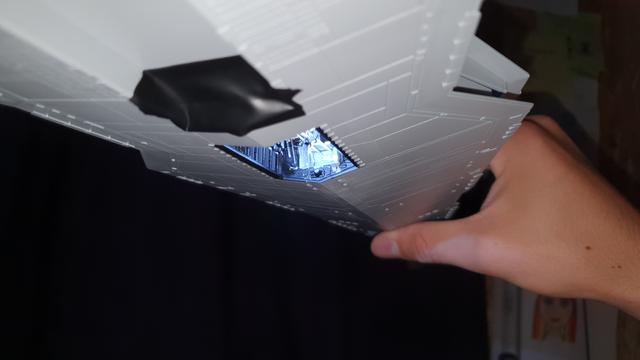

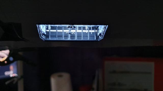

This is how the whole 'module' looks when closed up:
I must say I'm not good with photography yet so these picture's don't really represent how it looks IRL, but they do come close. you can see the main hanger gets indirect light from the top, while the side hangers beam outside from the back.

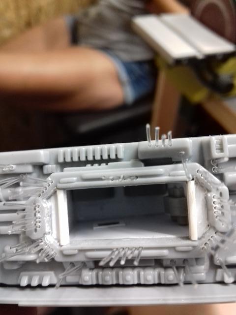

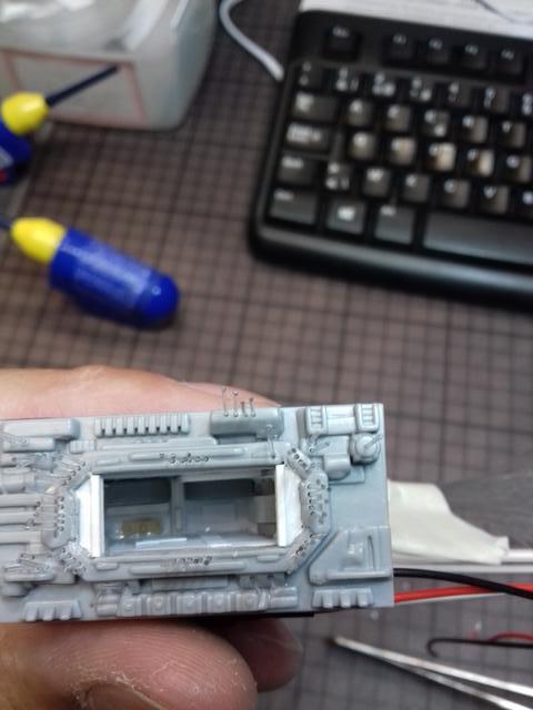

I started by adding the fiber strands to the hangar piece that was cut open.
This kinda revealed a problem. With all the fiber it was kinda hard knowing how to do the inside of the hangar. After working the problem for a while i came up with a box that fit just inside the fiber strands.
It was impossible to make the sides follow the front so I covered that up by adding the two blast shield doors to the sides.

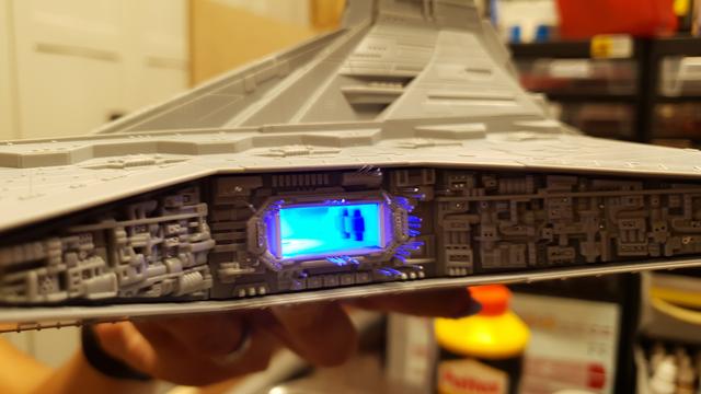

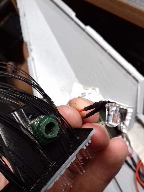

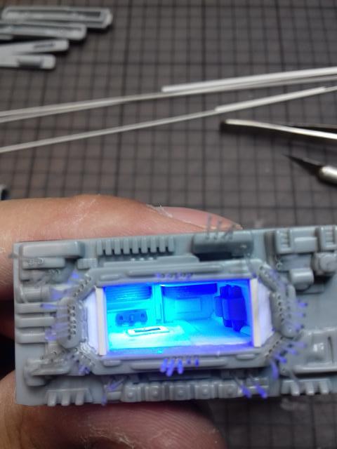

After that it was time for lights. A blue hue is what I'm going for. The thing is, in the bottom hangars you can see the LED, which isn't much of an issue since you'll never look at the ship at an angle revealing the LED. But this hangar is in the middle of the port-side trench, completely in view.
My solution to this was to mimic the typical pit we all know from the imperial ships and death star hangars.
my 'simple' rendition, also a few greeblies to break the flat surfaces and add a kind of observatory.

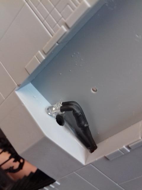

From within this pit I attached a blue LED using some spare tank wheels I cut up. Adding the LED in the bottom made sure whatever angle you look at the ship, it will never reveal the LED or shine back into your eyes.
This is the result (I really need to look into taking pictures from lit up stuff).

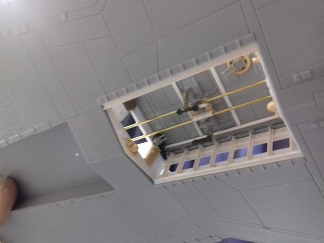

Hey, small update of the work I got done on this busy Sunday.
Part VI-2: Side-Hangar + lights and a preview on engines
I started by finishing up the detail inside the port-side hangar.

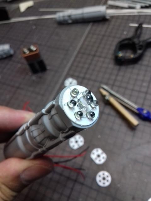

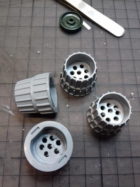

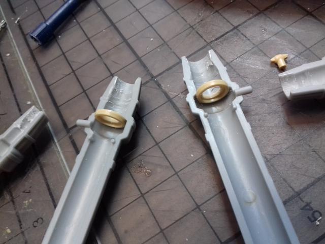

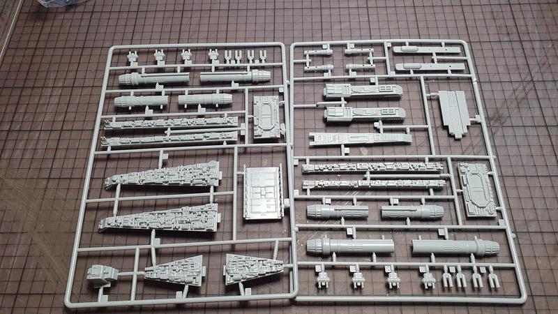

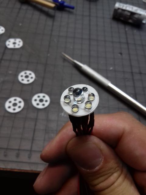

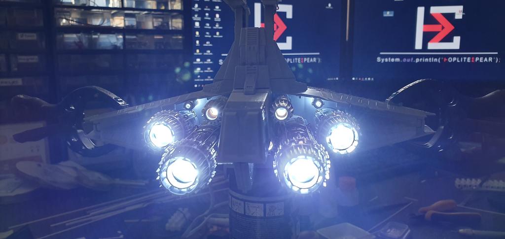

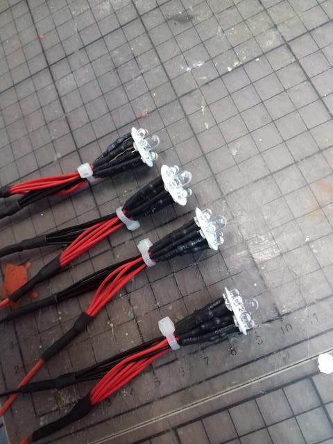

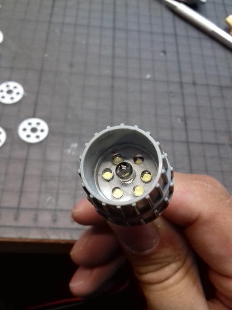

After that I decided to tackle the engines. Before adding lots of styrene parts and greeblies first I had to know how to route the lights.
The plan is 1 5mm in the center, 6 3mm in a circle around the center.
Drilling out the nozzle's was step 1.

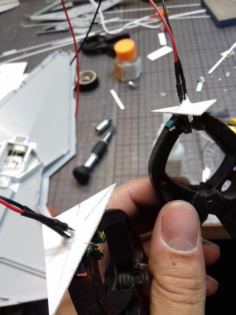

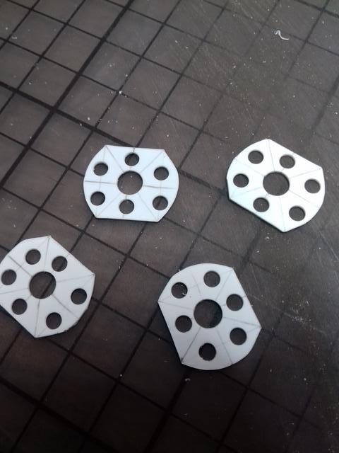

Step 2 involved making a styrene template to hold the LEDs in a nice array. and later hold some greeblies to 'hide' the lights when looking into the nozzle when the lights aren't on.
this is my first 'failed' attempt, some of the holes where to wide and didn't fit the nozzle anymore.
attempt two was much better, googling how to divide a circle in 6 helped...

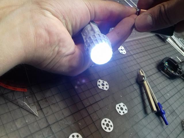

had to awkwardly hold all the wires against a 9V battery...

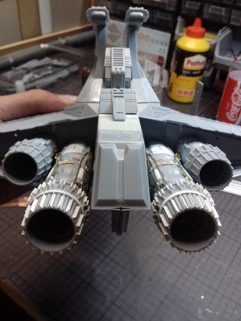

I got more work done on the engines. This will probably show the direction I'm going in. I'll just let the pictures talk. Still much more to add but getting there.
Sadly enough, more mangling of plastic first. Don't worry its not that much.
There are pipes on the side of the engines, in the opening scene of EP III you can clearly see the area beneath the pipes is open. Although I'm not going for movie accuracy, I did not like the plastic being molded shut.

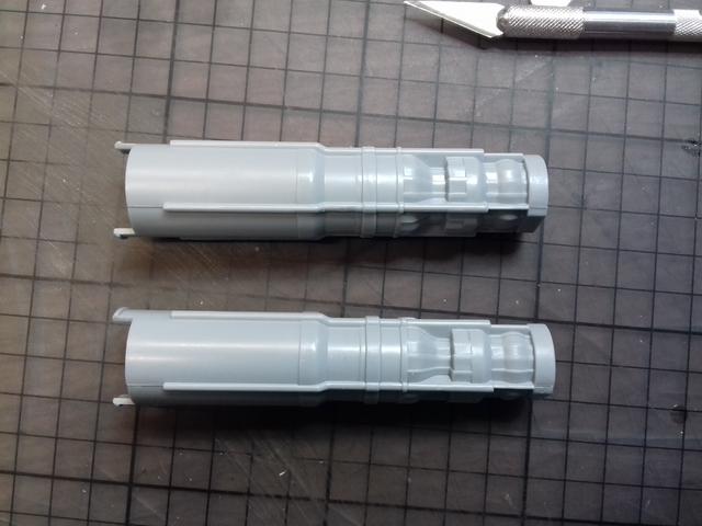

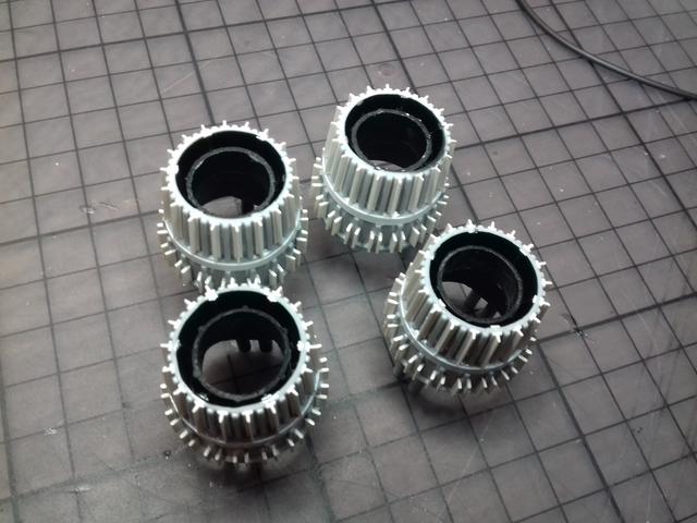

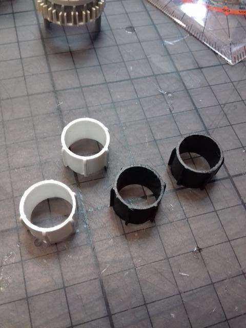

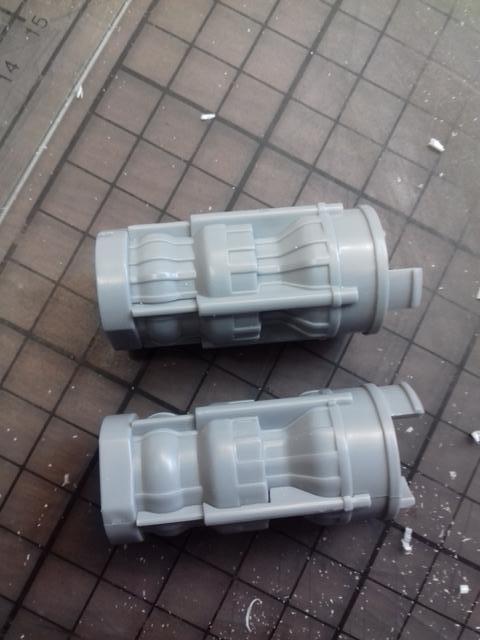

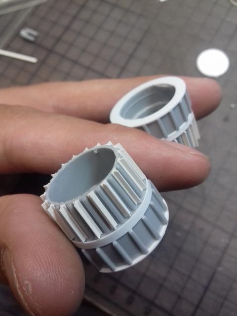

Part VII: Building up the engines!

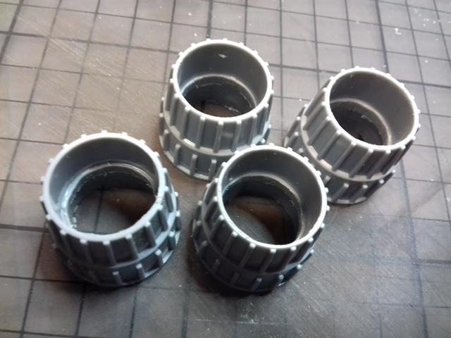

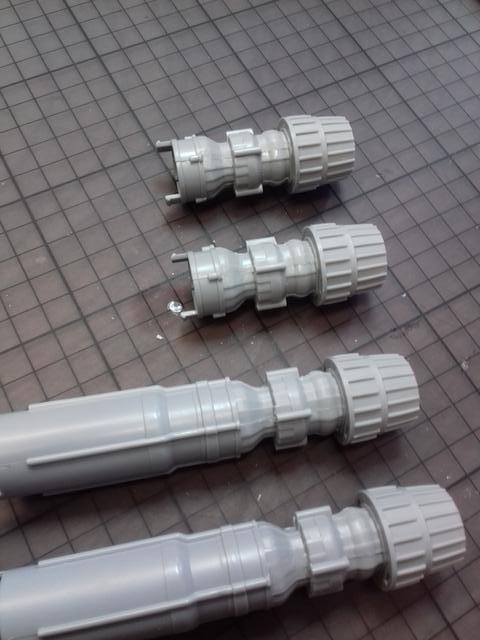

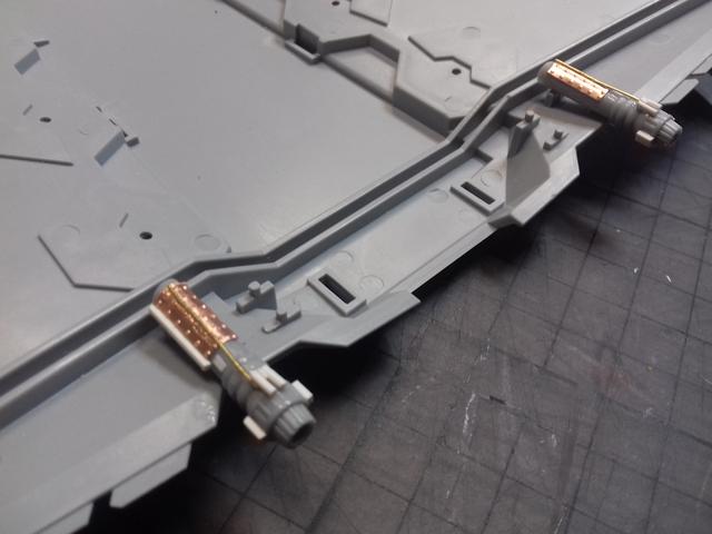

Original engines:
and the small ones:
Same four engines with the area removed:

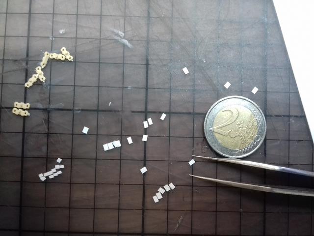

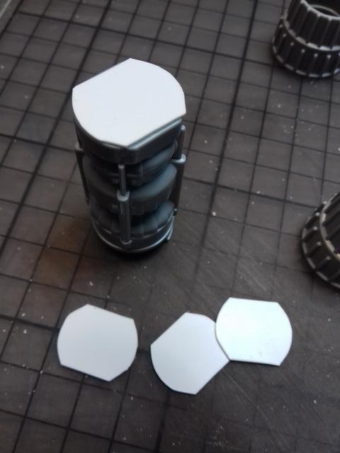

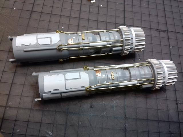

After this minor surgery, it was time to stick strategically placed random stuff on.....
this is what I have so far:
That is it for now!
Cya later!
-Hopli

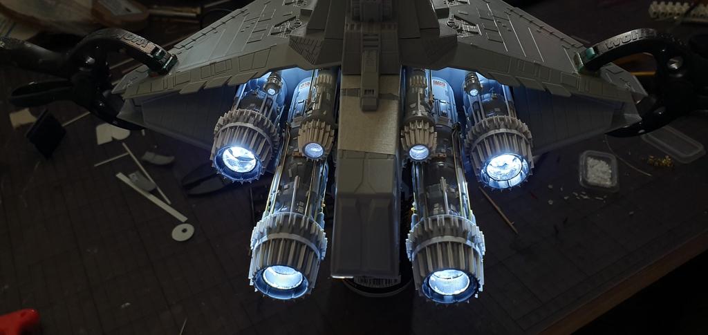

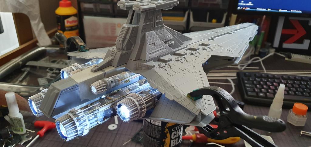

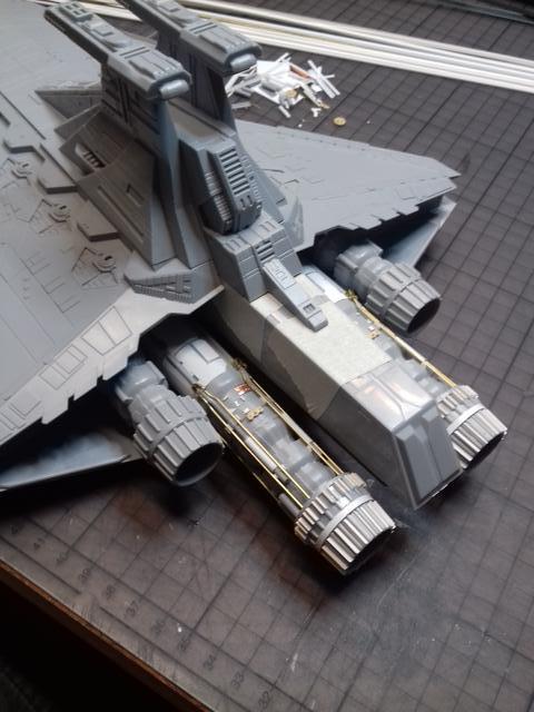

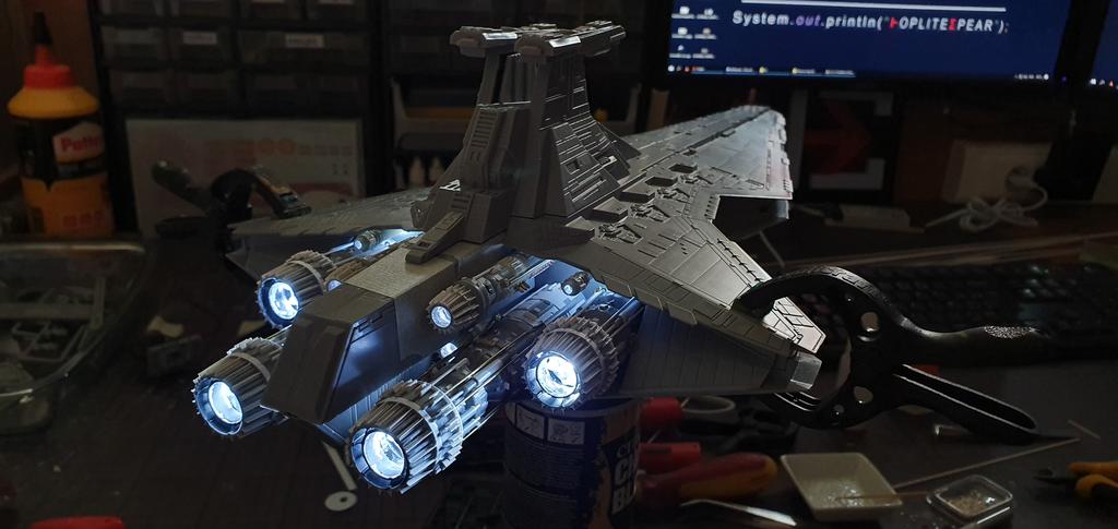

EDIT: bonus got them on the model and see how they look:
also going to try to put some previous pictures in spoiler tags.
Hoplitespear
Those engines look great! I love all the added details
Thank you, I'm still new to this, but I like the effect. Especially the T-track on the nozzle's.
Thx!!

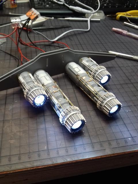

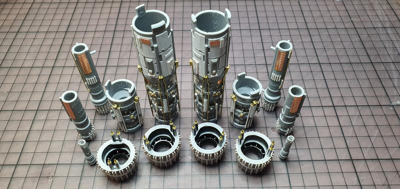

Hey guys! It has been a while but allot of stuff got done on the engines. So lets hop right into it!

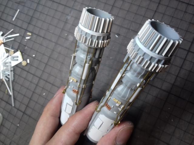

Part VIII: T-track and LED wires for miles!
Continuing on part VI-2 and VII... I started by detailing the shorter set of big engines the same way as the long set. The amount of T-track to be cut was enough to feel my t-track cutting needs for ages....
I crafted a inset in the barrel using spouts for caulking tubes. (hard to explain in English but basically this)
Here are the 4 big nozzle's finished with a quick black primer coating on the inside.
In part VI-2 I made the spacers for the 7 LED's each of these big engines is going to receive. I soldered them together giving each set only two cables instead of 14.
and off course could not resist a quick test:
After all that, detailing continued on the shorter engines and the 4 smaller engines hanging on the structure in the middle.
Holes were drilled in the back plate in the correct positions to receive wires for each set of LED's. The inside of the smaller engines had to be cut out and the border thinned. I glued a tank wheel inside with a 5mm hole to receive a single 5mm LED.
The tiny set of engines will receive a 3MM led poking trough the back plate. they also received some detail.
I got around 30 pictures of the engines in different states of detail but lets jump straight to the end result, or atleast the 95% mark. I really like this picture so a bit of a higer resolution here:
And lets finish of strong with pictures showing a final light test before placing the engines aside and starting a new part of the ship.
A total of 34 LED's for the whole engine assembly.
note: stuff not being glued yet gives light bleed, I am aware of this!
Thanks for watching !!!
Cya later!
-Hopli
