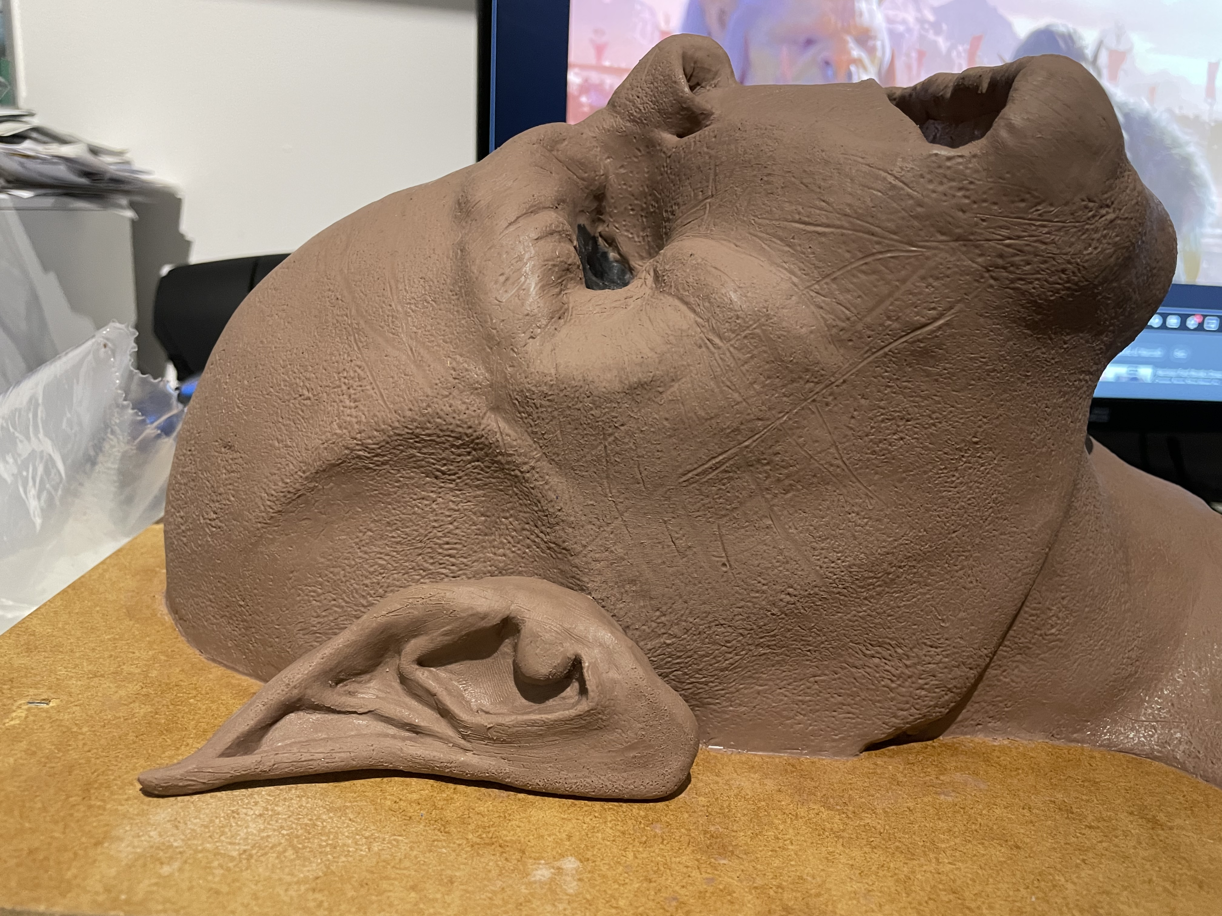

After carefully smoothing the entire sculpt out with sponges, water, and white benzine, Next step is to add wrinkles and pores.
This is challenging for me as I've never done anything before, but I started a bit, just to see how it would look.
If anyone has some tips or tricks and some feedback for me, I'd greatly appreciate it.
This was done by :
-carving in the larger wrinkles
-raking wrinkles on top of thin plastic
-poking the sculpture through thin plastic with a silicone tip (for pores)
-trying to follow some curvature on the face for wrinkles and such.
I'm also trying to bear in mind that this will be a painted face mask that will be about 2 meters off ground, so tiny details will not pop as much, but I still want the complexity of a face be visible... if that makes sense.

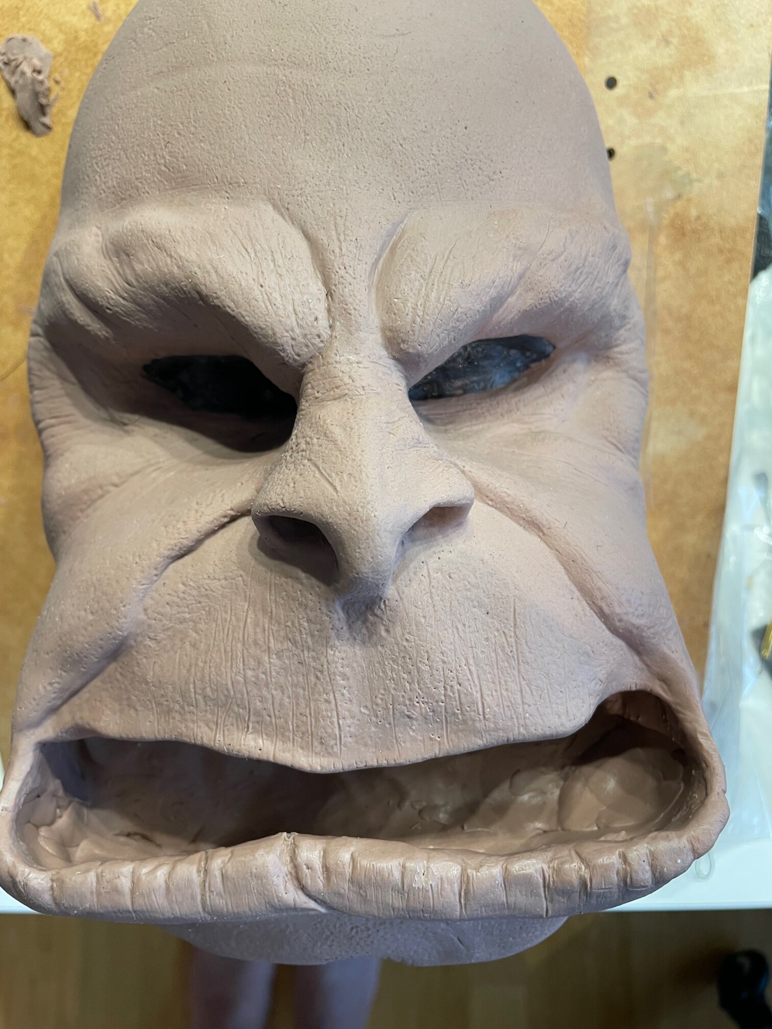

A small update on the sculpt:
I've let it sit for a few days to get a break and also a fresh perspective before going at it again.

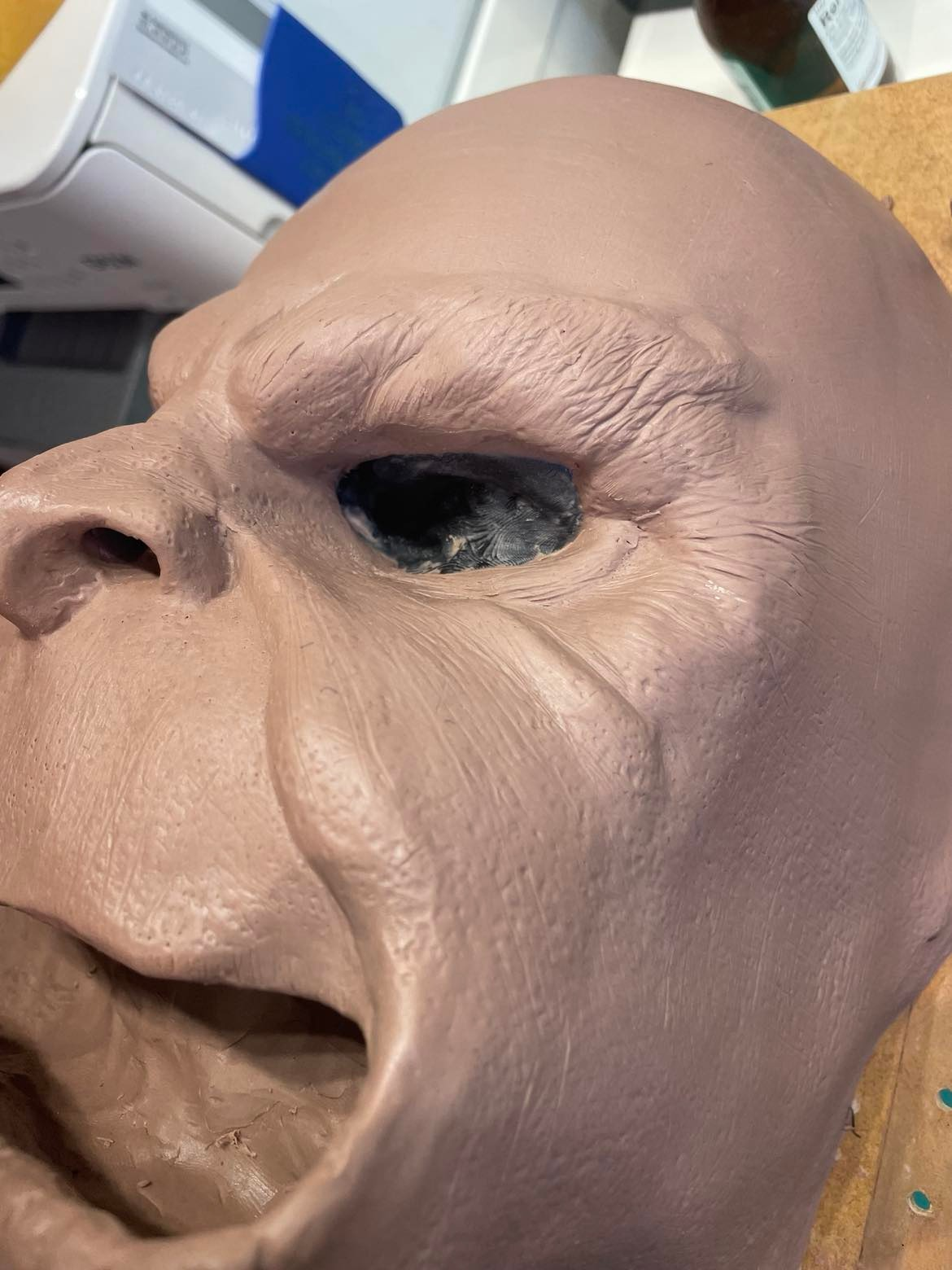

First off: I've remodelled the eyes. Mainly his right eye, but also some minor tweaks to his left eye.
More wrinkles, and added a lot more skin texture to him.
I found out we had an abrasive cleaning sponge at home that worked wonders when pressing into the clay to create small pores.
I've used that along with various foams and a sponge I had laying around to create a pretty ok texture, I feel.
Some minor tweaking around the eyes and the forehead, mostly, and we're left with this:
I'm not sure what/if I should/need to do anything else to this sculpt before the silicone arrives tomorrow.
