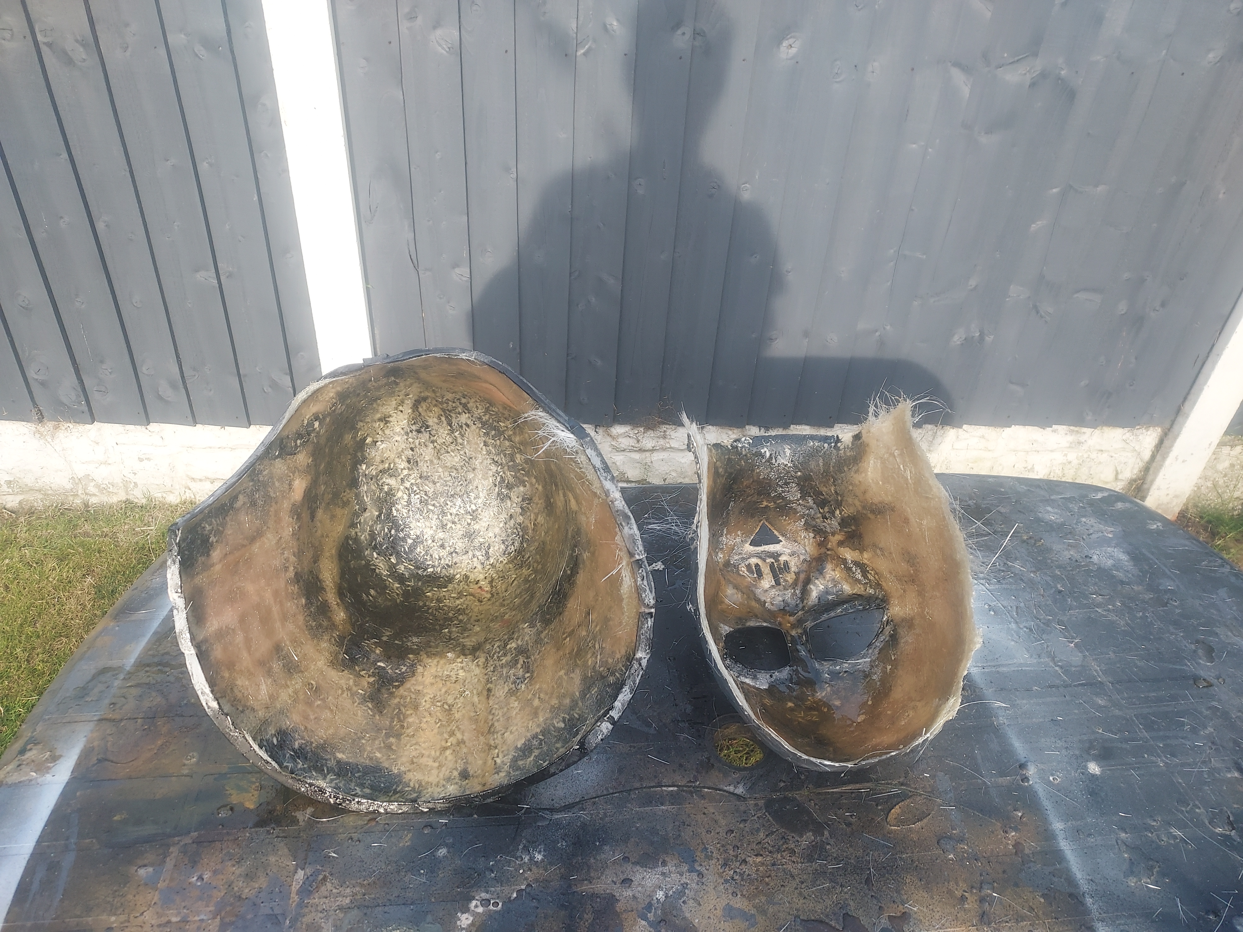

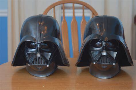

the bottom of the dome skirt isnt super bevelled, its more the sides along the face that are really bevelled in, may be from sanding or from the changes made from the ANH to ESB buts its quite noticable.

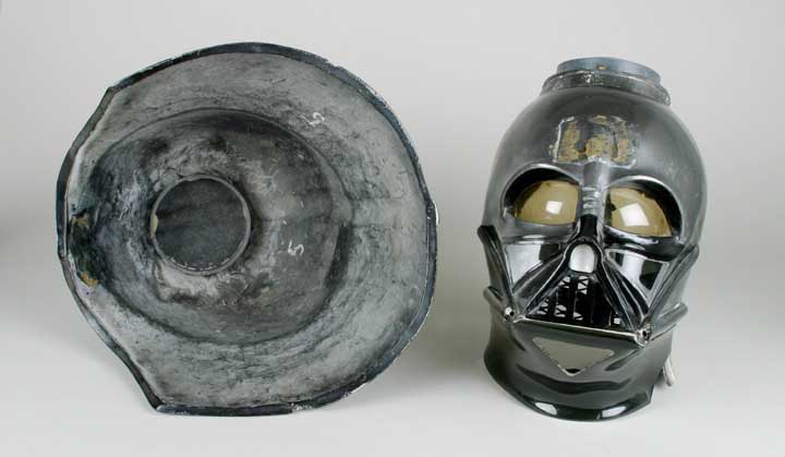

A picture of the ESB stunt helmet for reference.

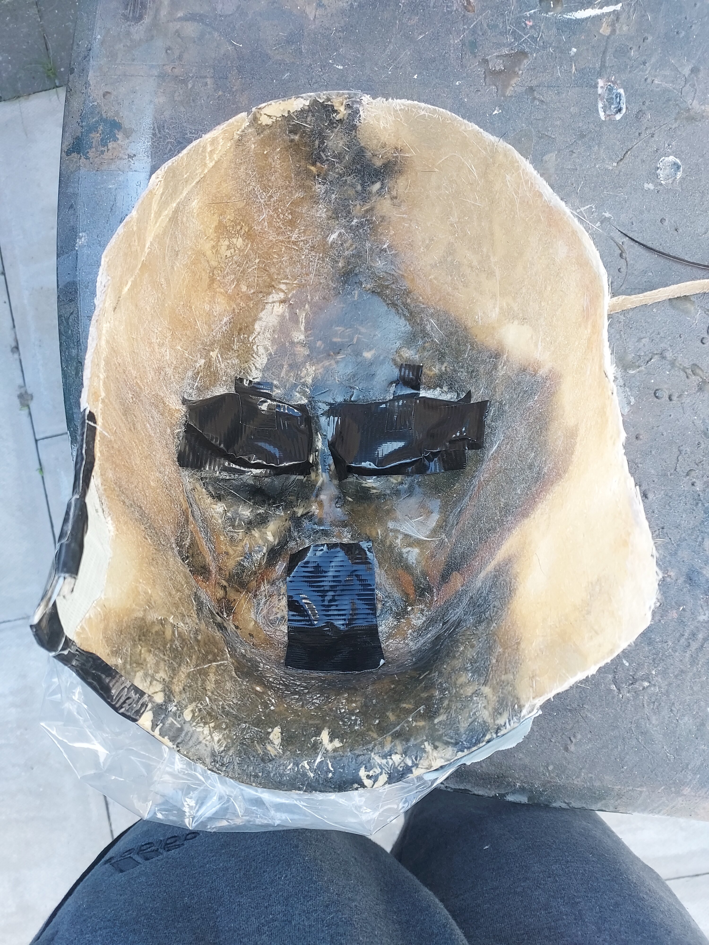

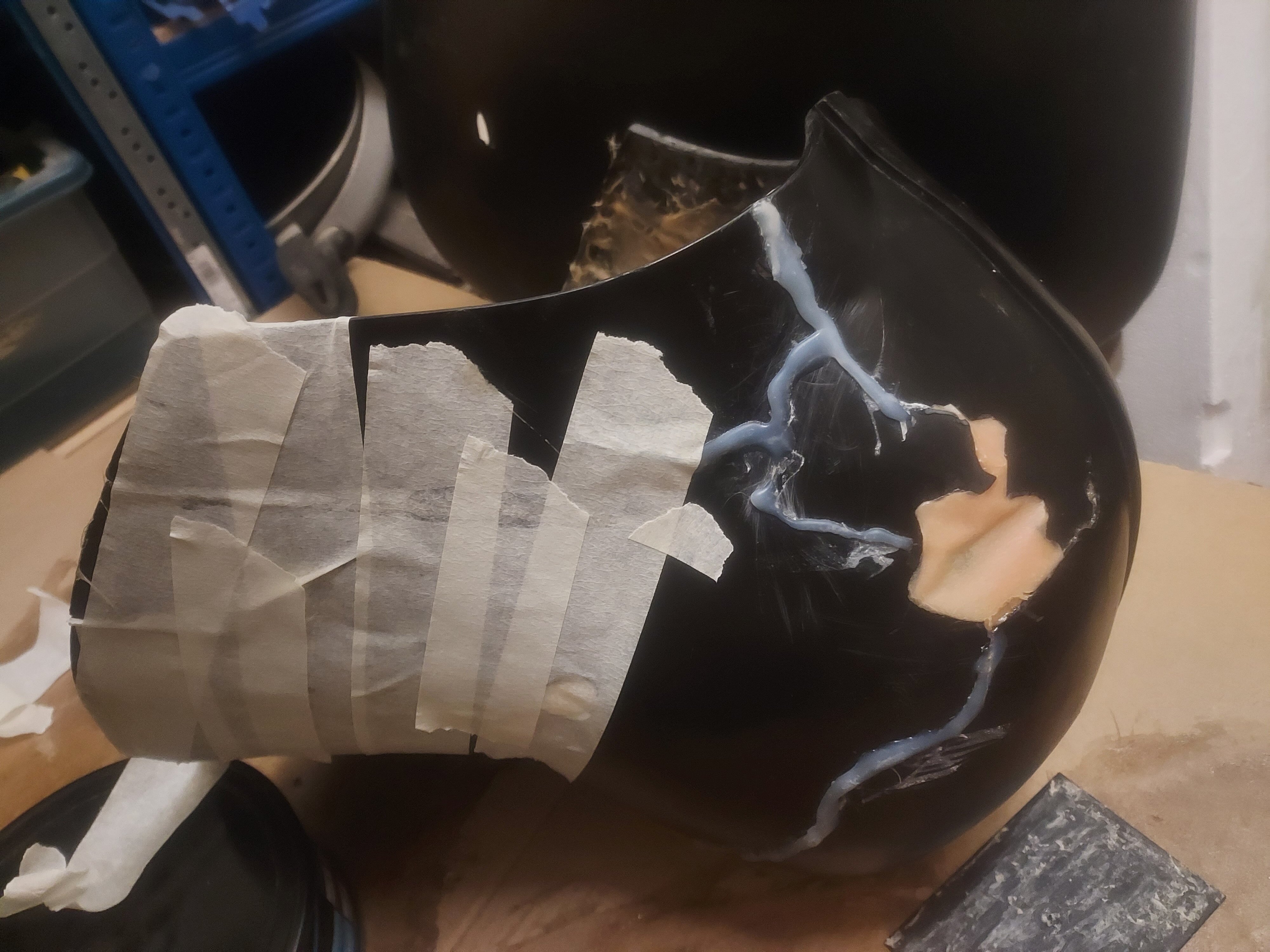

Bin back at it again I taped the outside of the helmet and put in some fibreglass filler theres more to come yet as far as strengthening and resurfacing goes but I just wanted to at least get it back in all one piece for now.

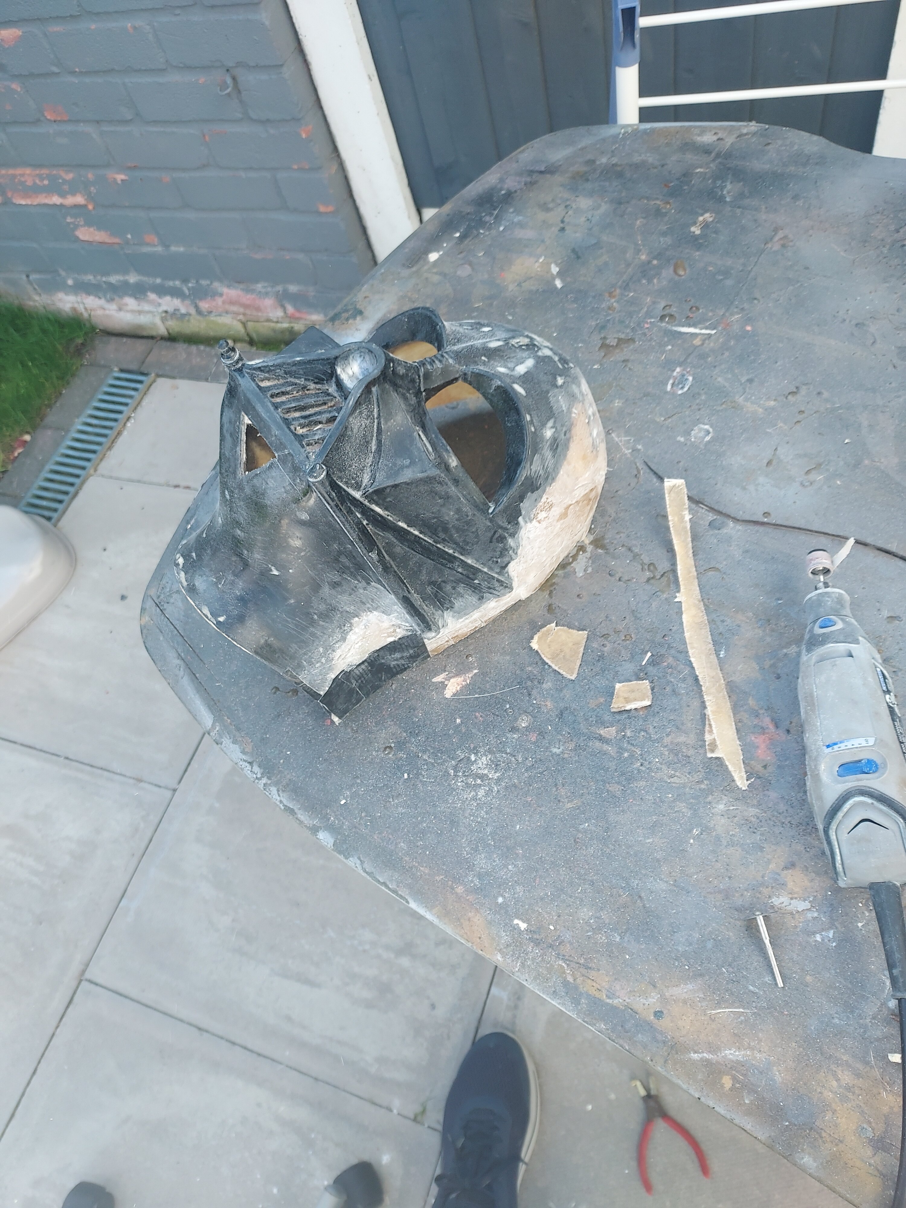

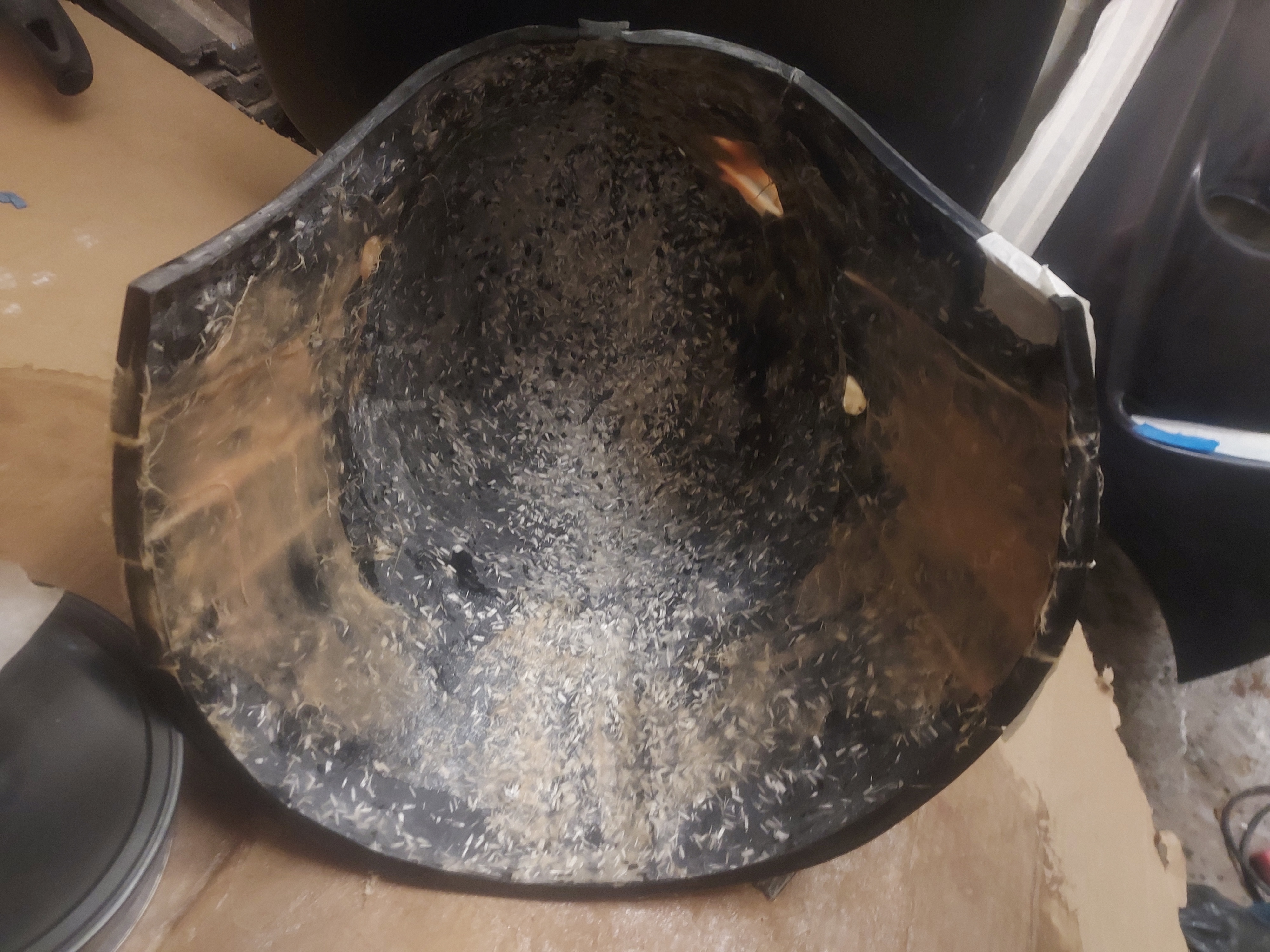

I'm back I decided to smash away the filler after someone I know tripped over it... anyways I replaced that with aluminium tape which was applied fairly thick on the helmet so I could bend it (mostly) to the shape I wanted and fibreglassed the inside of it, irlt was so hot today that I wasted two damn mixtures!!! so I had to do it in smaller amounts.

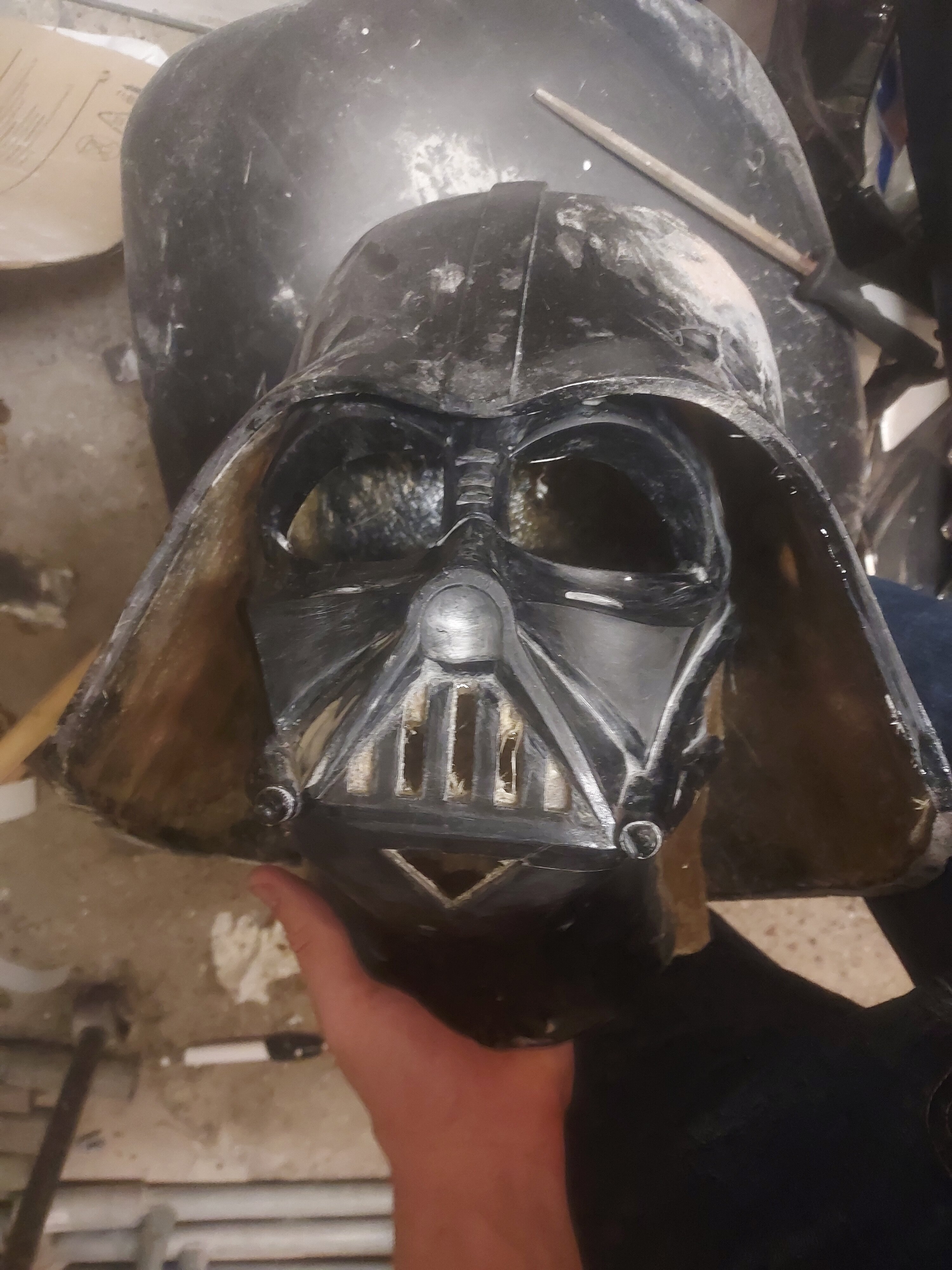

so bad news upon snading I found out that one side is warped, damn looks like I'll be duin more fibreglassing when I get some more, now I' not sure if the dome suffers too much swell I compared it to my new image dome and its near enough the same size but when I try to approximate the positioning it seems slighlty oversize thoughts?
You will have a hard time with trying to see how the dome fits with the faceplate without the ring mount being done on the faceplate and having the dome actually sit on it. using your hand to try and line them up wouldnt work. from what i can see the dome looks good.

yep from the picture you posted the dome looks to be fine how it is,obviously i'd not do too much to the dome until you get the ring mount for the face sorted out and see how the dome sits on it. i usually do it that way myself is finish the bodywork/priming faceplate and then the dome. if you do find once you get the dome sitting on the faceplate, its a bit wide or flared. you can always heat form the dome slightly and readjust the shape.

ah well then if you did the slit cutting the dome should be fine then, the difference making that specific dome more esb/rotj shape was slight, so it should be fine now, yea the PCR is quite different with the nose/nose slots being the biggest flaw in my opinion.

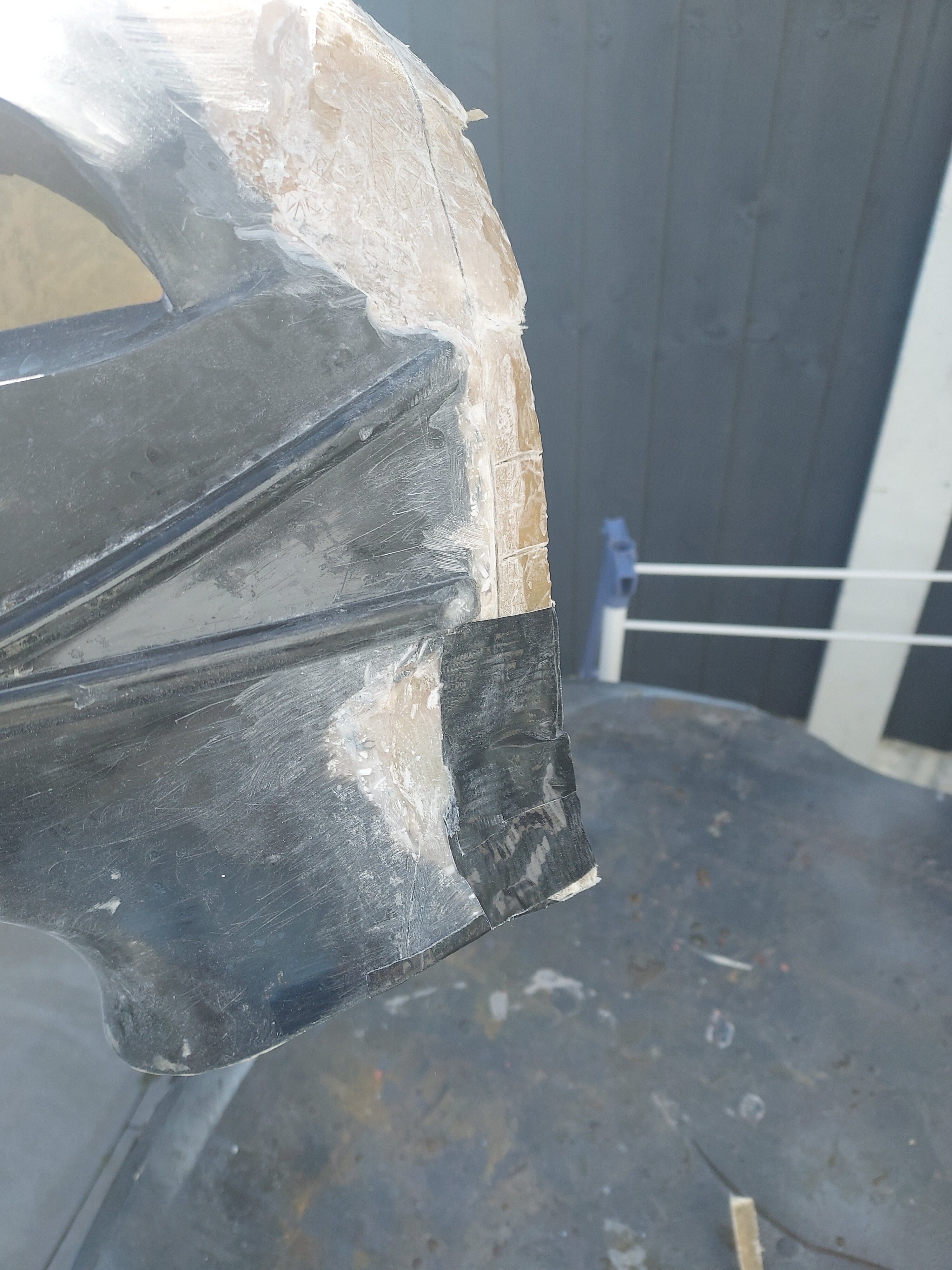

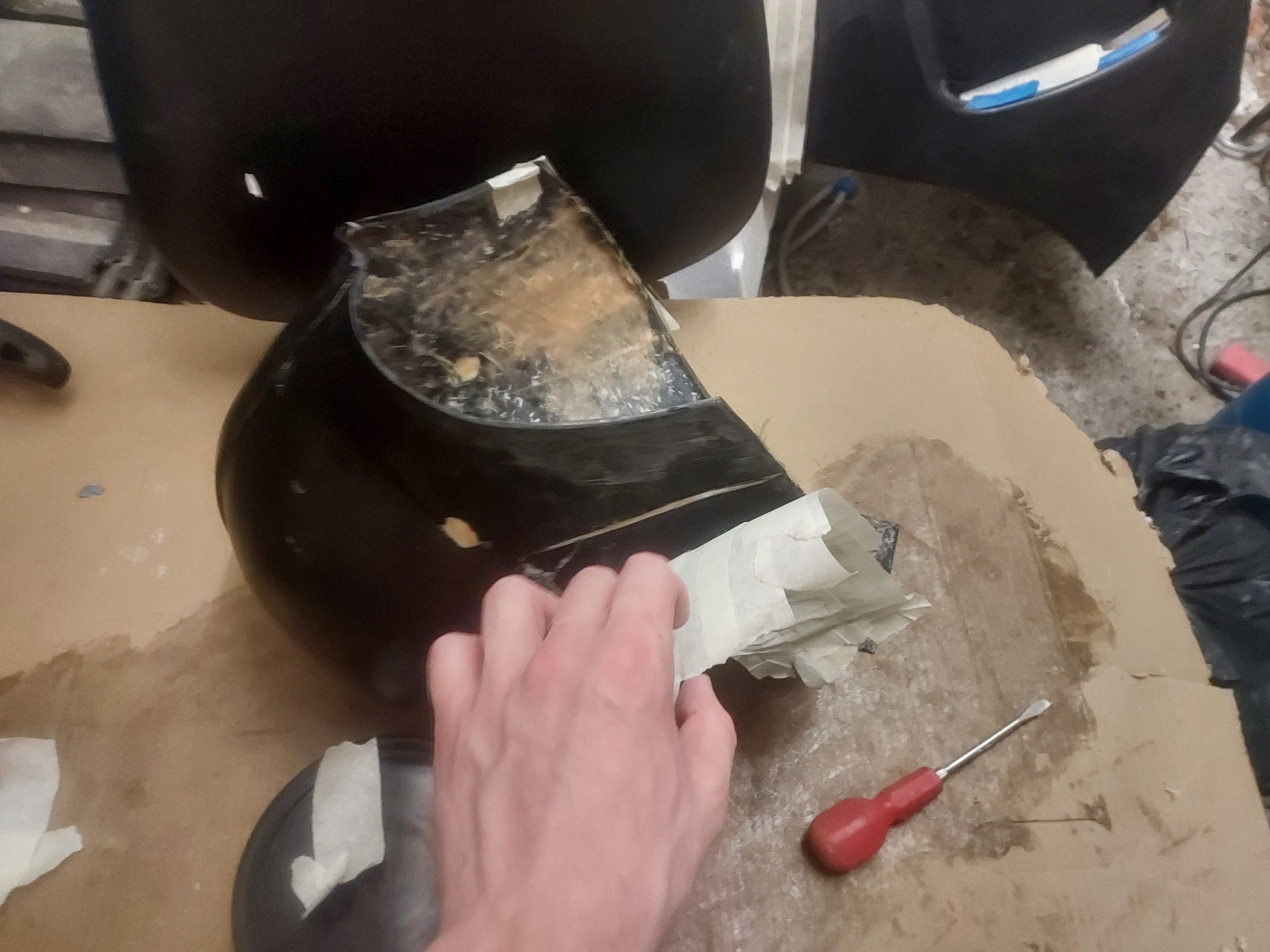

Wow can't believe its been 2 yrs my goodness!! anyhow decided to pick this thing back up and fix the back of the head with some dremmeling and bending and then I'm gonna reglass those parts, I taped the corner into shape I will lay more material over that part when its done.
