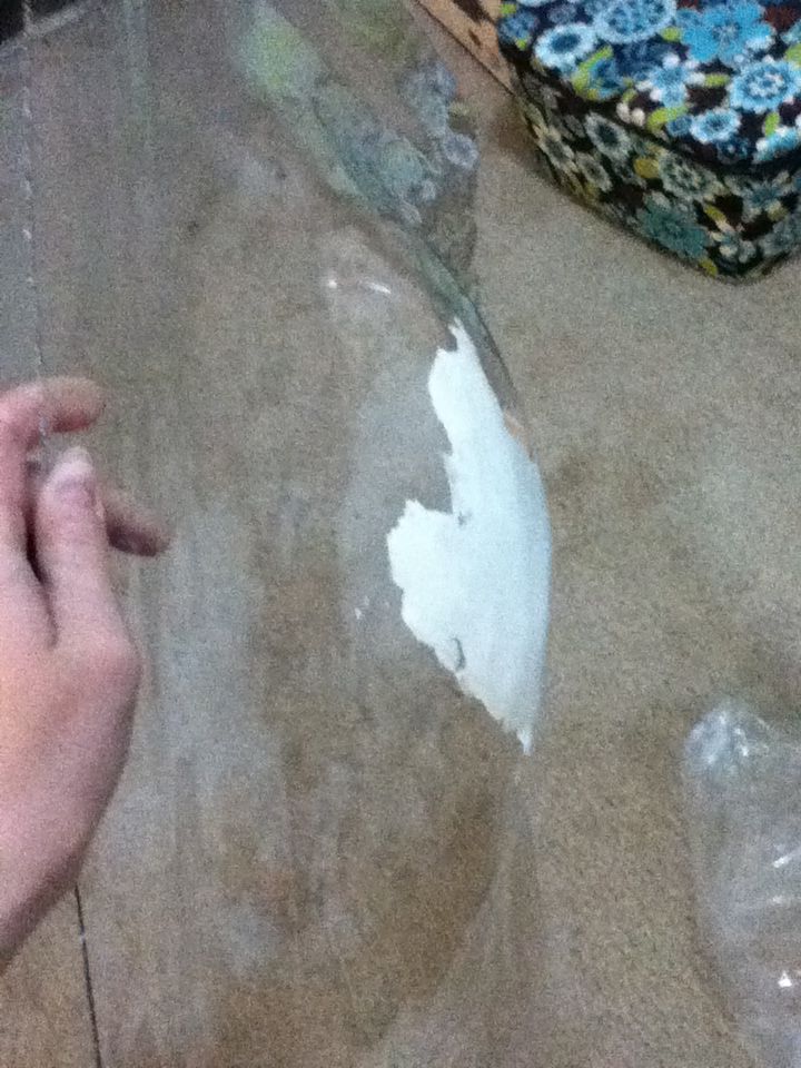

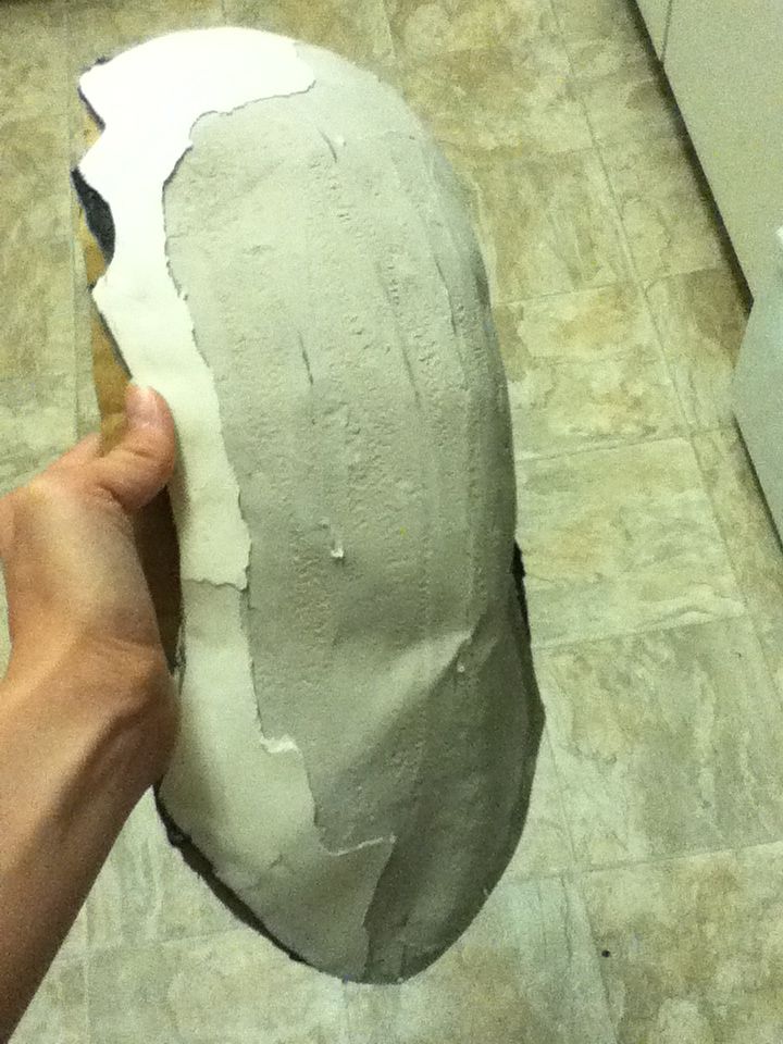

The other problem that I'm not sure about is that my buck not only got crushed, but it got stuck to the plastic. I had to literally rip it out of the plastic, and entire layer of paperclay remained attached to the plastic. What I SUSPECT is the cause of this is because I coated the buck with a layer of Mod Podge. Ironically, the reason I did this was because I thought Mod Podge would give it a sleeker surface and make it easier to remove from the plastic, but I think it actually got sticky when the hot plastic touched it and caused it to adhere to the plastic. Usually Mod Podge makes a surface sleek and fills in pores, so it seemed like a good idea at the time. But now I am not sure what to do to prevent this from happening. I have another buck that I made with Pepakura (so it's cardstock that I resin'd, fiberglass'd, resin'd again, covered with Bondo, sanded, and then added a layer of paperclay to get it extra smooth), but I don't want the same thing to happen to it. I put Mod Podge on that too, but I am definitely going to sand it off.
