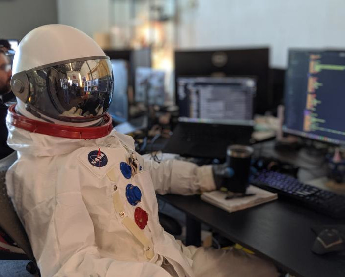

"Finished" product. I liked how finished it was by Halloween but I did have to buy a helmet from Spirit. I liked the more Mercury look it had but still. Either way, it won the office custom contest.
Kokanee
How did you hide the zipper for the suit? Or did you turn the suit around and wear it backwards? I'm starting to work on an A7L suit myself for next Halloween, would appreciate the info. I'll be using a bee keeper suit as a base, but same same.
