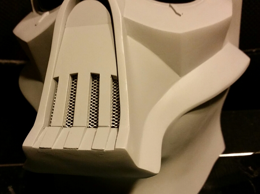

in close up you can see scratches and air bubbles i dug out. i guess this will be fixed with a filler primer? havent used one so far. what brand should i get? preferably to put on acrylic paint on top (im used to tamiya products )
To really fill the holes I would mix up some bondo. this will make sure the holes are really filled up. It's more work.... I'm eager to hear if someone has a better option though as I have small holes to fill on a few things I'm working on.
For such small pinholes, I really recommend "Porenfüller" or "Porenwischfüller" (f.e. by STANDOX)...I LOVE this stuff!!!!!

thanks for the advice! OdiWan72 had mentioned a pinhole filler !
Markus
wow thanks mate! i just ordered some :) thats exactly the stuff i needed (although i didnt know it existed in the first place ) :D

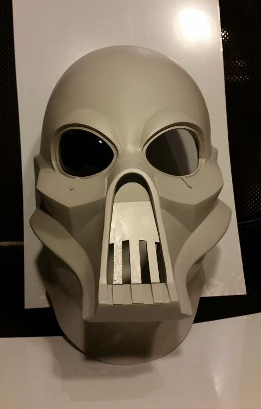

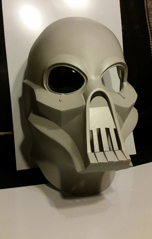

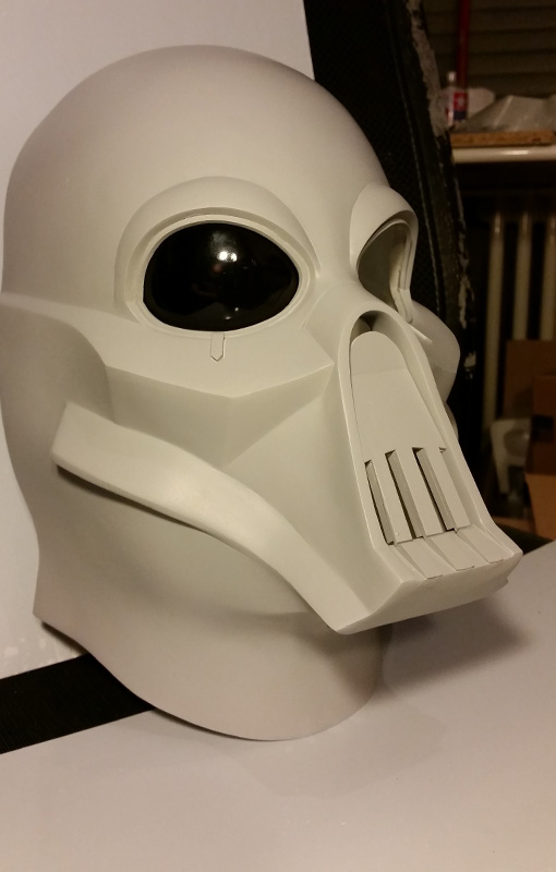

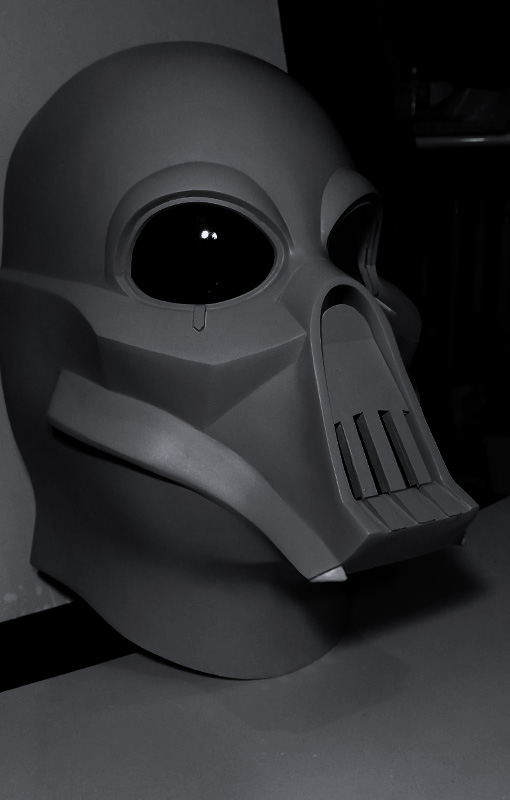

as you can see i applied some quick primer. the rattle can was allmost empty resulting in uncontrollable bursts D: well nothing i can retough with some more sanding . this wont be the last coat of primer anyways. still got to fill the fine pinholes .

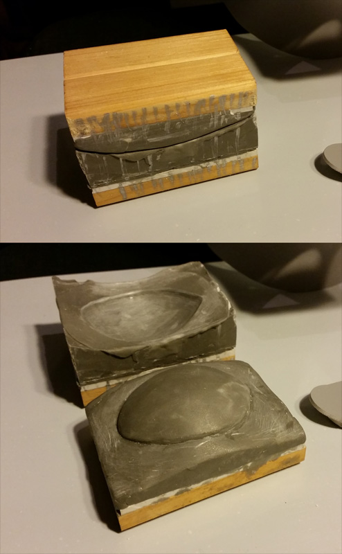

BUT! i was lucky to kinda solve my eye lense problem. in the end i invested much apoxie sculpt to build a 2 part PRESS-mold. the problem with the smkoed acyrlic glas is that its 1mm thick. right now im trying to heat it up enough for me to get it in shape with the press-mold. the difficulty is to not overdo it or ill have little tiny bubbles and a slight blurred vision in the acryllic glas.
anyhow
id be glad to form my lenses and get these done even if they might be a bit flawed. it wont be visible on the "outside" surface
also im happy with the result of the grill :) its detachable as it is now. again the quick primer application was just for the kicks

I have heard of people heating this type of plastic in boiling water. It will get a nice uniform heating profile for forming. Also, an oven would work I think.
thanks for the input! I just tried it:) it sure gets soft to bend it. Sadly not soft enough for me to press it into that curveture .damn
But i had another try with the heat gun.there is something i witnessed. The glass did only get those tiny micro bubble indents after pressing it in shape. It must be steam trying to escape and resulting in tiny air bubble pushing against the acrylig glass.
I applied baby powder to the molds and it worked! It bloody hell worked! Such a great day :D

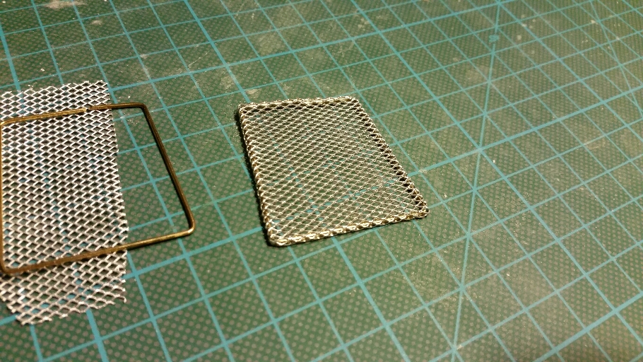

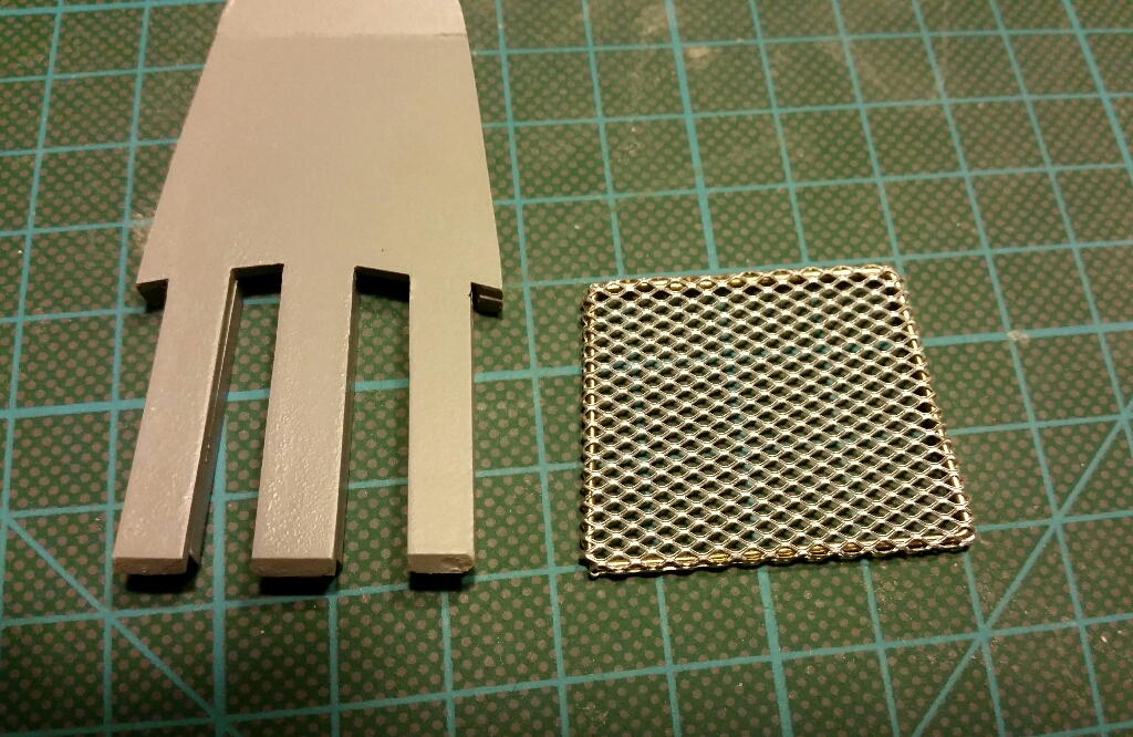

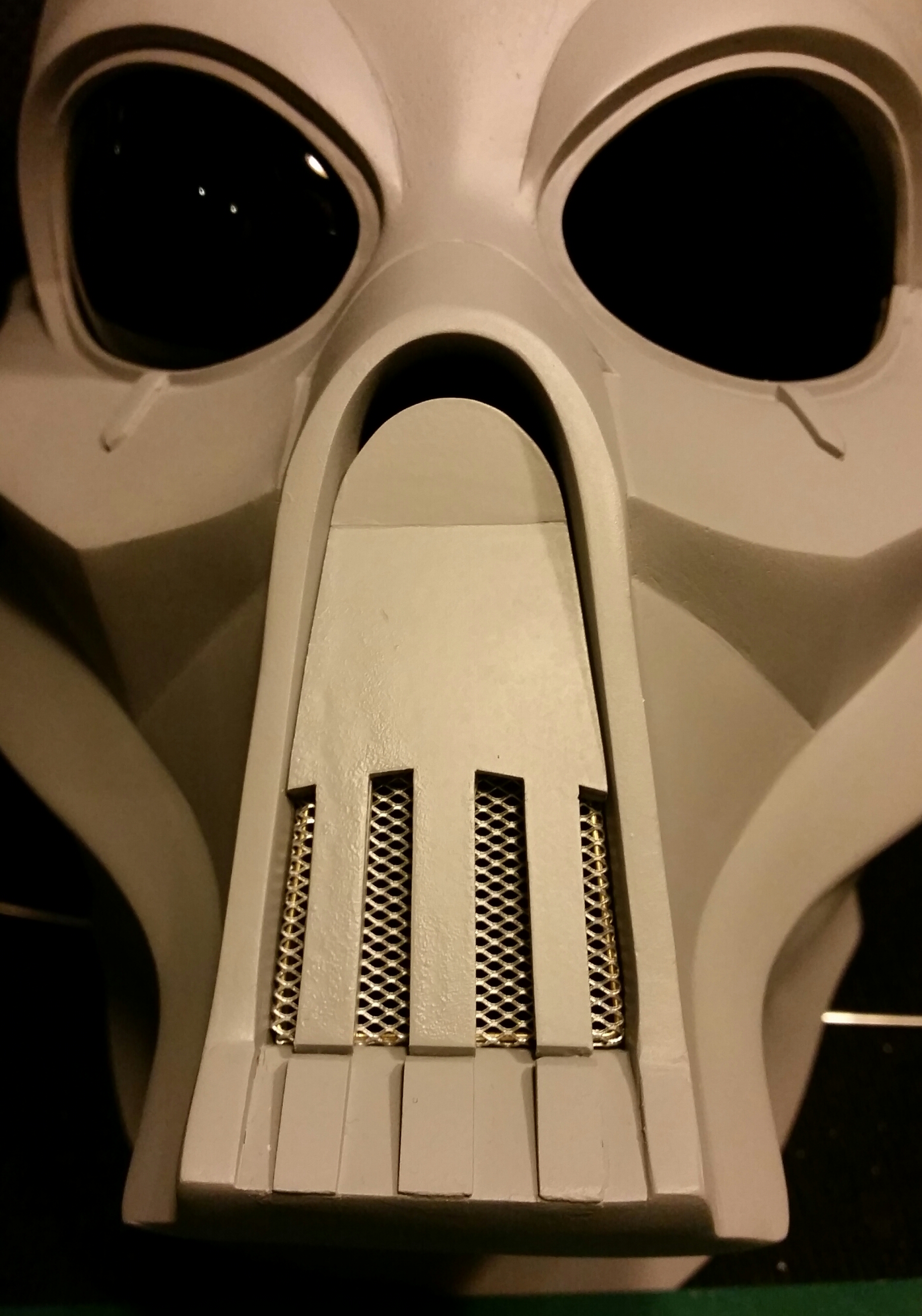

Oh and here i tested some metall grid for the grill :)

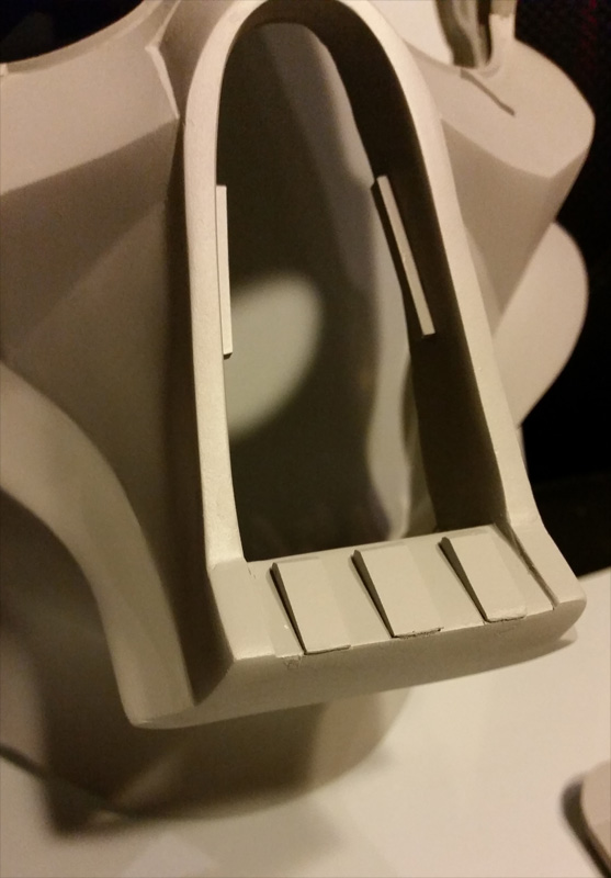

I reworked the metal grill for a perfect fit
Also there is a shot of the bottom opening too :)

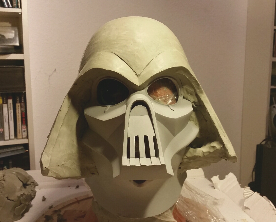

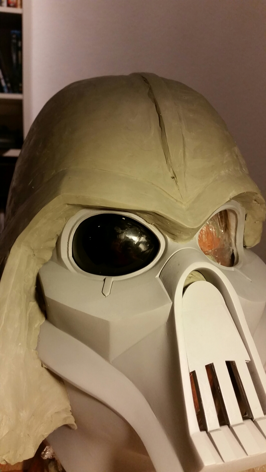

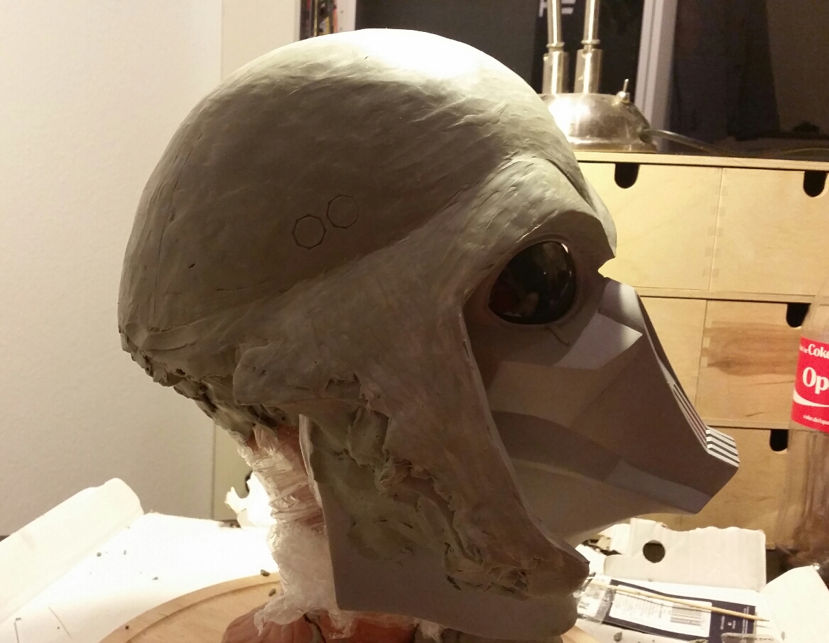

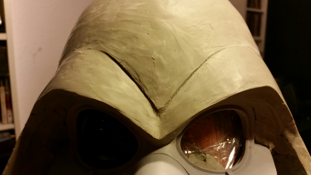

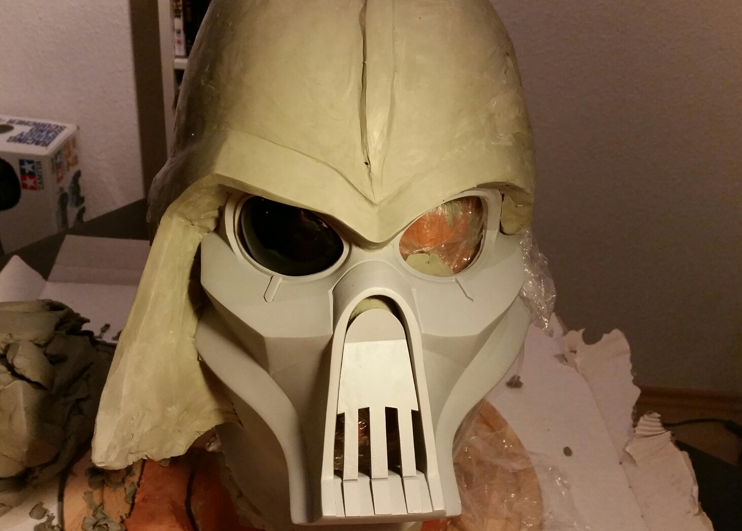

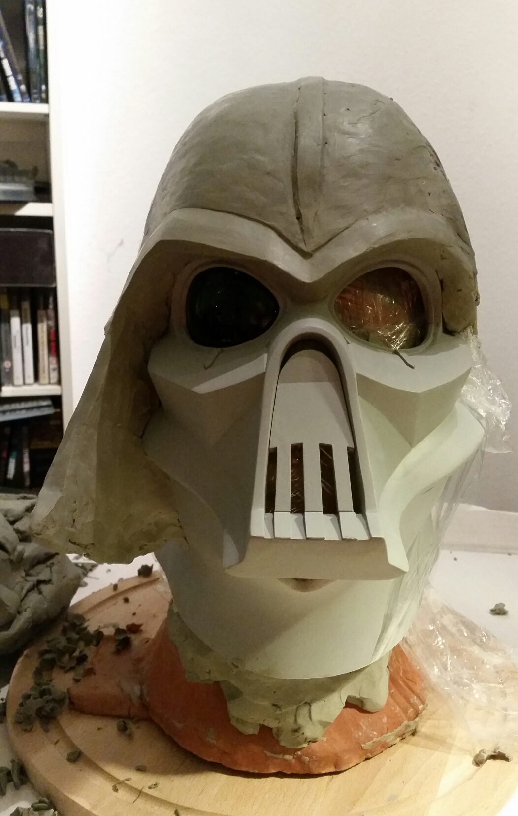

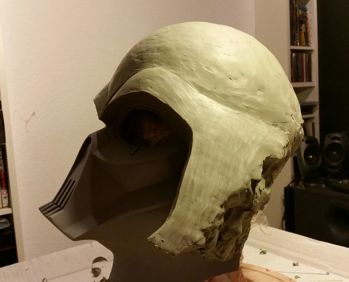

Ok so it really started! THE DOME
(I need to order some more clay soon :D )

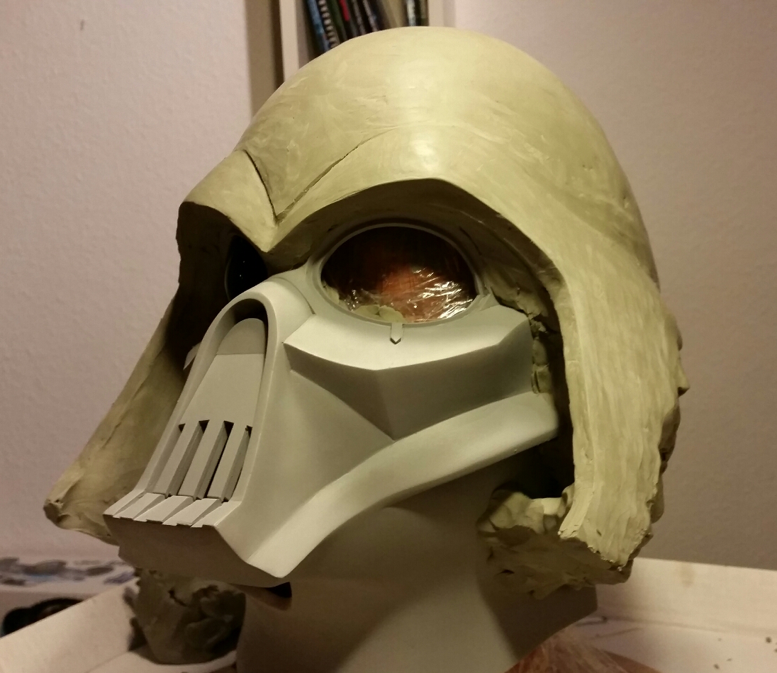

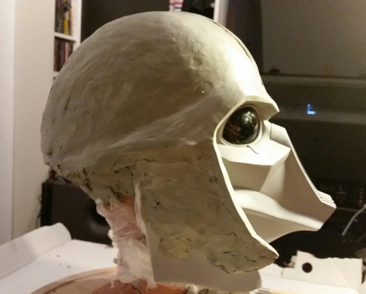

More progress :)
The middle stripe is missing cause id like to make sure that the overall shape is smooth.
I hope you guys like it :)
Cheers
