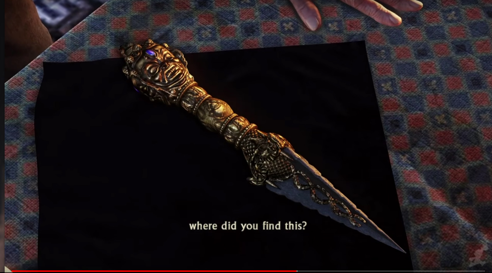

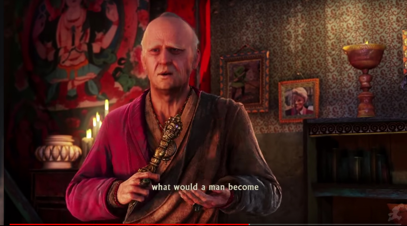

I started browsing through the game's cutscenes to collect screenshots, but there are really few good ones, and it came down to these three screenshots:
There is also some original concept art, that tells us a bit more about the detail that's hard to see in these screenshots but is proportionally a bit off.

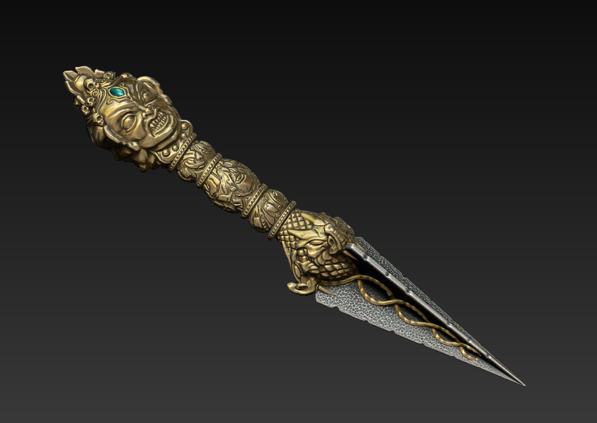

So I sculpted away from there and now have my digital model ready for printing. Let me know what you think and if you would change/improve anything!
This is what I got right now:

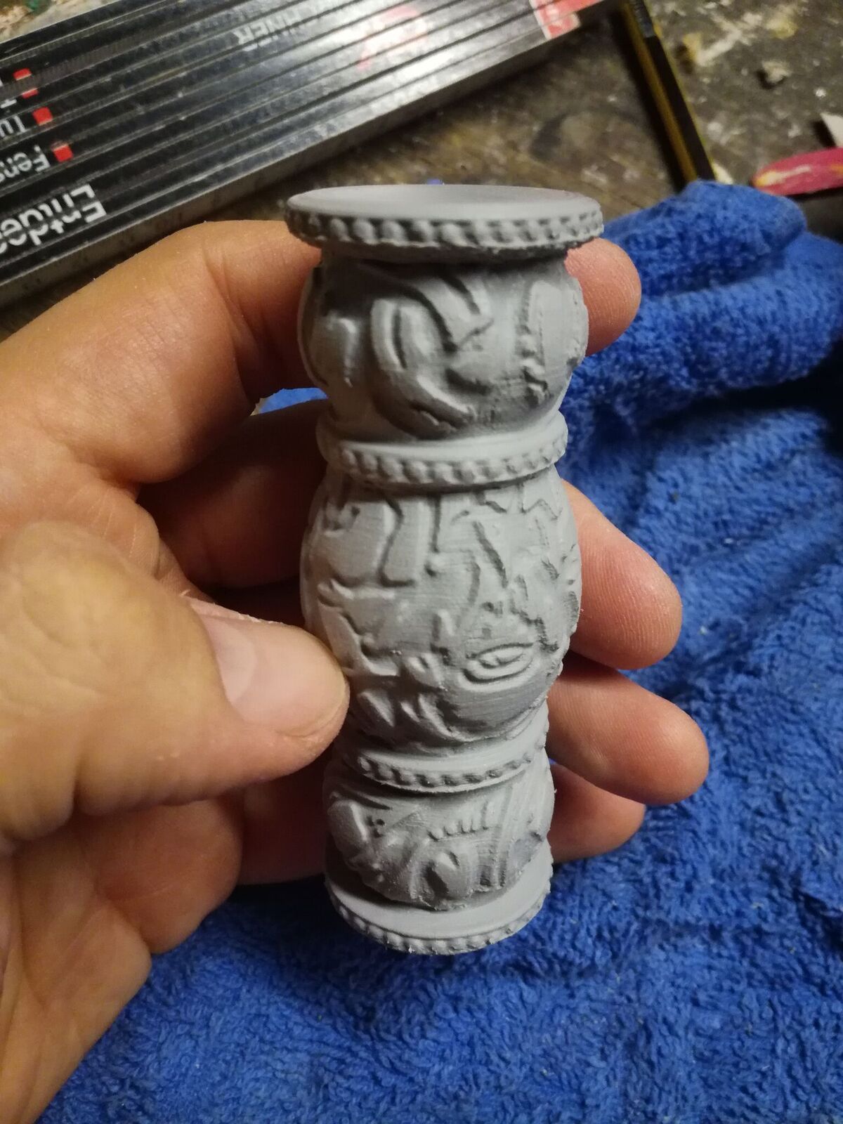

Finished printing, yesterday evening... Raw prints already look really good, I printed on highest quality this time (took close to 50 hours for the 3 parts).
Now starting to clean up some areas and fix some others with greenstuff.

Still filling and sanding, the handle and top are babysmooth know, but there's still some really fine printlines on the blade (hard to see in the pic)...
Might have to sand it down smooth and redo the hammered metal detail by hand...
One more pass and it'll be ready for casting.

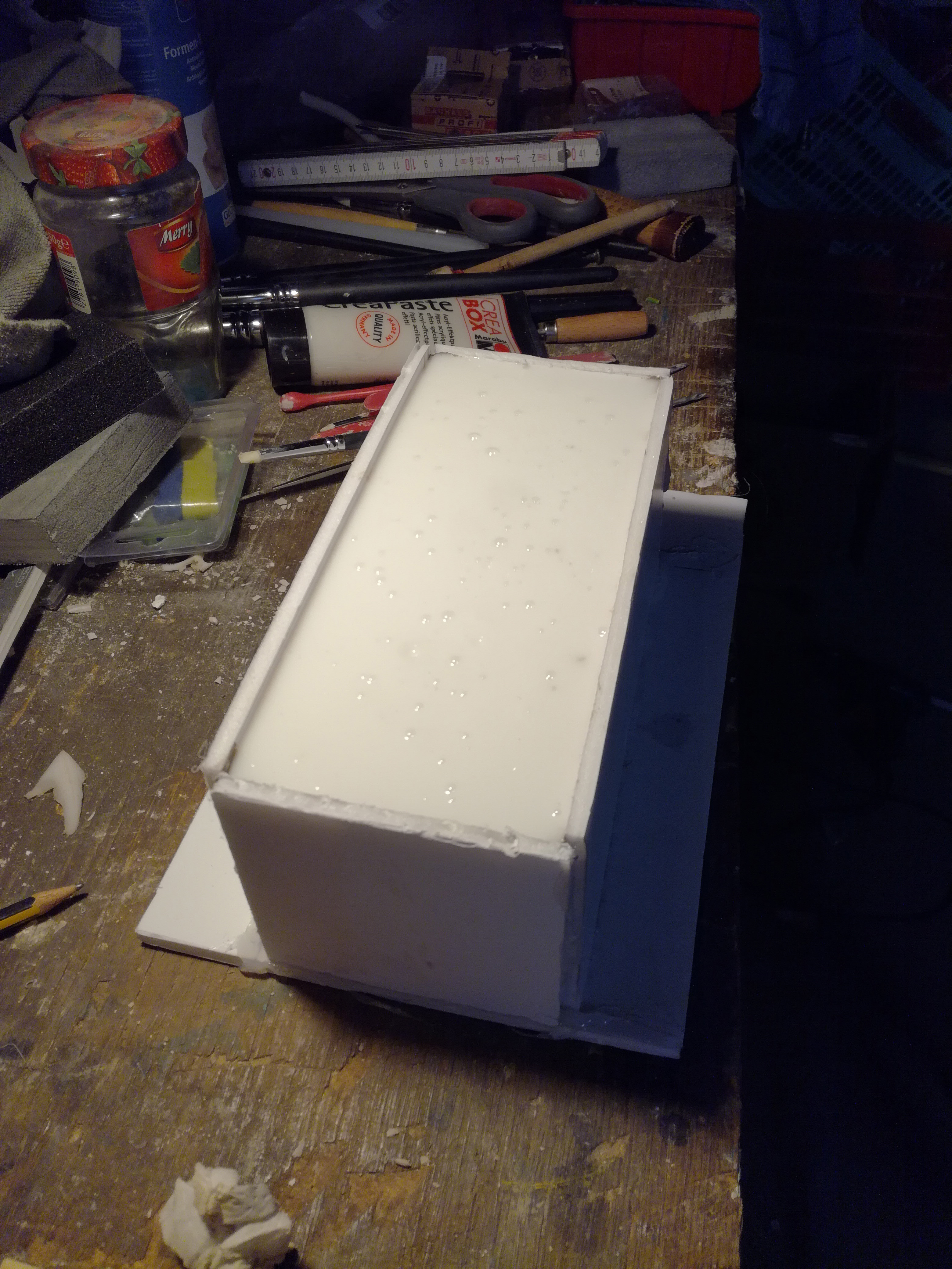

It's really hard to get FDA 3d prints to a mirror finish, but if you only need it for mold making, a cheap and easy way is actually using nail polish!
I made the mold from this and will try casting with turquoise resin tomorrow...

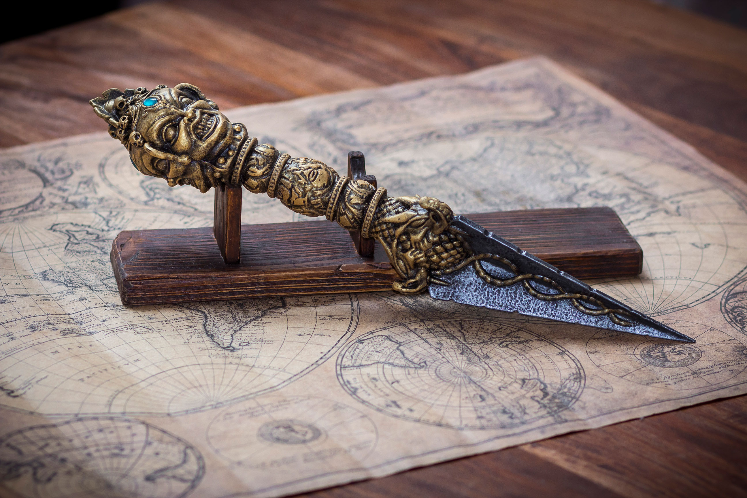

Ok, I'm going to call this done! Had a quick shoot today, to spoil you with proper photos, for once.
I hope you enjoyed this! I'm going to open up a Run thread in the Junkjard in a sec, if anyone's interested!

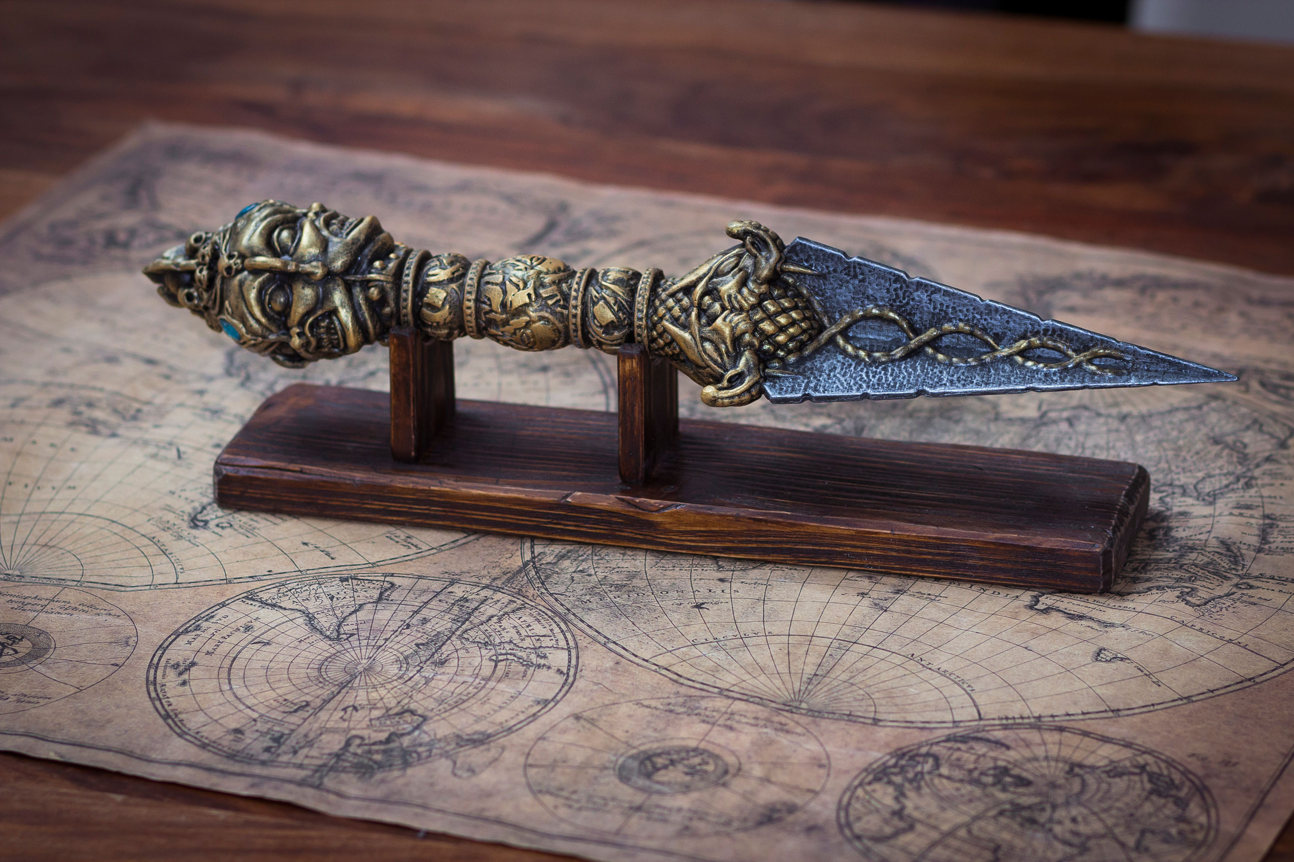

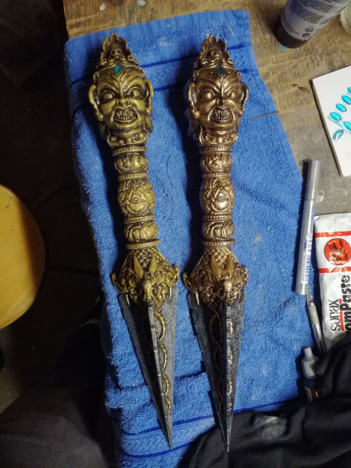

Small update, I tried using Rub'n'Buff on one of my casts, and it came out waaaay more convincing than my acrylic metal paint...
Gonna shoot updated beauty shots on the weekend, when I'm actually able to catch some daylight!
