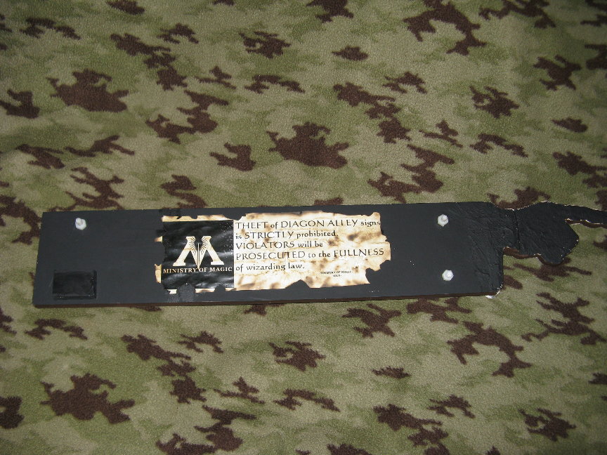

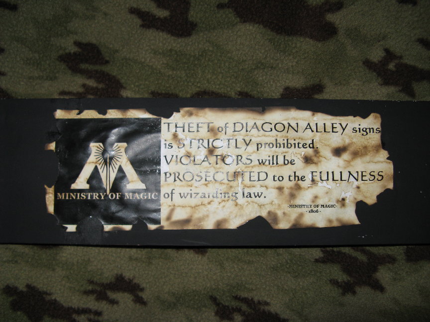

8.) then i thought to myself....why doesn't this sign ever get ripped off by the baddies?!!? well ladies and gentlemen..its because the the ministry of magic is around to make sure this doesn't happen!!! and soooooo....i made this magical warning label for the back!

10.) then using a bbq coal brick i burned the edges all super awesome like! and came up with this wickedness.
11.) all that was left now was splashing some of the next door neighbors blood on the hand and BANG KILLER SIGN! (pun intended)

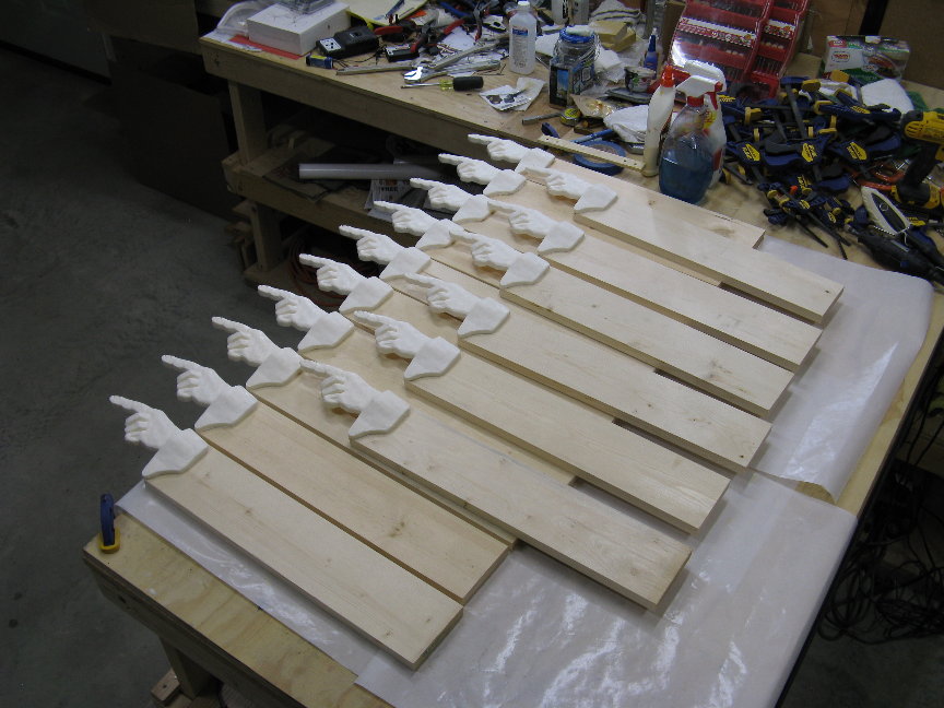

well kiddies...
i've been hard at it working on making the higher quality signs.
got everything molded and casted....and finally after 7 days of work
i have the hands mounted to the sign boards ready to paint!
feel free to add any comments that would help make these as screen accurate as possible. one such comment was that the sign is black and has white letters...if you feel this would make a better sign please comment.
-ultra:ninja
