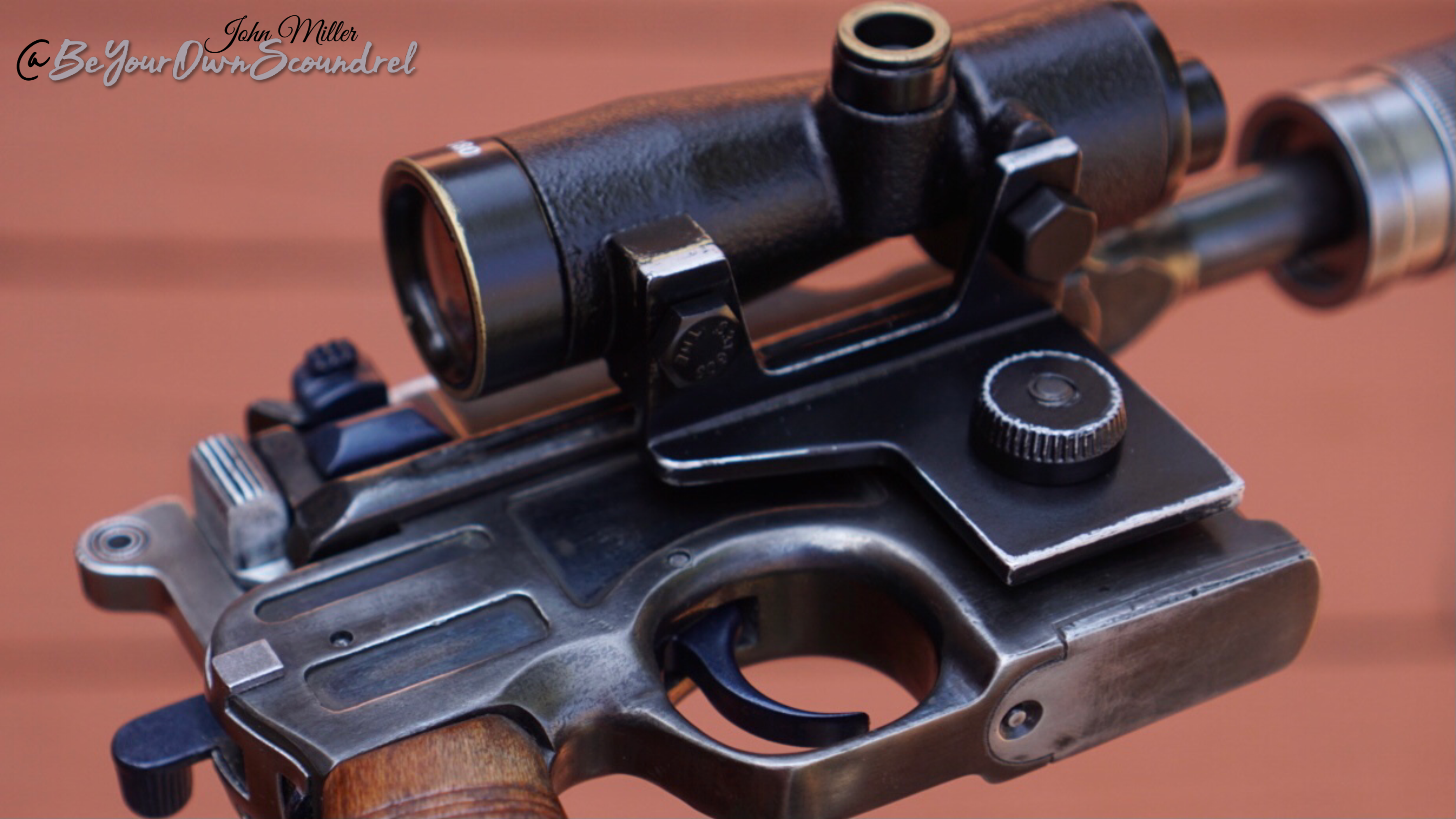

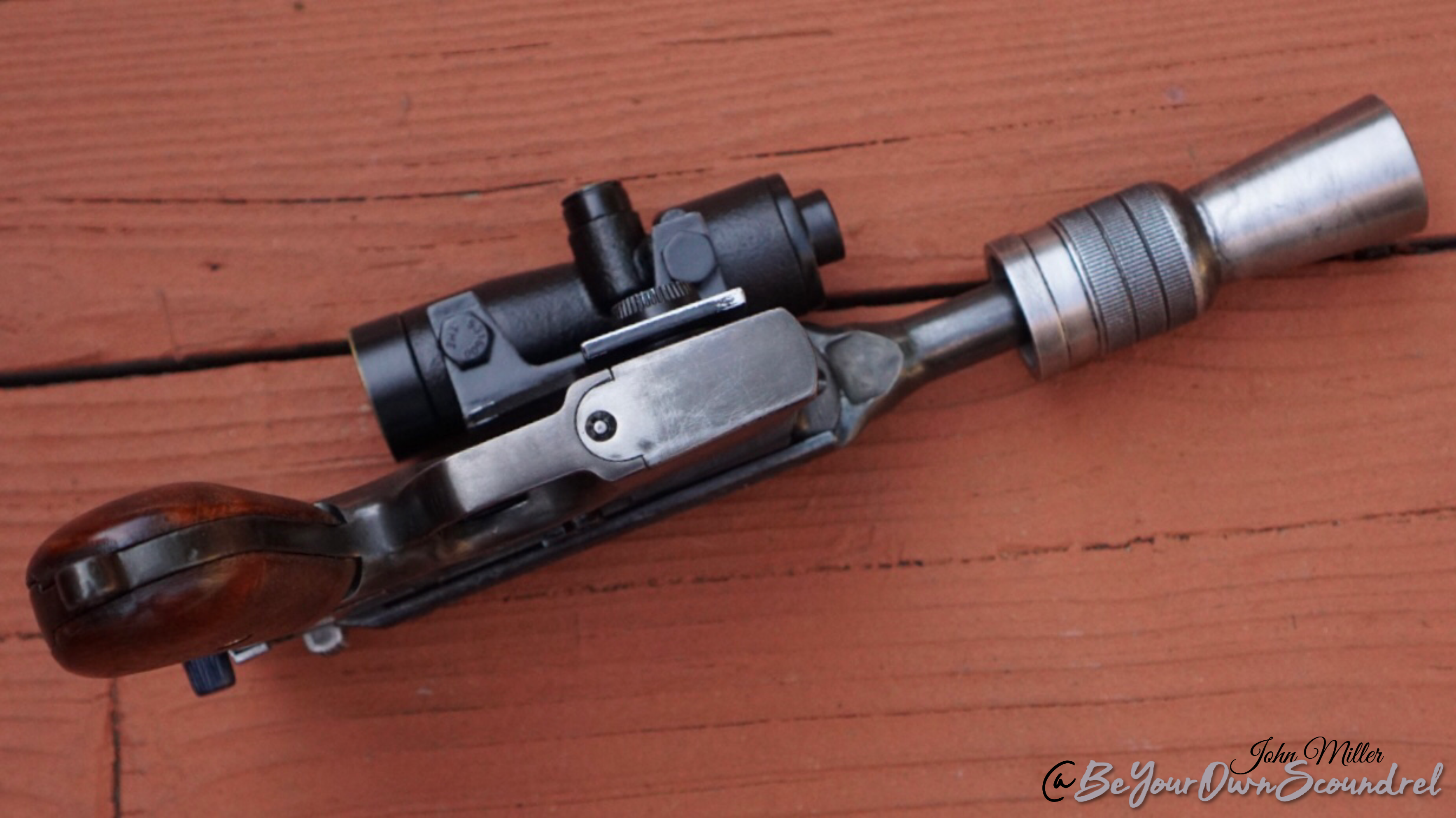

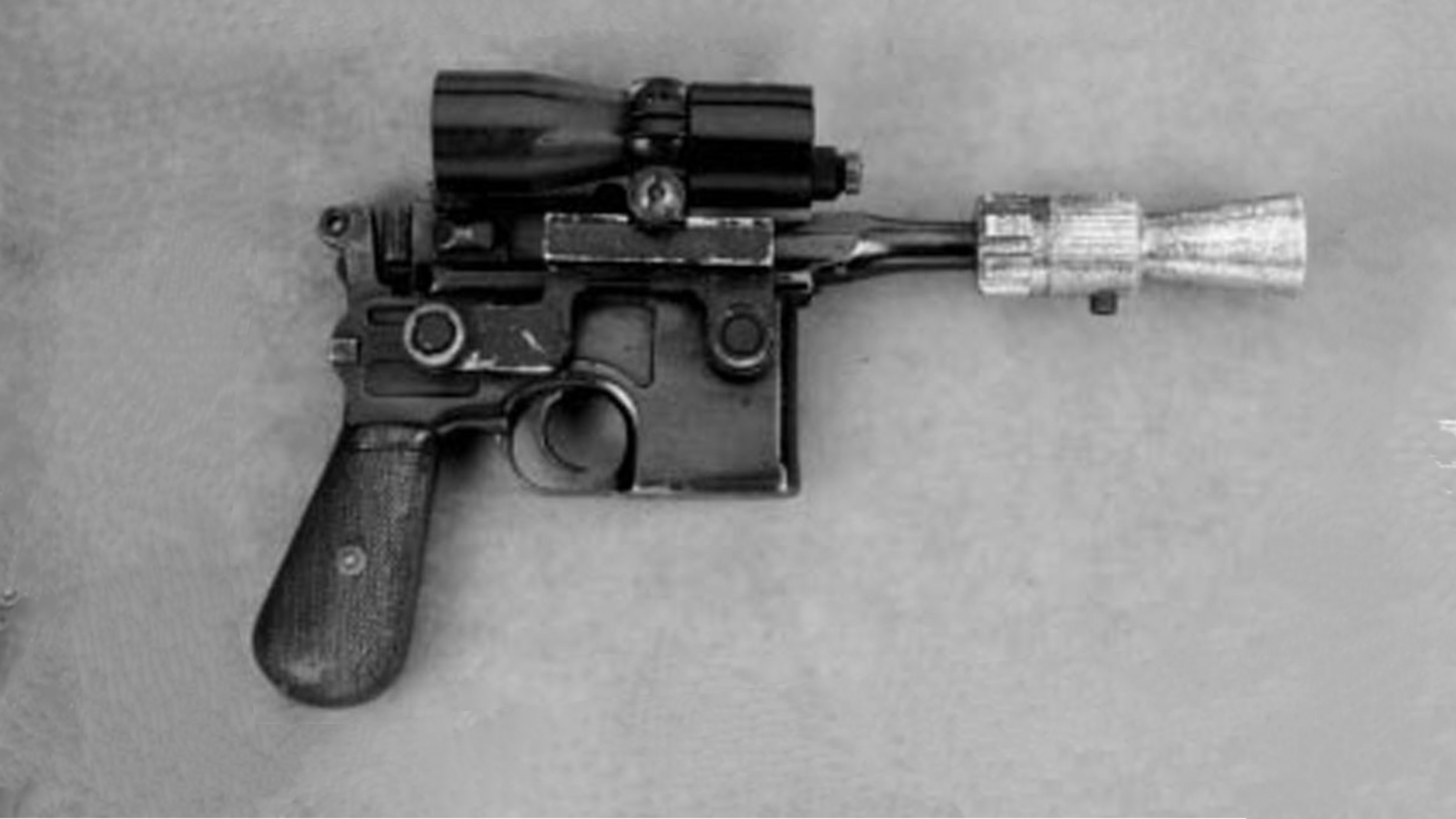

I really appreciate you giving some insight on this. It’s really coming down a circuit or the silhouette I’m thinking. I grabbed this blaster off one of your threads. Is this rail created from your silhouette? Looks great and this is also one of the things I’d like to use it for as well. Make life a little easier and help calm the OCDism that can fester.. :rolleyes:

I really appreciate you giving some insight on this. It’s really coming down a circuit or the silhouette I’m thinking. I grabbed this blaster off one of your threads. Is this rail created from your silhouette? Looks great and this is also one of the things I’d like to use it for as well. Make life a little easier and help calm the OCDism that can fester.. :rolleyes: View attachment 1452355
Yep, that's the one, thought I've made a lot of "special modifications" since then. ;) (actually not that much, that's the never ending project! I need to get a real scope for it!). I can send you the Illustrator file I made if you like. It's time consuming but not at all difficult to trace from photos of scratched up props! The Silhouette cuts surprisingly small details. I think I have some more pics around somewhere, will try to dig them up...also it makes a really cool almost musical sound if you have it cutting big arcs! Just sayin'. :D

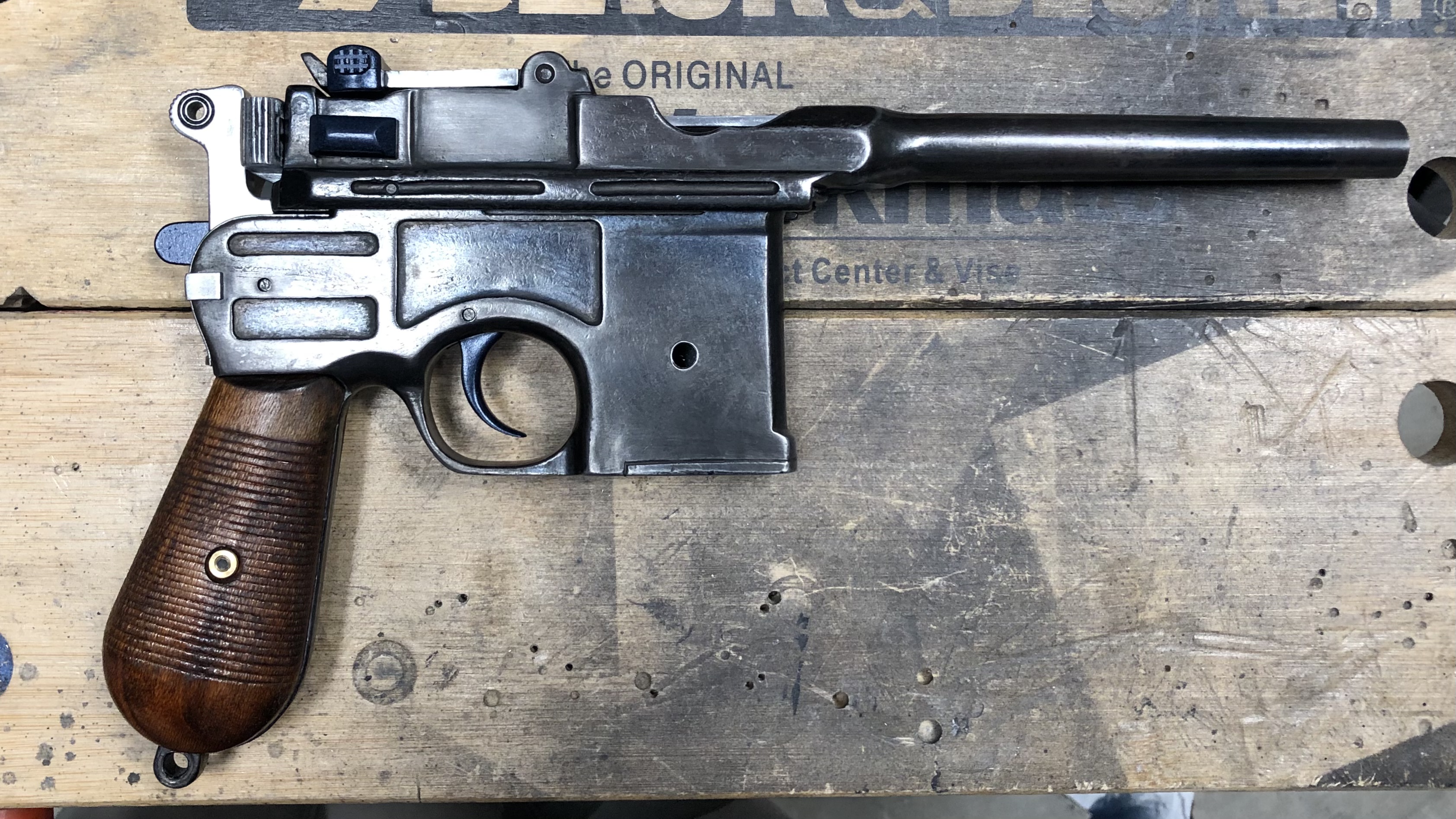

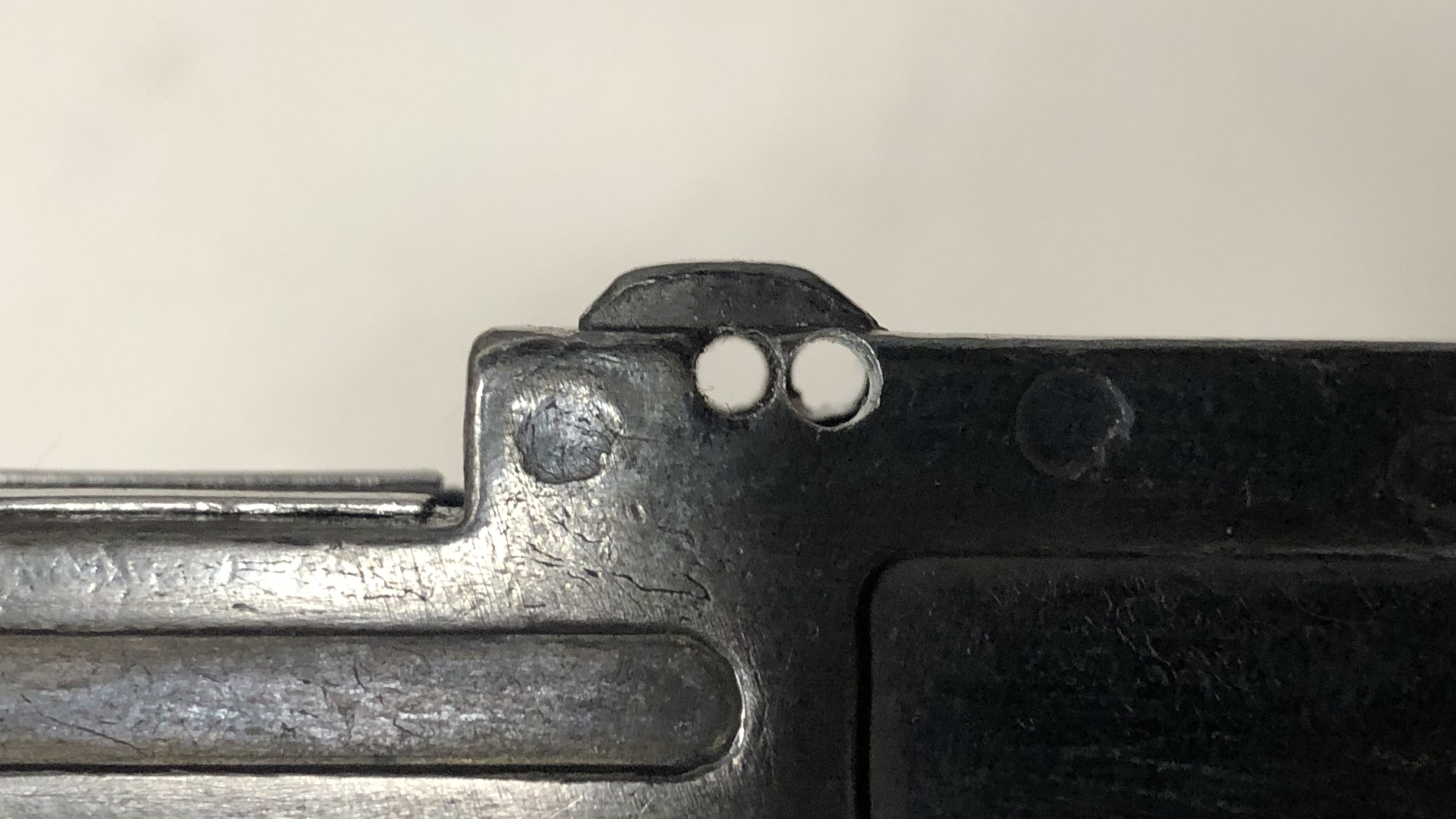

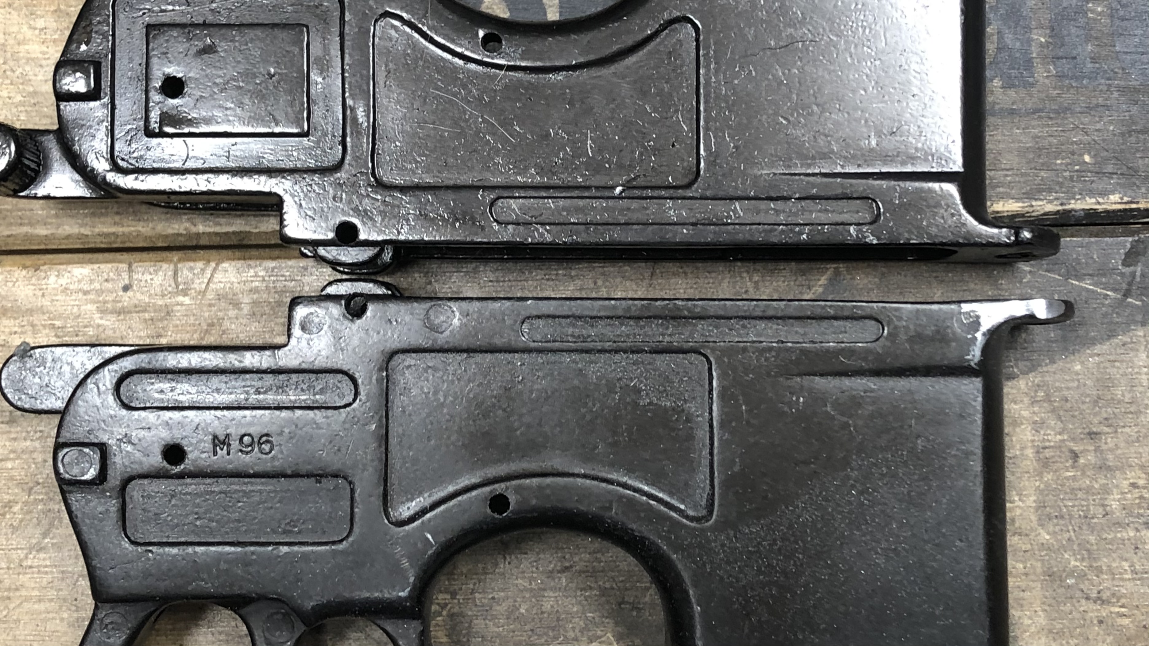

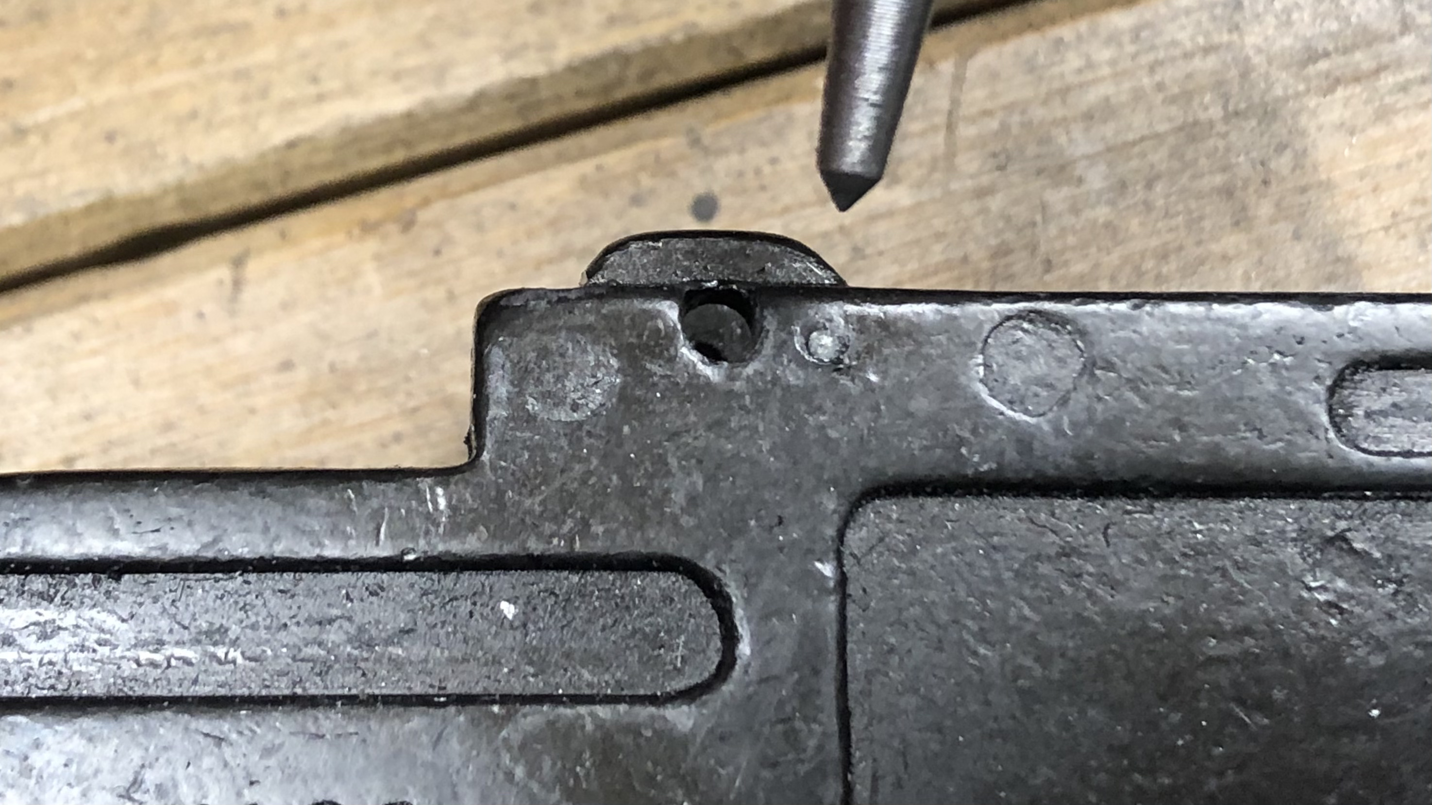

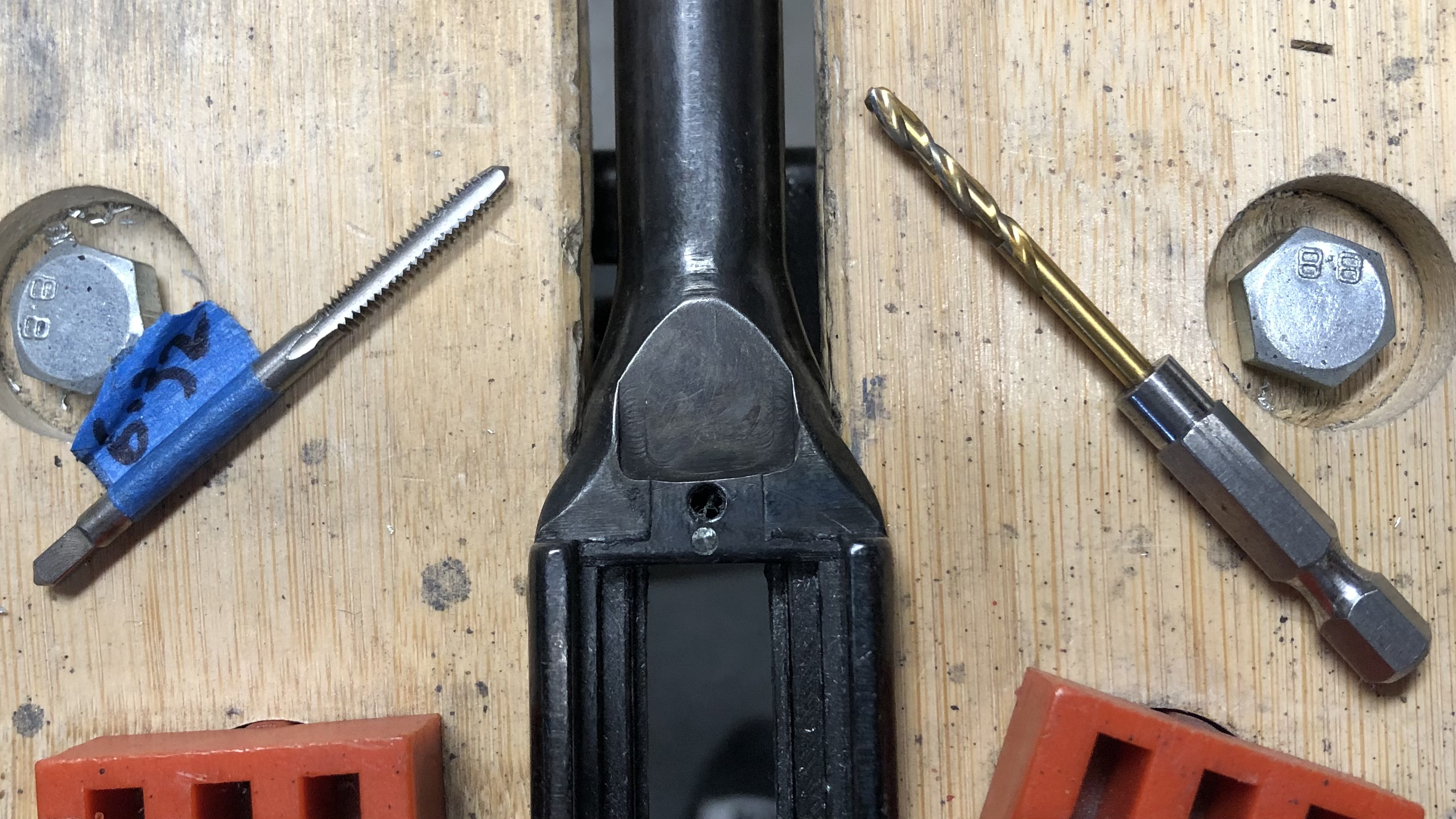

There are 4 mods you need to do to slide the top of the denix forward. Once you get the denix separated you can begin by sanding down the front two lips on the bottom half of the denix. This will allow you to slide forward the top half and proceed to the next mod. Dremel works perfect here..

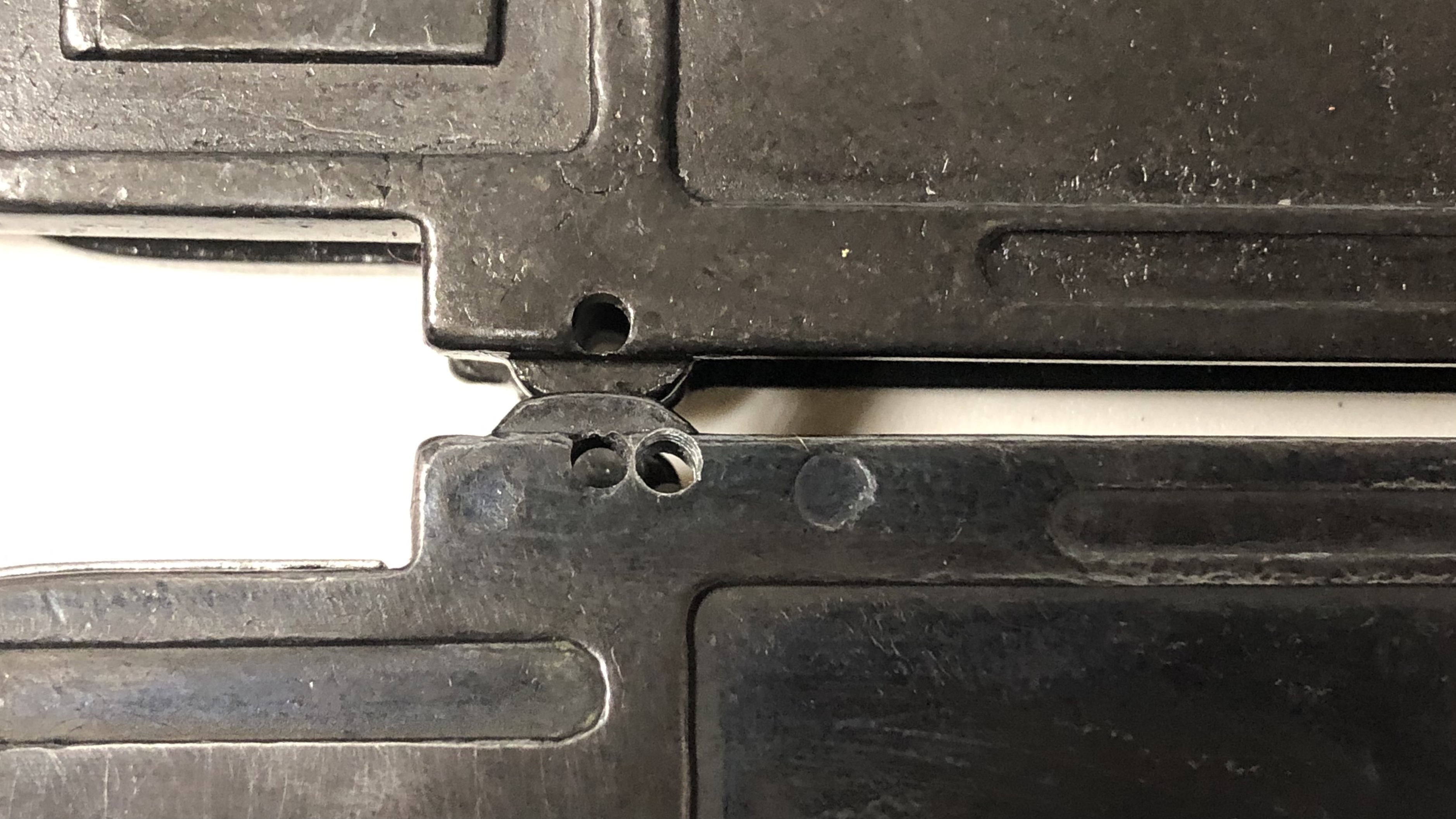

Next you need to create two new holes in the back for new pin placement. This can be tough because if you don’t do it right your denix will sit awkwardly on an angle or the pins won’t fit at all..
So the best method I’ve figured out to avoid all that.. is simply to use the pin itself, a hammer and a center punch..

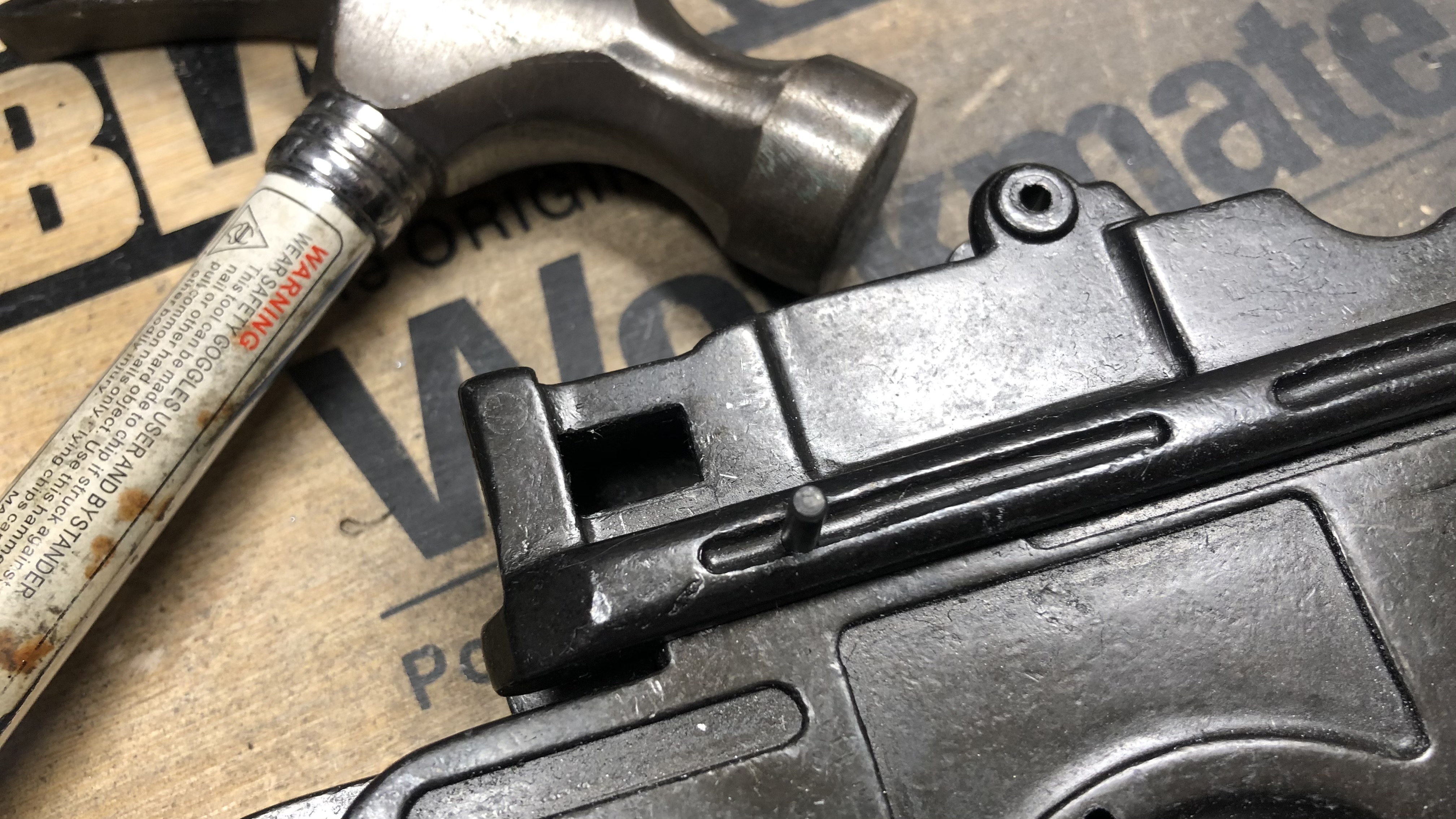

Attach the top now that the front lips have been removed. Line everything up and hammer the pin in place so it will leave a circle mark as a guide. From there use the center punch to mark it and start drilling. I use a 1/8 drill bit so the whole is big enough for the pin..
Now IMHO the hardest part of this mod. I have a mini mill which helps a lot here but I originally did it will a drill. You have to move that front hole back on the top part of the denix. But just make sure you drill straight down when creating this new hole. If not the hole will slip out the back or towards the front hole itself and then you’re up the creek at this point.
I basically use the center punch to create a hole that is dead center to the hole that’s there and the back. Then drill straight down..

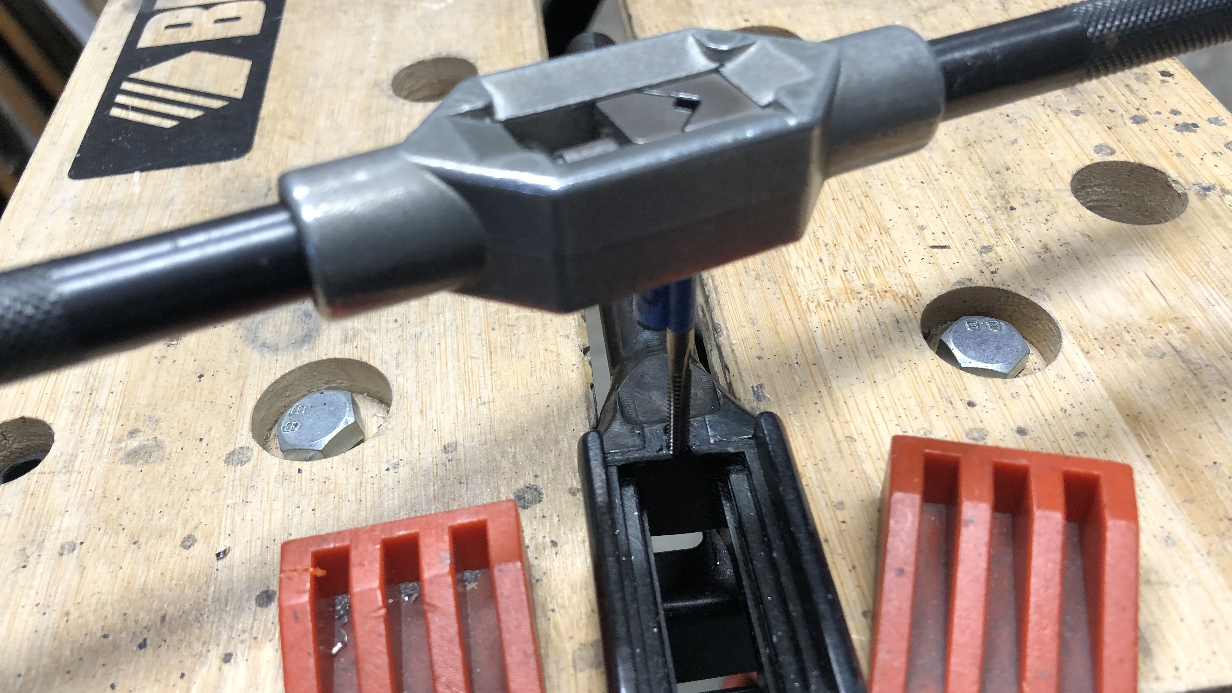

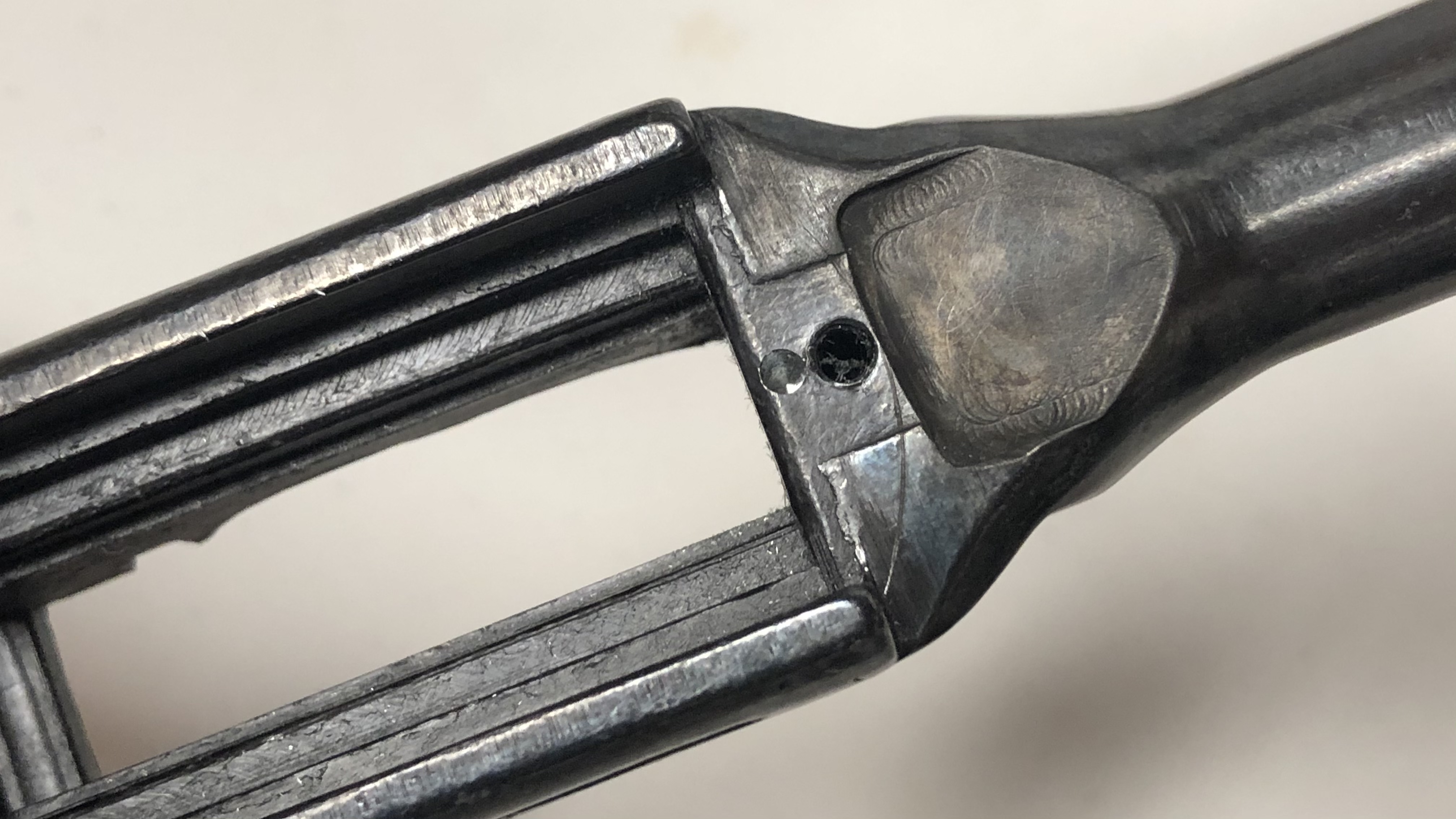

After I have this hole template I redrill with a 7/64 drill and tap with a 6/32 tap..
The last mod is taking off some metal on the inside metal part. Sorry I don’t know the technical names of these parts but it should be obvious what I mean I guess. Simply reduce the sides so it allows the modded top and bottom to fit accordingly. Cut approximately 0.160 inch off each side. Otherwise it will restrict the top from sliding back..
After that, unless I missed something you should be good to go. Just reassemble everything and here you have it..

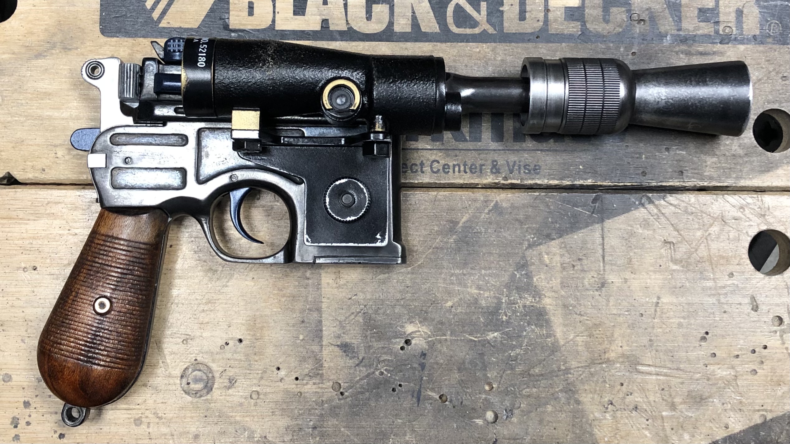

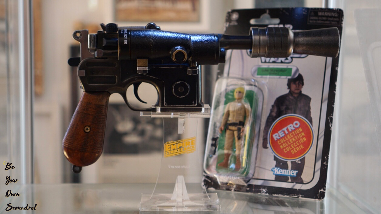

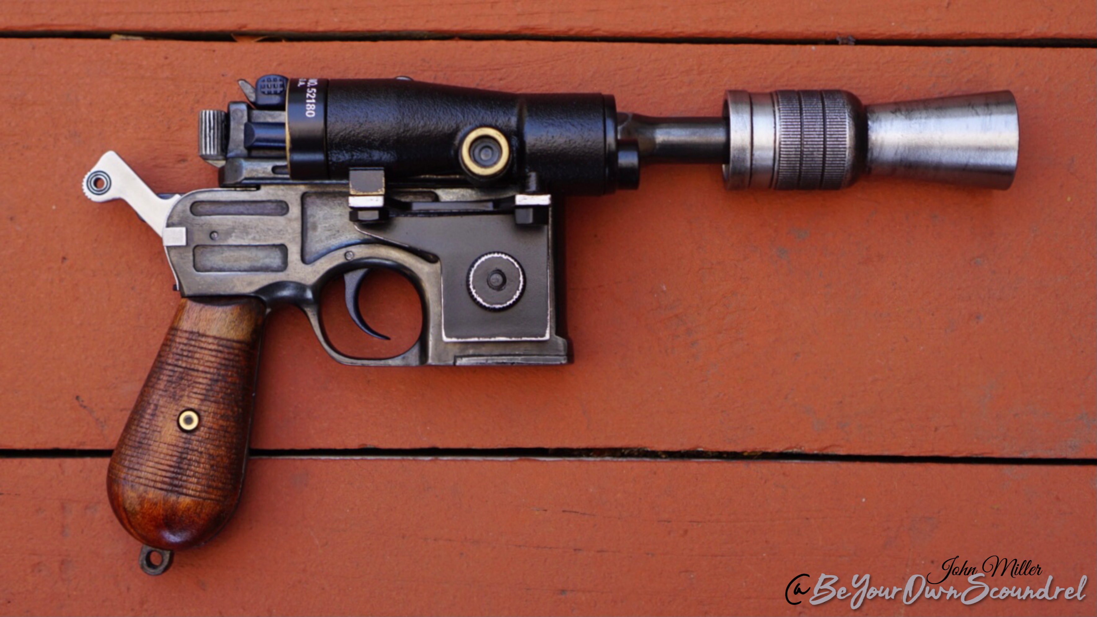

Here is this Mauser I was moding all finished as a Bespin

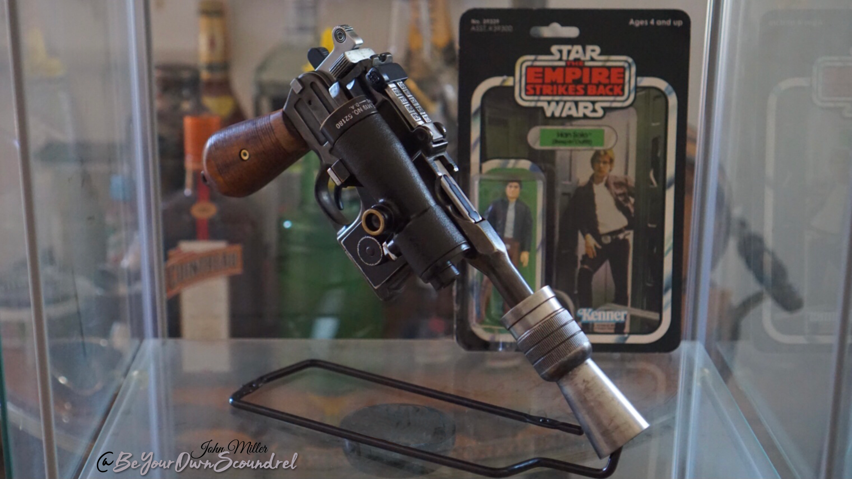

Which mill do you have? I've almost bought a Proxon about 10 times now but went with 3d printing instead, which I think I get more use out of. Love the pic with the Luke figure...I adored that figure when I was a kid! His little Graflex!! <3

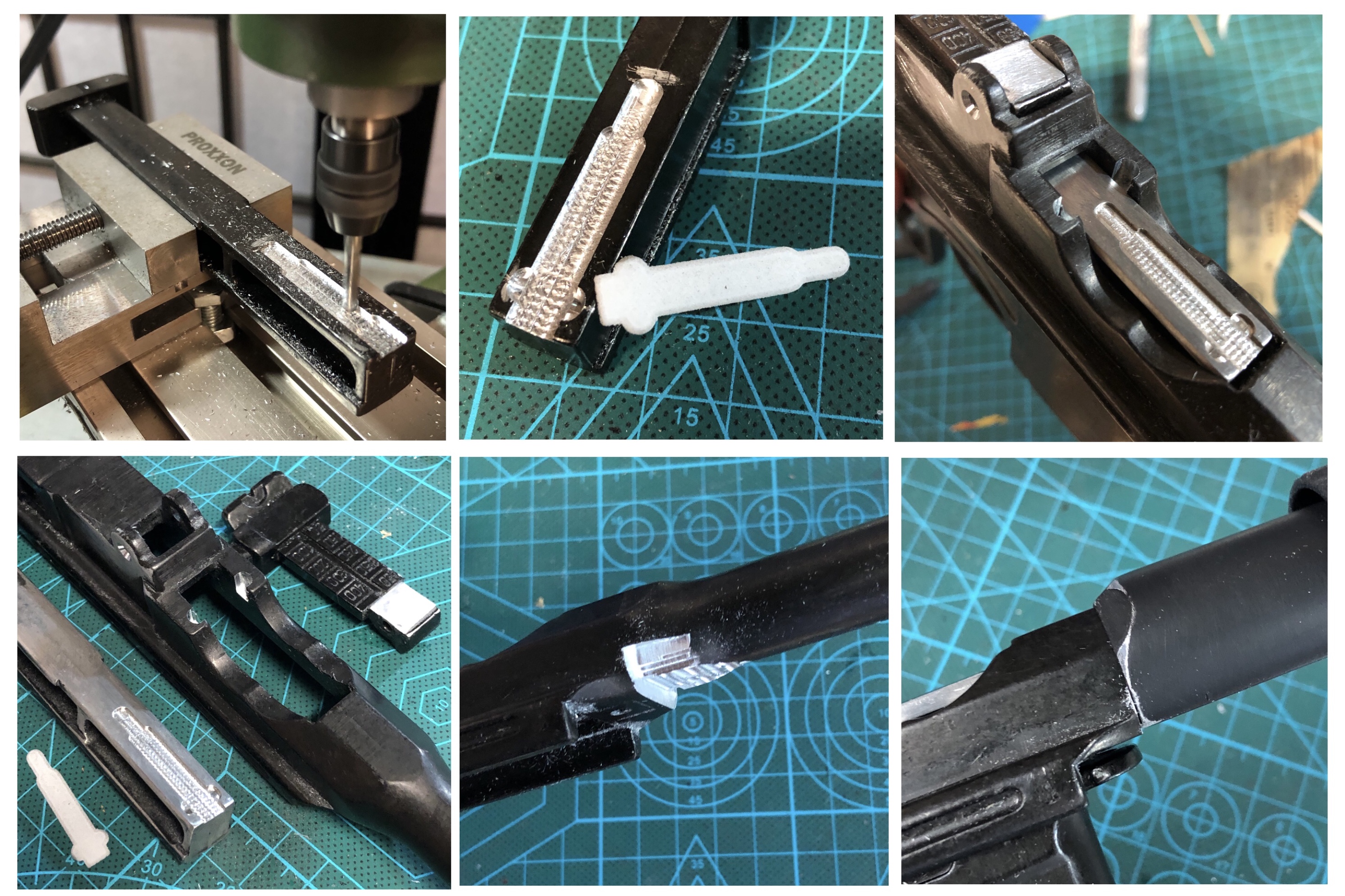

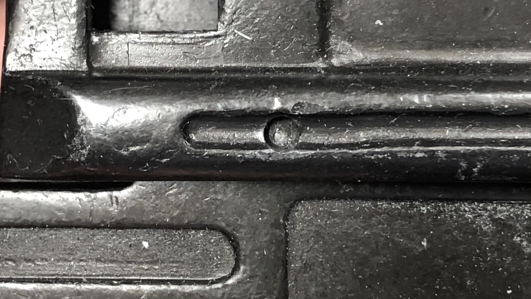

Proxxon micro mill. Probably the exact same one you uve been contemplating. It takes a little getting use to as everything has to be done by hand but I’ve figured it out pretty well. Once you do have the turns figured out you can repeat the process pretty quickly. It’s extremely accurate and I’m able to create the extraction details to a T! I have an extraction mark deisgned up that I 3d print, then mill in the spacing for it with that mini mill. I do the bullbarrel for my ANH as well as a few other details. Honestly it’s truly amazing what you can accomplish with it. I love it.
Here is also a Han Bespin set up the same as that Luke. This is a repackaged original Kenner figure but ya these are very nostalgic!

Nice work on those extractors!! That must have taken some practice! I had some laser cut from stainless steel for my blasters, cheap too! But no milled recess. Yours are so cool!
chubsANDdoggers
Thanks man! It actually wasn’t that difficult all things considering. That mill is very accurate so basically just trace out the shape and then start counting ur turns along the way until it’s all traced out. But regardless it’s a pretty good feeling when it does fit so snugly. These builds are like the best adult LEGO’s one can have. Truly very rewarding. If you ever want to try you hand with some of my parts or you want me to mill in some of these details let me. I’d be happy to help if I can.

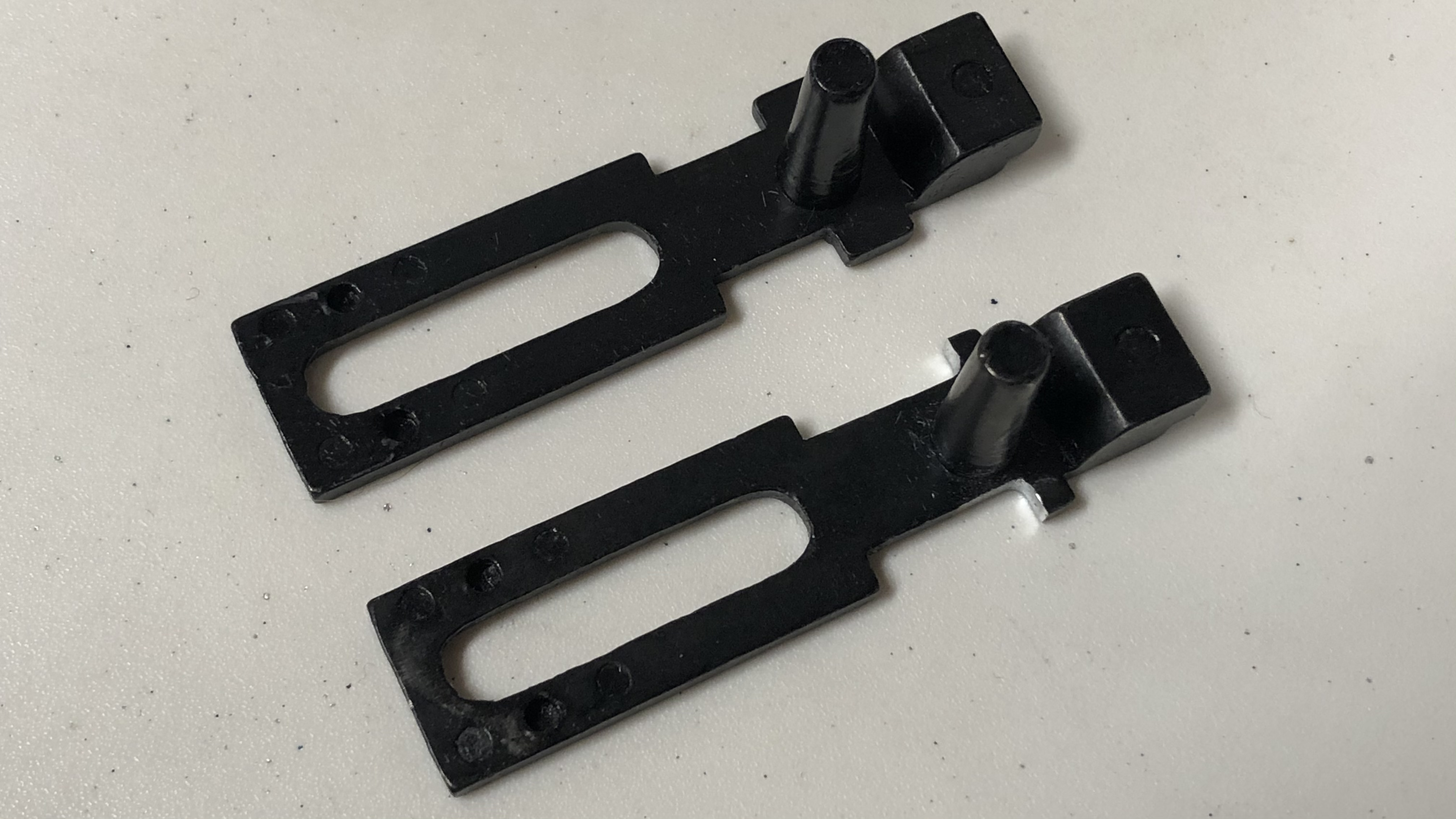

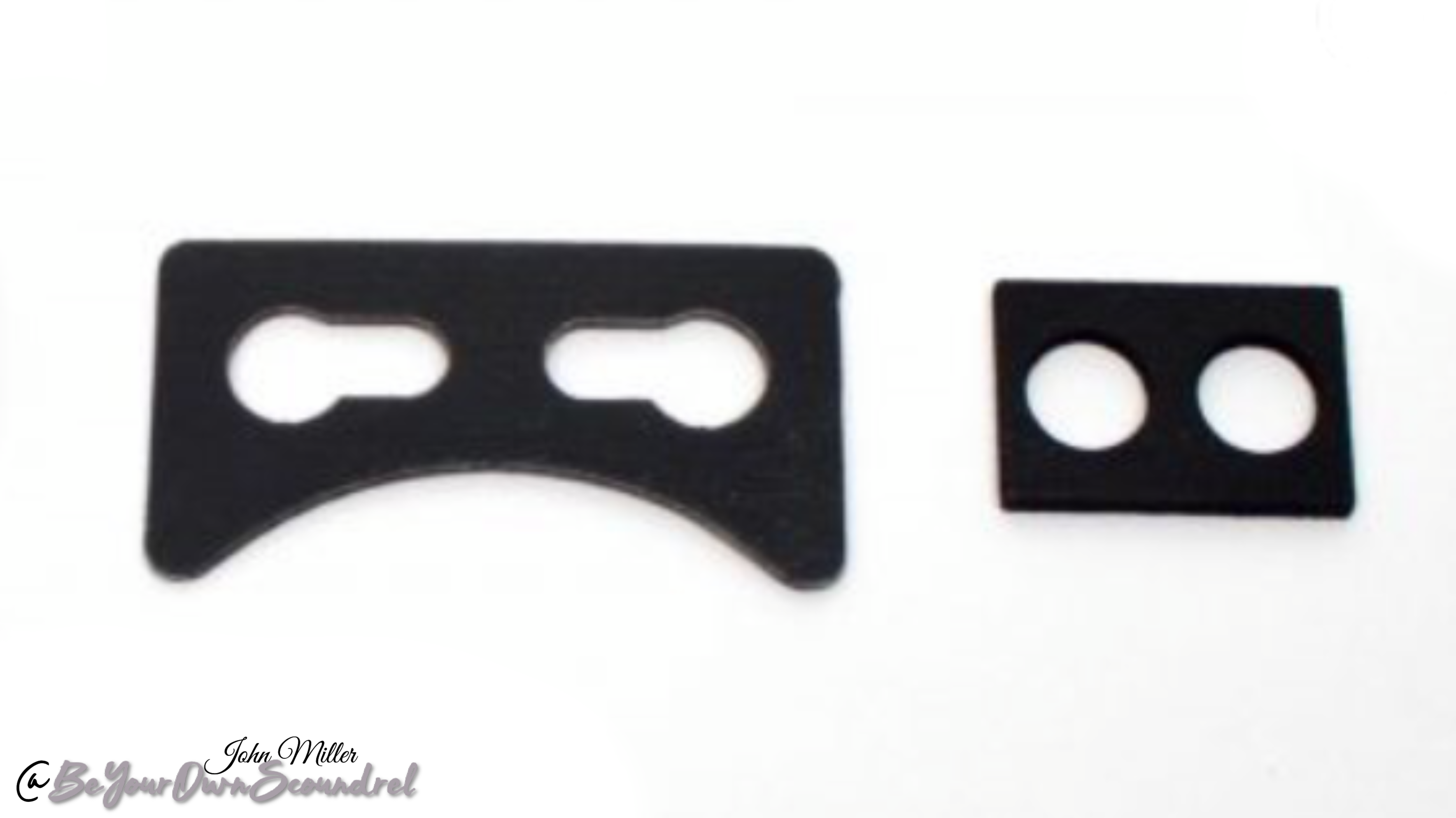

Yes that’s the mill I use to create all my details. I can’t recommend it enough but unfortunately it won’t do the Endor blasters left side though. The machine and the mill bits themselves are just to small. I did create these parts though that work in a pinch if needed..
