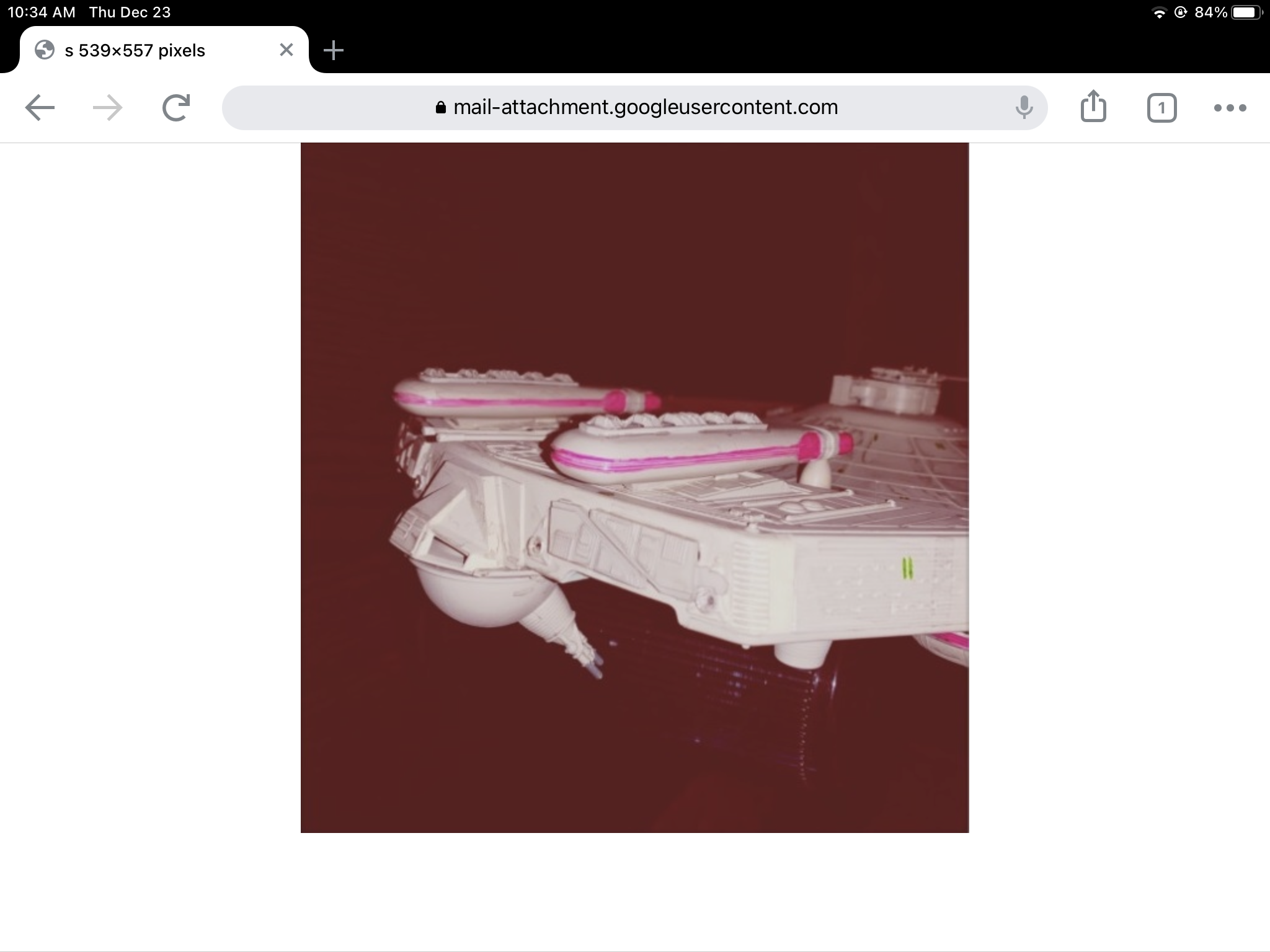

So, small update… I’m waiting for my base coat color to arrive, and I have window masked the bottom saucer. HOWEVER… the bottom saucer MIGHT be redone, because someone on a FB group has said they have scans of Polaroid pics of the bottom and side of the studio model, and if he can find them, he’ll send them to me. So, I’m awaiting those references before I commit any base coat to the bottom.
BolianAdmiral
So, a friend was extremely gracious, and shared with me these photos of the Trieste studio model, which haven’t been seen before. As you can see, the bottom has more bits that I’ll have to add. I have everything I need, EXCEPT for the two long cannons on the bottom. I would REALLY appreciate if any eagle-eyed folks here can let me know what kit those long guns are from. I am convinced they’re definitely military parts, but I don’t know exactly what scale or what kit they’re from. If anyone can help identify them, I’d be extremely grateful. TIA.
stevielewis
Is the structure that one set of guns is on part of the Flackvierling 38?
Edit: I figured it out, the structure is from the Flackvierling 38. I've used a few parts for that structure on my Centaur build so I need to get those parts again.
