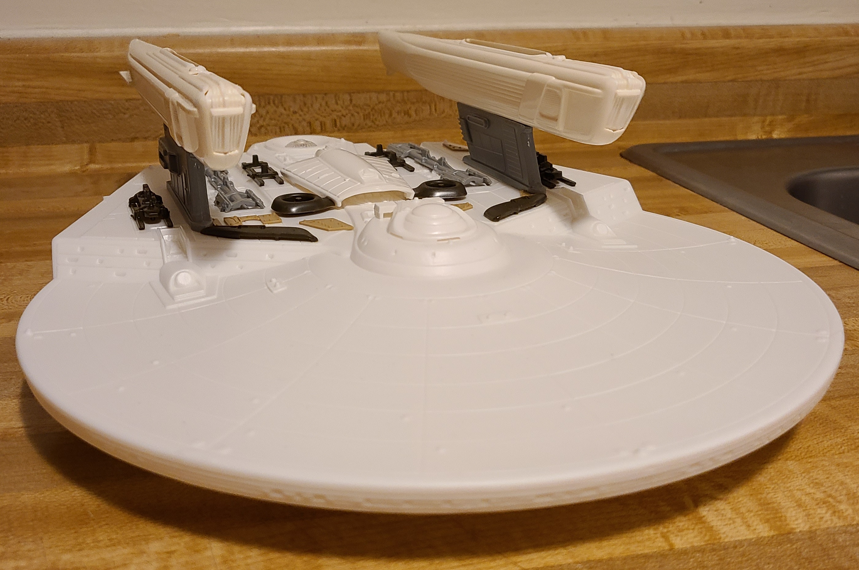

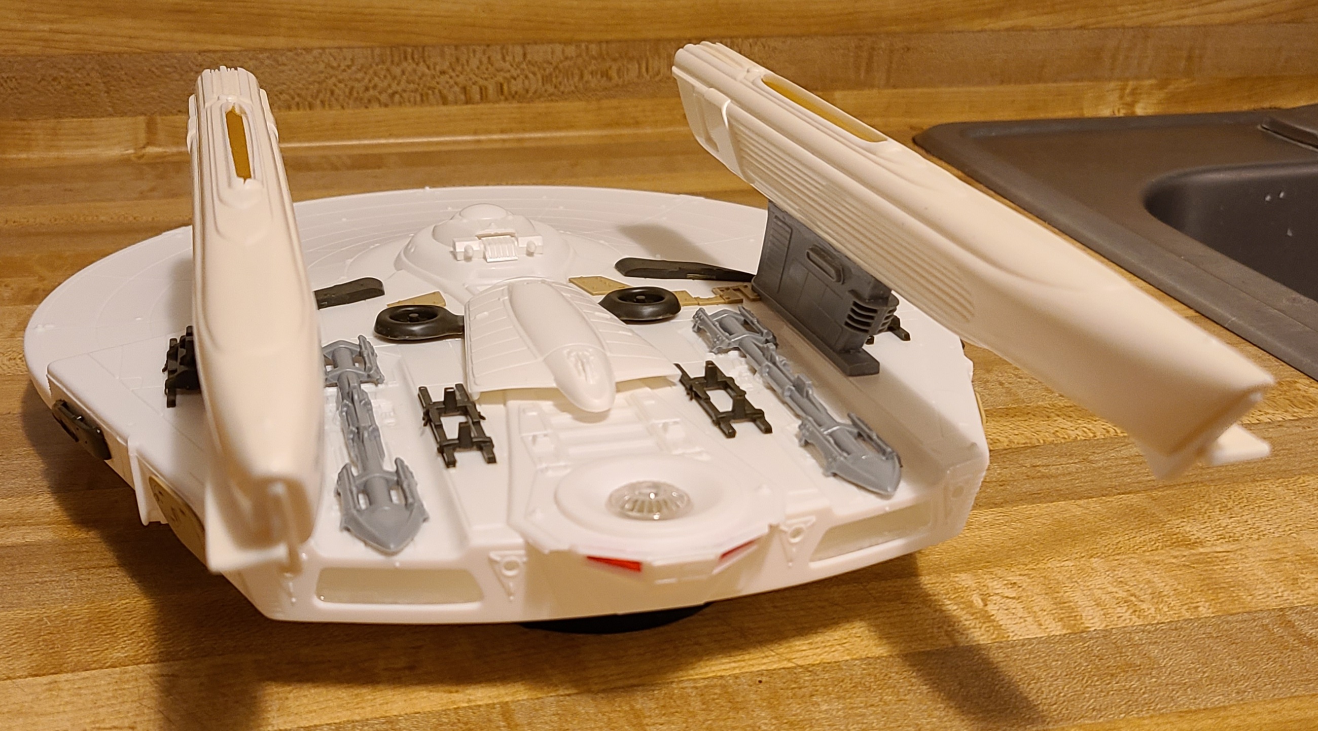

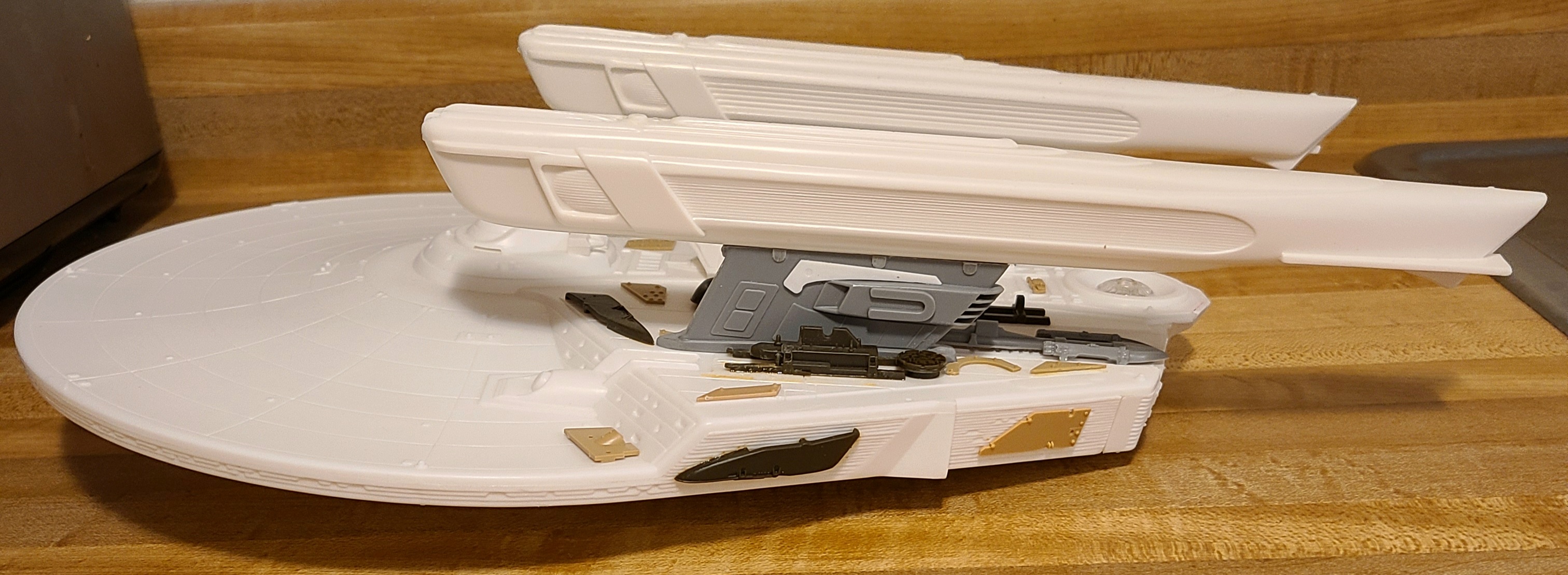

I realize this is not my thread, I did not start it, but I have been posting to it a lot in hope of helping the person who originally started it. I have attached the nacelles and the struts together and have attached them to the main hull, as well as finished attaching the greeblies to the area between the nacelle struts. Here are a couple of photos of what I have accomplished:

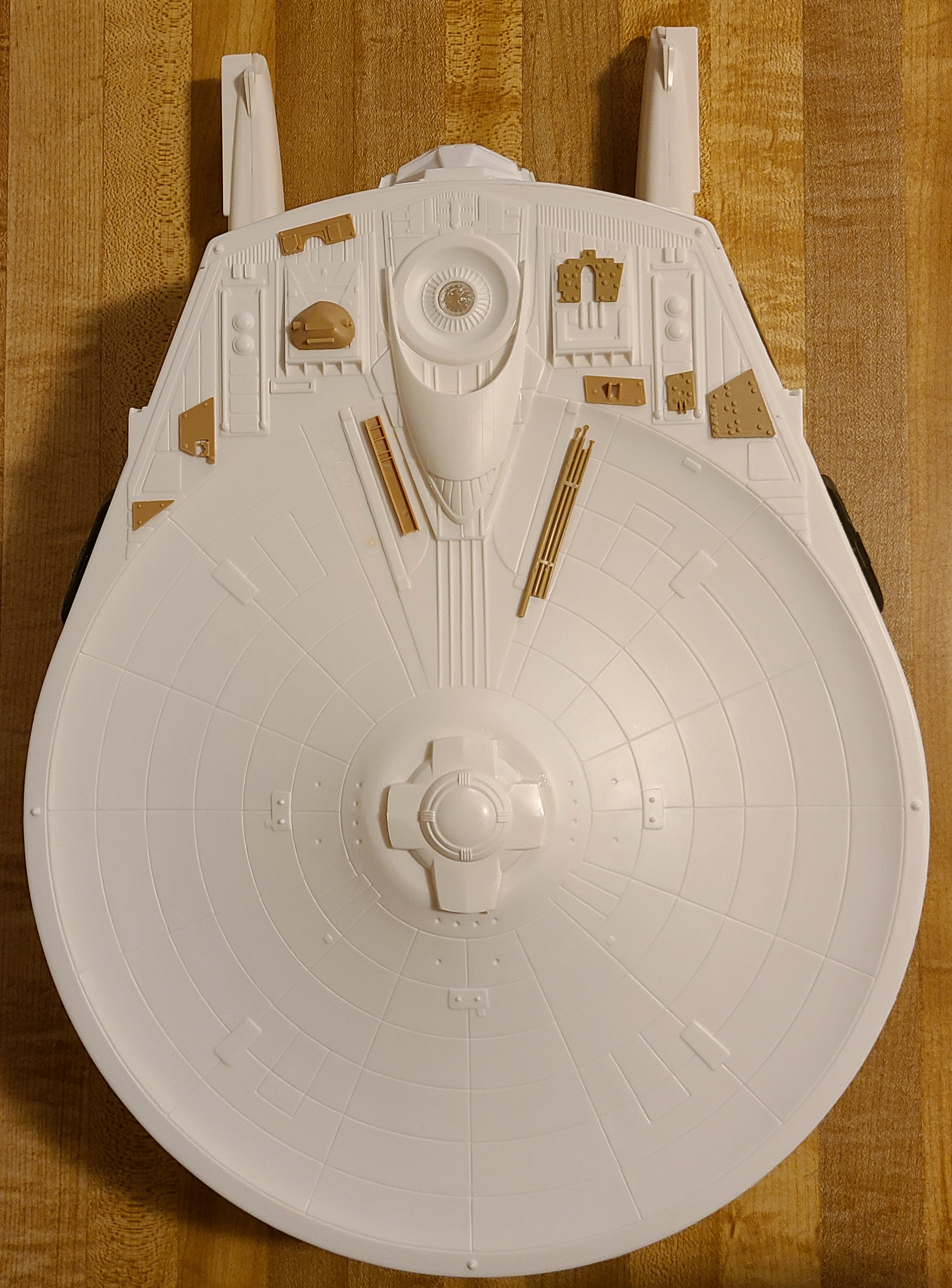

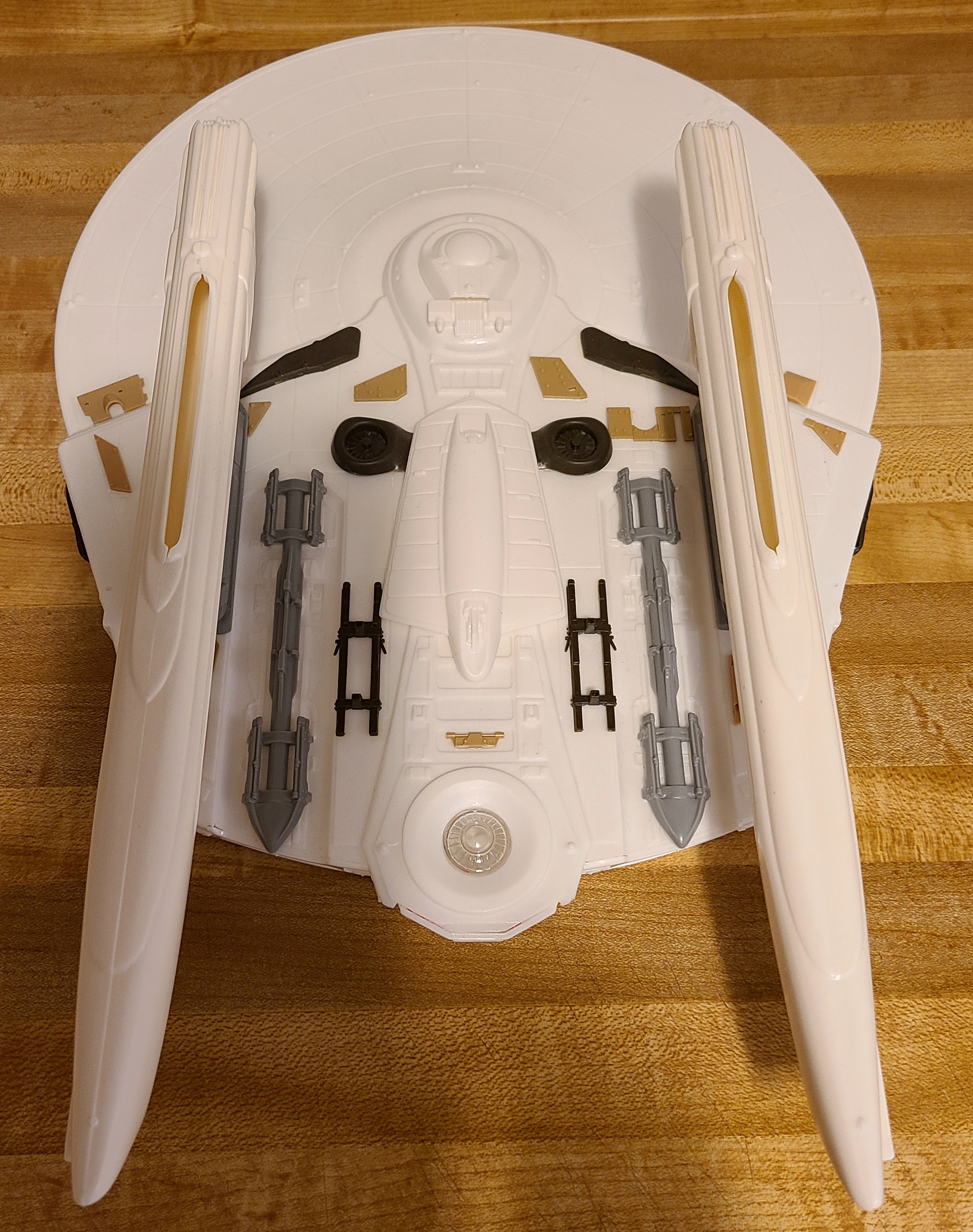

Thanks to some recent photos of the Bradford that show the bottom of the main hull and better views of the upper hull, I have been able to update my Bradford build. Many of the parts that have been added to the upper and lower main hull are from the 1/35 Tamiya M2A2 Bradley Infantry Fighting Vehicle. All those parts are tan colored. I also found that two parts from the AMT Enterprise-B kit were used on the outboard sides of the warp nacelle pylons, these are white in color. And I have figured out that parts of the 1/32 Monogram F-14-A ejection seat were used on the inboard sides of the pylons. I have these coming from a friend and will be adding those as soon as I receive the parts. Here are the updated pictures of my Bradford build:
Comments always welcome. Thanks for looking.
