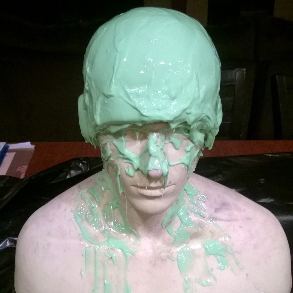

for you head form do a life cast with body double silk
Oo, that's not a bad idea. Damn, wish I'd thought of that before. I have a little bit on hand, but probably not enough to cover the head. I just ordered a bunch of stuff from Smooth-on for this, but didn't get more body double. I have tons of alginate though. :(
Sinned
Re: Tips for molding silicone head appliance?
Good tip ataris121, I had just enough Body Double to cover the head! Or at least, I think I did. My plaster support is still drying, so I haven't pulled it all apart yet, and looked at the thickness. But it should be good enough to get at least one decent pull out of.

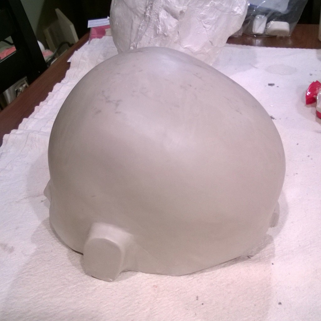

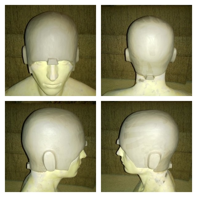

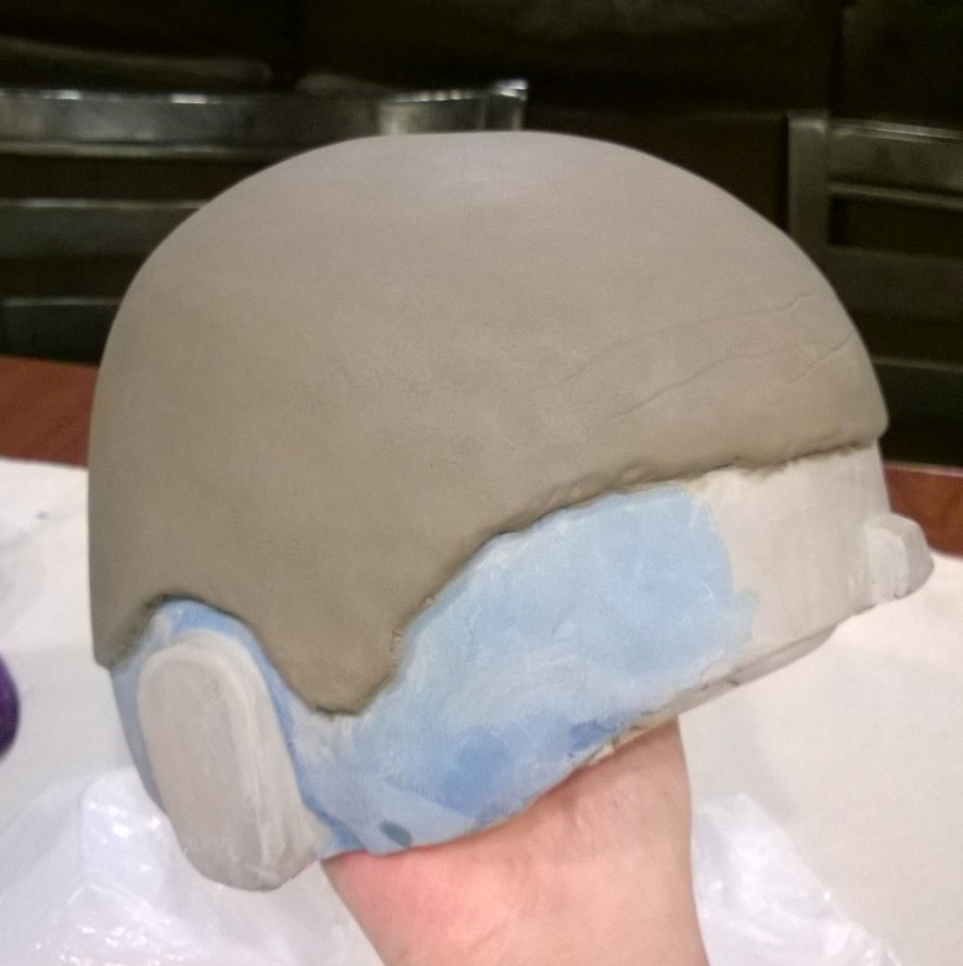

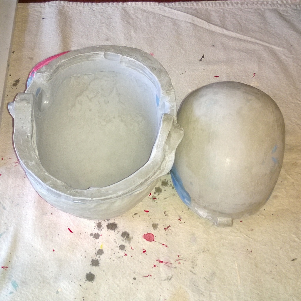

Just realized I never added a picture of the finished head form. It worked out pretty well. I used ShellShock, backed with FreeForm Air.
There's a slight undercut on the back I'm going to have to be careful about, but should be okay if I make the 2nd half right.

Round-robin of projects going on; finally back to this one.
I fixed the shape of the head form to remove the undercut areas, using FreeForm air, and then sanded it down nice and even with the rest. Also added a handle inside (forgot to take a picture) to help with maneuvering the thing while sculpting, as well as removing the form from the mold.

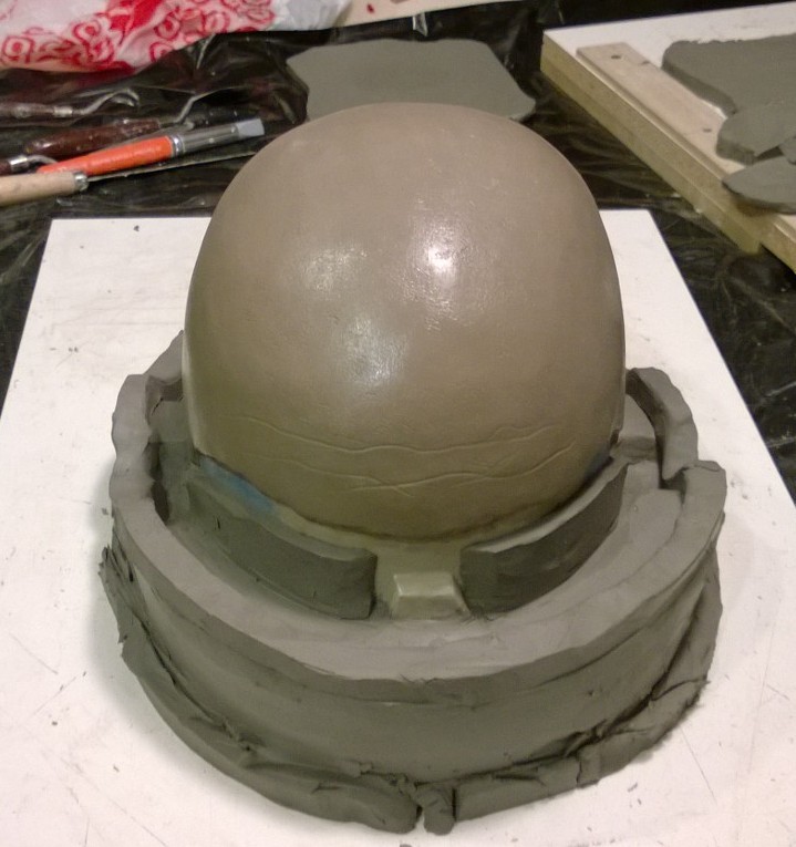

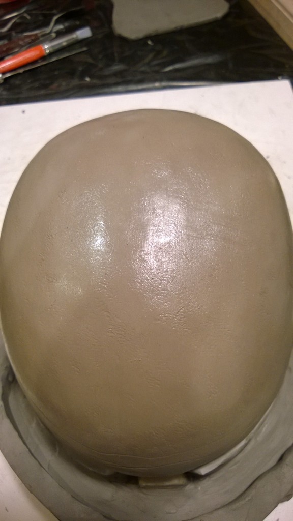

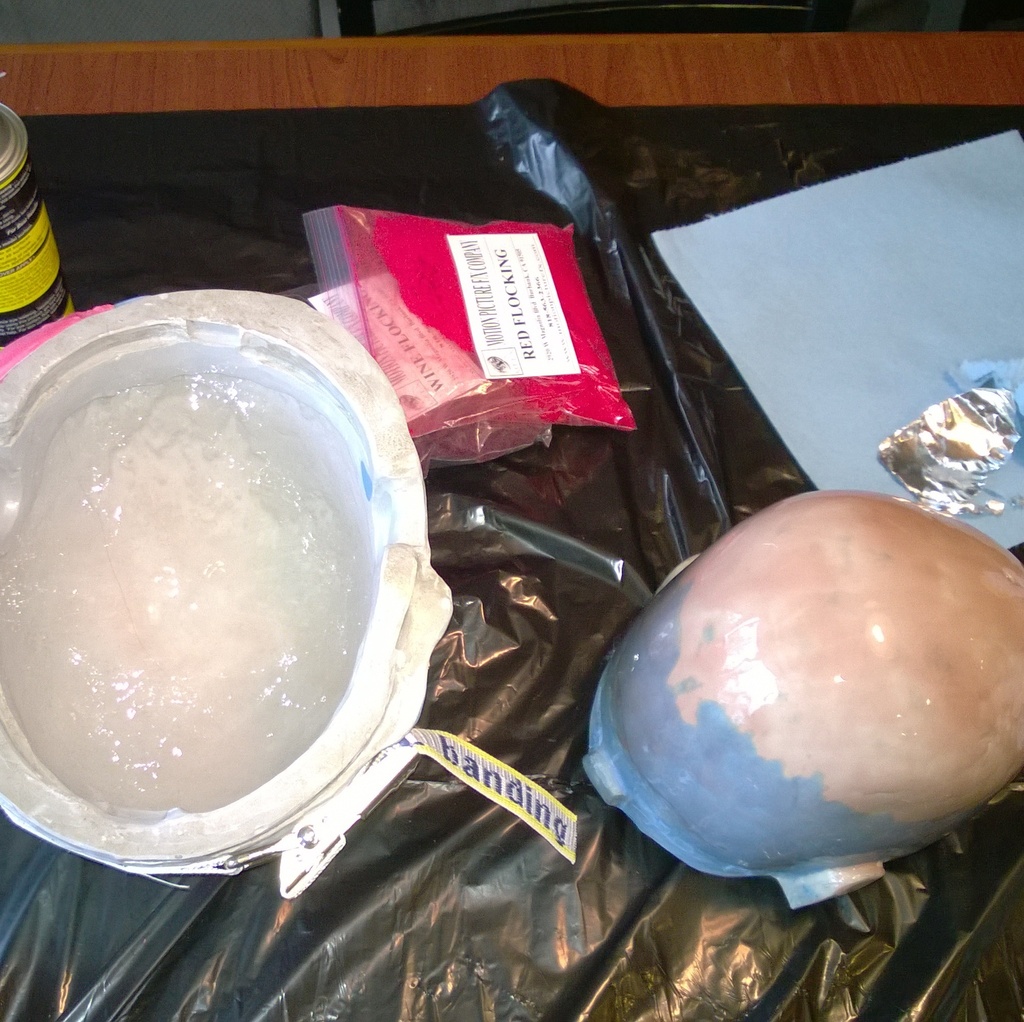

Scalp sculpt was done in WED, and sprayed with Crystal Clear. I wasn't sure how to texture a bald head, so I just winged it. I started with a sort of mottled skin texture stamp all over, and then a large pore sponge, followed by patting it all down with my hand inside a plastic trash bag. Not super realistic, but I'm happy with how it came out. Although, I went a little heavy-handed with the forehead wrinkles, but I'm racing the calendar, so let it go. Done with a thicker plastic bag, and edge of a loop tool.
Making use of my handle in the first picture below, it was super-helpful.
Twisty-Scalp-02_zpsrsaonj0b.jpg Twisty-Scalp-03_zpsxguwh5of.jpg Twisty-Scalp-04_zpswwqz8hus.jpg

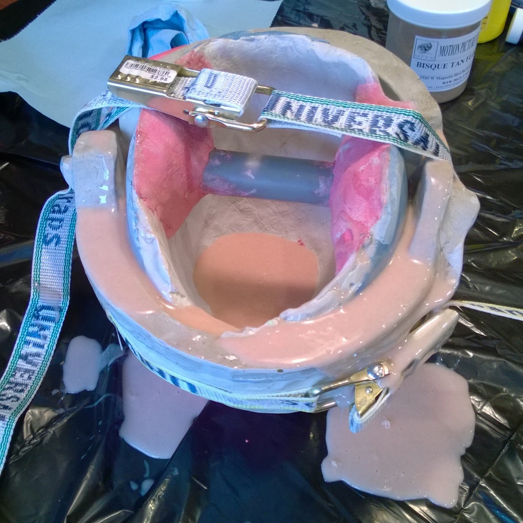

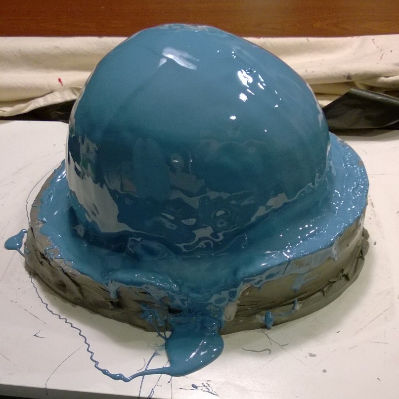

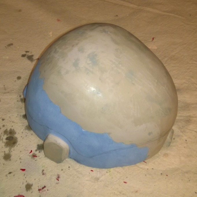

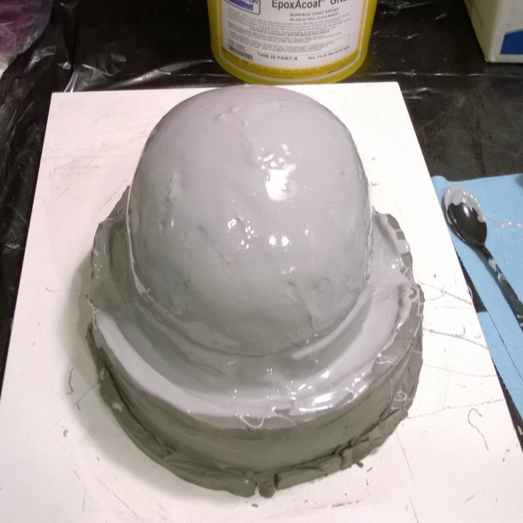

I've never molded something this way before, so a bit of trial and error as I go. I did a little layup with EM-210 to help me shape the epoxy mold, then a couple of coats of Frekote Lifft (nifty stuff, I'd never used it before). I have some fiberglass cloth, but no laminating epoxy, so I just went with 2 layers of EpoxAcoat, and a hefty dose of FreeForm Air on top. Hope it holds up!
Twisty-Scalp-05_zpsvlihxquo.jpg Twisty-Scalp-06_zpsnr2bawm3.jpg Twisty-Scalp-07_zpsbsygcyom.jpg
Here's hoping it all comes apart when I get home tonight!
Sinned

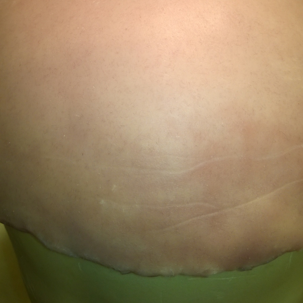

So, it turns out I missed some slight undercuts right around the ears, so the epoxy locked up. Happy accident then I guess, that I didn't put any glass on there. The mold cracked when I forced it apart, but at least didn't break in half. I ground everything down, and got it so things would fit back together again, and moved on to running the silicone.

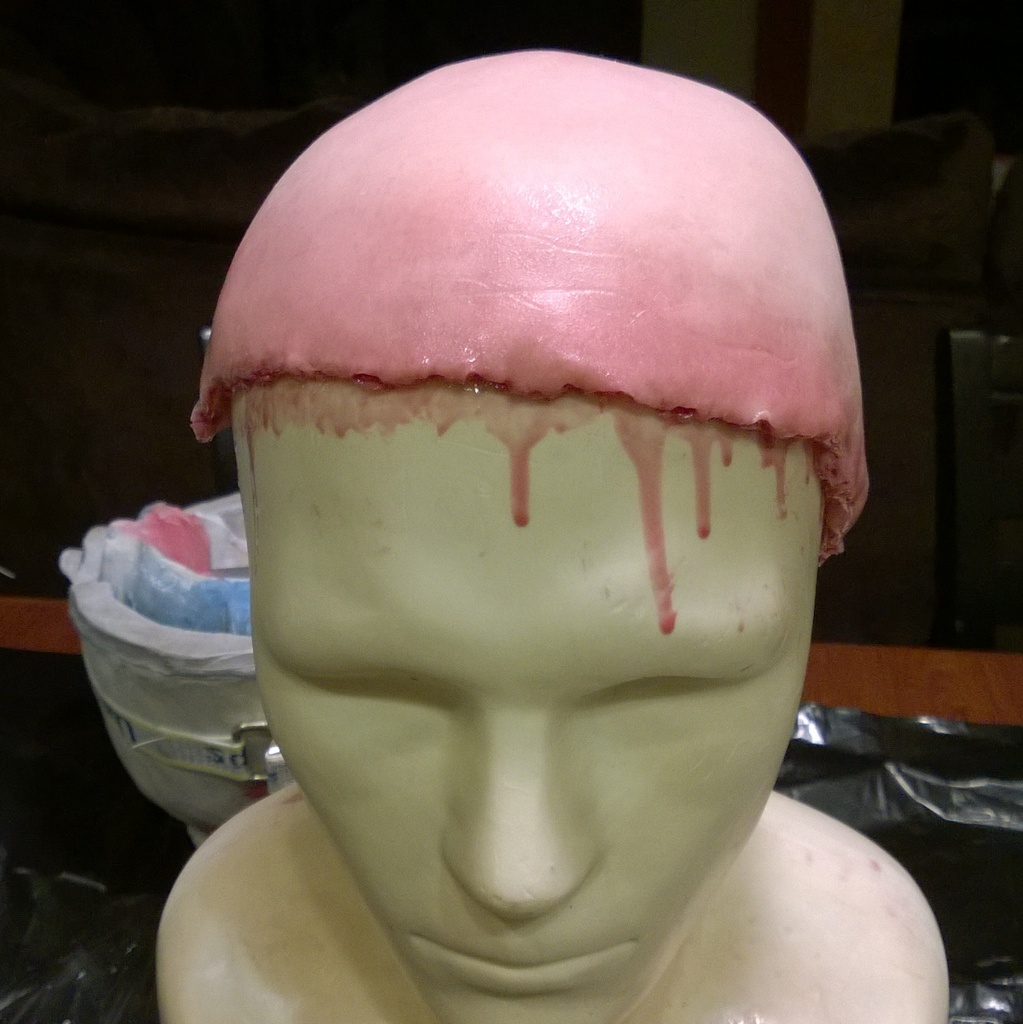

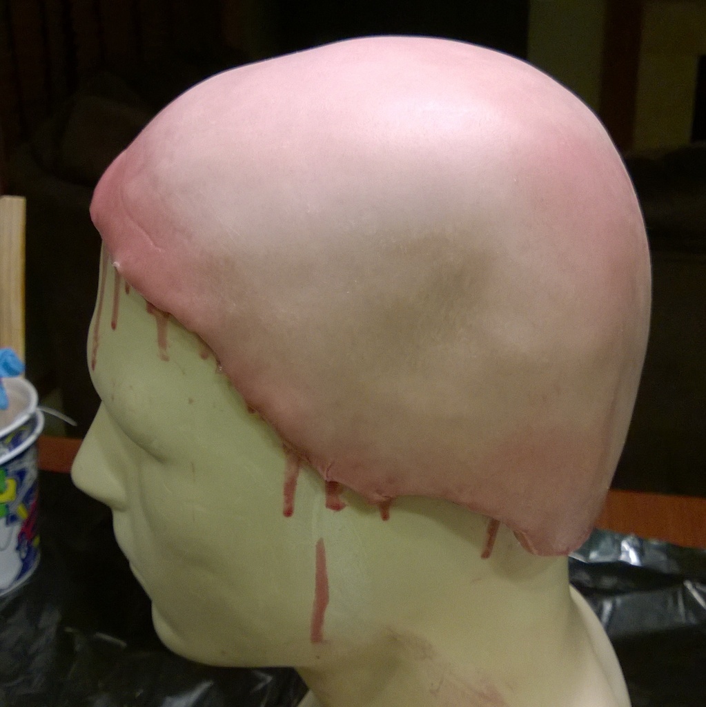

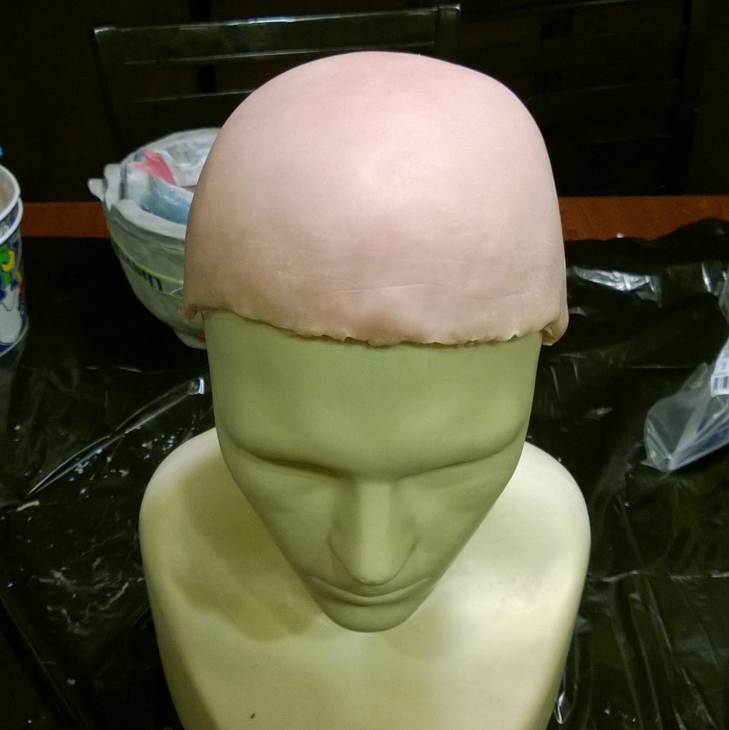

I went with DragonSkin FX Pro, and gel-filled with a Slacker mixture.
After that all set up, it was again, extremely difficult to get apart, but I finally forced it out.

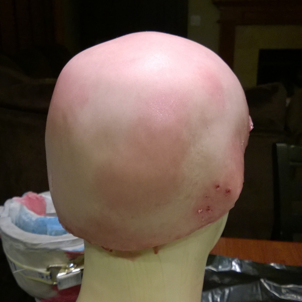

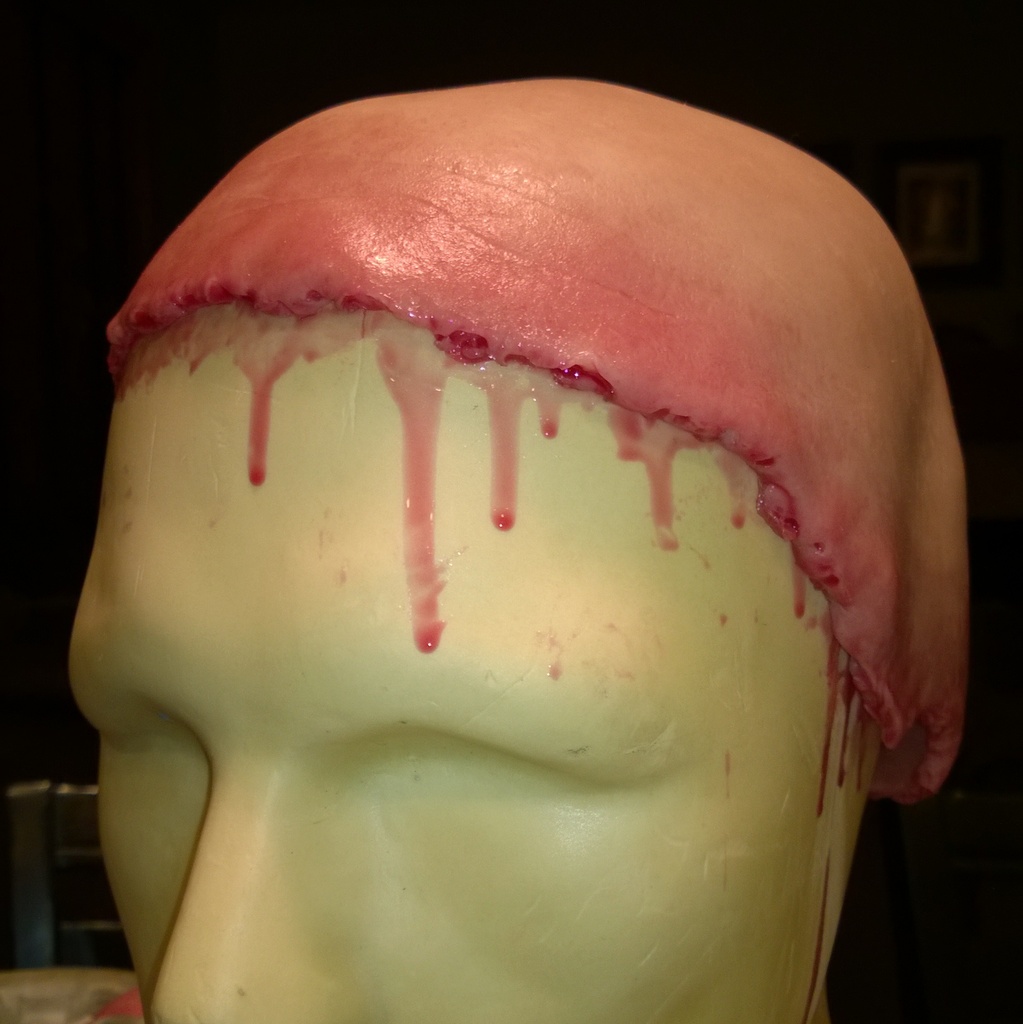

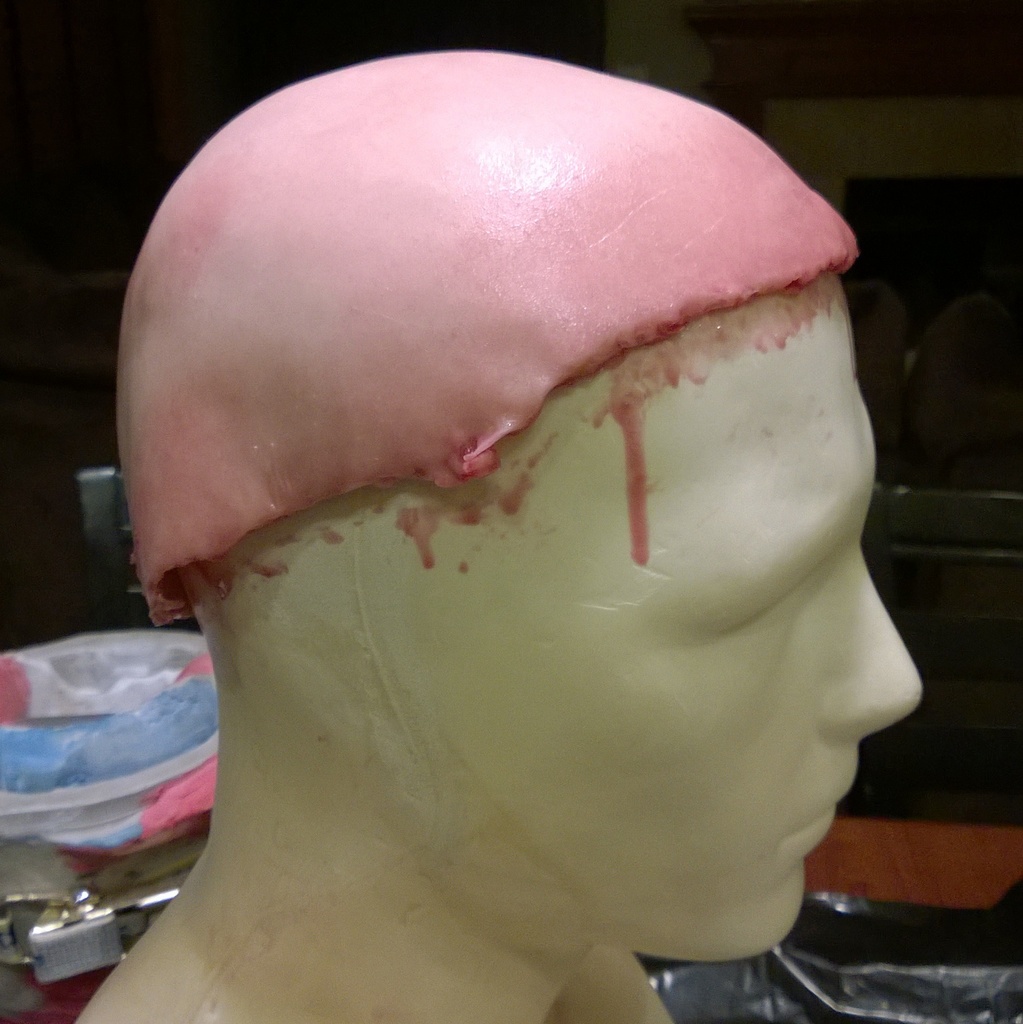

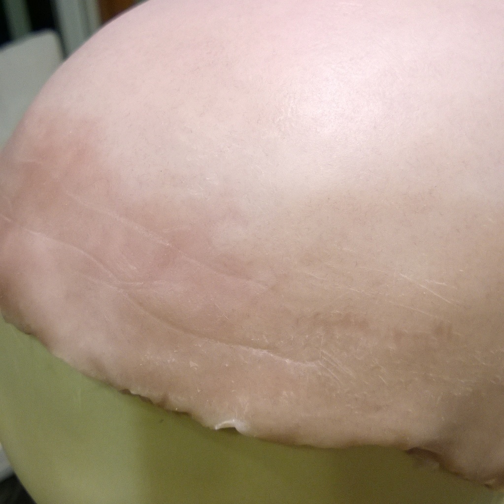

The head piece turned out pretty good. A few unfortunate bubbles, but I'll take it. I used some Psycho Paint to "wound up" the cut edge, and am happy with it.
Twisty-Scalp-08_zpsxc7urio4.jpg Twisty-Scalp-09_zpscwmuy6pi.jpg Twisty-Scalp-10_zpst7ufc5h8.jpg
