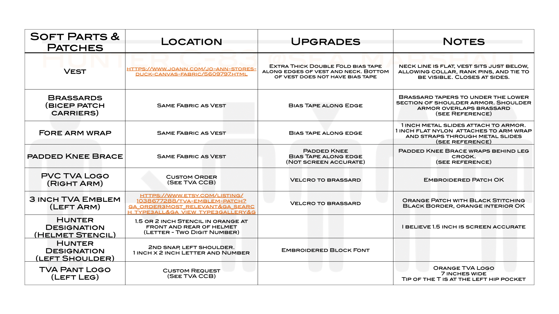

Note: For the vest pattern, I simply cut up a t-shirt and modified it (primarily the collar and shoulders) for a pattern.
Brassards, wrist wraps, and knees were Saran wrapped and taped, then cut off to make patterns to my size.

Joann Fabrics Duck Canvas
Etsy Patch Maker
NOTE: I have made a small run of PVC patches and are available on my Etsy Store

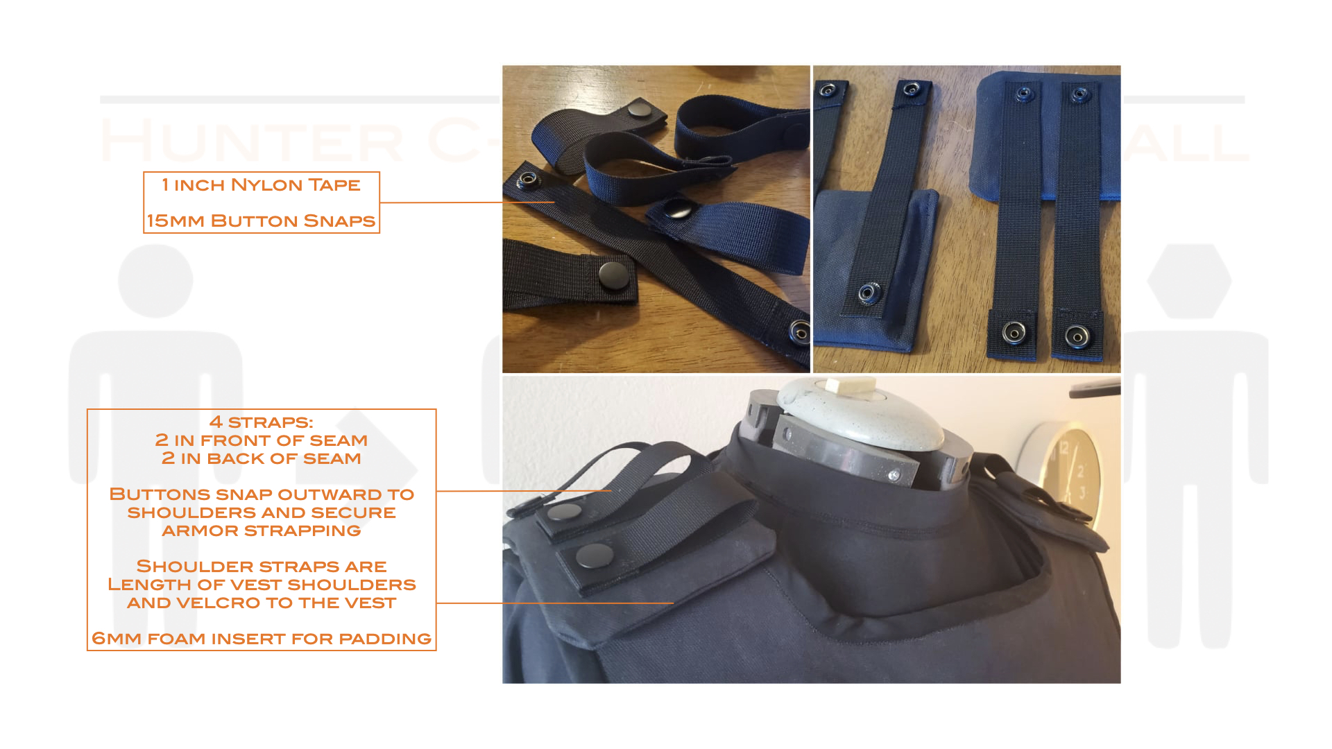

Note: For the sake of time, I purchased a bulk of the items from Strap Works despite the buckles needing to be flat, not rounded. Accurate chest armor strapping was found on Etsy with help by TheNickFox
Links here:
1 inch flat nylon tape
3/4 inch flat nylon webbing
Update: 09/18/21 37mm Polyester Strapping
Note: 2inch Scuba webbing was my original selection from Strapworks, however, the 37mm Polyester
from Etsy appears to be closer to screen accuracy.

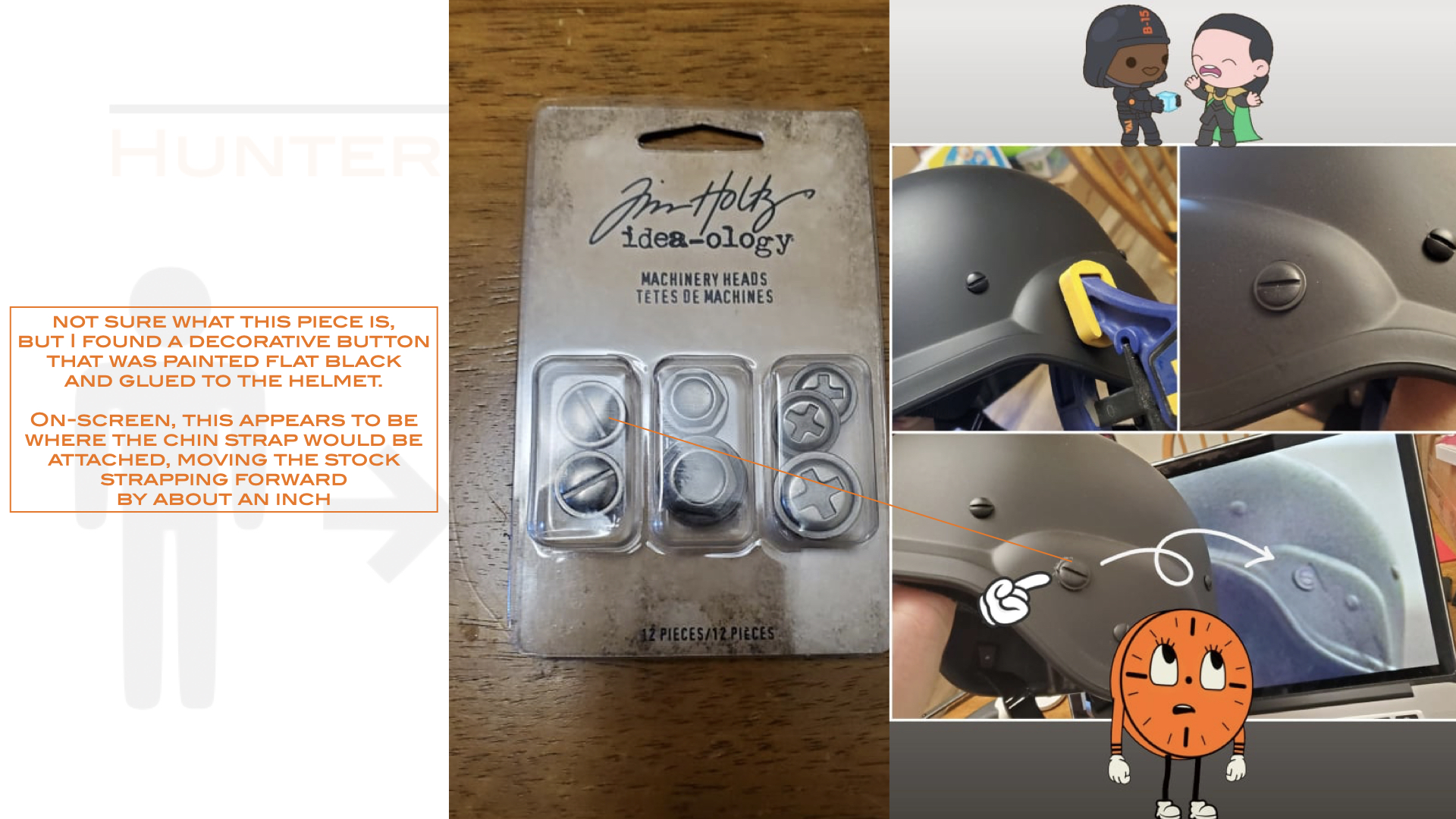

I'm also hoping to replace my helmet, or at least repaint it with a 1.5 inch stencil and tighten the grouping of the letters to better represent what is seen on screen. Same as the other items, I was pressed for time and I found a 2 inch stencil set locally. The chin cup could be replaced too. Mine is missing the grooves and I didn't want to bother printing one at the time.

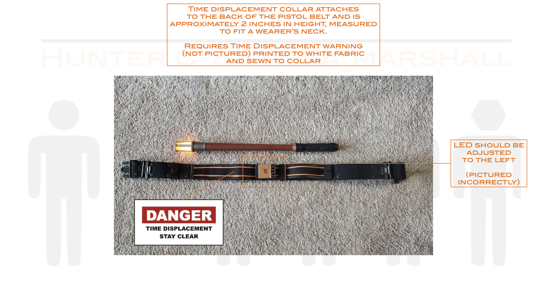

I slapped together a time displacement collar with some piping, faux leather, and belting. It really was a slap-dashed job because I put the collar together wrong... but it was just going to live on the back of my belt and again, good enough. I need a new one anyway and I can add the LED and Warning label, which I'm also missing.
Version 1 did the job. This was my first costume that I've built on my own through printing, painting, sewing, and purchases. I'm sure there are other things I'd like to change that I've not mentioned, but the bulk of the costume is done.

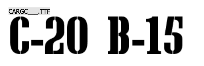

While waiting on some parts to come in, I believe I found the font the helmet stencil is based on...or at least one that is VERY similar and should serve as a decent base.
The shape of the 5 and 2 and the thickness of the ends of the C were the keys to trying to narrow this down, take a look:
And download it yourself here: Cargo Crate Font | dafont.com
EDIT: In Photoshop I change the text horizontal scale to 130% and it looks nearly perfect.

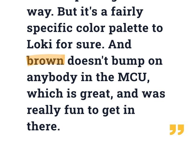

Compared to the Disney parks cast members (I've not seen them in person myself, these are from online). The male CM is shown in shade and sunlight (over exposed) and the female CM shows a clear back and front -- which is cool, because the entire front except the collar is black, where the back turns color at the seam. ...basically any break in the fabric can transition color, which allows for complete customizability of the color scheme. Fun. oh, you may also notice they're wearing the calves armor as shin guards, which I'm sure is just a suiting error.
In the excerpts above, I've highlighted "brown", but I've always thought it was a rust color, kinda red/brown. And in this screen shot below, Mobius' suit is brown, and whoever these unarmored guys are, they're my color comparison.
Right? You can waterdrop that color in a photo editor and pull up the color reference.

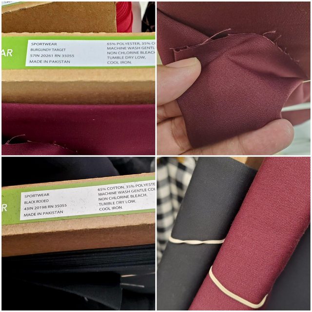

So THIS is in line with what I expected. Burgundy is basically a red/brown, akin to rust, and fits the images on screen. In my short time working with fabric, I know camera exposure can shift the fabric color, add color grading for film/tv and you get something kind of in line with burgundy, and not so much brown - as seen with Mobius' suit.
I went to my local fabric shop (Joann Fabric) and went looking for some kind of cotton/polyester blend and found it in Sportswear. I snapped a photo, and sho' nuff' it exposed to the just about the proper color.
Is this the right fabric? I don't know, but it's close enough for me. The build is coming soon, just looking for some time to cut patterns and get to work.

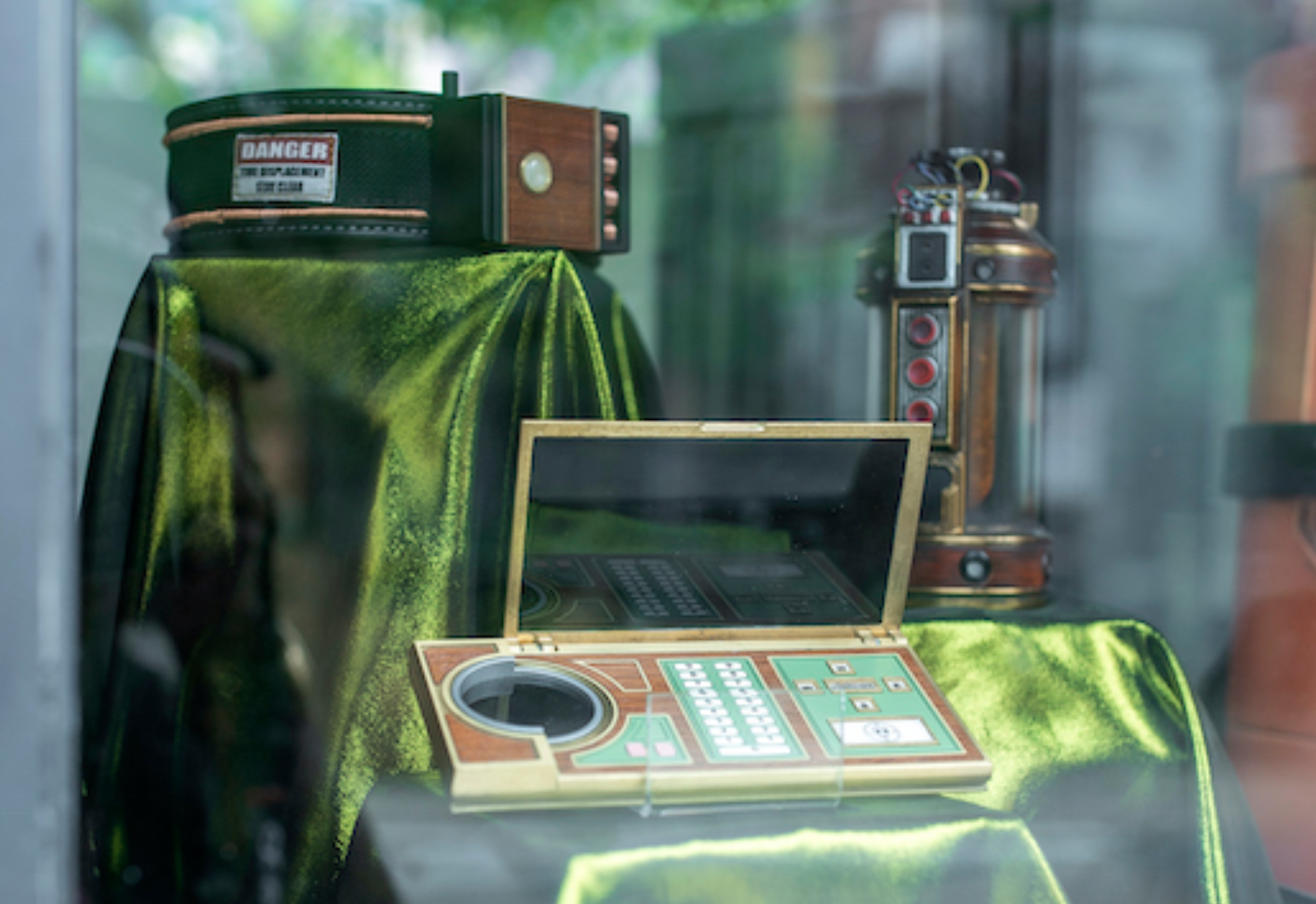

And on that note, here's a photo from The Collector's window at Disneyland.

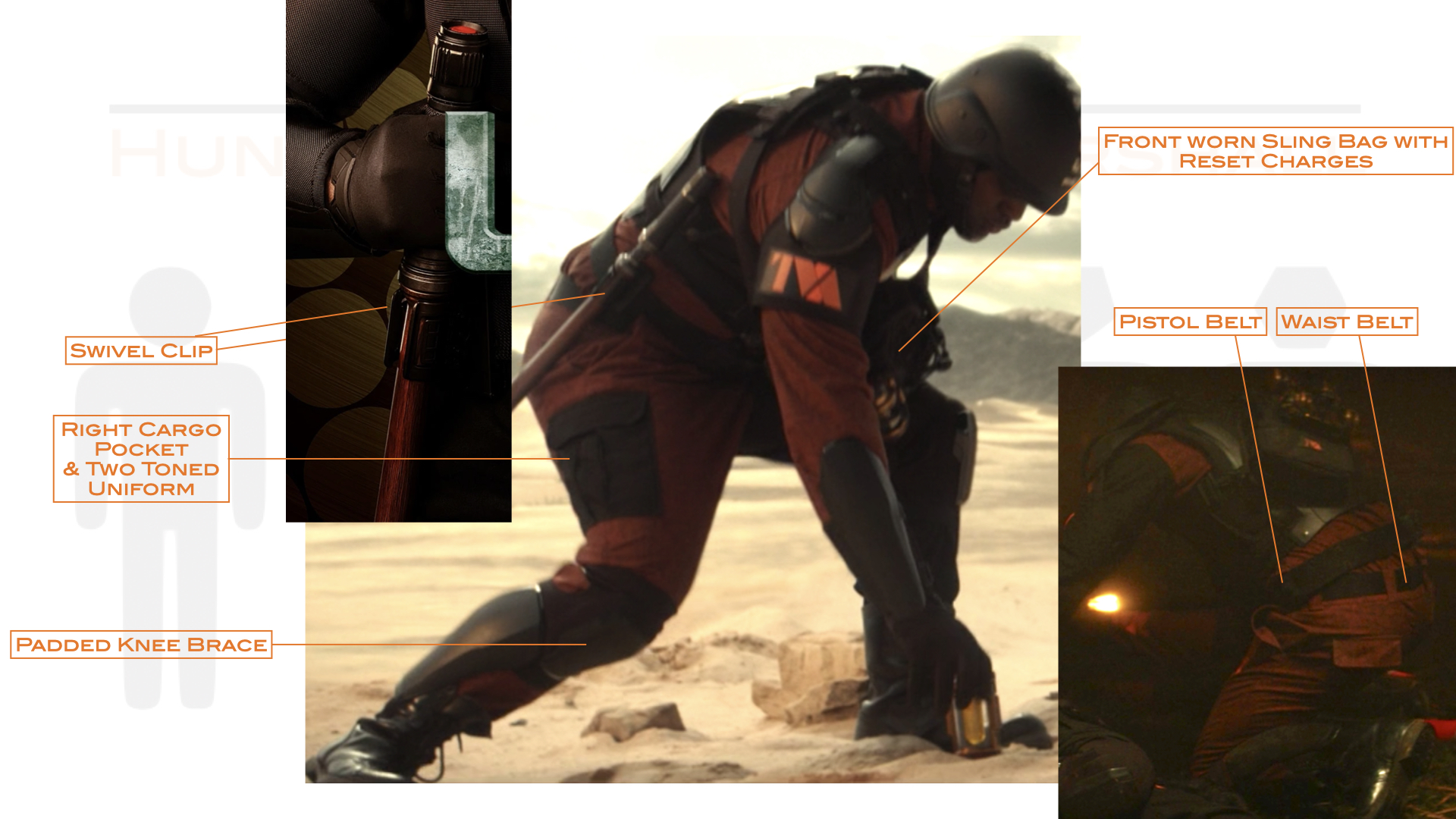

Some observations, that may help others (though you've likely already noted these) :
1. The vest appears to be ballistic nylon based on texture and sheen.
2. The shoulder and waist strapping for the armor should be roughly 1.5" (assuming the belt is in fact 2.25" it appears to be) and features a 1.25" flat nylon strap on top of it. It doesn't appear to be sewn down along its length since the two aren't even and the top strap "wanders" along the top.
