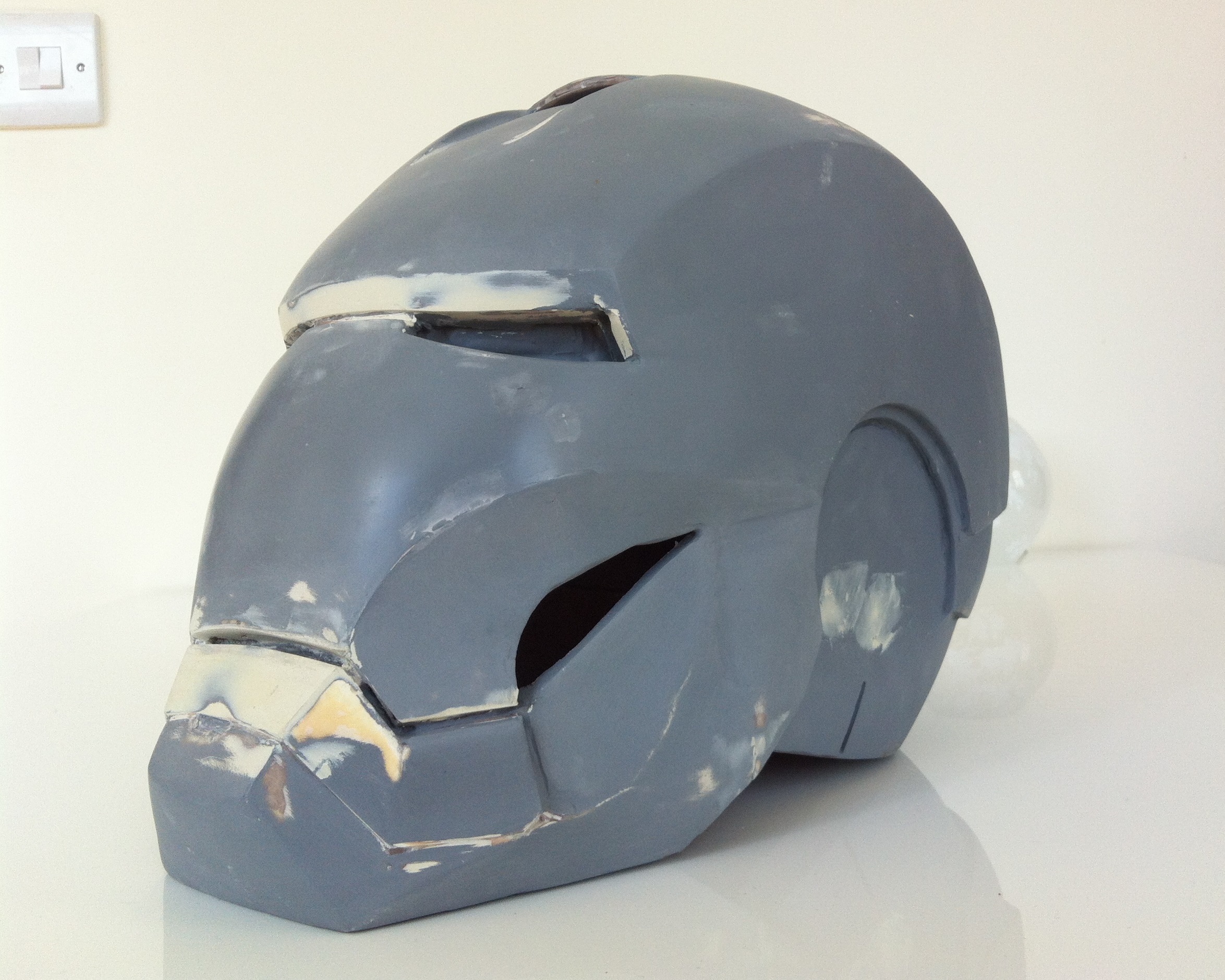

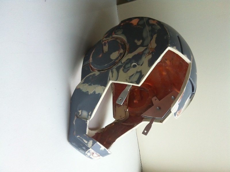

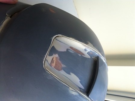

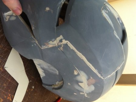

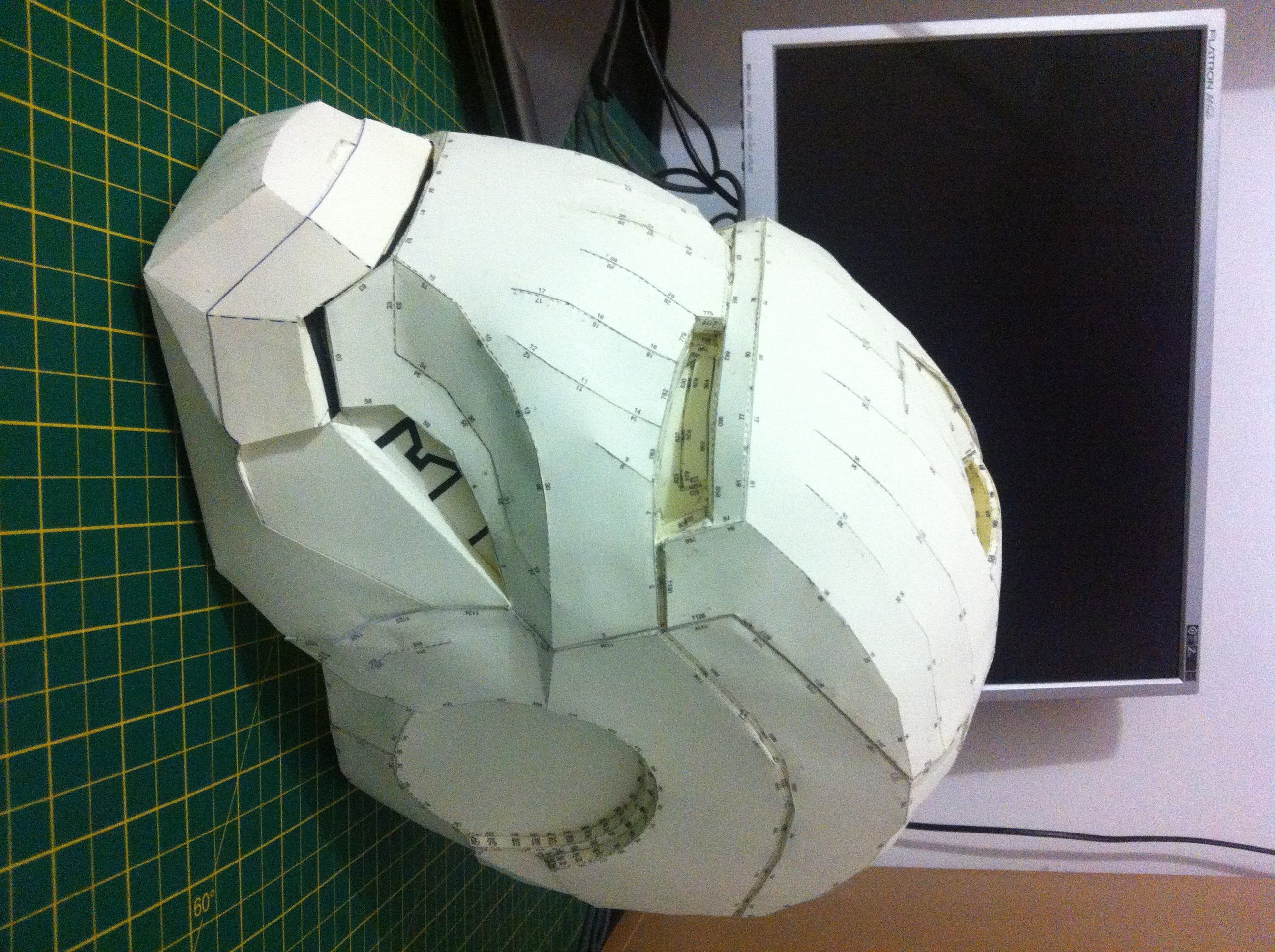

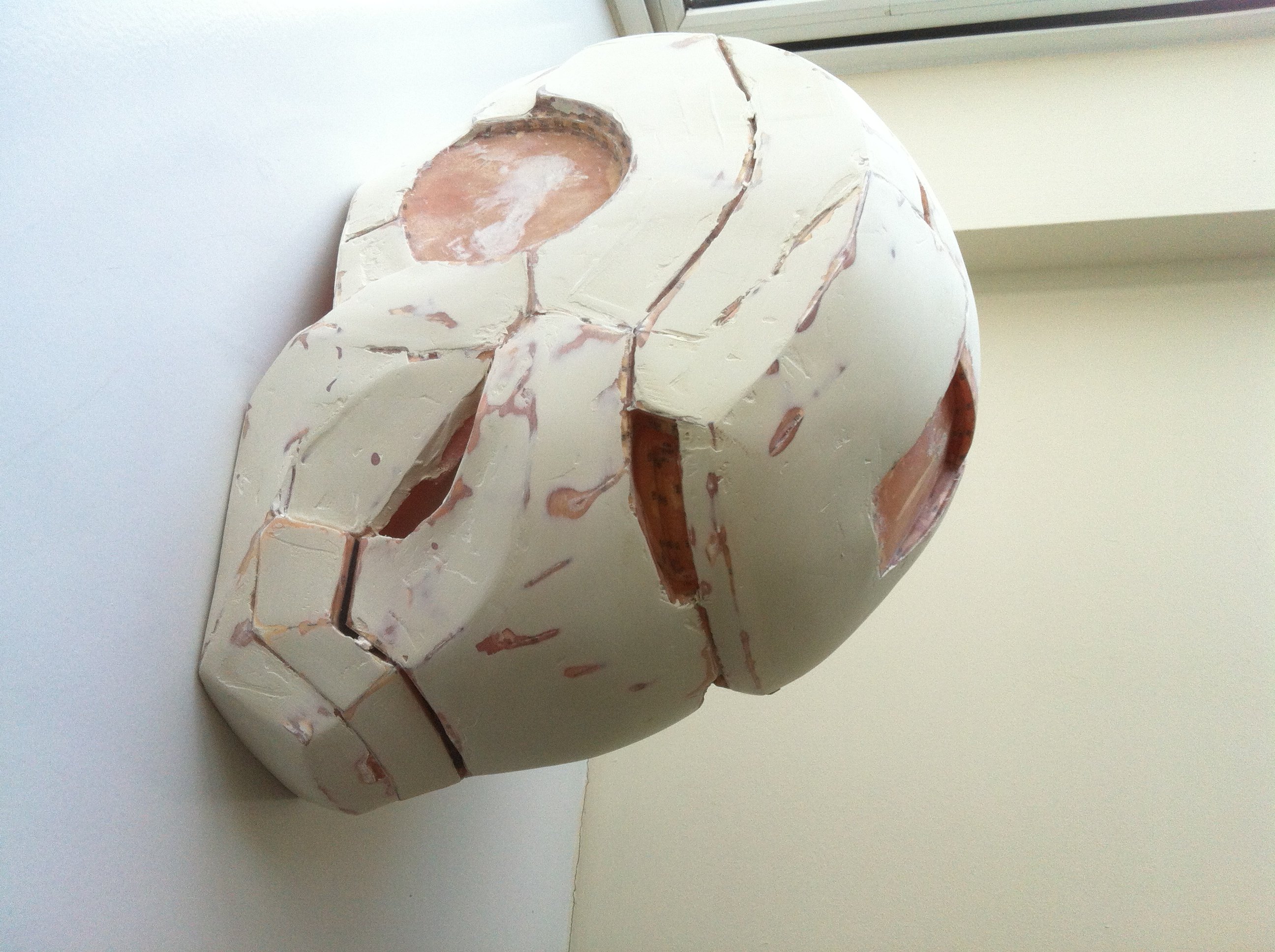

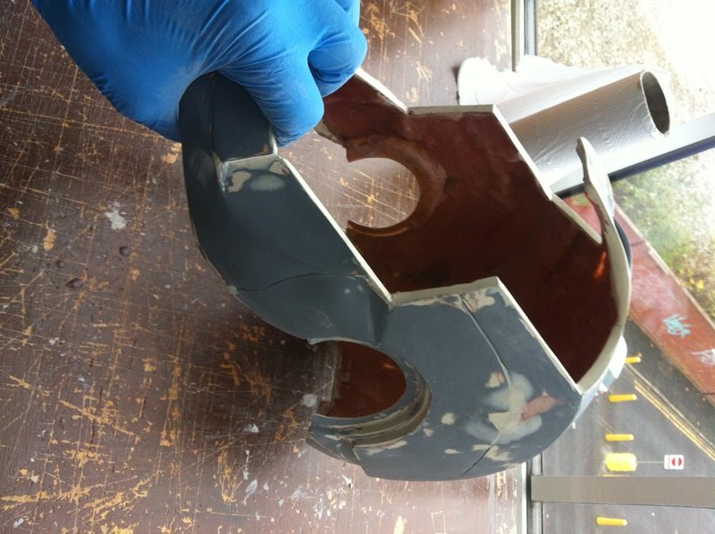

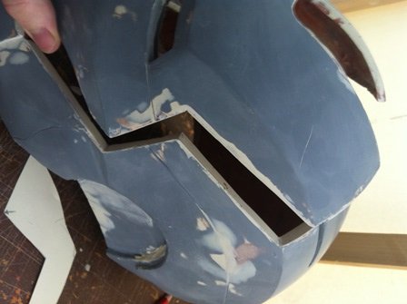

I just wanted to share the progress of my IRON MAN MK7 helmet so far. It did start out as a MK6 using pep files from Sharkhead/Sharkmark, but halfway through I decided that I wanted to do a MK7 suit. As you will see from the pictures I then used Darkside501st's files to add the MK7 chin and finish it off. I'll add more details at a later date, for now here are some pics.

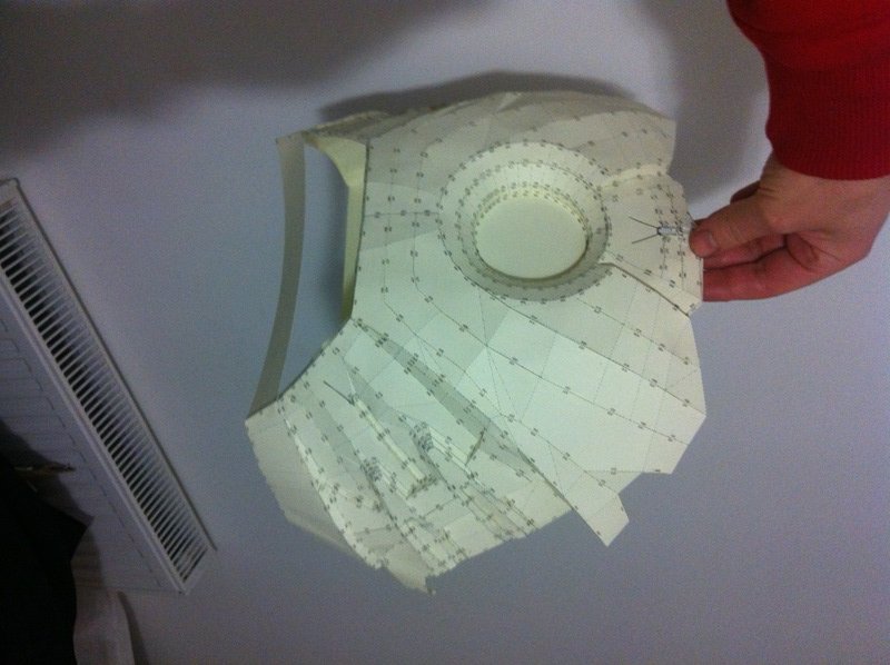

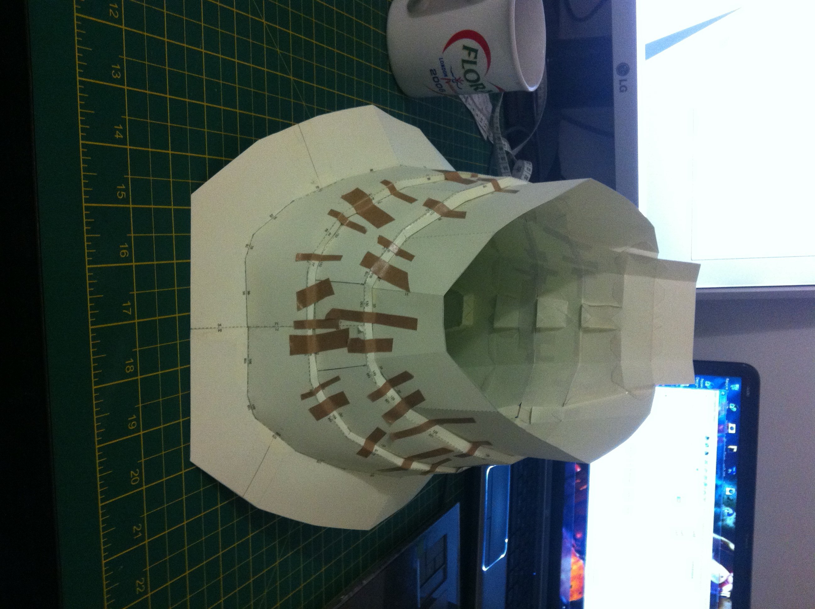

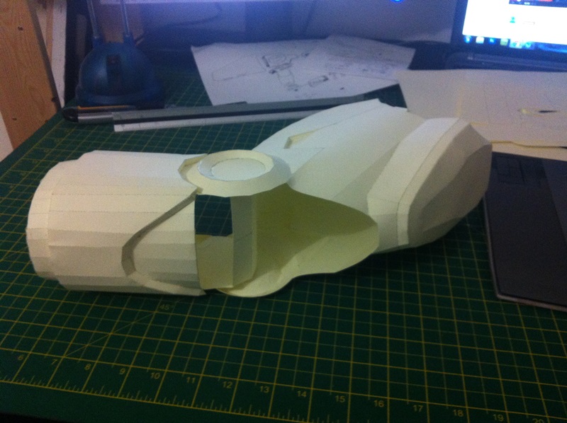

Hi guys, as you can see I have now pepped the neck (Omarbou's), but I'm not sure how to go about fibre glassing it, I think it would be easier to make it one piece that splits in half and re-joins with magnets but I'm not sure if that would be too uncomfortable to wear? has anybody managed to join the separate layers together in a way that they still have some movement?
I know a lot of people go with foam for the neck so I may resort to that eventually but at the moment I think I can get a better look with pep so want to try and make it work.

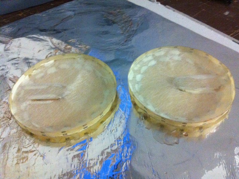

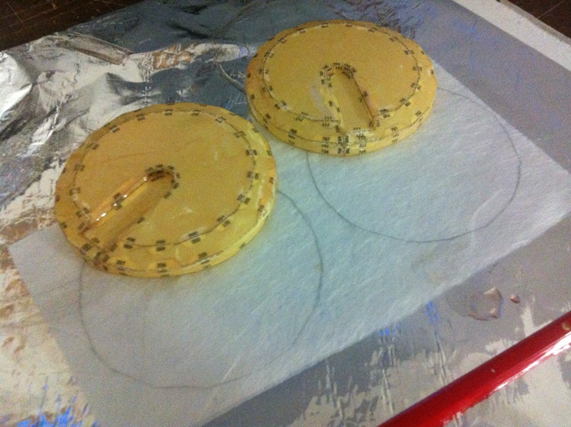

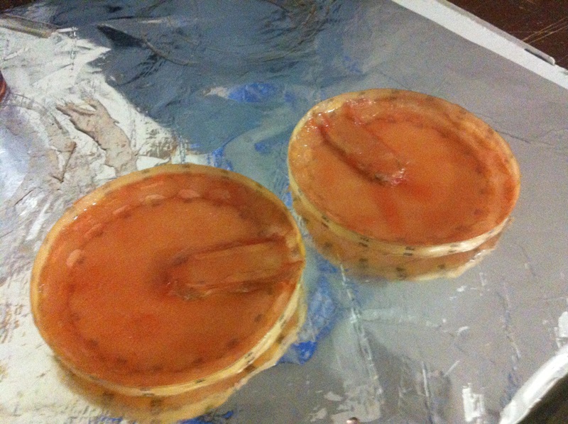

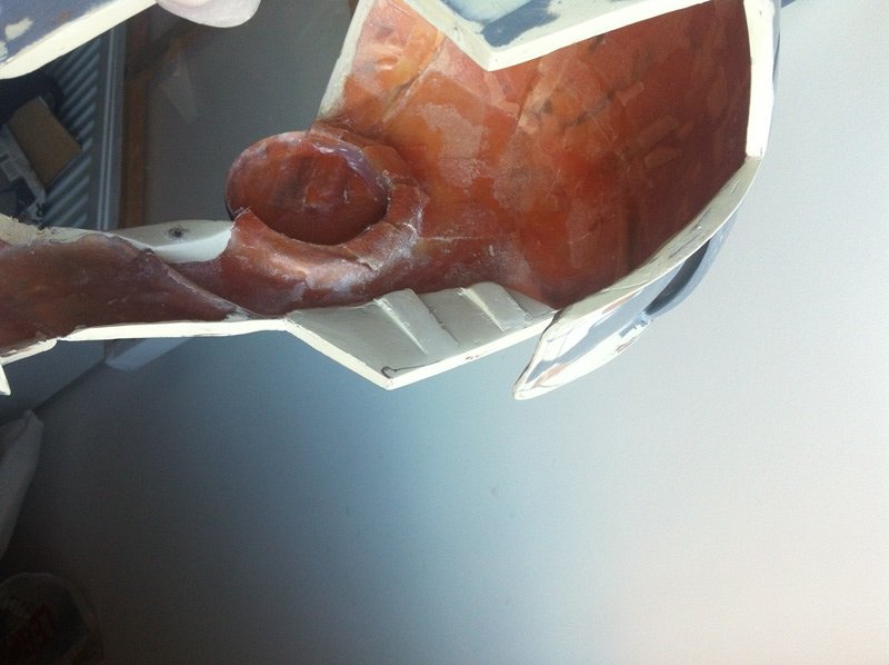

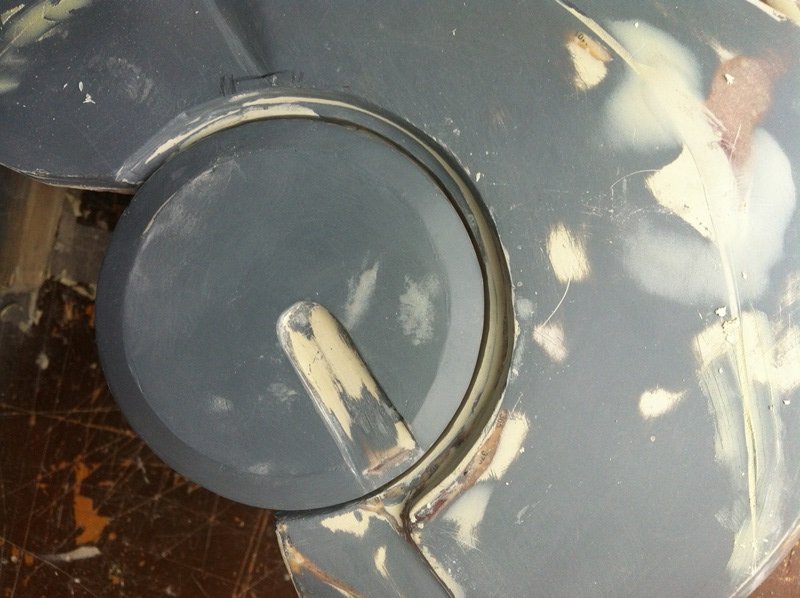

Made some progress on the ears recently.
pepped ears covered inside and out in resin, then used as a template to cut out some fibreglass cloth
fibreglass cloth placed in ear
More resin added
Added filler and sanded ready for the first coat of primer. :) Quite happy with how they turned out but I'm starting to get real jealous of the 3D printed parts people are producing!

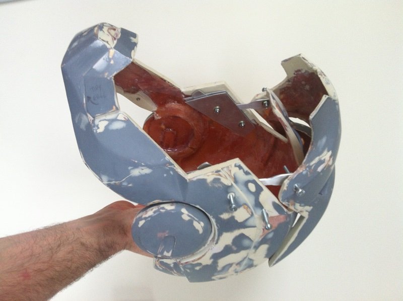

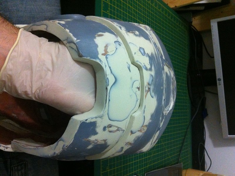

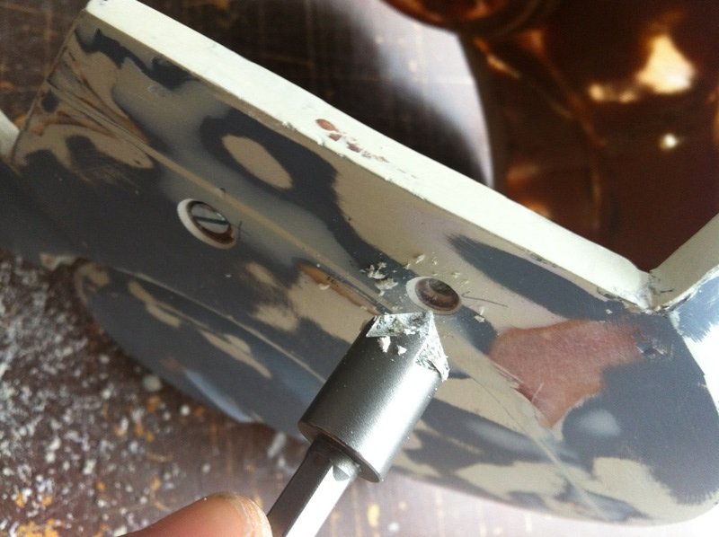

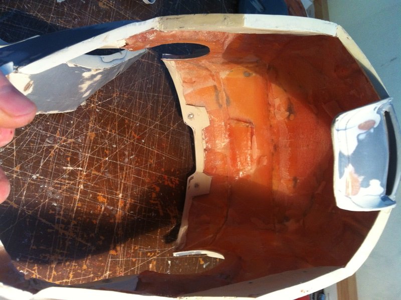

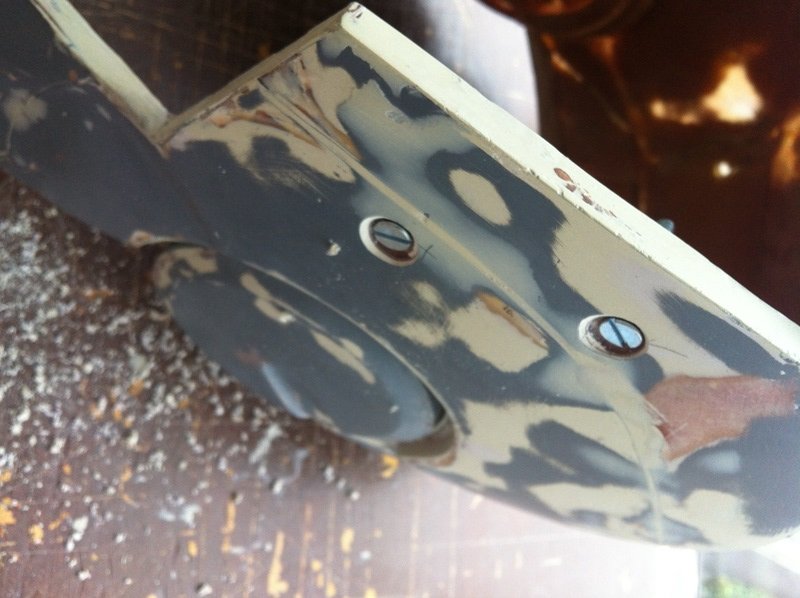

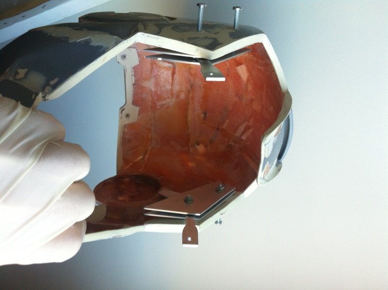

Hey just a quick update, got back into the build lately and made some progress. Built the chest only to find out that it's too small!, ah well it was good practice:wacko.
Also attached the rear helmet piece with magnets, glued on the ears and started work on the faceplate hinges.. :D
