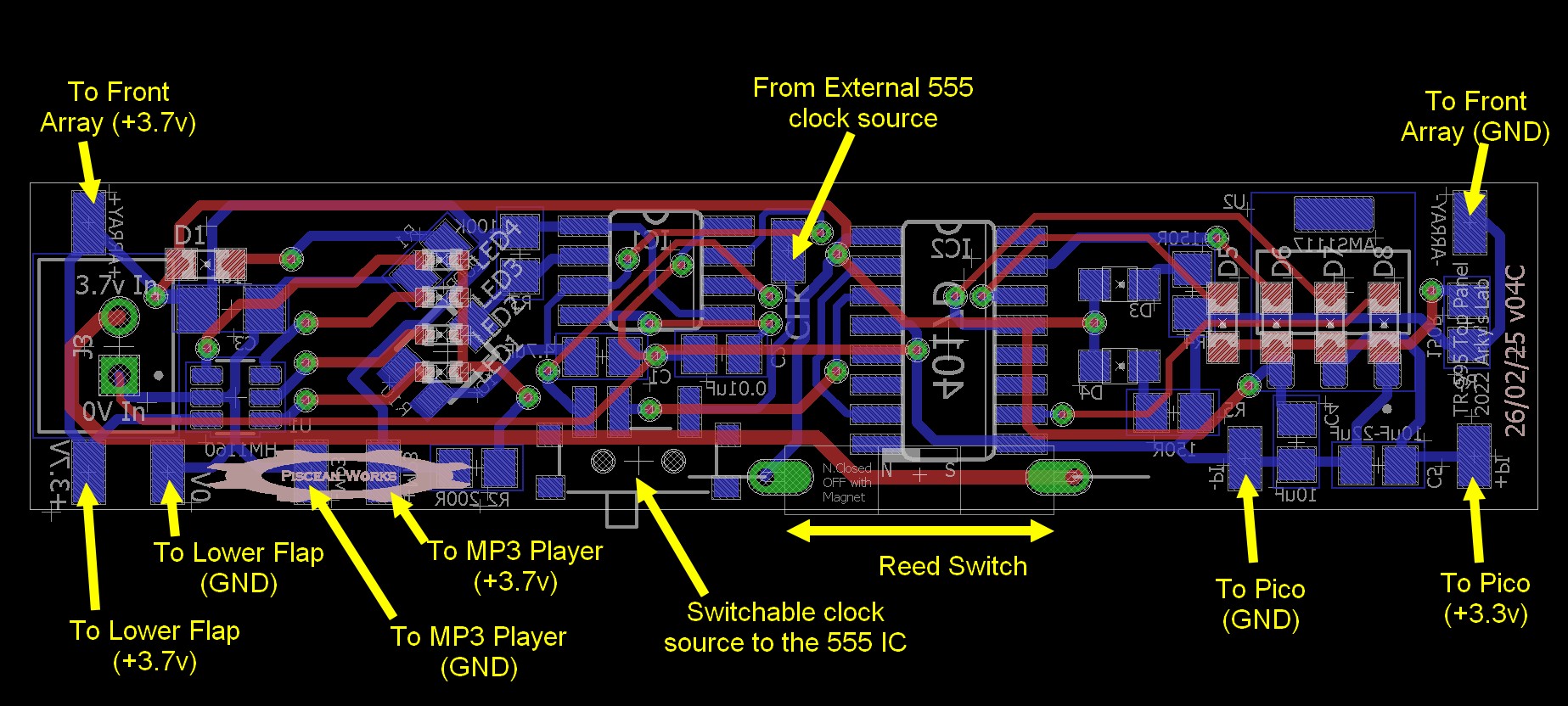

Hi, Guys,
Just an update. I have found a nice little IC which displays the status of the LiPo battery. So far, it does work but the other voltage regulator IC needs more time as it only worked with 5v instead of 3.7v. In another few weeks or so, I would be able to confirm if the new design works. This Top Panel PCB, which serves as the central power distributor for other Boards, would be v04. V03 will not be released.
But a word of caution. The board is quite densely populated and so, you will either have to use the reflow method or, lots of flux with a pencil tip solder bit.
