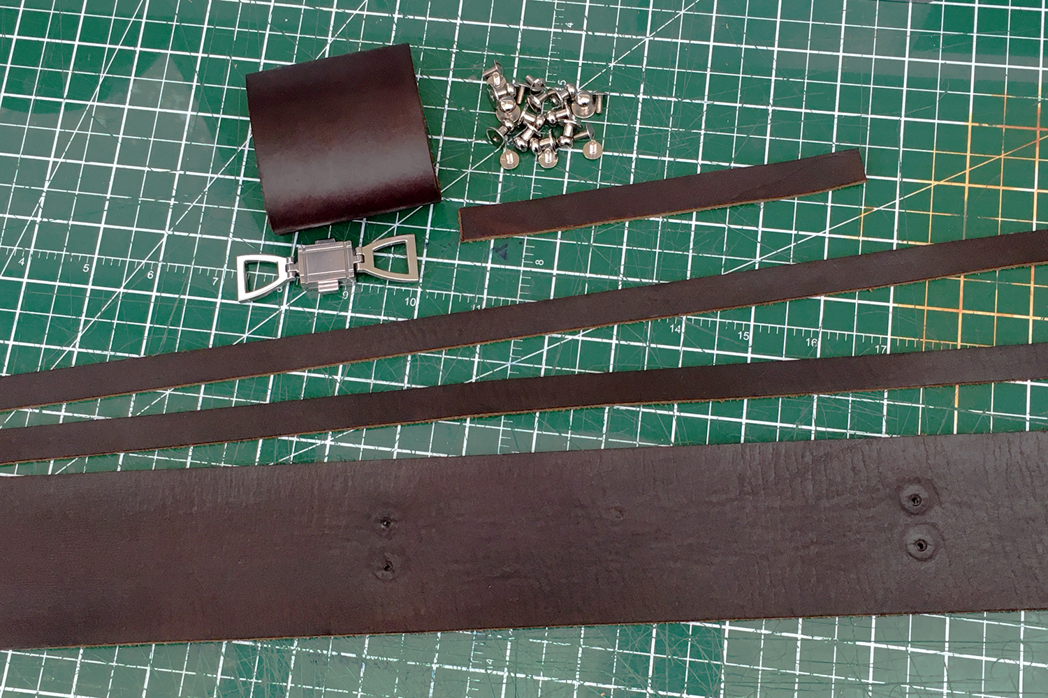

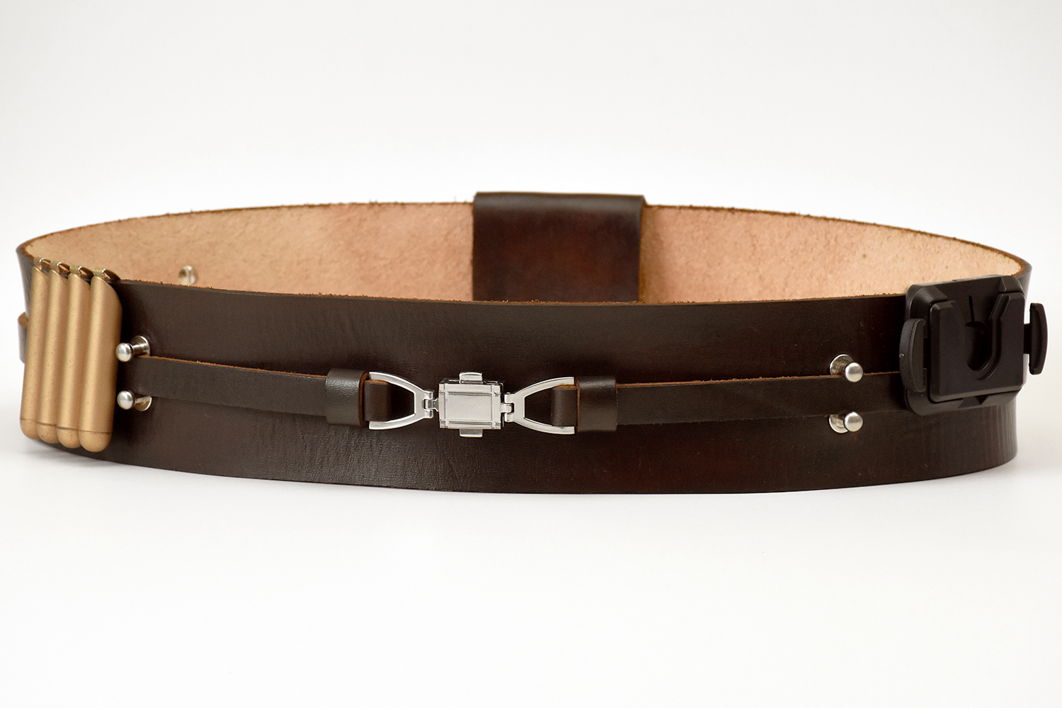

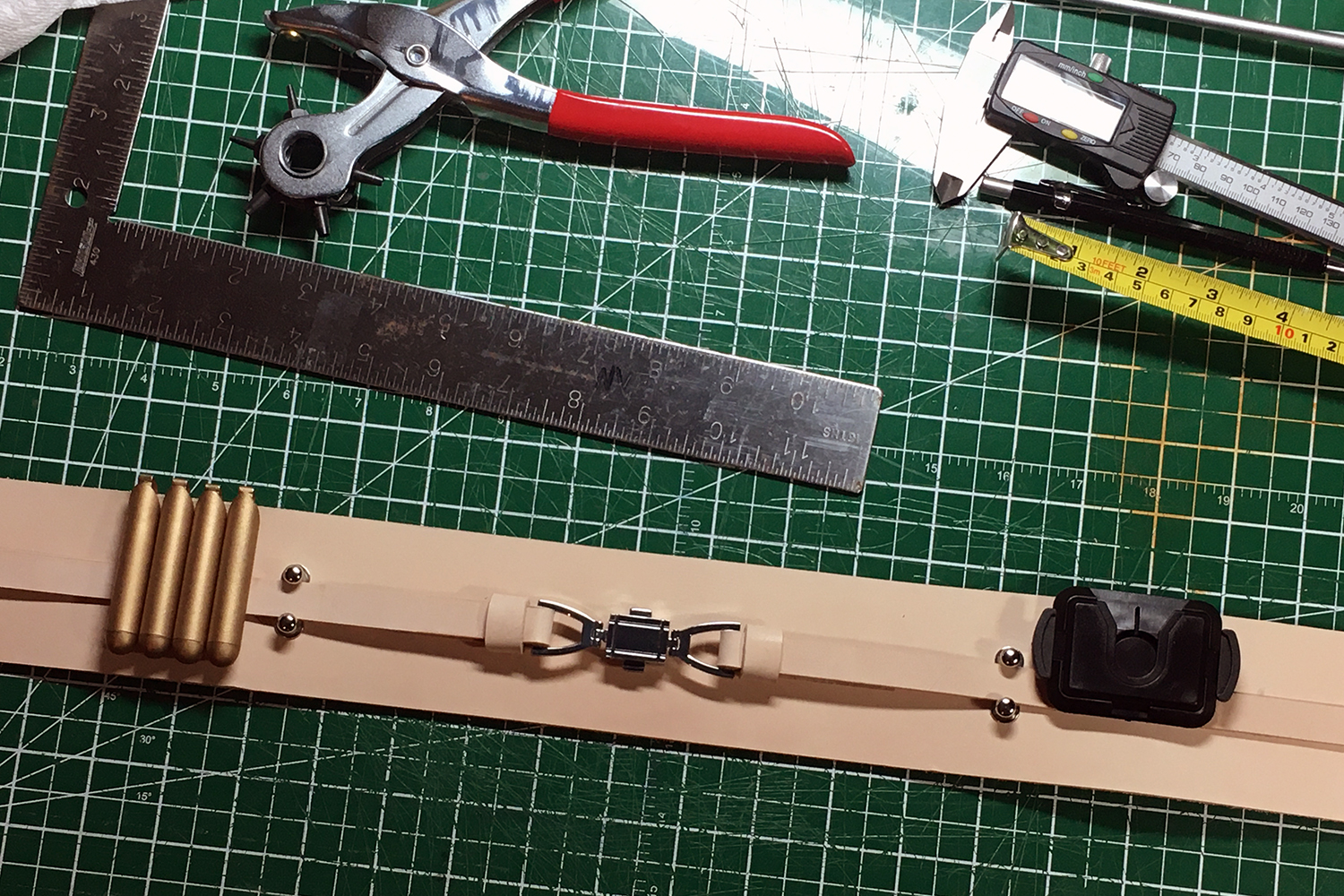

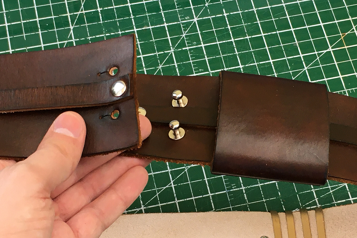

I've recently had an unexpected desire to make a replica of young Obi-Wan's belt from Episode I to utilize some of my new basic leather craft skills and bang out a quick project in-between other task. While I didn't do a super deep dive into all the ins and outs of the original belts, I did a little bit of scaling work to nail down the basic dimensions of a 2.5" wide main belt with a 0.5" wide top belt and the rough location of the button studs and buckle. A Covertec clip and some original pen lid "food capsules" that I made over 20 years ago helped confirm things.
I wanted a really deep brown colour so I gave all the leather pieces a few coats of "Walnut" dye and some neatsfoot oil to darken things nicely.

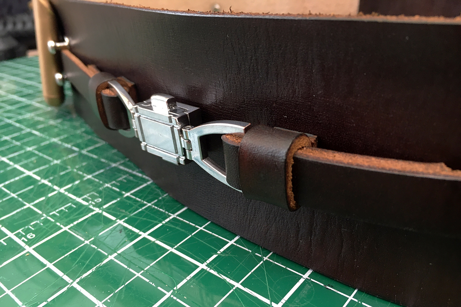

After a top coat to seal it all I assembled everything with the button studs and affixed the loops around the top belt attaching to either side of the buckle.

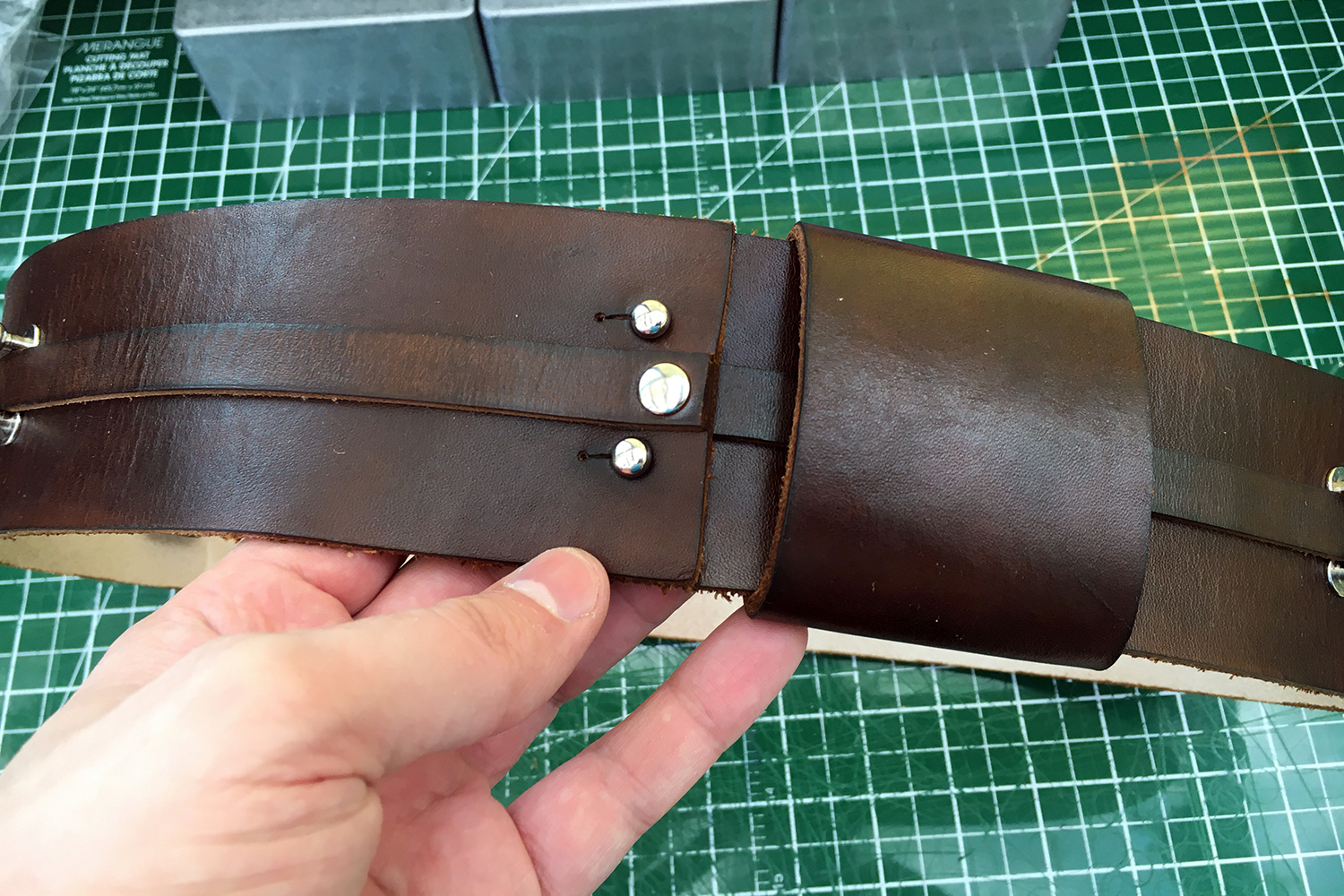

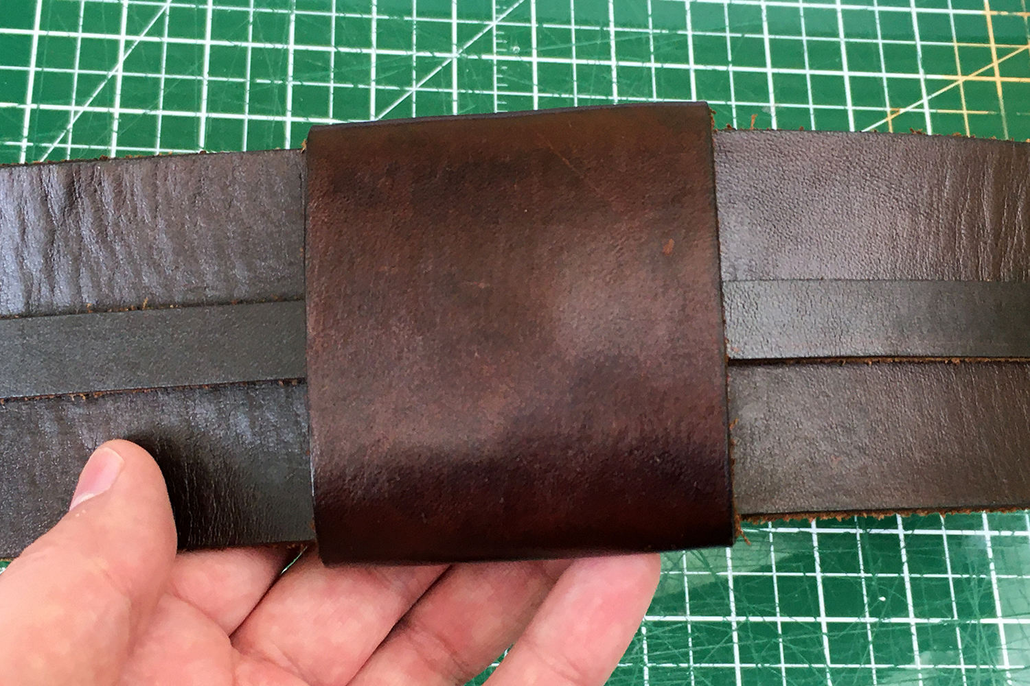

You'll note that I decided on this type of closure at the back, which will work best for the display application this belt is destined for. A couple of the same button studs used to align the top belt pop through a couple holes on the other end of the belt flap. The ends of the top belt pieces are riveted in place. All of this attachment gets hidden by the "keeper" which I made from a loop of the same 2.5" wide leather as the main belt.
I used the same 8-9 oz leather for the main belt, top belt, and the keeper loop, while I used some thinner leather (probably like 6-7 oz) to make the little loops that affix the top belt around the buckle, which appears to mimic the construction of the originals.
I gave the leather a little "pre-weathering" before assembly, but will likely rough things up a bit more over time. But for now, it's done!

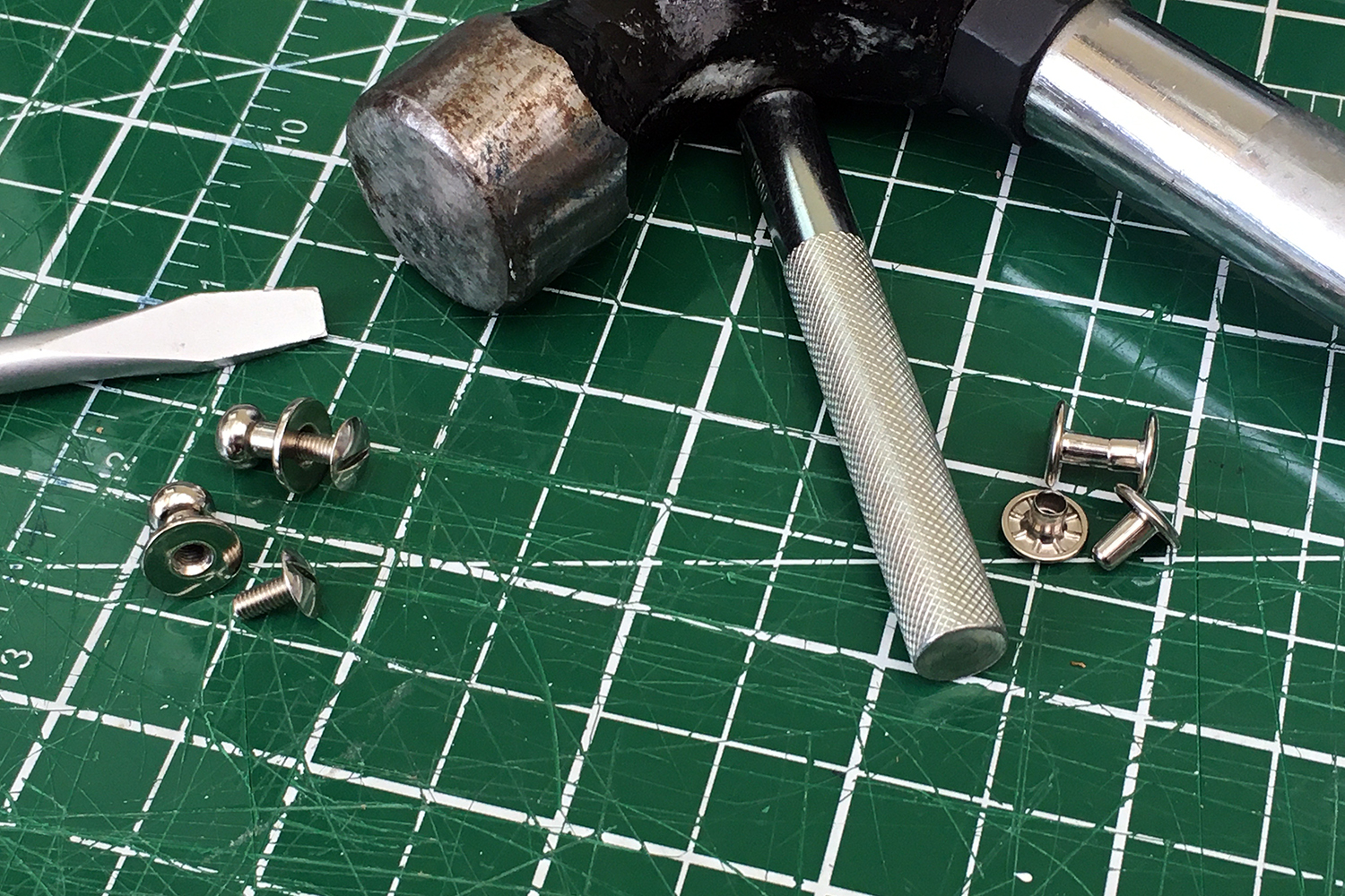

this is amazing! I'm so interested in this.. so, how do metal rivet things get installed on leather with no visible thread or anything?
I never realized the central strip was just held in place with guides, this is really neat
Thanks for the kind words, folks!
The double cap rivets I used on this belt are made of two pieces, one with a cap and a sheath and the other with a cap and a post. Each piece goes into a hole that is punched through the two layers of leather from opposite sides, with the post from one side coupling with the sheath from the other side. Then the whole thing gets hammered with a little rivet setting tool from one side that effectively mushrooms the post inside the sheath, binding them together permanently. The rivet setting tool has a dished tip that preserves the dome shape of the cap on the side you hammer from, but the other side gets a bit flattened if you are just hammering against a flat surface, so it's best to set the rivet from your "good side" and have the flattened side hidden on the back if possible.
Whoa, thats cool. I love that this is probably as common knowledge as changing a drain pipe and I've had no idea, thank you!

I just want to point out that there are also screw-on versions of these button studs available.
The button studs I used are screw-on, but the rivets I used to affix the top belt to the main belt at the back are cap rivets that are hammer set as I described. Here's a photo with the screw-on button studs on the left and the hammer set double cap rivets on the right.

I got the buckle a while back from an Etsy seller called "Saberbelt" here: Obi Wan Prequel Trilogy Buckle
It's a fairly nicely made buckle that actually functions like the originals, but there were some flaws in the plating on mine so I decided to lean into it by going for a weathered look.
