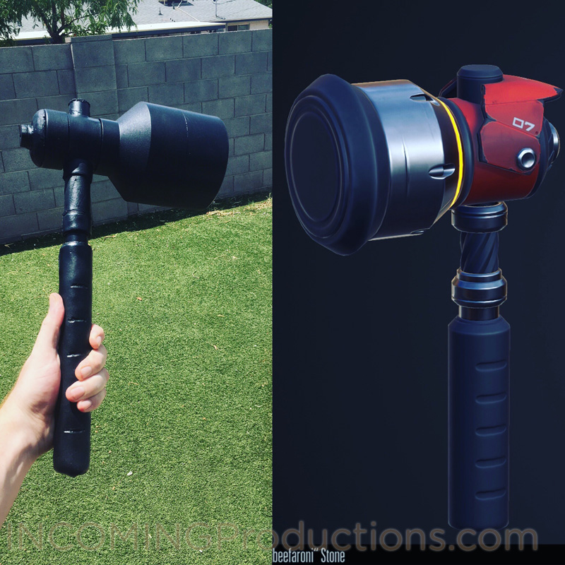

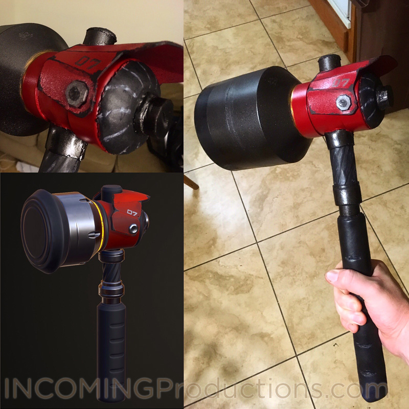

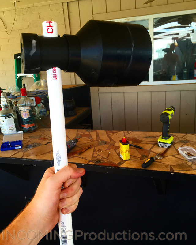

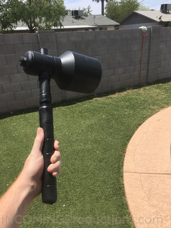

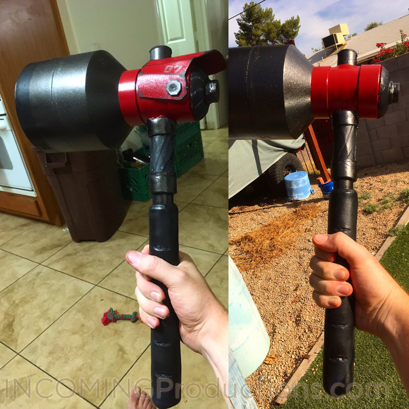

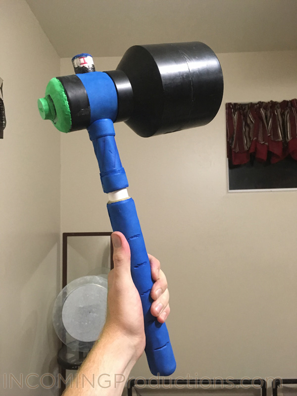

First up was the hammer.
I wanted it to have some actual weight so foam was out. Plus it would be cool if I could actually hit stuff with it. Decided to go with 4" PVC couplings for the hammer head. I left the caps unglued so i could add a battery pack for the EL wire I will use to create the light ring.
Real happy with how it turned out. Hefty. Didn't like the "metallic silver" paint I used so I switched to a different color after this. Might go back and repaint that section.

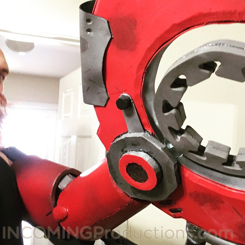

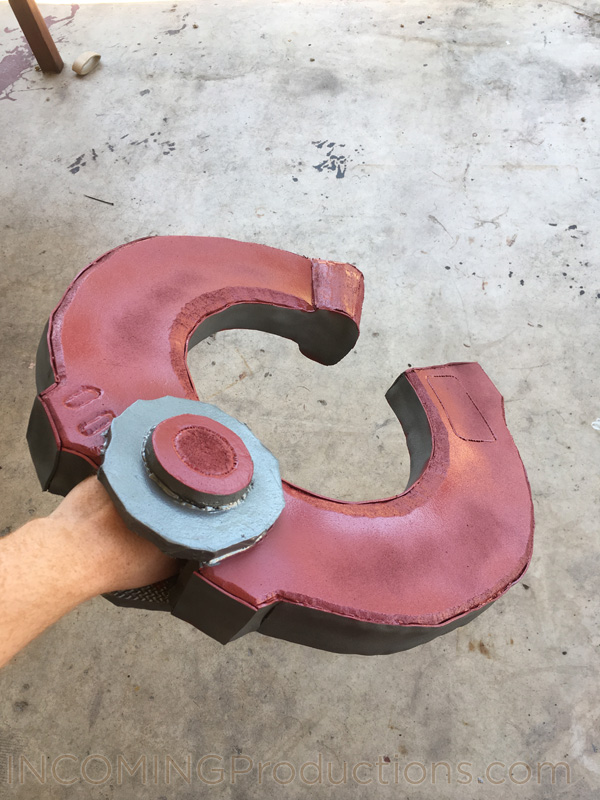

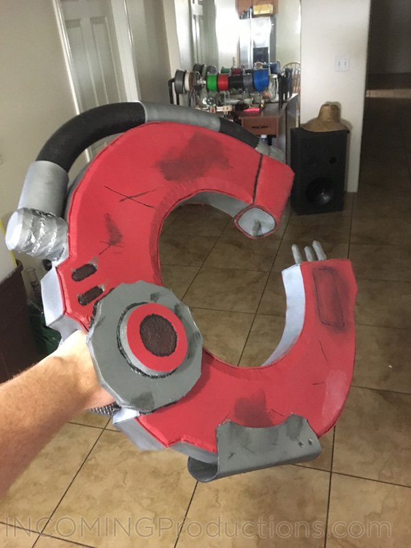

Then there was the claw. I wanted the center ring to actually spin.
Sorry I didn't take more pics of the bracer and claw construction. The bracer is held on by the foam being snug on my forearm. The claw is layered FoamStyrofoamFoamStyrofoamFoam. Just the regular EVA foam was too floppy.

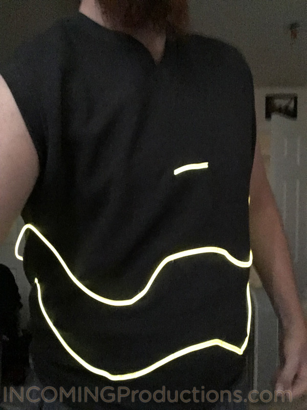

I live in Phoenix. It is usually over 100 degrees at comicon. I refuse to wear a foam armor chestpiece so a simple vest with EL wire will have to do.

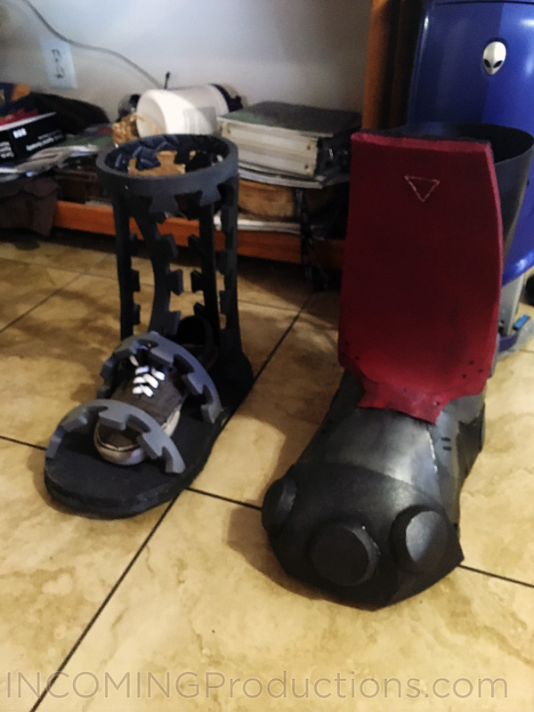

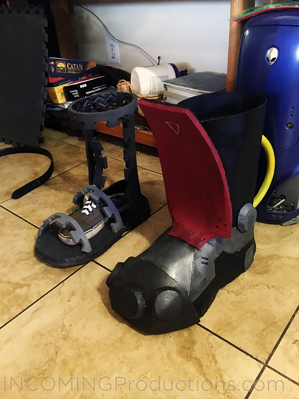

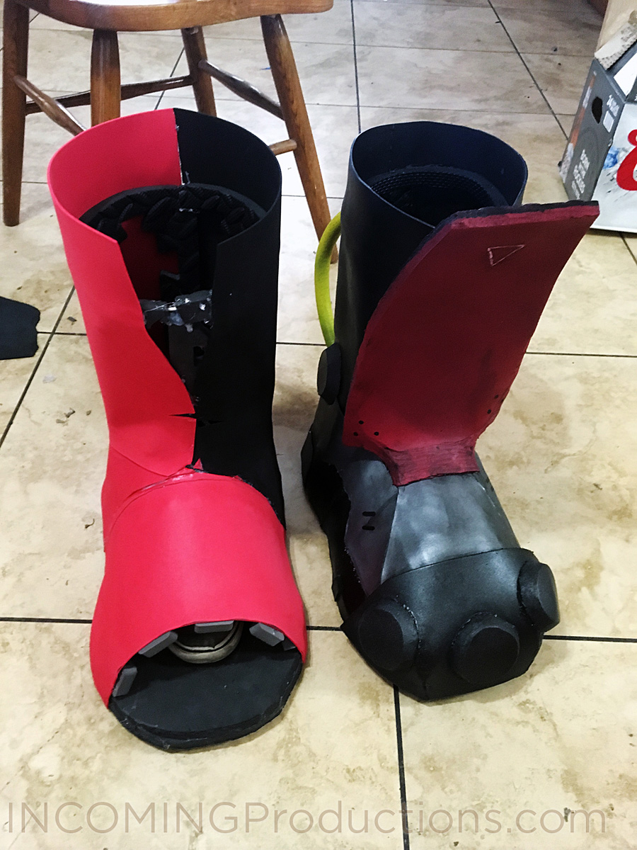

So now we get to the part I could use some help on.

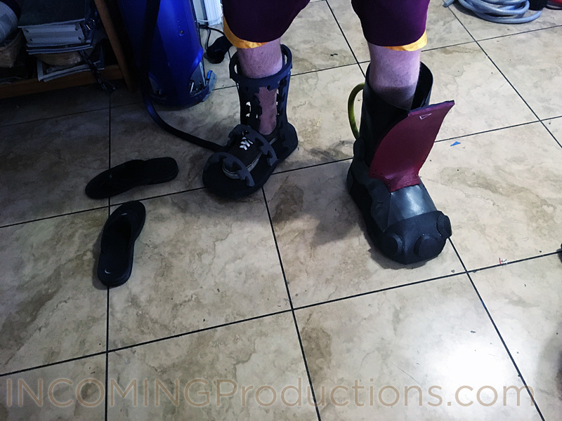

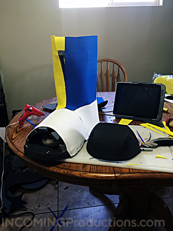

The boots.
The shoes are currently barge cemented onto the foam and I am worried that will break off after walking around awhile. Does anyone have suggestions for how to affix shoes to foam permanently? I have seen some options with straps and screws and such but I definitely don't want to have screw heads sticking up under my foot.
Took a little Overwatch break to clomp around a bit. After about 15 minutes the hot glue/barge cement combination seems to be holding up quite well. I was thinking about gluing/pinning down the laces and filling the toe cavity with foam so if the glue breaks the shoe should still be fairly secure, leaving me able to walk still. Hopefully. Thoughts?

Looking really good already.
With your thoughts on the boots, I imagine what you have will hold pretty well. Depending on how much flex you have in the sole I wouldn't have thought you would need to fill the space. I've a set of iron man boots I've made that have done 4/5 outings now where I just hot glued the full length of the soles of the shoes onto some foam and they're still holding tightly. It may vary depending on the kind of shoe but I think with the addition of the contact cement it would be unlikely that they would come lose easily. Particularly with the reinforcement from the hot glue as well.
Just my thoughts on it but I hope that's of some use.
Incoming
Thanks Ikras. That's like exactly what I wanted to hear. Now I can seal those shoes in and attempt to build these monster boots.

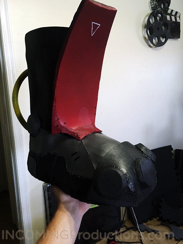

I drastically underestimated the complexity of the boots.
It has taken me the better part of the day to get this far and I still have to do it all again. Dammit. What have I gotten myself into??
I ended up just gluing/pinning down the laces and moving on. Hopefully it all holds.
IMG_0989.jpg IMG_0990.jpg IMG_0991.jpg IMG_0992.jpg IMG_0993.jpg IMG_1006.jpg IMG_1004.jpg IMG_1003.jpg IMG_0998.jpg IMG_0997.jpg IMG_0996.jpg IMG_1007.jpg
I really wanted to see how this was gonna look so I kept working and... voila

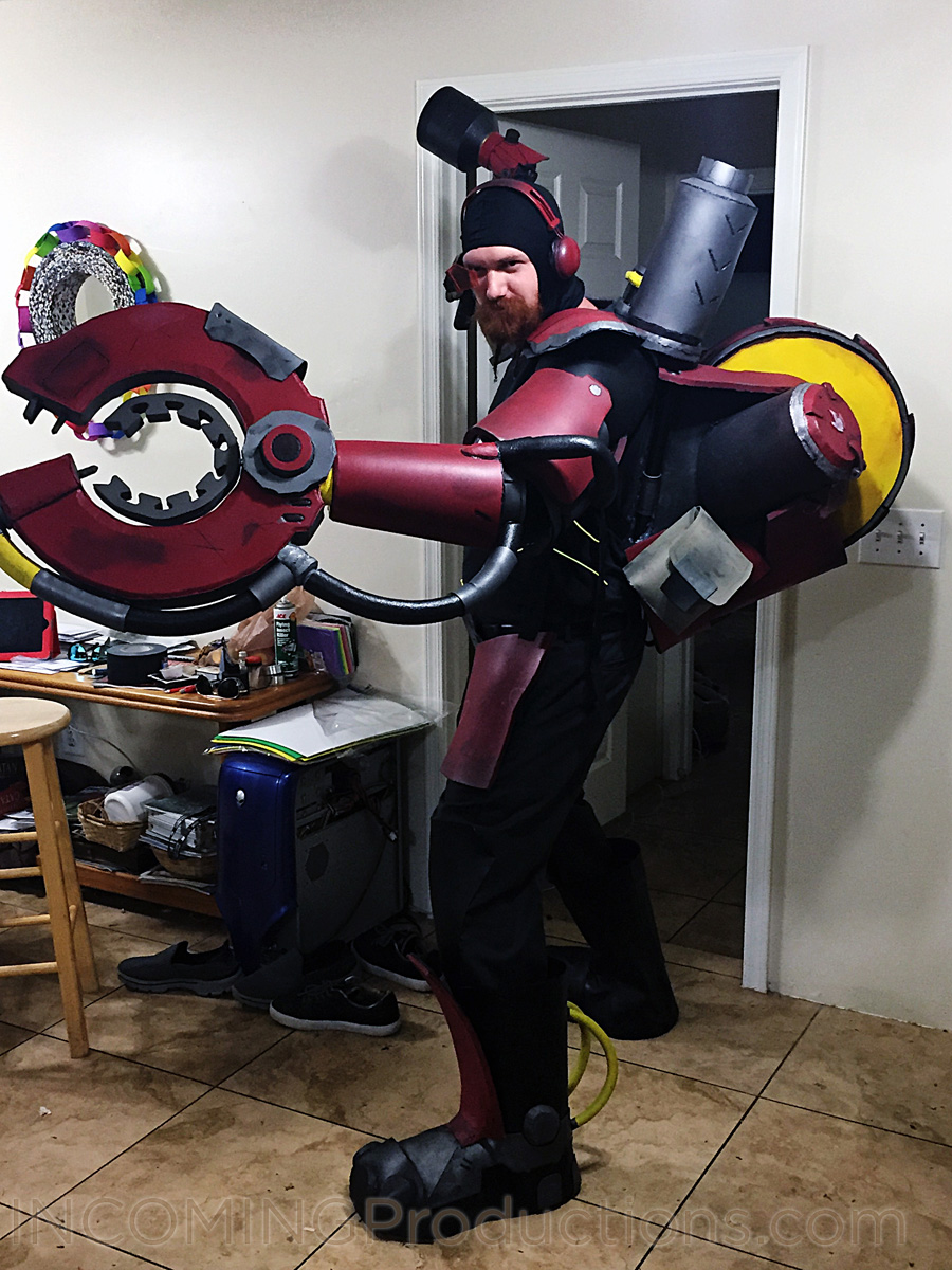

Started on the wheel for the back pack. Really hoping to get this spinning by comicon.

This baby's gonna spinnnnnn!!!
Also, I built the wheel too large. Oops. Now the backpack is kinda out of scale but oh well. Bigger is better I guess.

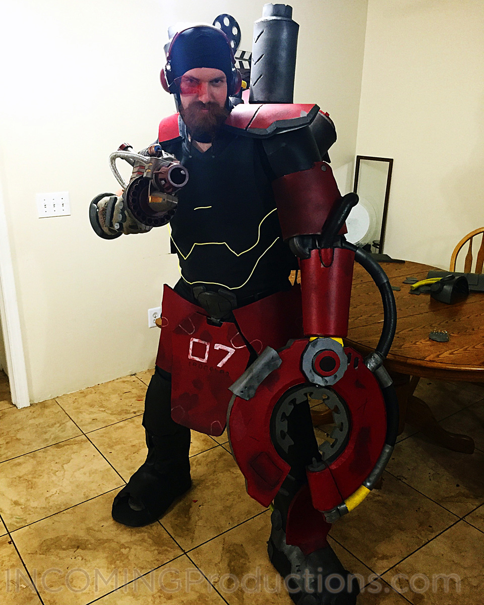

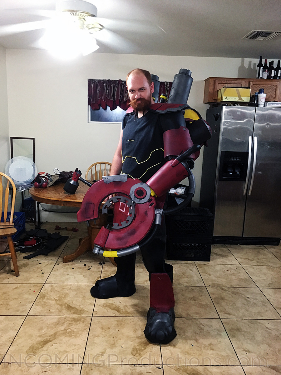

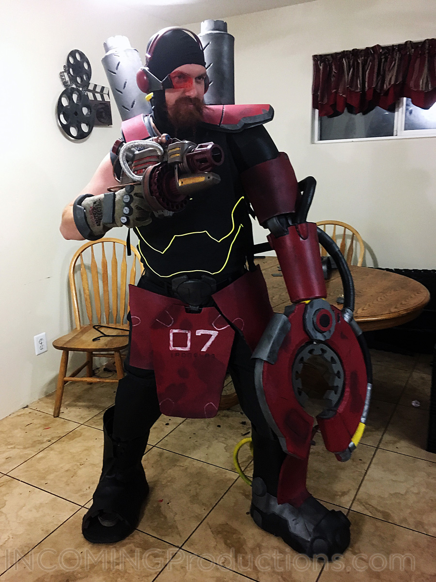

90% COMPLETION UPDATE
So PCC starts today but since the forecast is 118 degrees all weekend I'm only wearing the full thing on Saturday. And I'll probably die of heat stroke. But we will see how the partial cosplay goes today and tomorrow.
Still gotta finish a boot and the helmet then just some final details. Enjoy!
