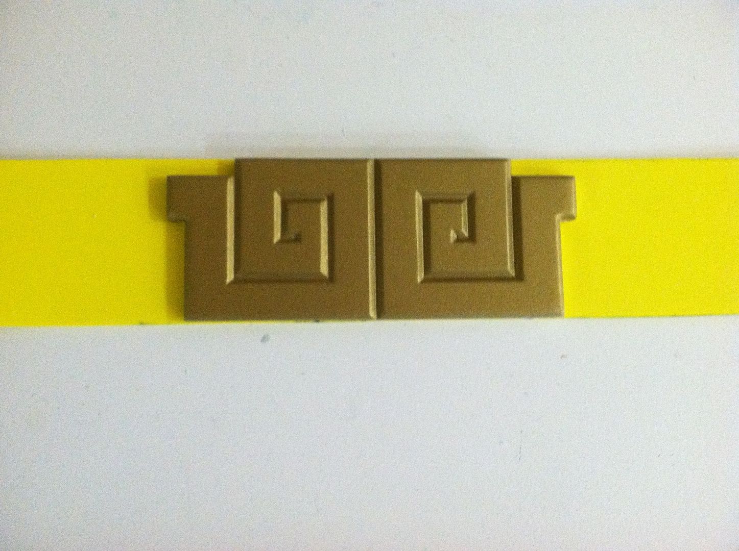

Belt: I am creating the belt myself and adding a purchased belt buckle (raw cast) that I will be painting and finishing.

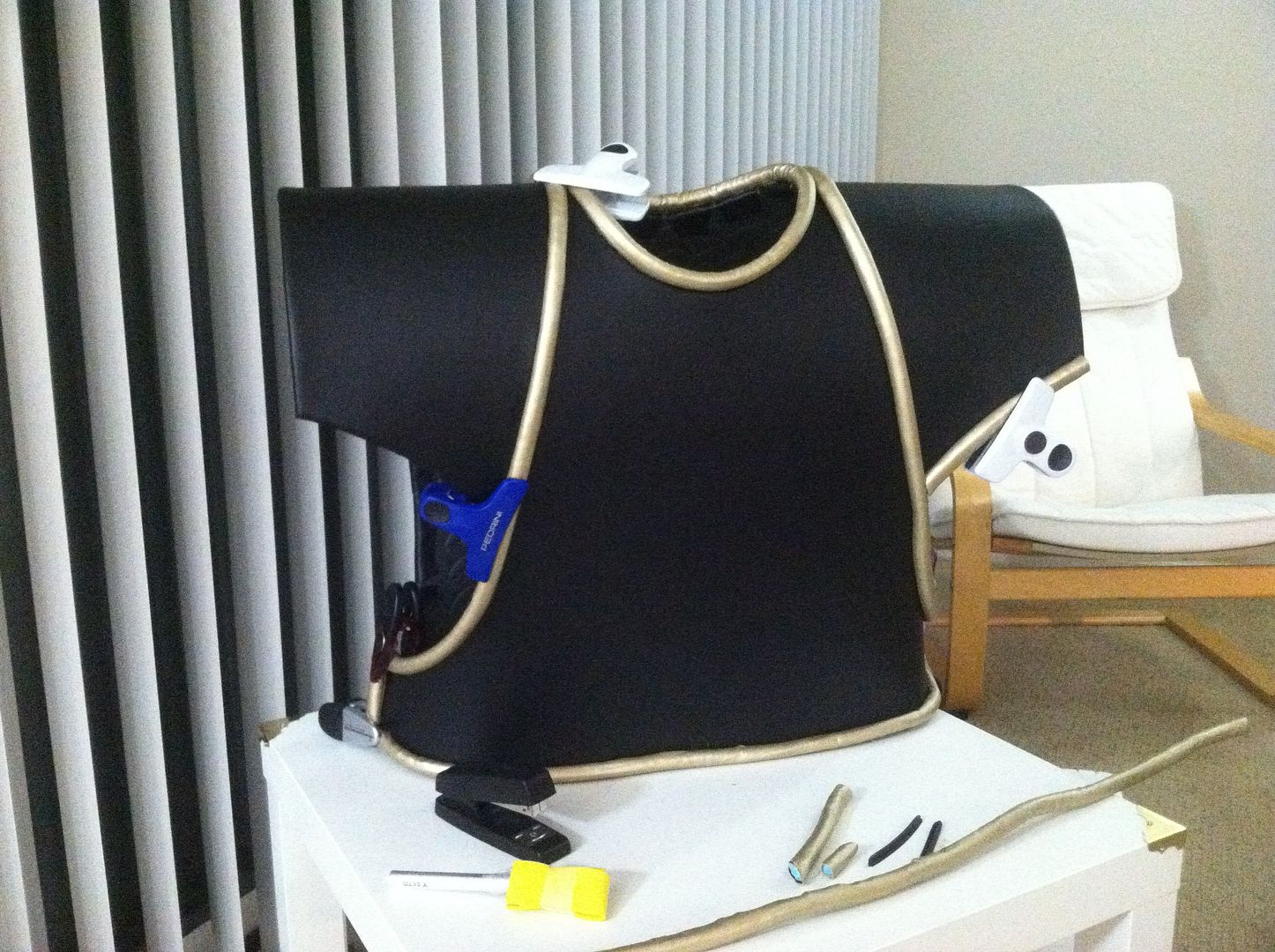

White Ranger Shield:
For this I looked up TONS of different styles and builds. My favorite build being here on the RPF which I am stealing heavily from.

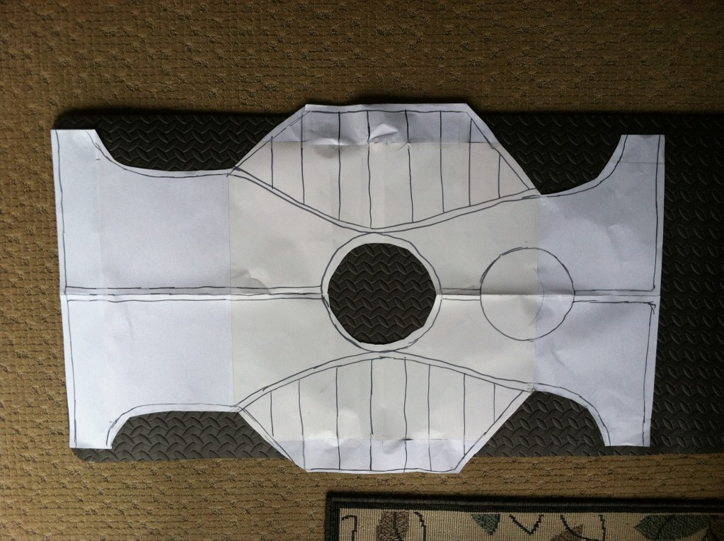

I started by taking my measurements and approximating the overall size. Here are the measurements I used:
-Waist (adding a bit of room for movement)
-Overall width (shoulder to shoulder)
-Length (Kibaranger had a shorter shield that only went down mid-way to the chest, the White Ranger had a longer shield that came down to the belt)
From there I taped some paper together and freehanded a crude template.
Then I used this picture and superimposed a front shot of the White Ranger to reshape the contours and draw the lines. Here's the result:

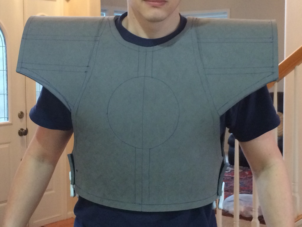

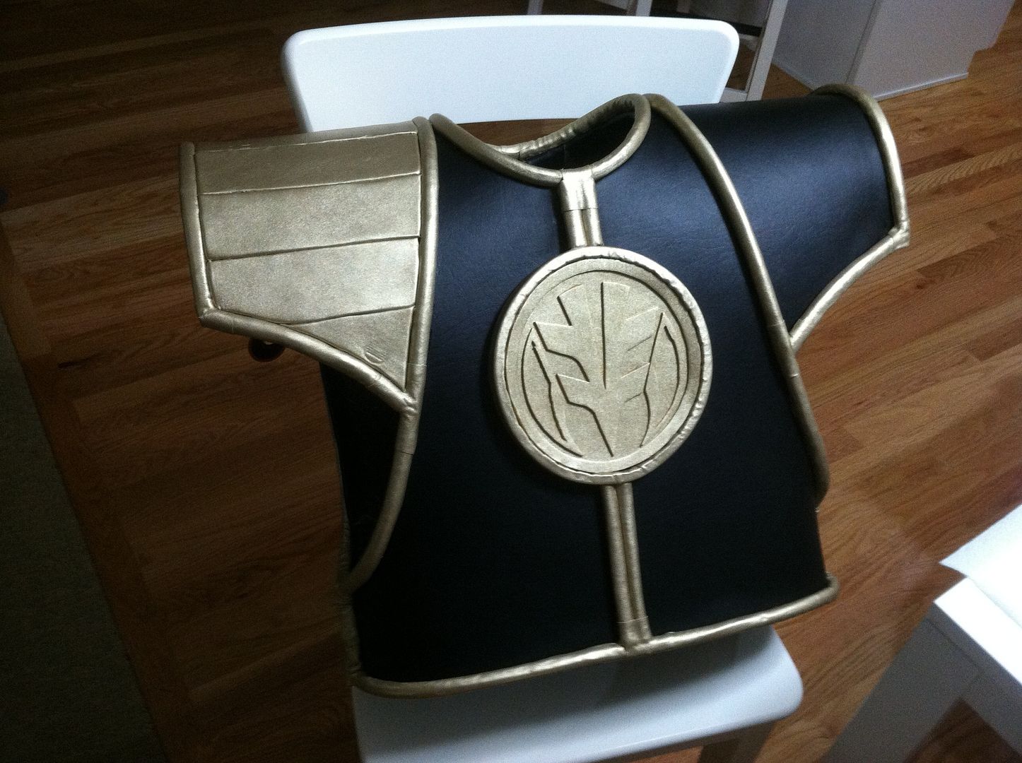

At this point I transferred the pattern onto 5/16th inch EVA foam. I bought it in roll form from Harbor Freight Tools so I could make the entire thing one piece:
0BE0C3B9-CF80-4B02-9B3C-587EEC0D2B6C-3195-000004C57DB2DFFE_zps2159a19a.jpg 295A0918-AB7A-41C9-BC5F-EB2AEE38B4AF-3195-000004C586BEDB8B_zps48e89809.jpg
And with some finesse:
Test fit before continuing:
I then used spray adhesive to glue a layer of satin leatherette to the outside as the base layer (spray adhesive held the fabric down fairly well on the flat surface, but I had to go around and reglue all the edges with E6000);

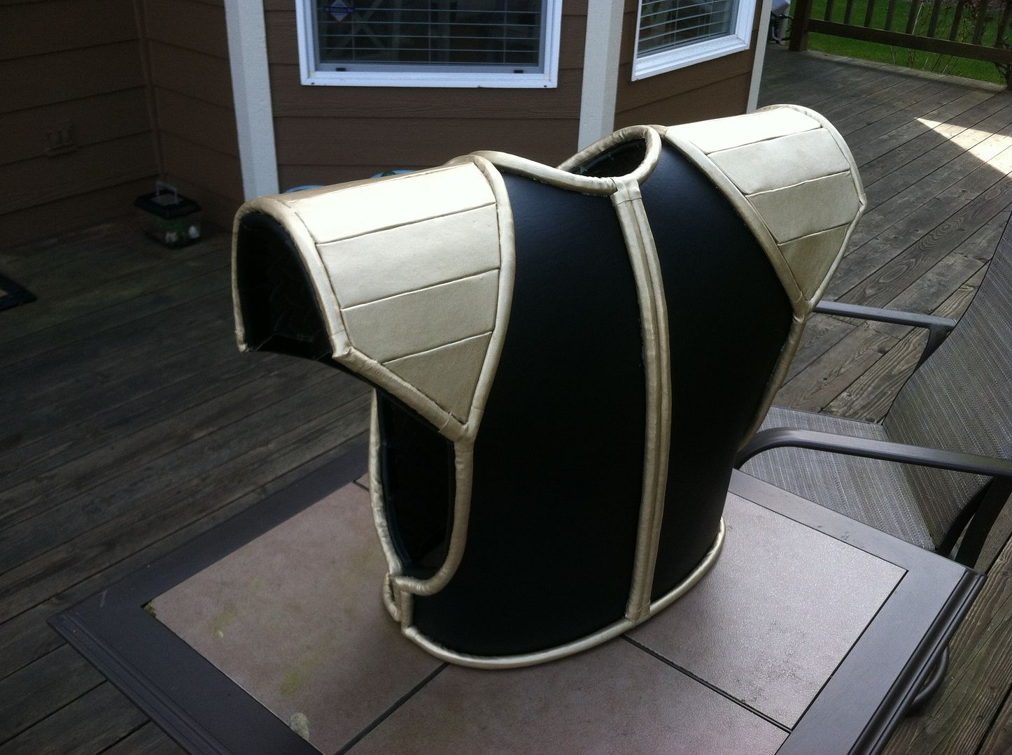

Updates: I'm pretty happy with the fit of the shield at this point. I will be using snaps instead of velcro to attach it (I used velcro on my green ranger shield and I never liked it). Also I finished tailoring the boots last night - it's a small detail that I think makes a huge difference. Most of these "costume" boots are very loose/baggy and can ruin the look of an otherwise-perfect cosplay.

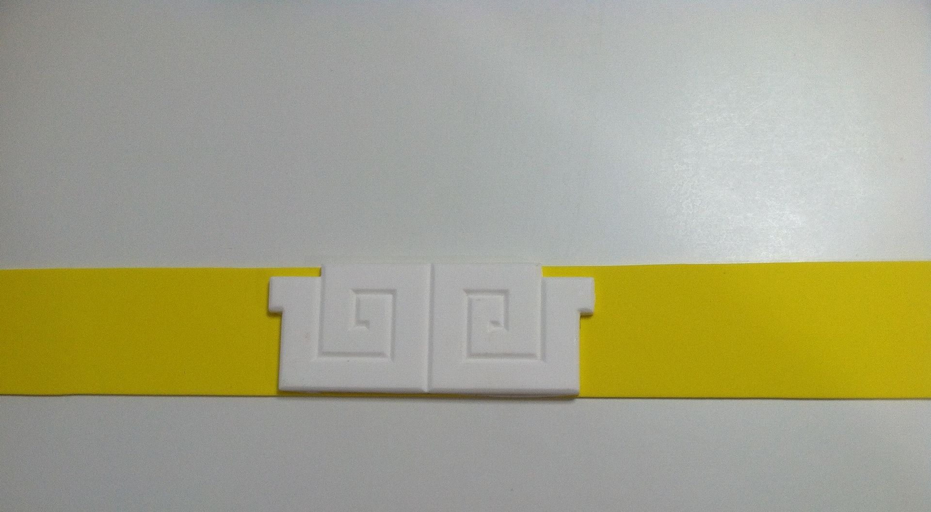

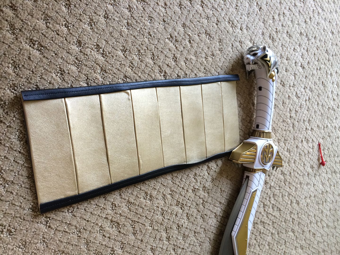

I also started working on the belt. I cut a 2" strip of funfoam which I will cover with the gold vinyl fabric and stitch. My concern is that painting the buckle will not match the color properly - I got Liquitex Professional "Antique Gold" which I am hoping will match OK.

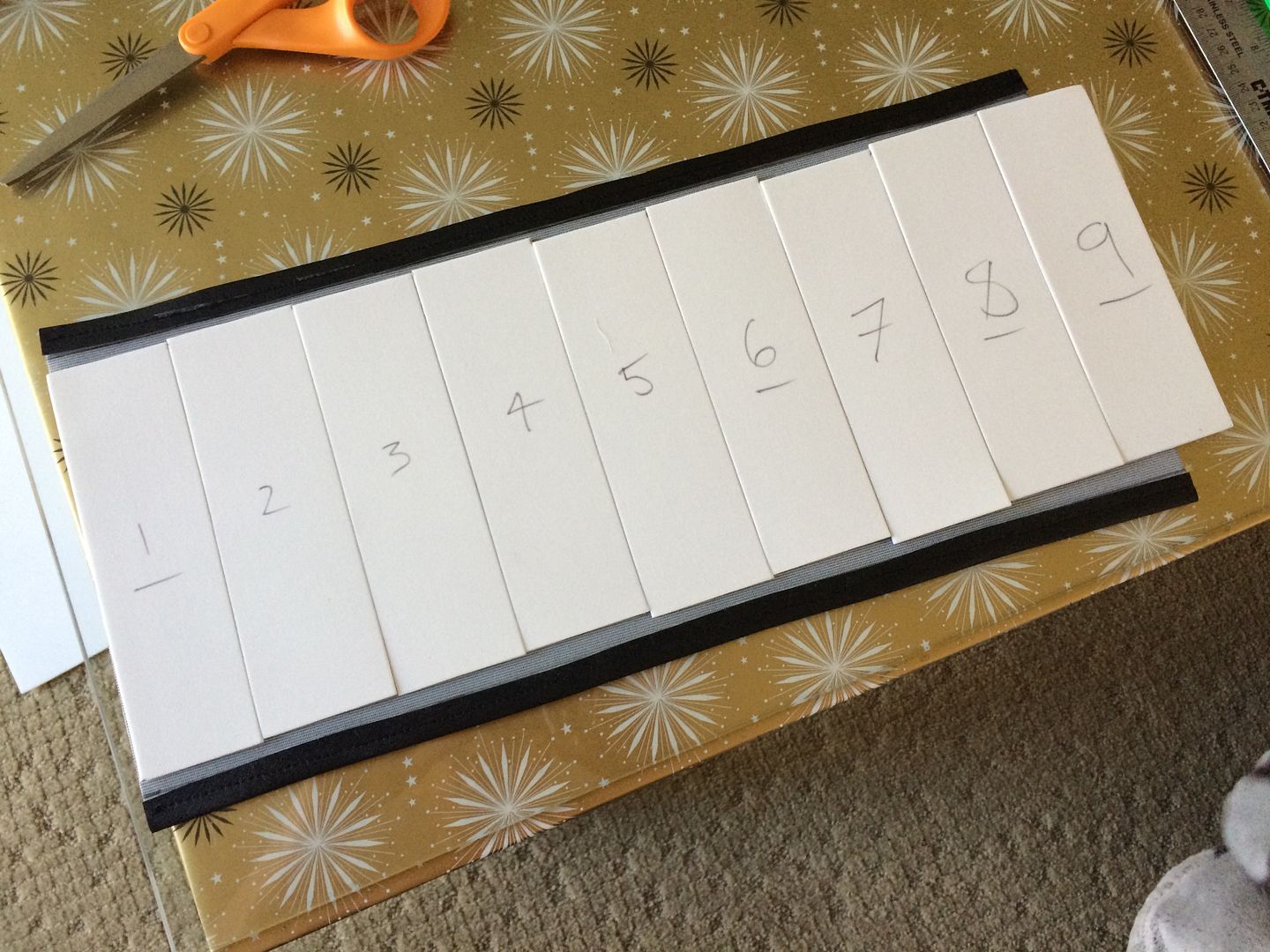

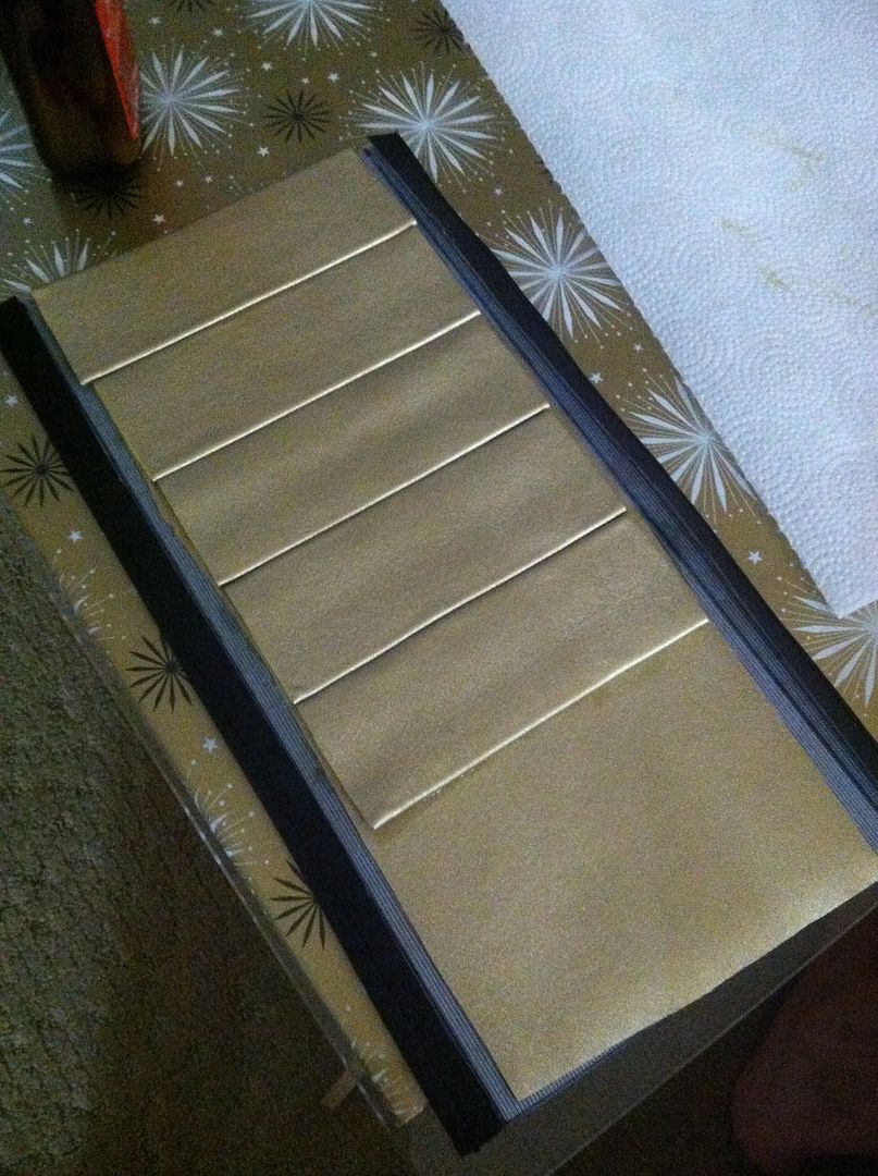

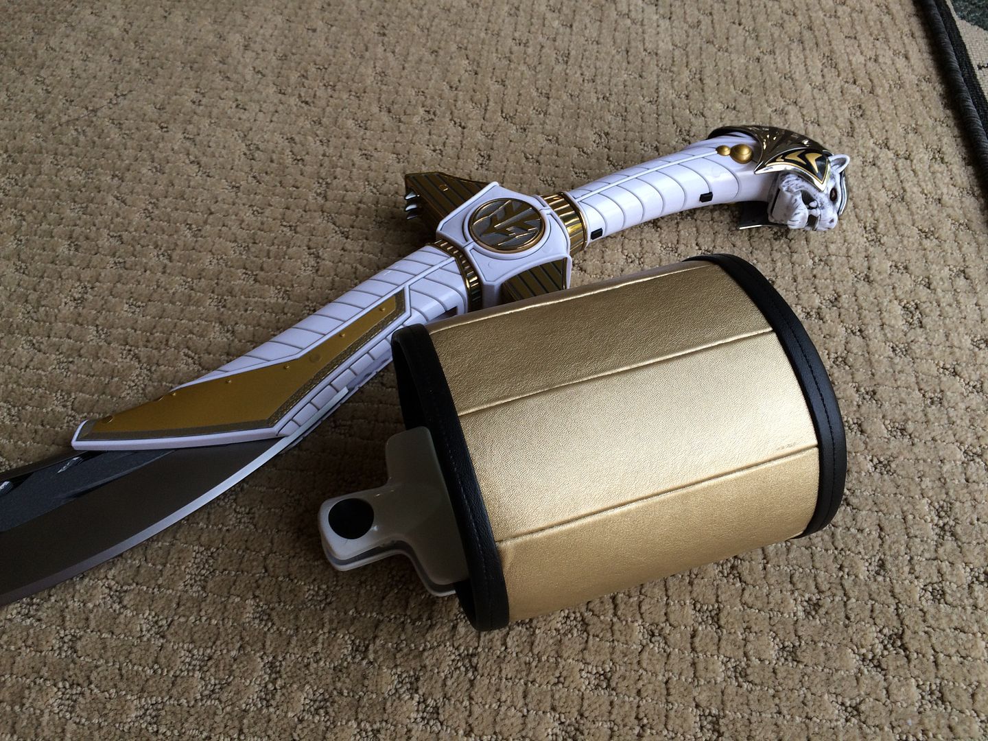

And lastly I have been working on a method for the cuffs that I think is pretty unique compared to most of what I've seen out there... more on this later!

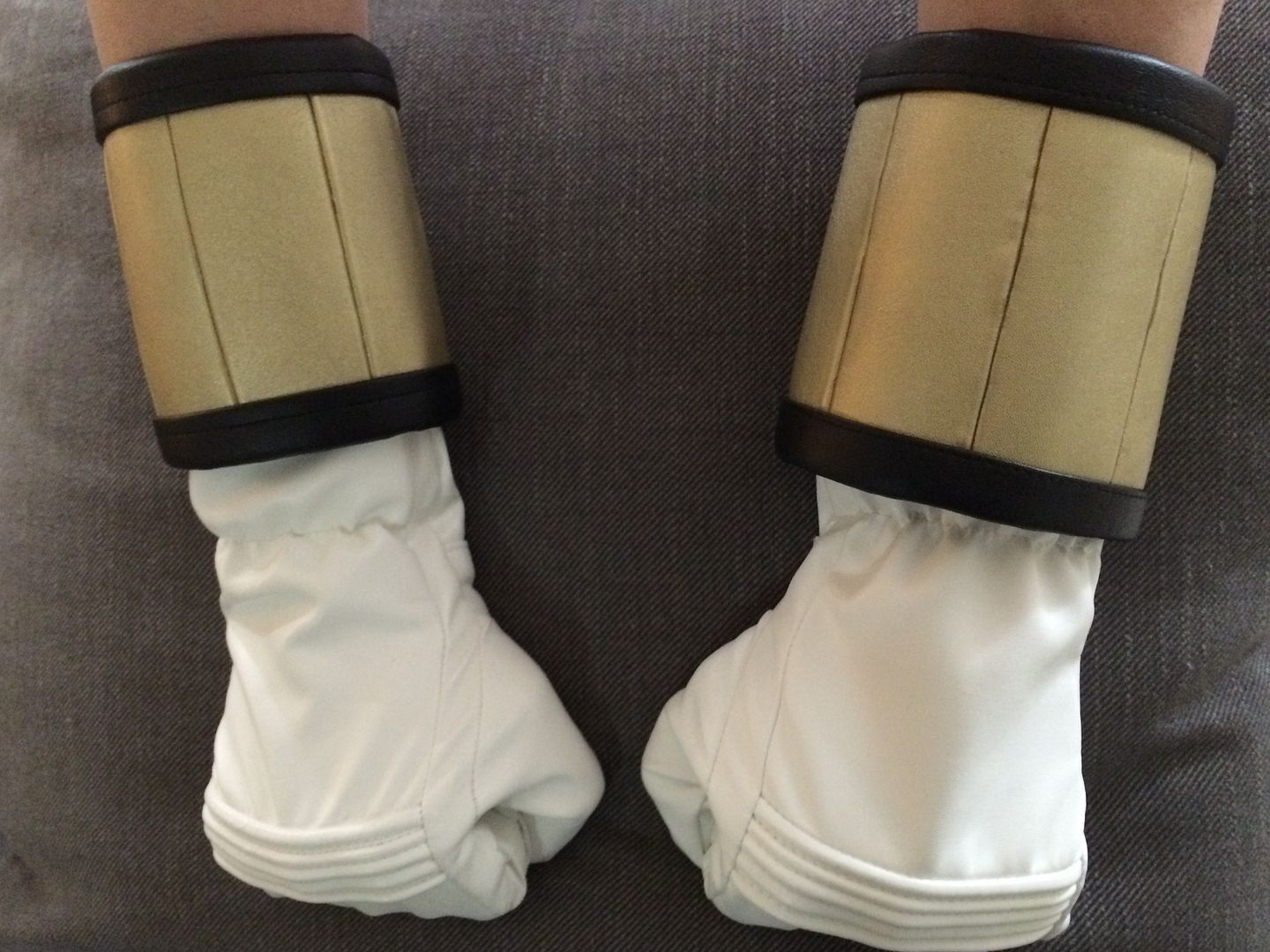

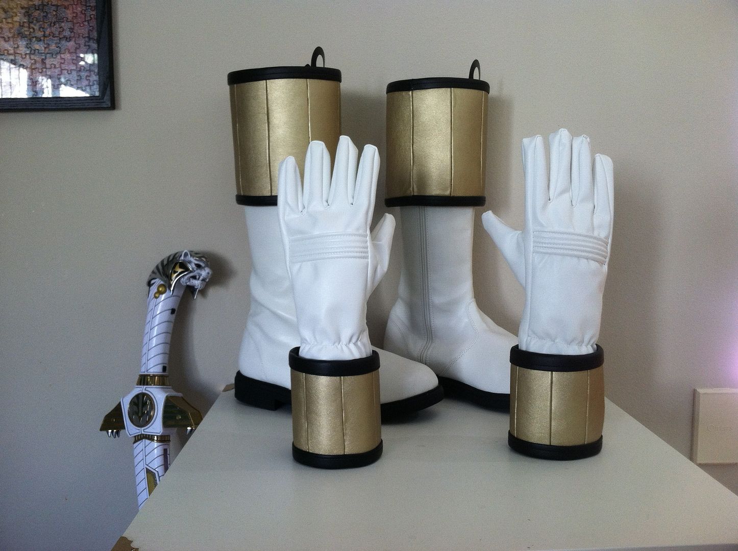

Boot & Glove cuffs:
I spent a lot of time on these. After looking at quite a few White Ranger costumes online, it seems that most people focus heavily on the helmet and shield, and perhaps less thought goes into the boot and glove cuffs. I know of at least one seller that is considered to be one of the best Ranger Cosplay sources that builds the cuffs this way - It was really important for me to make cuffs that appeared to be more screen accurate.
Here's an example of a really good white ranger cosplay - as you can see, the glove cuffs are just gold panels with a piece of black material behind it. They aren't shaped particularly well and they have large gaps where they zip up. (I am in no way meaning to offend the owner here, just trying to illustrate the differences)

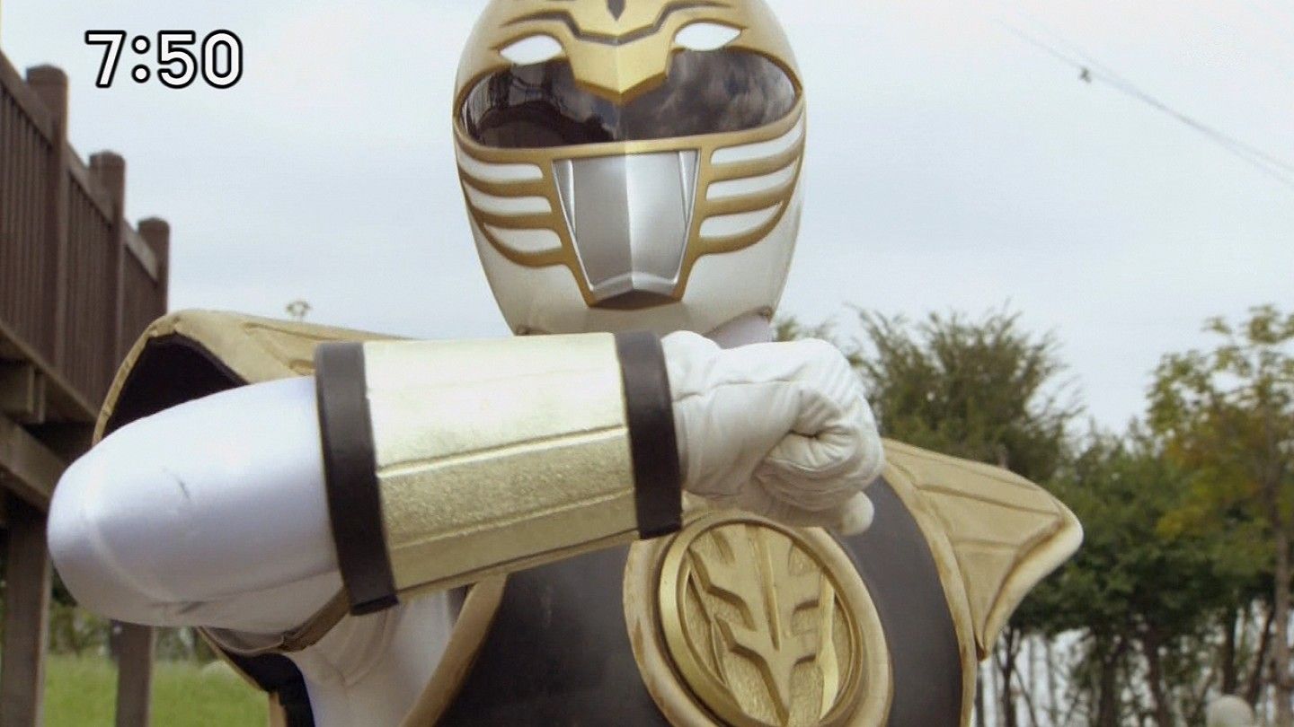

While here's an actual screenshot from Dairanger - you can see clearly what the Kiba cuff looks like - it's as if the black material is actually "covering" the gold on the ends. It's a shorter & fatter cuff, too.

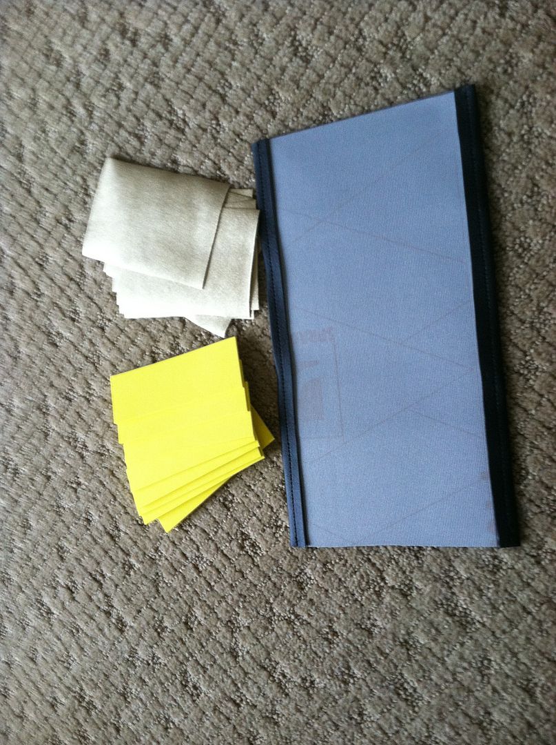

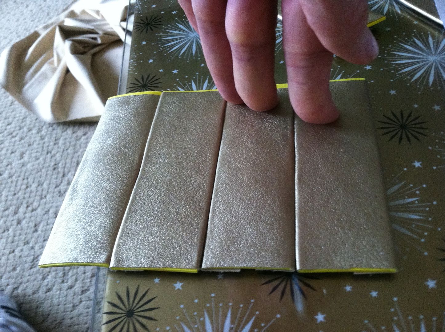

This is what I set out to make, and I think I did a pretty decent job of recreating the look. I began with the pretty common base: funfoam covered in gold fabric. But instead of affixing this to some black material, I instead created a rolled edge out of black vinyl and folded it over the ends of the gold pieces, achieving the "wrapped-around" look. Hard to explain, so you'll have to reference the photos.
EEE8195A-9B13-4394-B202-0B0598C6C035_zpsevqha7am.jpg~original
8BA8158E-AE35-4932-8F94-5D24C5E5D3CB_zps3lelfqoy.jpg~original
801DF0C2-001A-461F-B69D-6B890102DAA3_zpsuzgqmcnw.jpg~original
Here's what the cuff looks like before I fold over the rolled edge:
ACBAA664-C98B-4B1B-8C58-062B01C5EA61_zpshrswetqk.jpg~original
And folded over:
6D30F404-DEAF-4617-8CBB-C2D2C45E5204_zpsvudqfciq.jpg~original
And with the ends connected:
891DD992-2B1D-4E25-9EF8-8D21B1036960_zps4zaneact.jpg~original
All finished!
8951EC10-29F0-4137-A957-A1E0A8AB1F69_zpsdou2x6kg.jpg~original

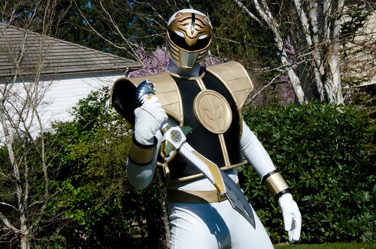

As you can see, the look is much close to that of the screen-used costume:

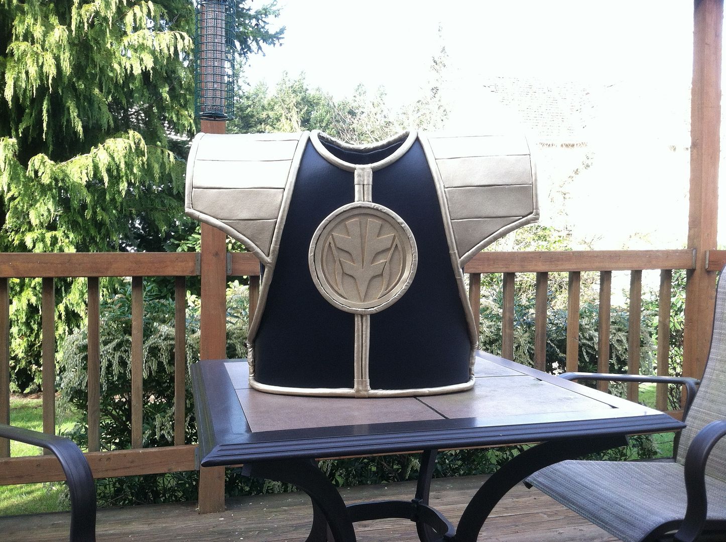

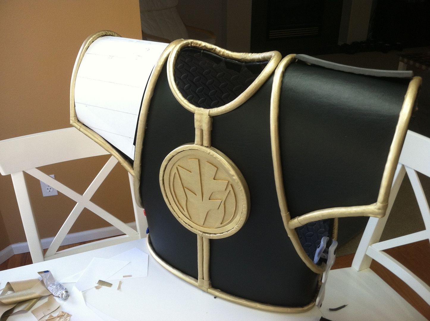

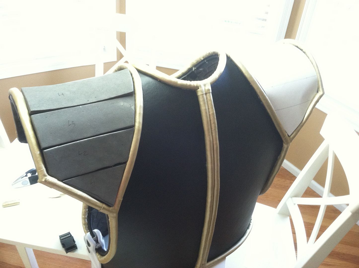

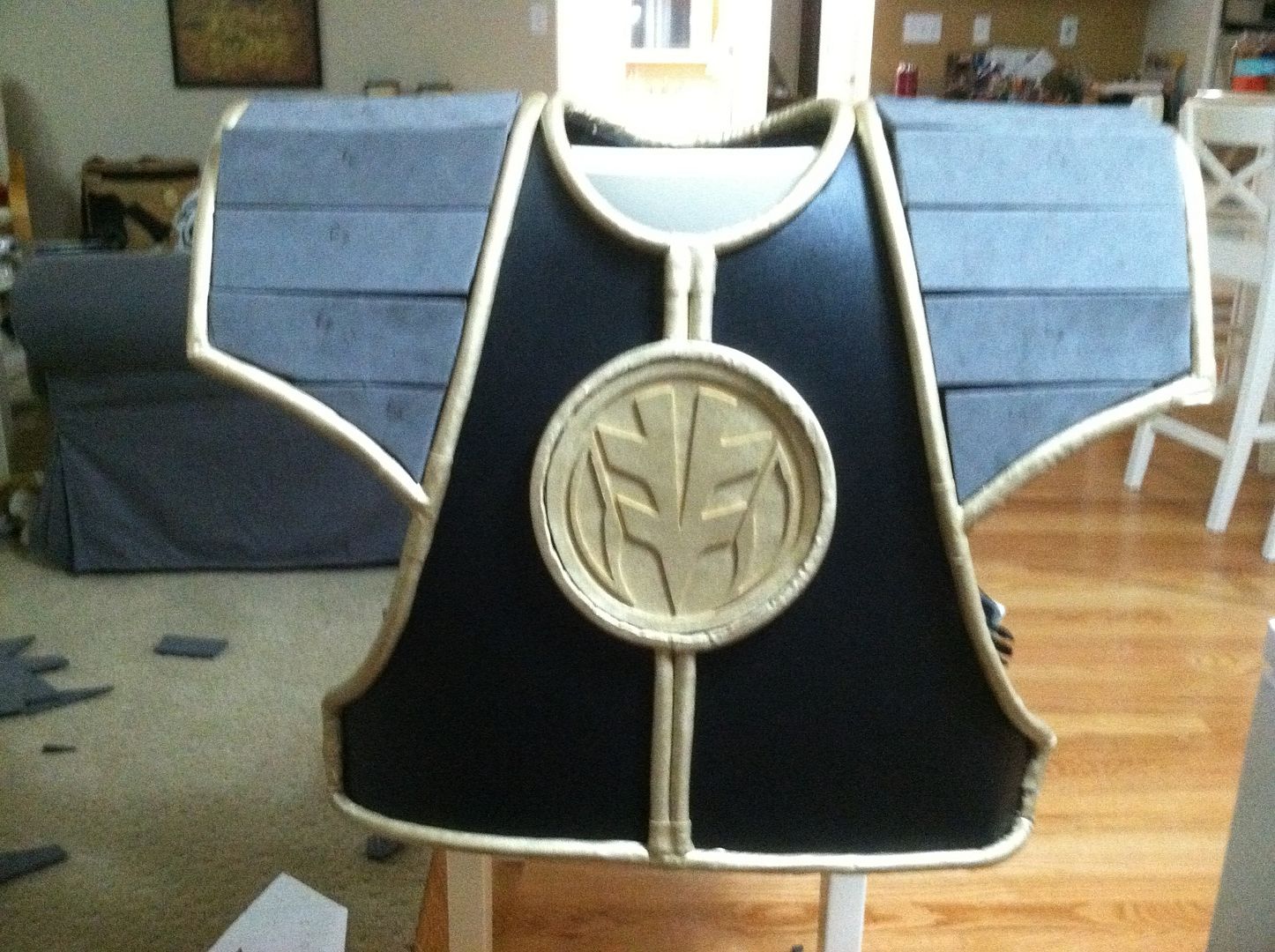

The Shield:

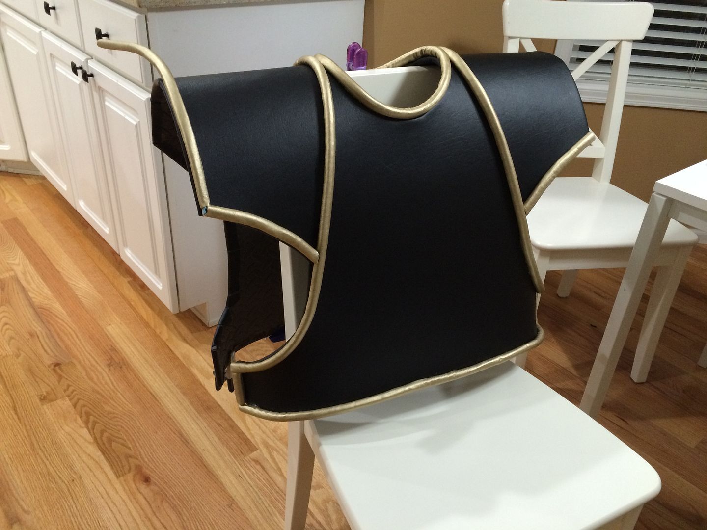

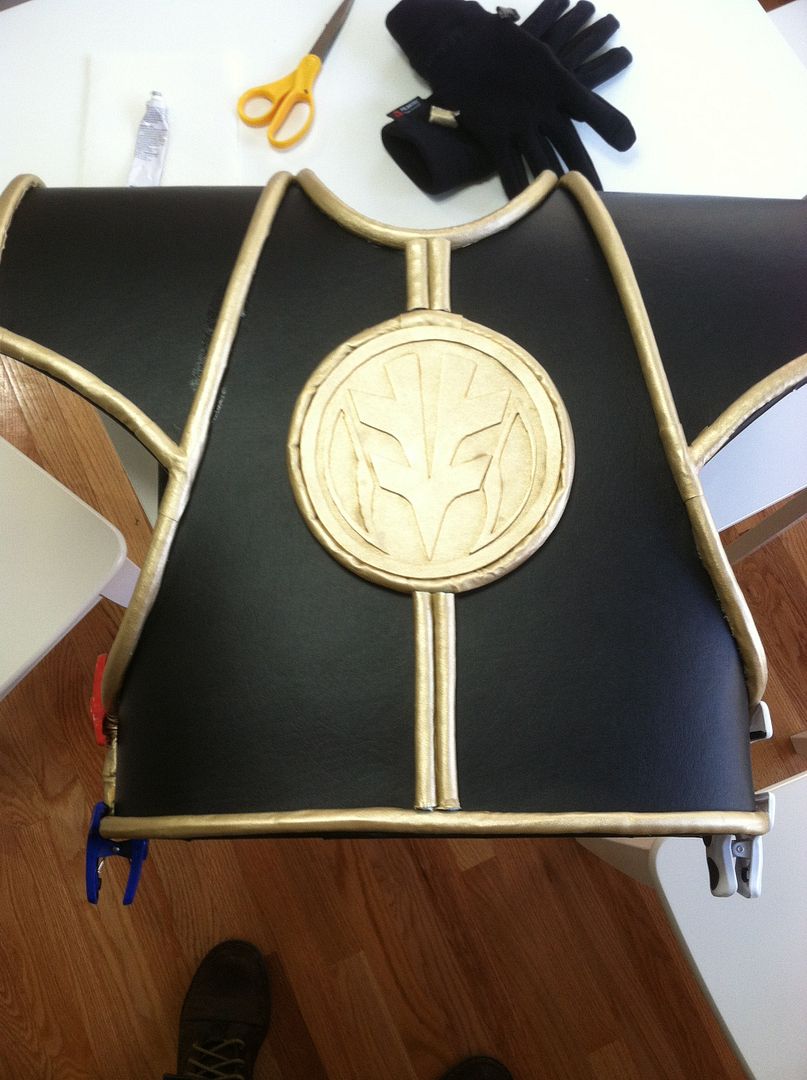

This one was a beast, no doubt my most difficult prop I've ever built. For this one, I used the images from the original footage along with the S.H. Figuarts white ranger action figure.
I left off having just covered the entire shield in black vinyl. From there, I began covering 1/2" diameter braided rope in gold vinyl fabric. This task was pretty horrible in the beginning, but I learned a few things and improved my process. I began gluing the gold "trim" to the shield in all the correct places:
4435BD80-58F5-4E13-9313-5DEB334FDA9C_zpsvmckqmev.jpg~original
49851F2F-BA29-4856-8473-E20C26D27DFB_zpsdzfcvcou.jpg~original

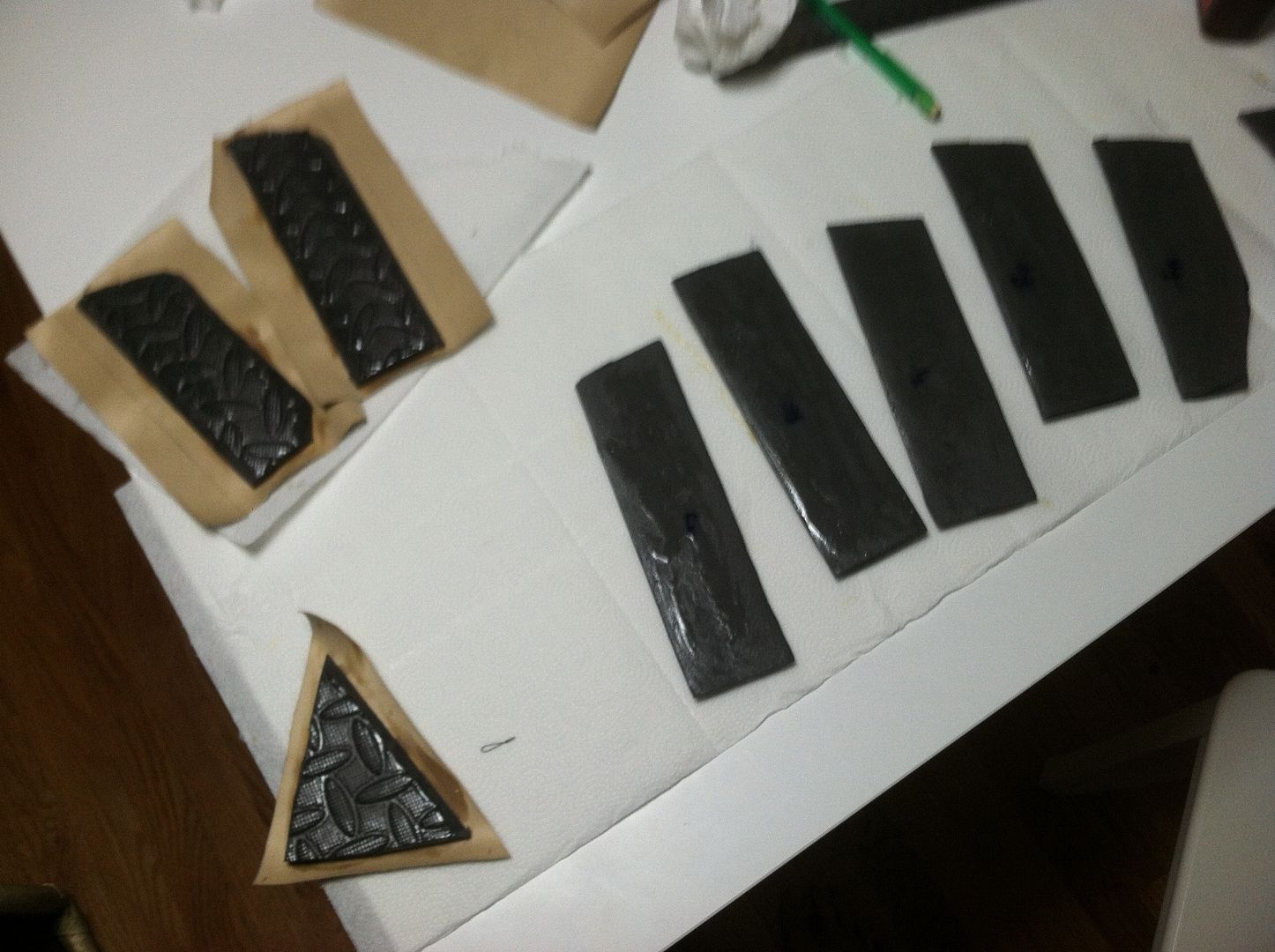

Unfortunately I don't have any pictures of making the coin, but I will explain. I started with a sheet of funfoam and glued on some gold vinyl fabric. I printed the design (thanks Google Images!) and I used a glue stick to adhere my template to the other side of the foam. I cut out the foam using the template, then peeled off the paper and was left with the gold-coated funfoam shapes. From there, I hand-painted the edges of the foam with gold acrylic paint and glued the entire thing down onto a gold-coated foam circle. The result was fantastic! (My first attempt at a "circle" around the coin turned out too wrinkly. As seen in the rest of the shots, I ditched the one in this pic for a thin strip of 3/8" EVA foam coated in gold, much cleaner!)
CCF23D66-8FB8-435F-8C47-0BB919C44558_zpsulacmh3i.jpg~original
Filling in the shoulders is where it got crazy. Covering all the shapes in foam and gluing them down was really tough! I made a paper template of the areas to fill and from there, created templates for all the shapes.
F458BF1D-B396-452D-BC92-C80B3D43F980_zpsplttiwnz.jpg~original
0974BBE9-3C36-467B-9852-109F9366EDC9_zpsgttnhemd.jpg~original
ED9D9E4C-39C1-4C15-9FEF-9C96D72D549D_zpsh5nkt0ee.jpg~original
Getting them all to lay flat as they curved around the shoulders was pretty simple - I just beveled the edges of the underside of each foam piece!
IMG_9032_zpszkfq6ydo.jpg~original
One side done:
IMG_9033_zpsn4jgdrcc.jpg~original
And complete:
IMG_9041_zpszszbn4jg.jpg~original
IMG_9038_zpsyytk4a2z.jpg~original
The shield fastens on either side with two buckles per side. It slips over my head so there is no split down the back or anything like that!
Belt:
This was pretty straightforward, not many pics of the process. As mentioned above, I started with a cast buckle. I painted it gold:
51096C3B-C2E0-4669-85CB-4E530AACE128-3683-00000522EACEC065_zps742bff75.jpg~original
2755C41F-83E4-4239-9D9A-6E00C991C90C-3683-00000576438E6A0A_zps71bfa46d.jpg~original
Then painted the outlines with a black paint pen. I again covered the funfoam in the gold vinyl. I affixed the buckle and in the back, used an actual buckle sewn to some elastic to connect each end.

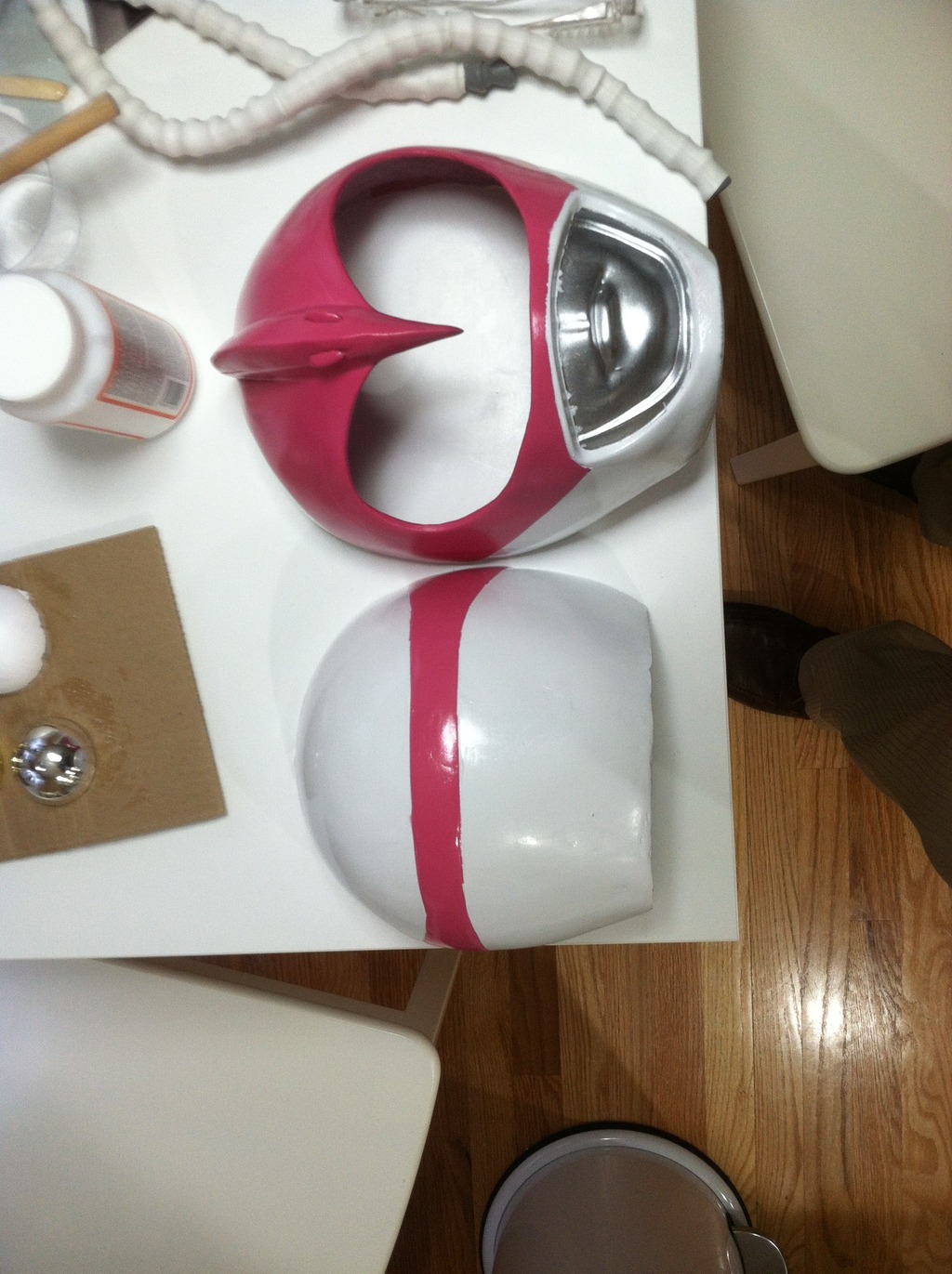

I've started the Pink Ranger helmet for JuJuBean, this has been pretty fun for me. It started with taking the raw casting and using Bondo filler to smooth out the imperfections. Sand, prime, bondo, repeat. I then used the dremel tool and cut the helmet in half.

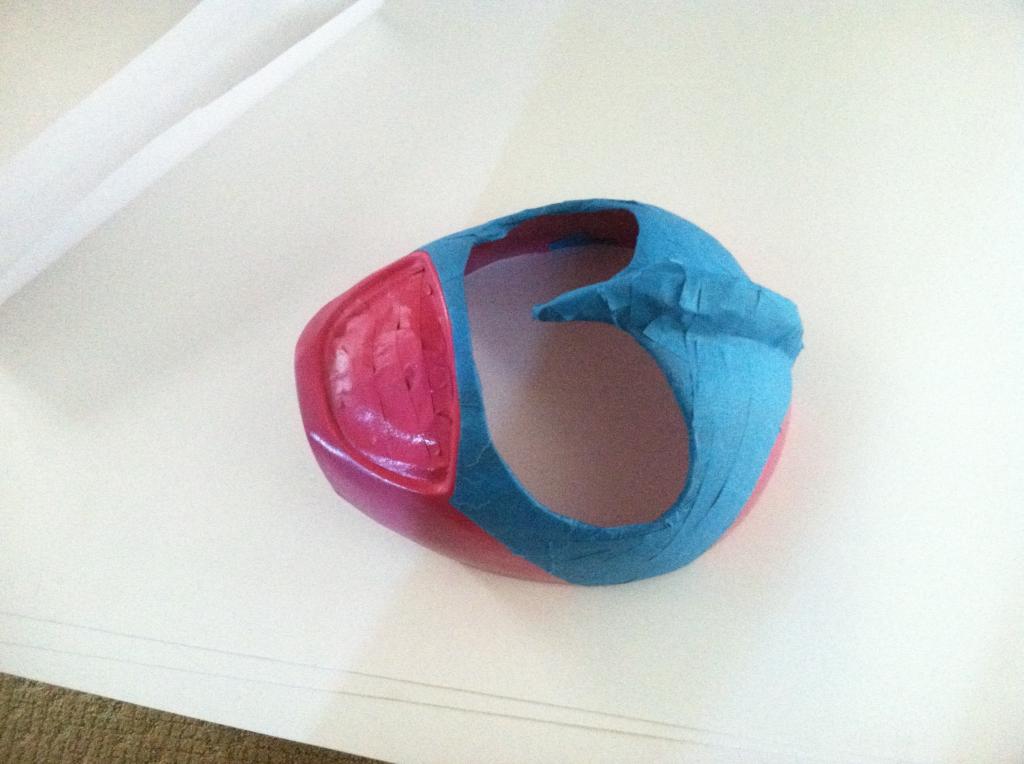

From there I painted the mouth silver, then masked it off and painted the face pink. Lastly, I masked off the pink and painted the rest white.
For the back, it was pretty simple. Paint the center stripe pink, then mask off and paint the rest white.
I still have to wet sand & clearcoat the finish, but it's looking pretty good so far!
