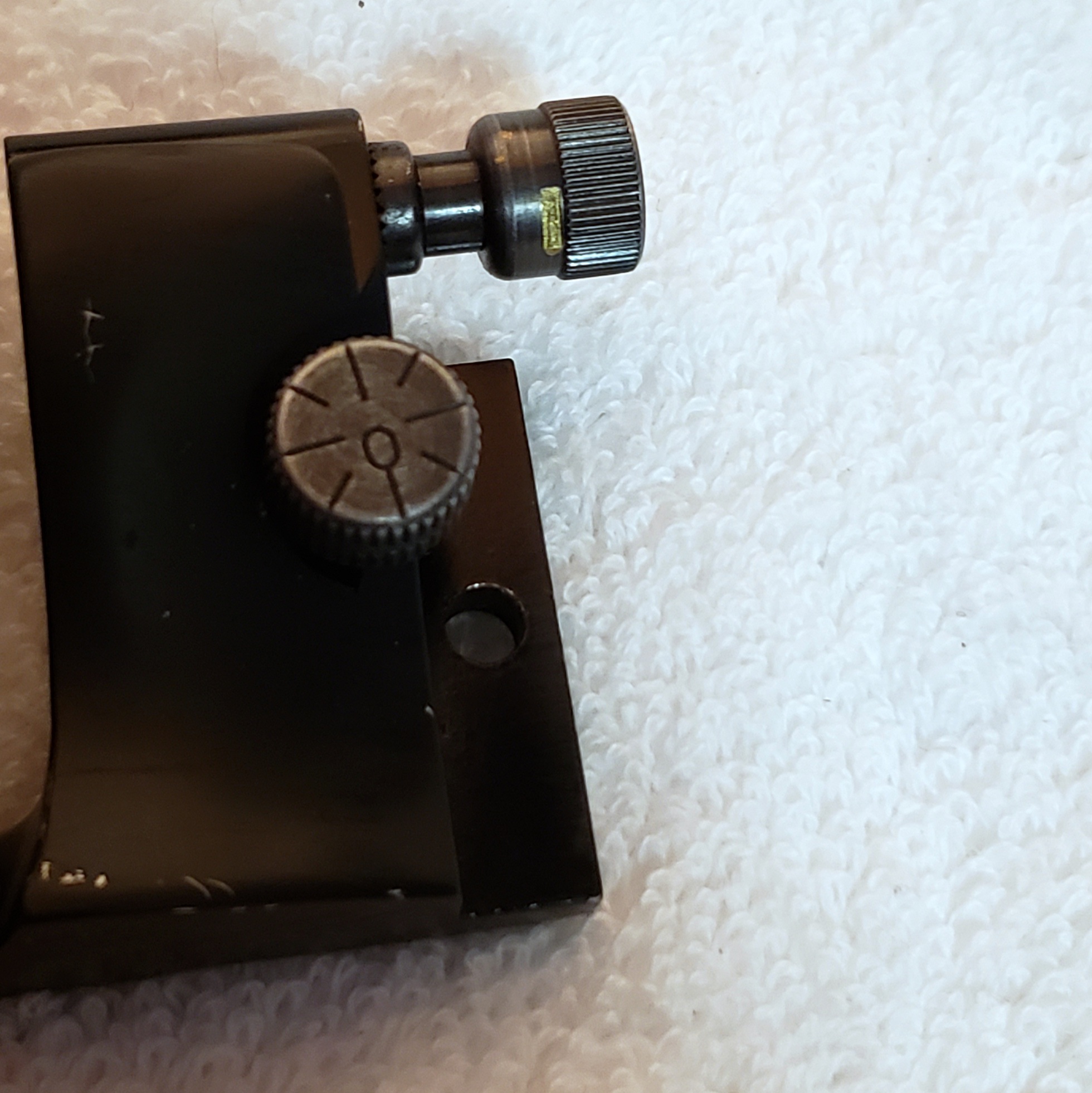

Those of you who own one of the Tomenosuke blasters know that they include a slotted screw to swap out with the Weaver knob, and that's just what I did.

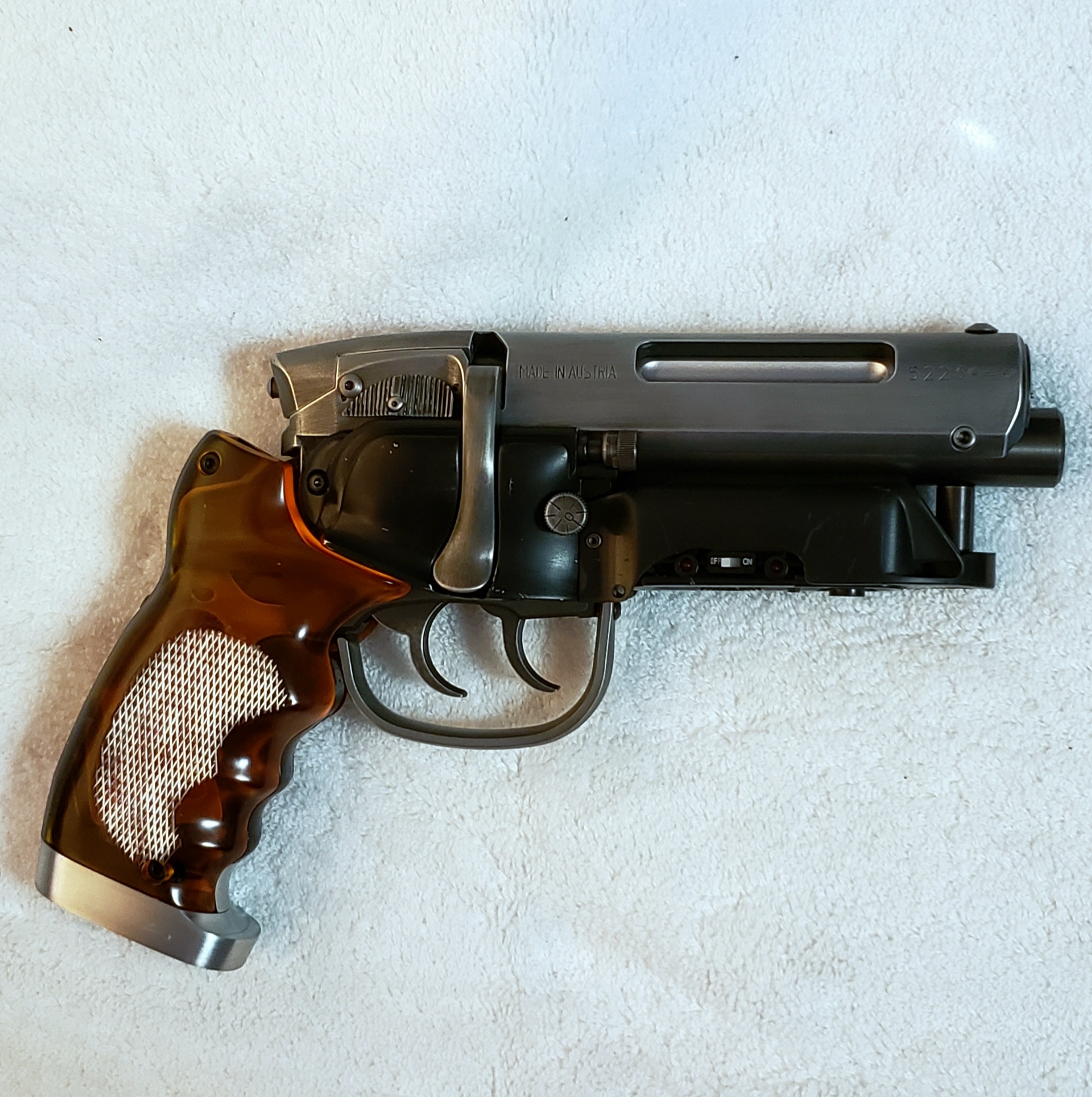

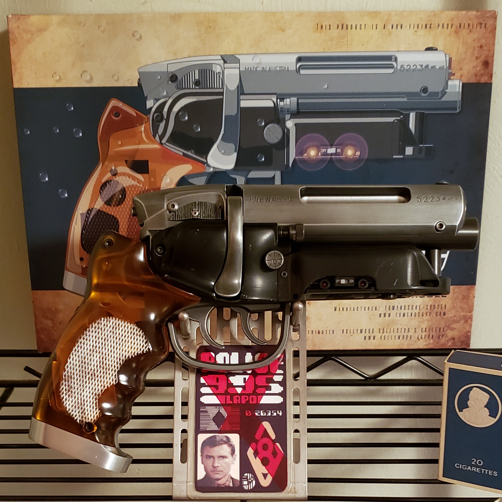

As I mentioned yesterday, the conversion on my OG is finished! (Except for the grips, which should be here by the middle of next week.)
Here are a couple of overall shots to start things off.

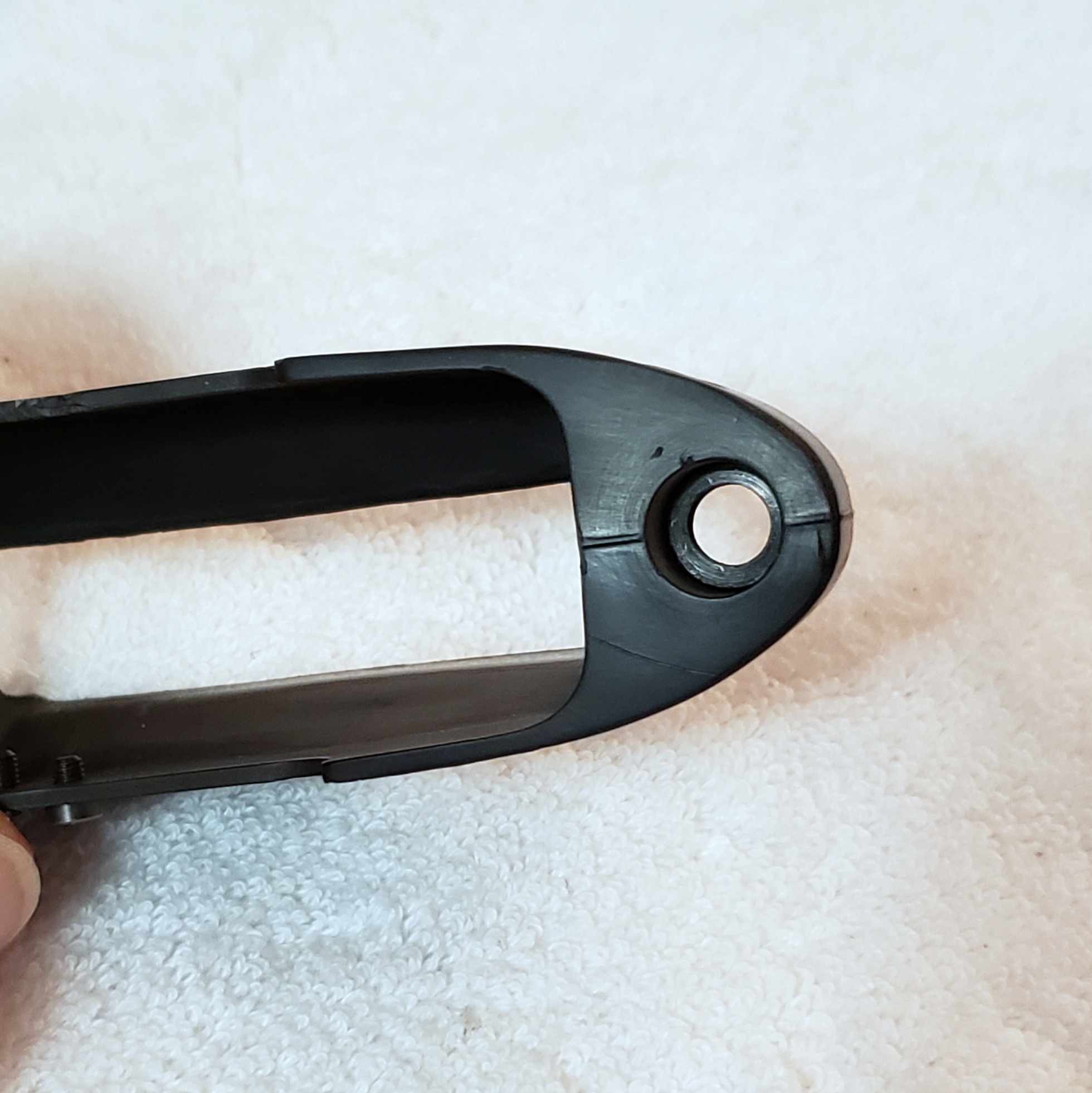

On the Steyr upper and the trigger guard, I soaked the parts in white vinegar and then used steel wool to remove the factory finish. I probably soaked them for a total of around 4 1/2 hours, doing 2 or 3 rounds of scrubbing. I disassembled the parts before soaking.
I bought a bottle of Novacan liquid, which I had read about in another Tomenosuke thread, and applied it to all the parts, after I had cleaned them with acetone. After applying the Novacan and rinsing the parts, I lightly went over them with steel wool to even out the finish.
