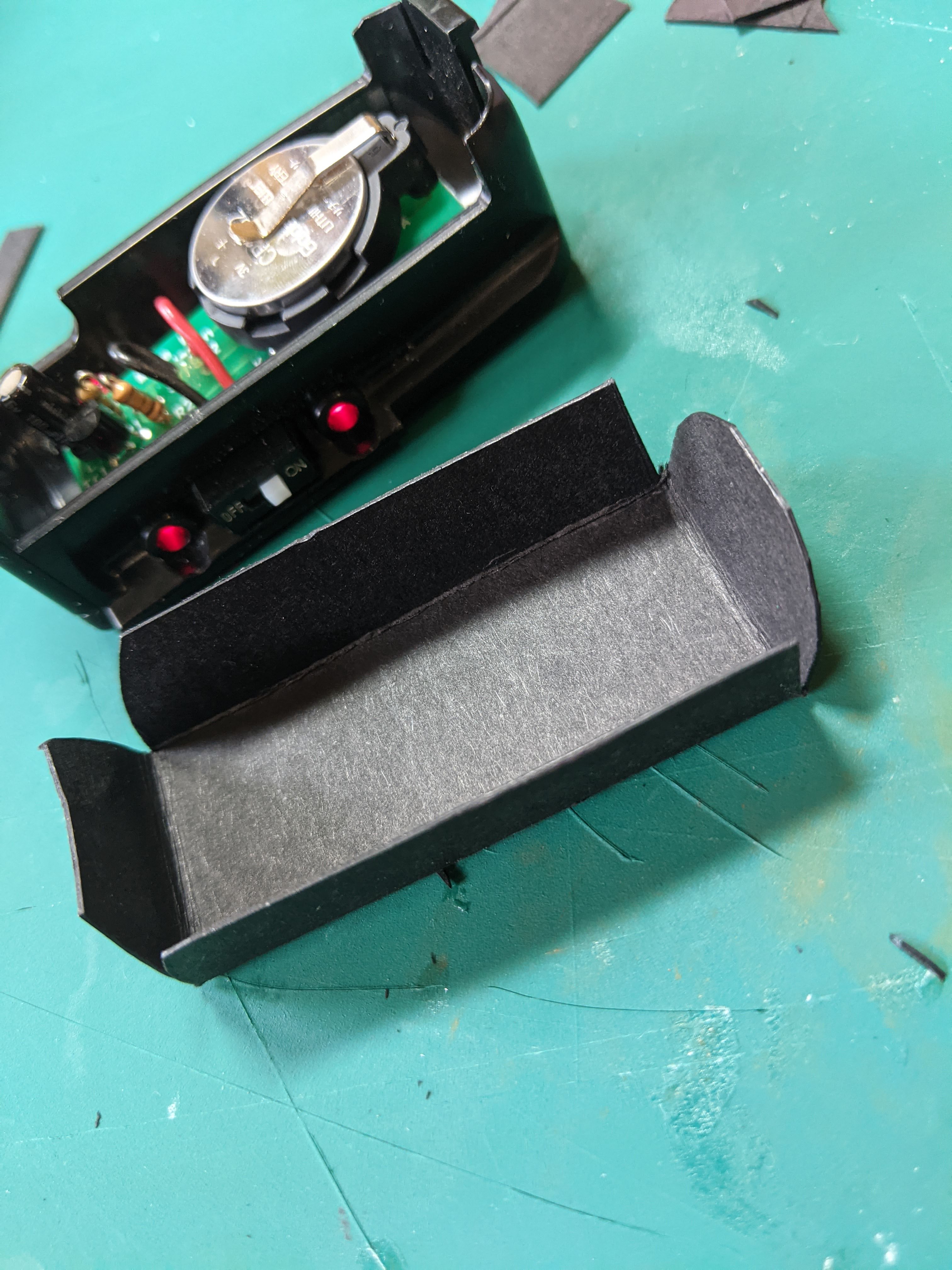

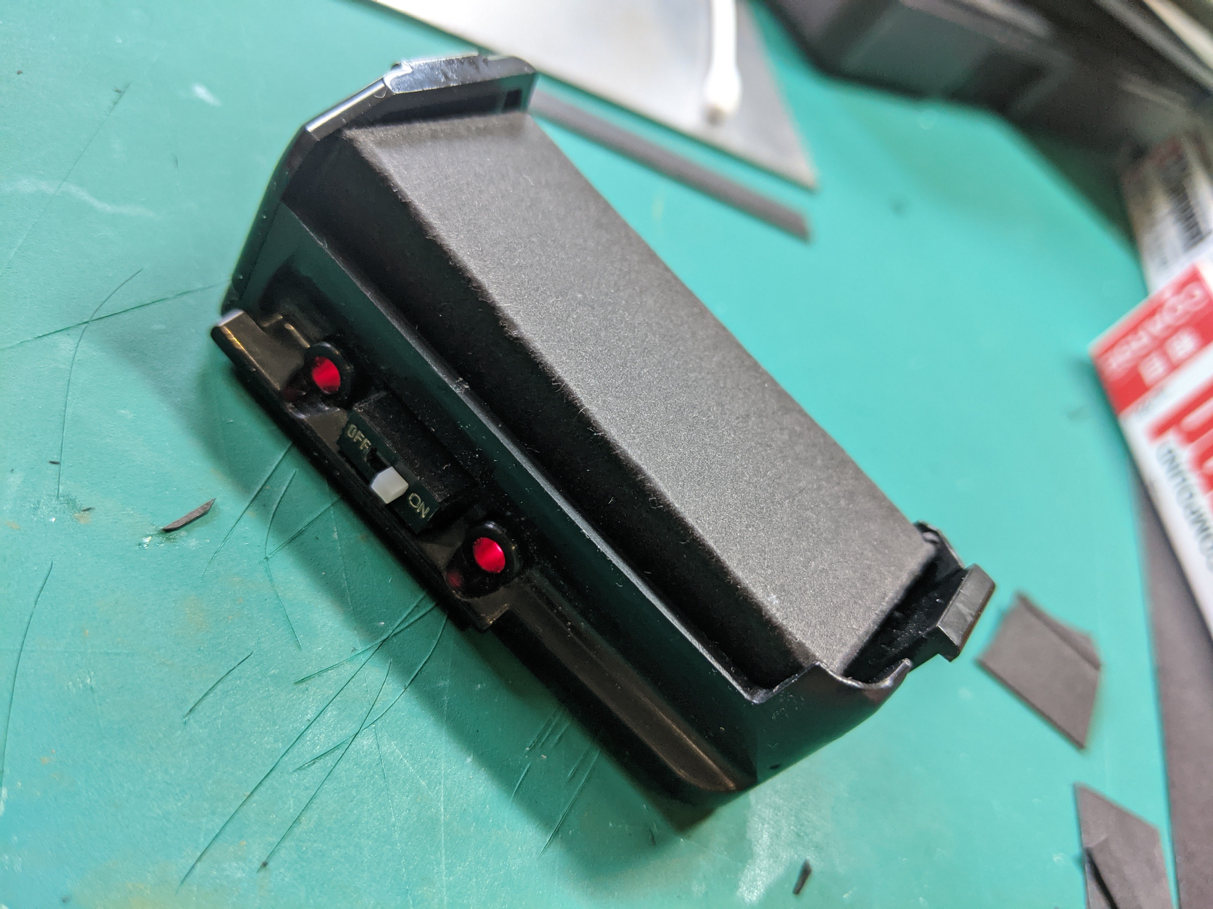

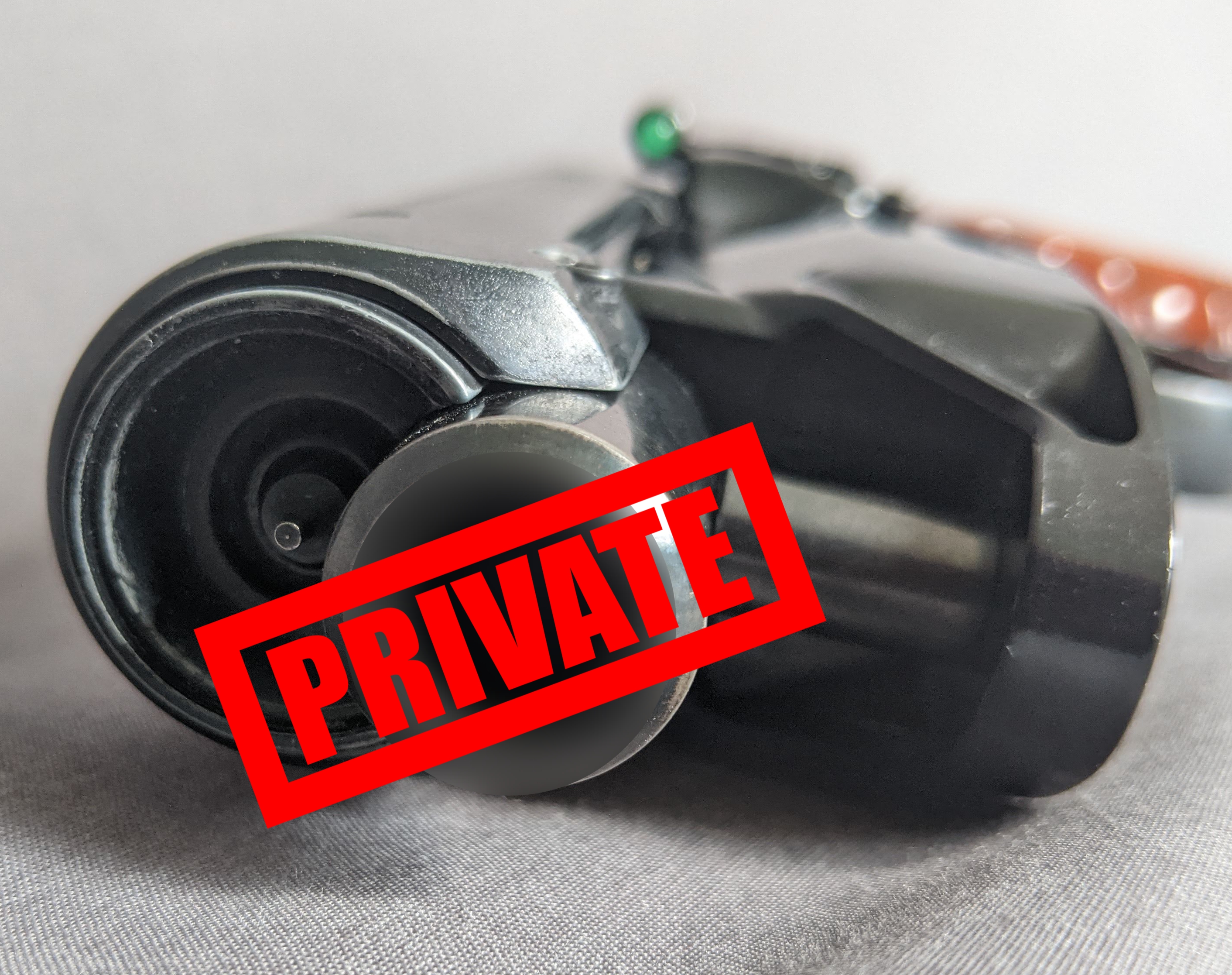

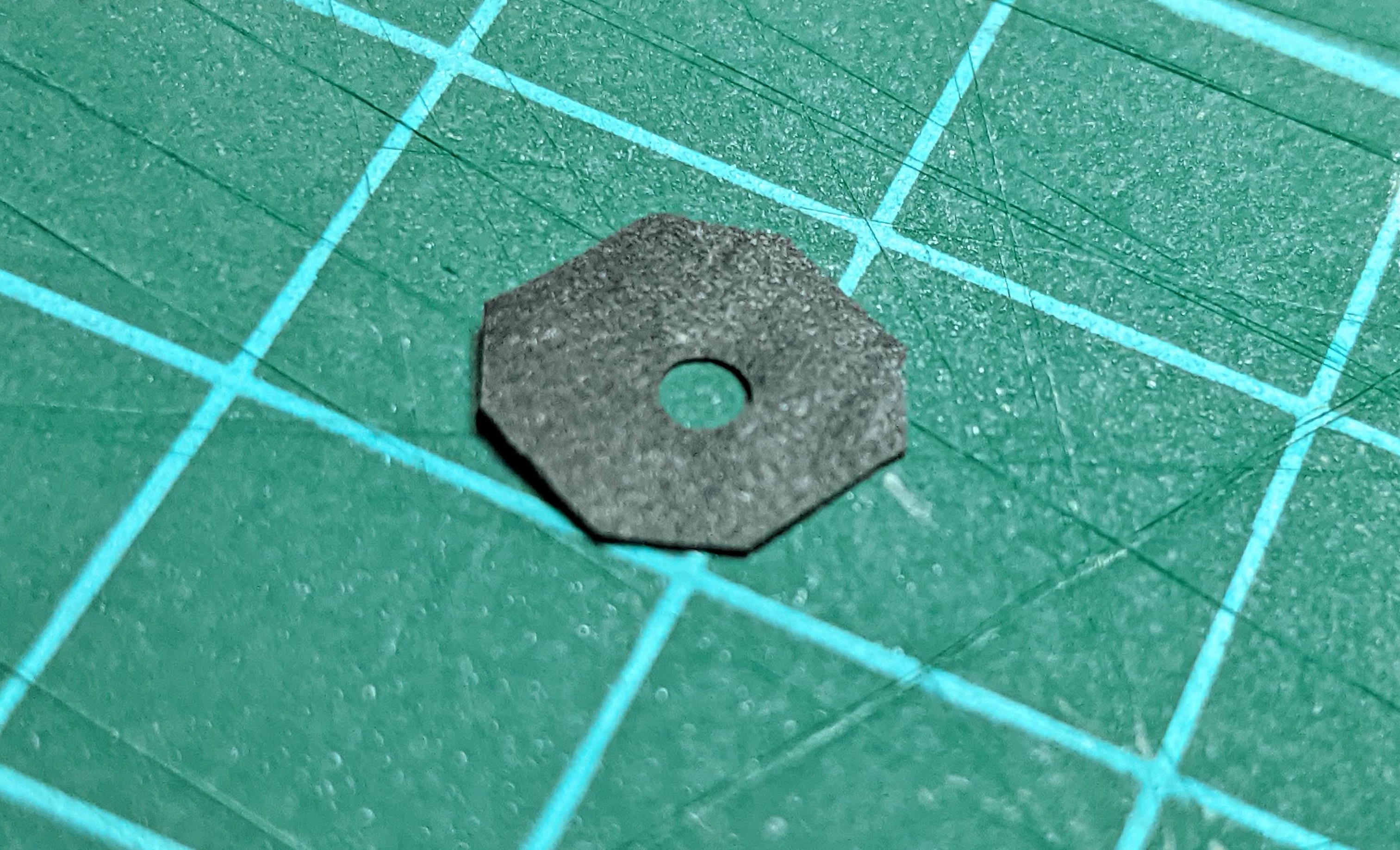

Here's another couple of changes I made to the magazine housing.
I found that the back side of the LEDs were visible through a thin gap between the barrel and mag housing on the right hand side of the blaster.
There'd be lots of ways to sort this but I just used what I had to hand at the time, which was a bit of black card.
I just cut a sort of lid out of the card that slots down around the circuit.
Tomenosuke Blade Runner Blaster - Magazine mod light blocking - Akwalek RPF

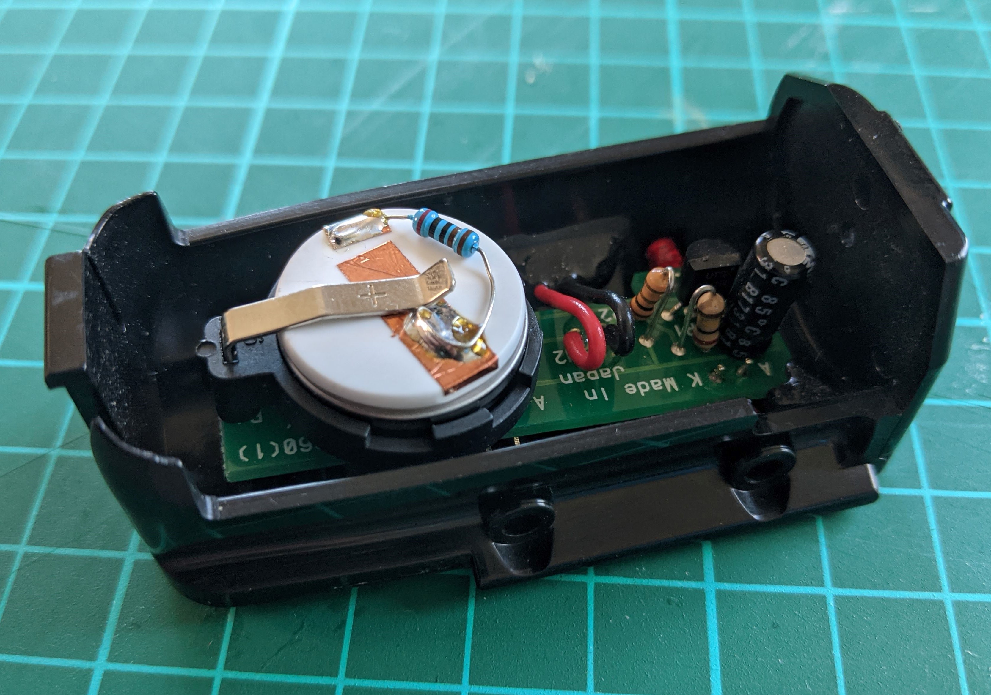

Okay, this next one, I'm open to admitting it might be a little overly fussy...
...I think the LEDs burn too bright. Maybe even twice as bright ;)
I love what Tomenosuke have done with the warm up of the lights when switched on but for me they never look super bright on screen.
To sort this out to my liking I tried a few different ratings of resistor between the battery and the + terminal. 2k seemed about right so I cut a 20mm disk of 2mm thick acrylic, put a strip of 5mm copper tape onto the bottom and wrapped around to the top. Then I cut a gap in the tape and soldered the resistor between them. The result is pictured below.

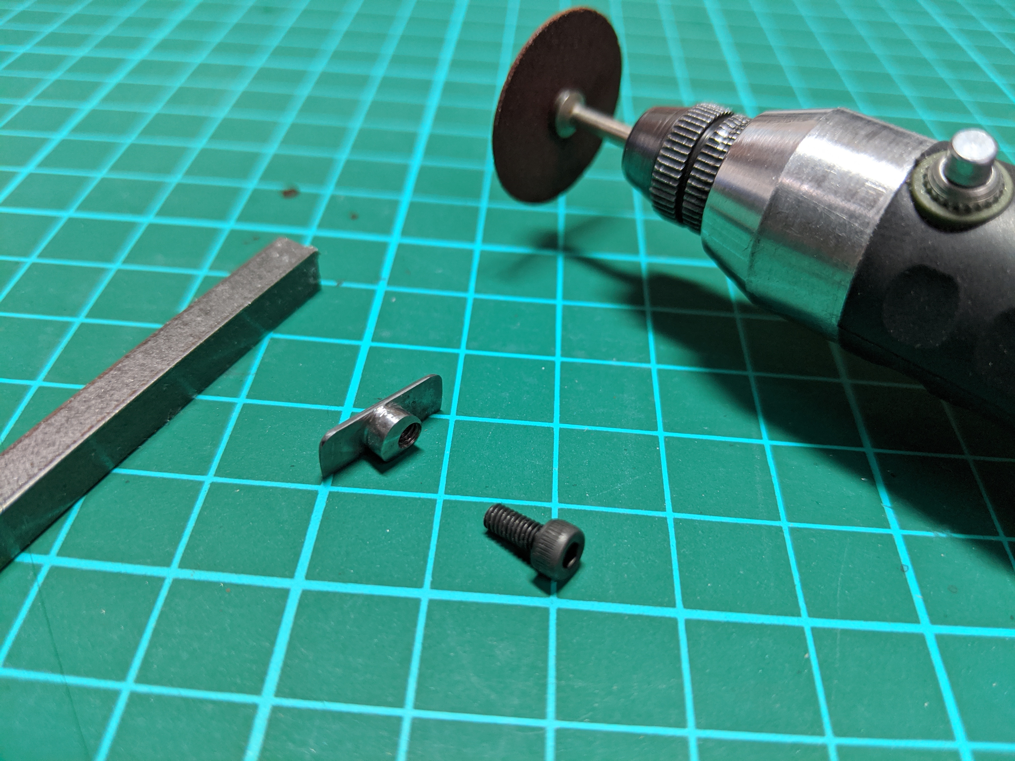

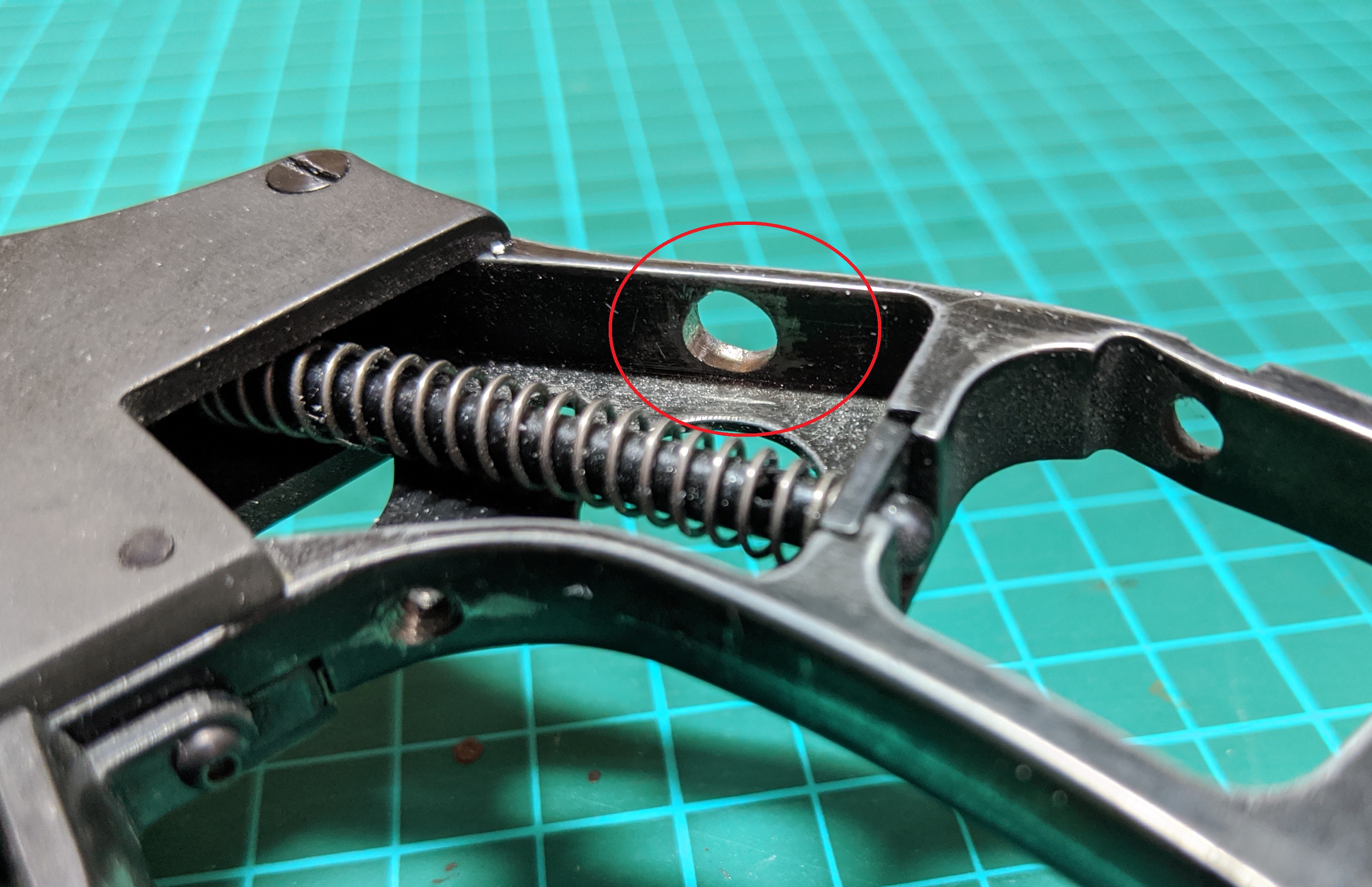

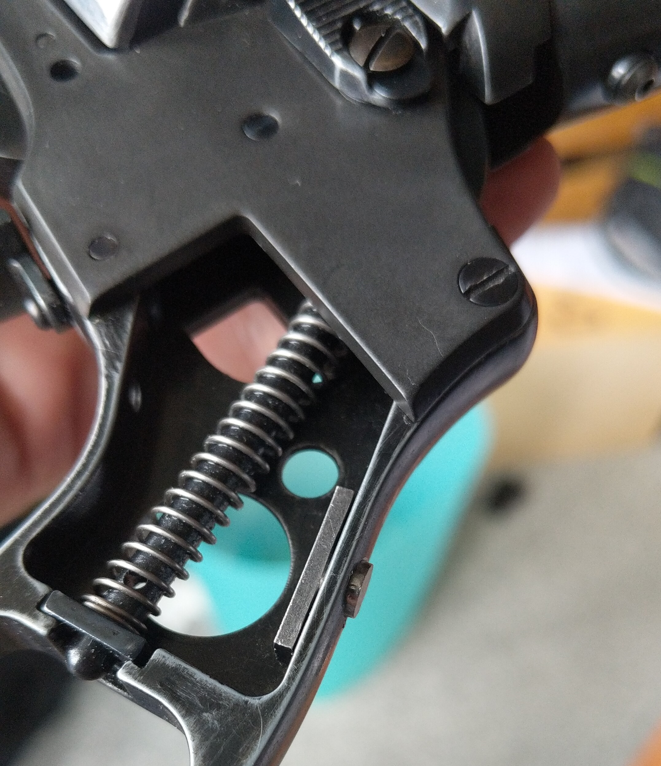

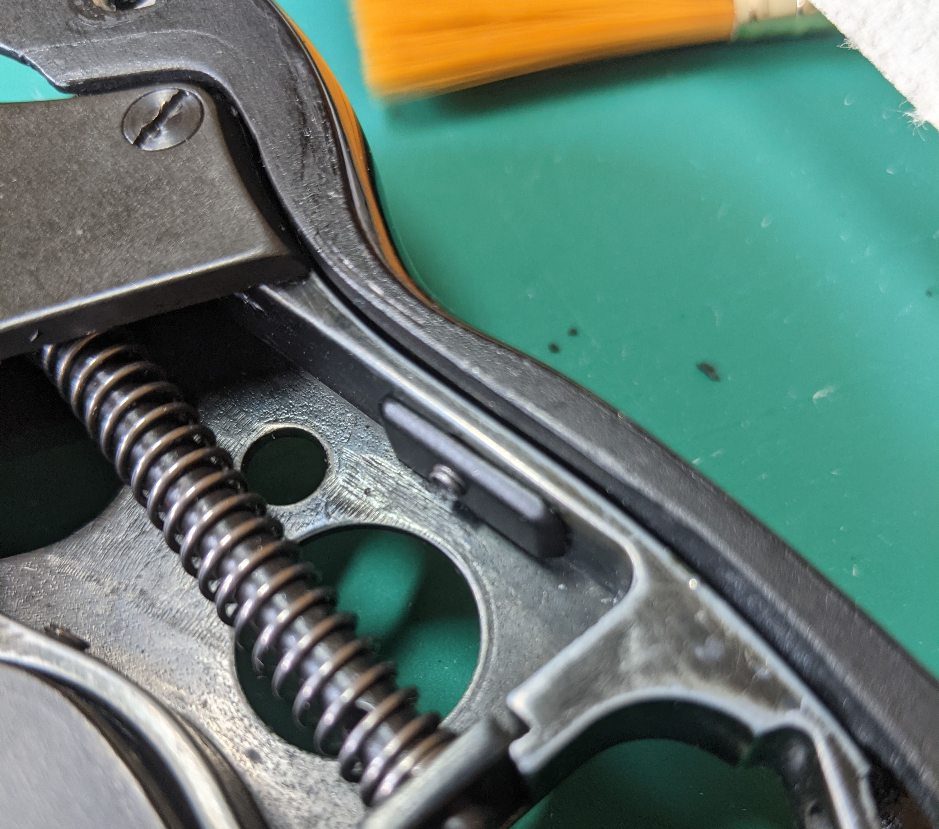

So the next mod was unfortunately needed to fix an issue that I created rather than a problem with the Tomenosuke.
I stripped the thread for the small 8/32 [EDIT - 4/40 not 8/32] screw that goes into the back of the grip frame to hold the inner and outer frames together. The one just above the large hole on the back strap of the frame.
My first thought was just to re-tap for a larger thread but it can't really accommodate a larger screw. So I ended up creating a sort of bracket on the inside of the grip frame, tapped to take the 4/40, that would pull the outer frame against the inner frame.
First step was to drill out the stripped thread. I went for a hole about 5mm diameter.
Next I formed the bracket from 5mm square mild steel bar using my handheld rotary tool and a grinding disk. It was finished up with hand files, then drilled and tapped for the 4/40 screw. The second image shows a test fit of the piece.
View attachment 1556790 View attachment 1556801
Below is the finished piece installed. I painted it black so it is not visible through the amber grips. It works great and is much less likely to fail than the threads that were in the relatively soft metal of the bulldog grip frame.
this happened to mine as well, I couldn't think of a good way to solve this issue until I saw this. Thank you!

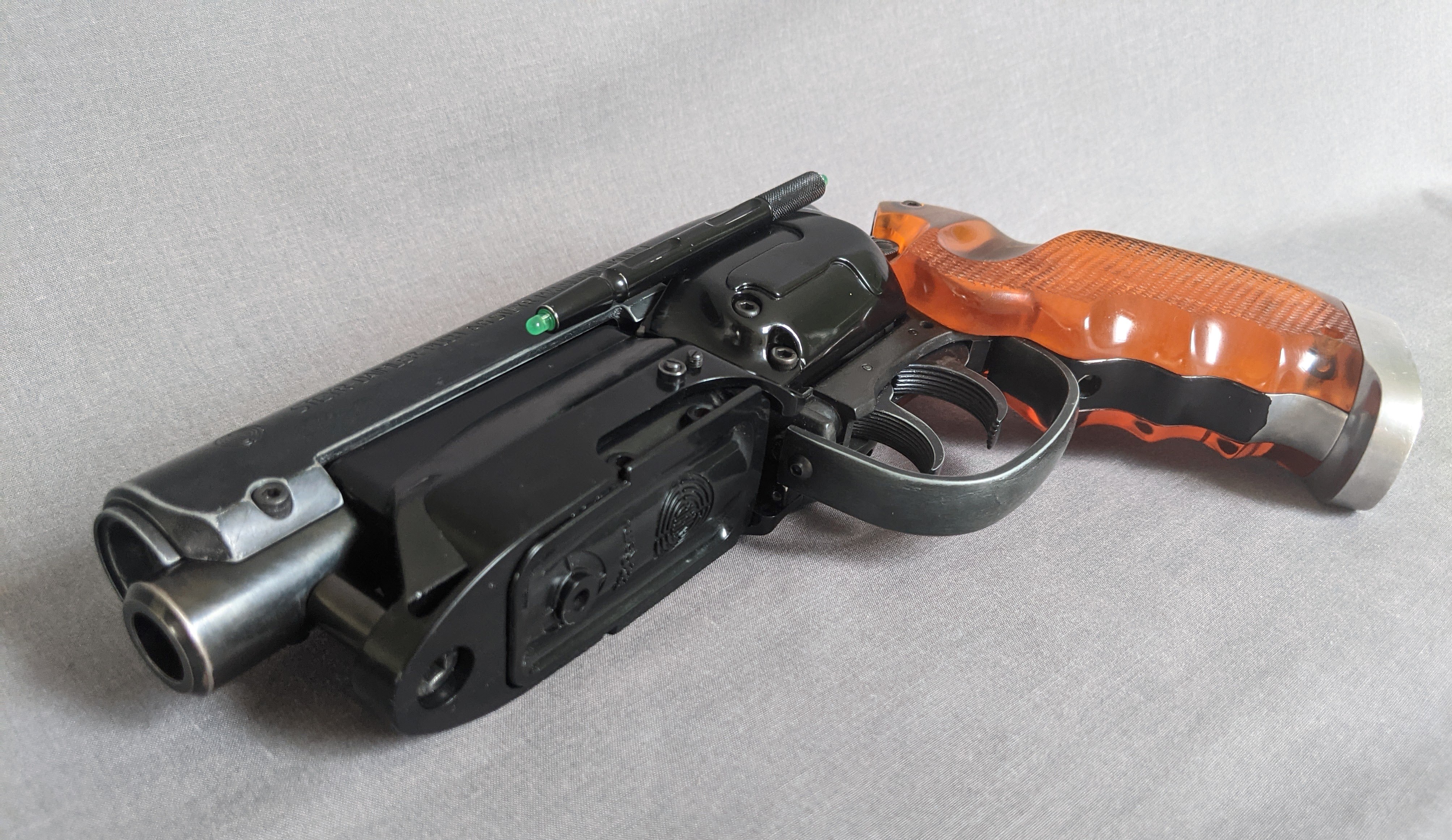

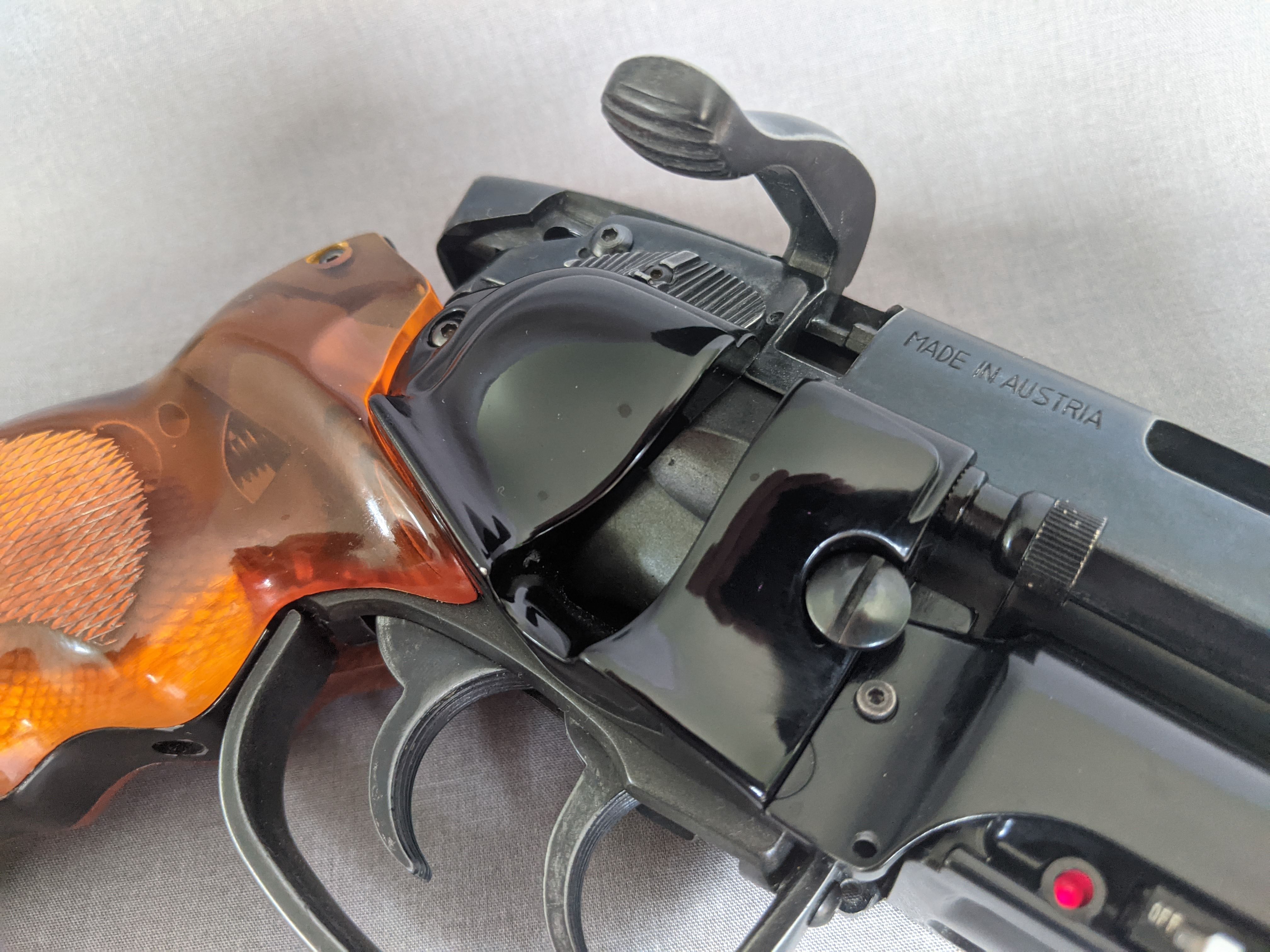

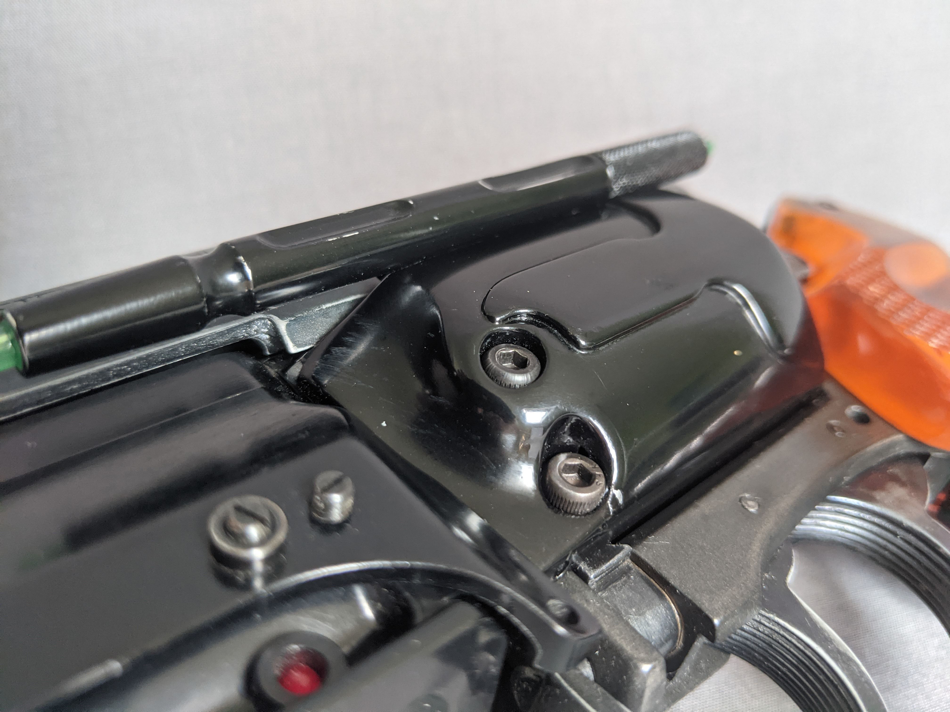

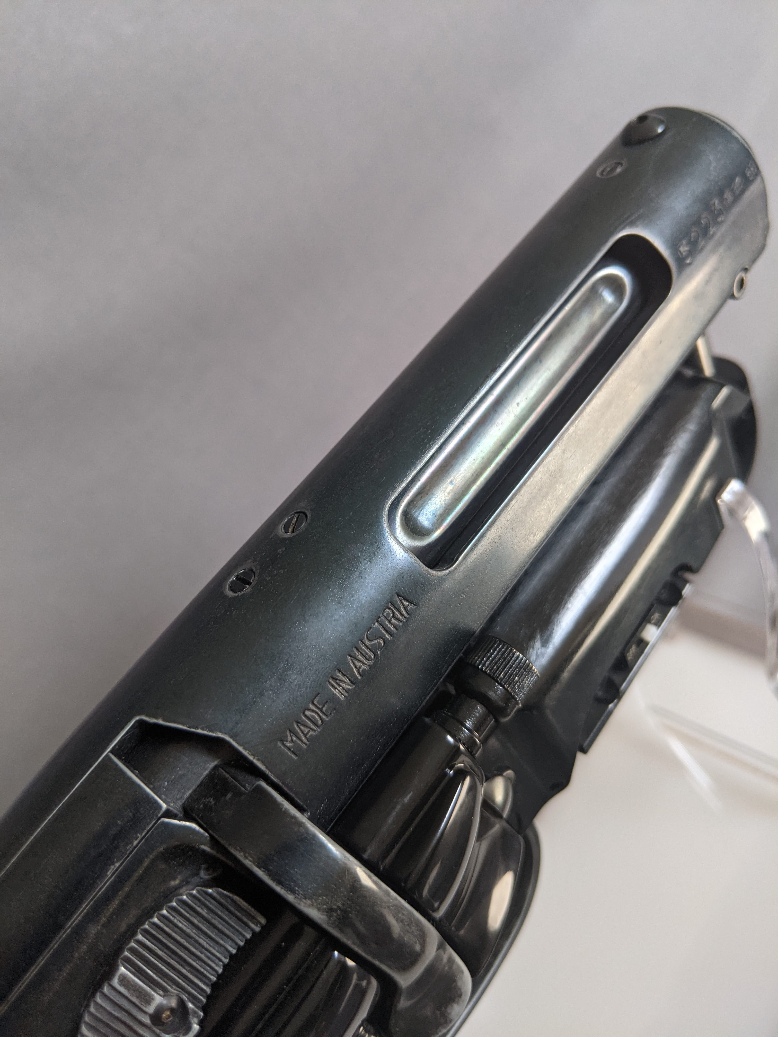

Another issue with the Tomenosuke Blaster's is a loose bolt handle.
I say issue but I know that the real prop has a loose bolt so potentially this is intentional. Anyway, it's not really a feature that I wanted to replicate.
I'm pretty sure that the changes I made are common mods but I'll detail them here anyway.

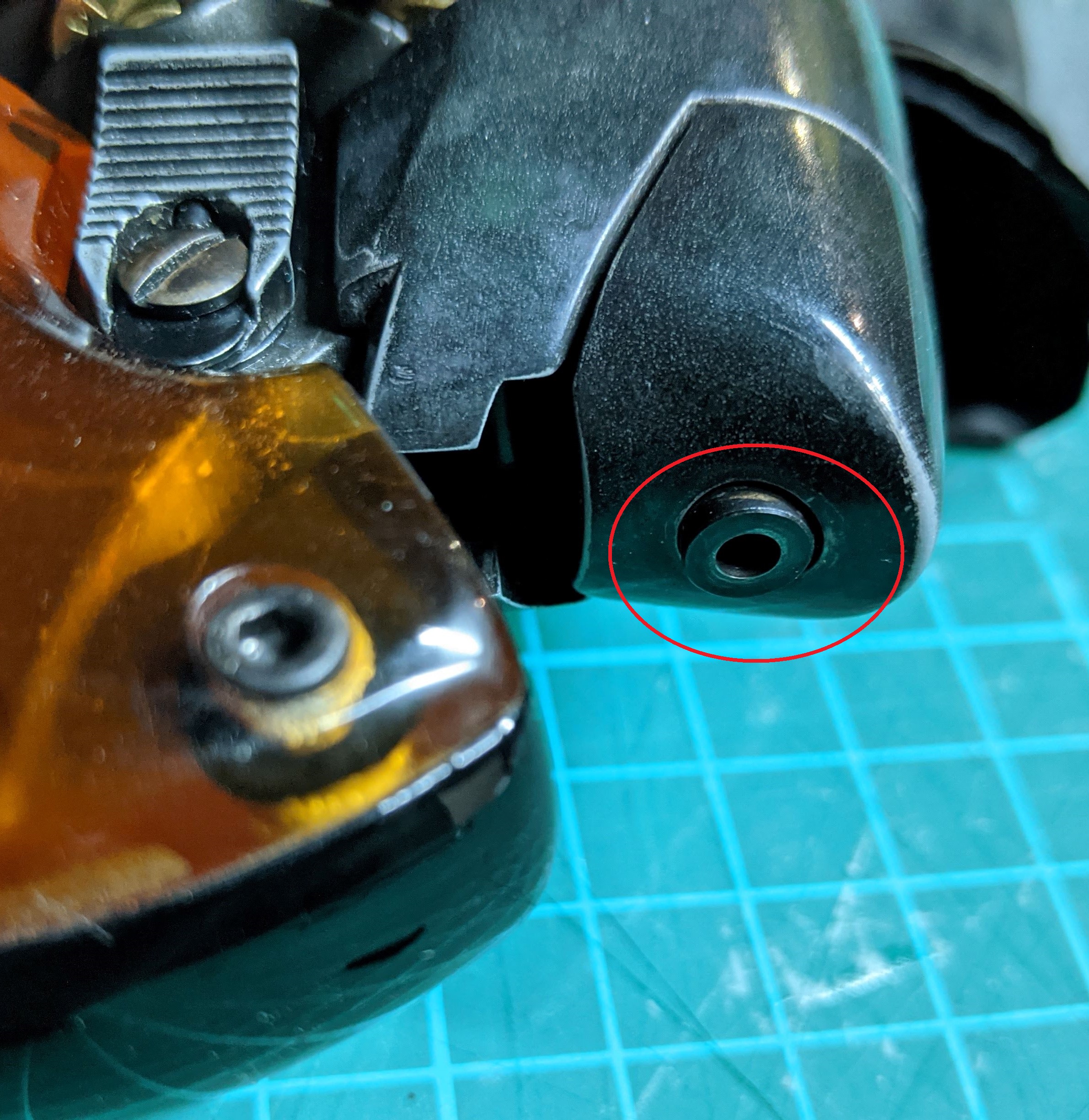

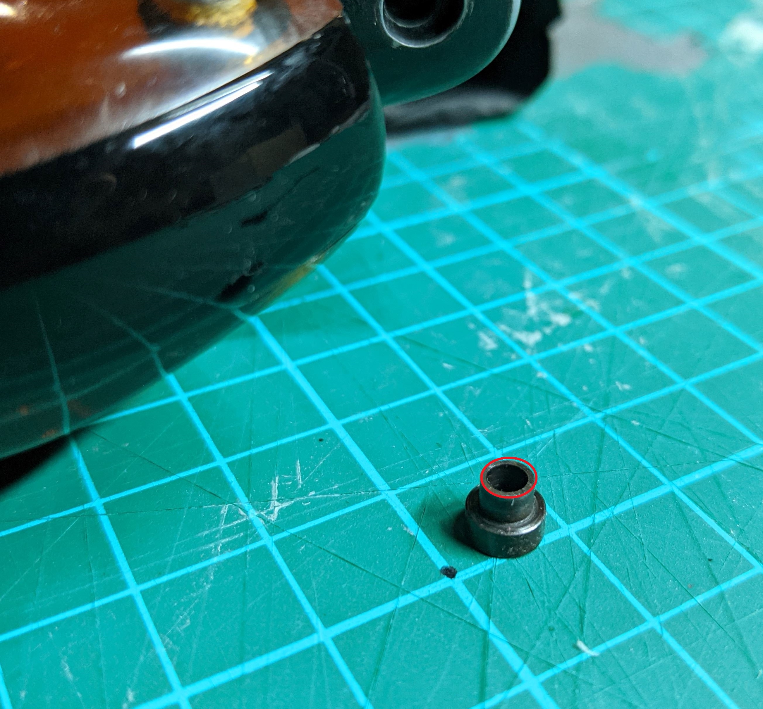

First up is to shave a little off the stepped bushing at the back end of the bolt assembly. It's circled in the image below.

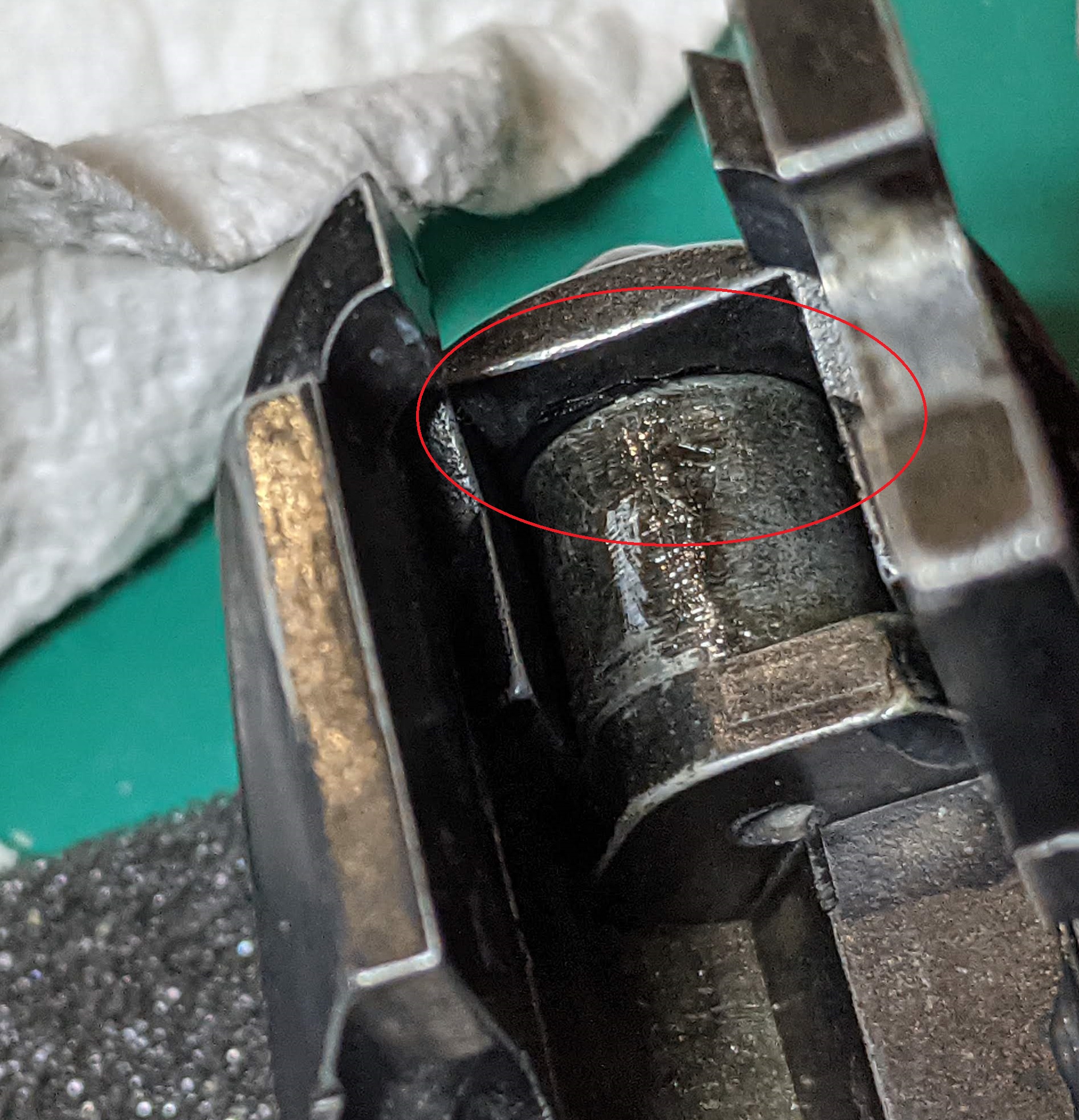

I filed a little off the inner face of this (circled in red below) which results in everything this end fitting a bit tighter. You've got to be careful though as too much off will have the opposite effect.
It was still a little loose for me so to add bit of extra friction I cut little spacers out of an old black nitrile glove. This material is great for this sort of task as it's super thin so doesn't cause fit issues.
A couple of these were then put between the back part of the Steyr receiver and the bolt end where the bushing screw comes through. You can just about make them out in the image below. This is the back end of the Steyr receiver assembly viewed from below.

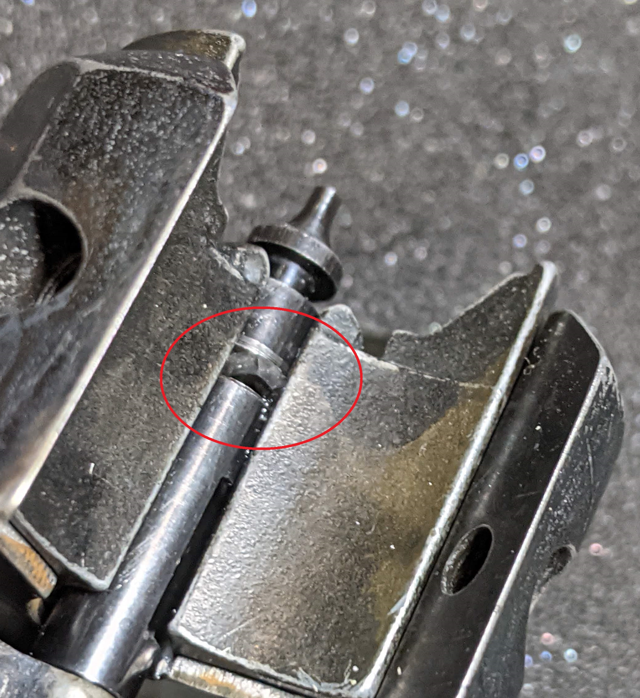

As well as this I made an alteration at the front end to the pin that protrudes through the front cap of the receiver assembly.
I saw someone else do this on this or another forum, so if that was you then thanks for sharing.
First up I mounted the pin by the threaded end into the chuck of my rotary tool. I then spun the pin whilst holding a file against it to cut a channel into its shaft. Next I made a rubber O ring from a piece of old bicycle inner tube and slid it down into the channel.
It just needs to be slightly wider than the pin so it has a bit of grip in the hole it rides through in the front cap.
These mods combined result in a really smooth action for the bolt assembly and most importantly, everything stays put when the bolt handle is closed up!

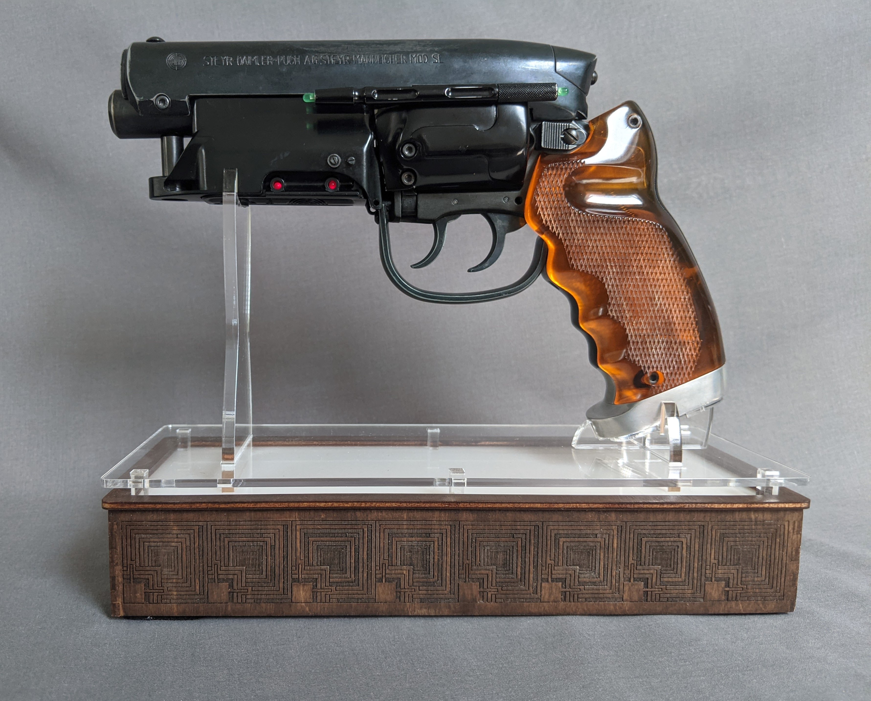

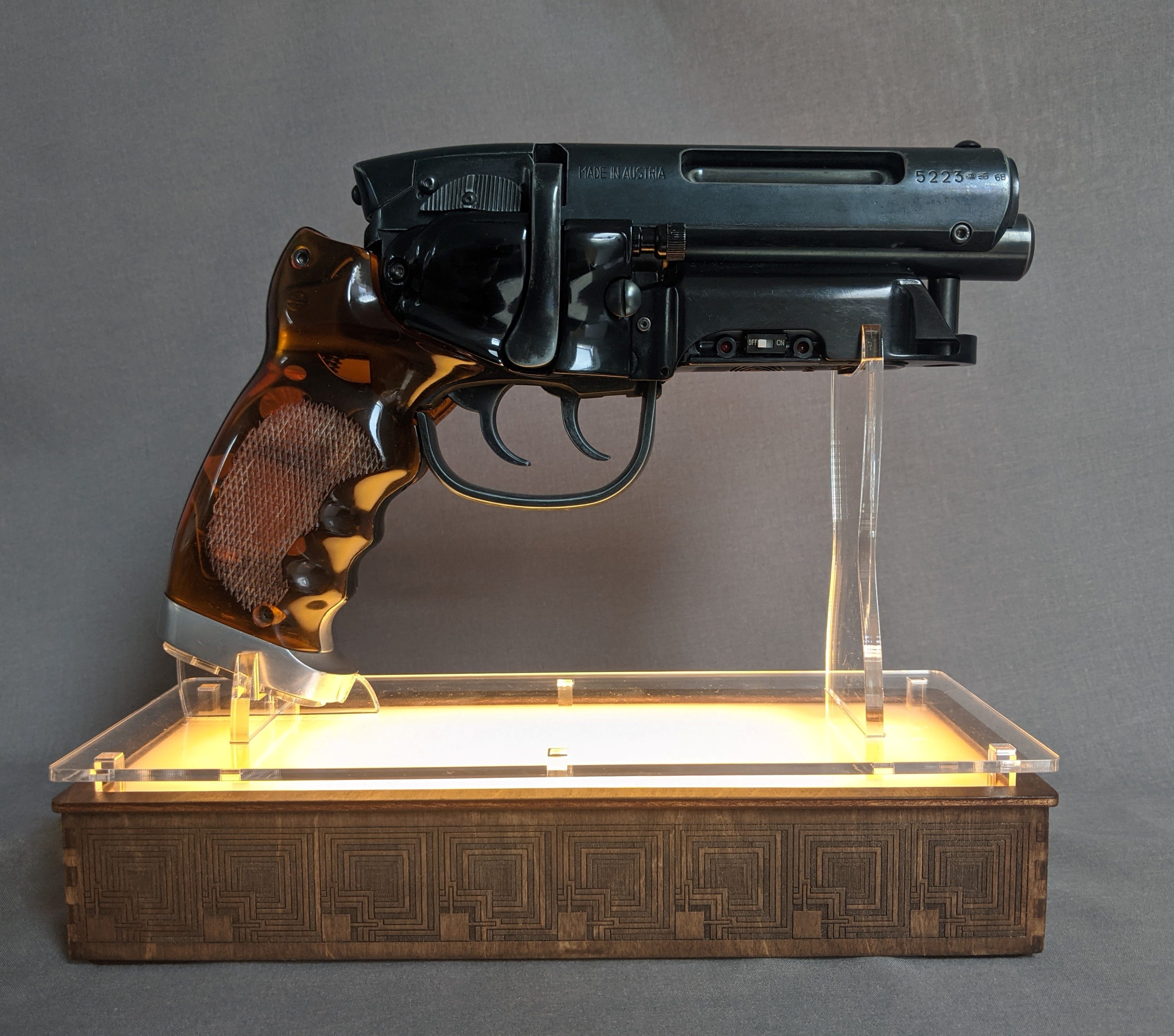

Akwalek

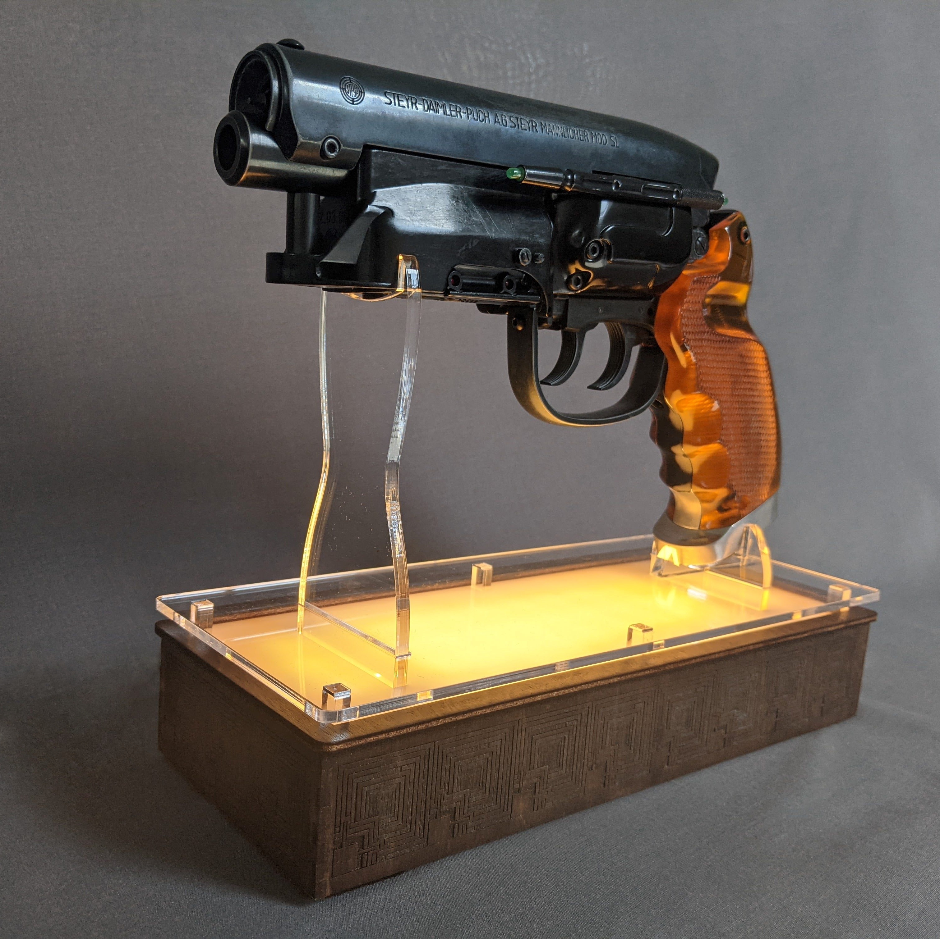

For the last couple of months I've been meaning to take some nice pics of the completed blaster to share with you guys.
Well when I say completed, I mean I've not messed about with it for a sustained period of time!
So here you go....
Tomenosuke Blade Runner Blaster Custom Stand - Akwalek RPF

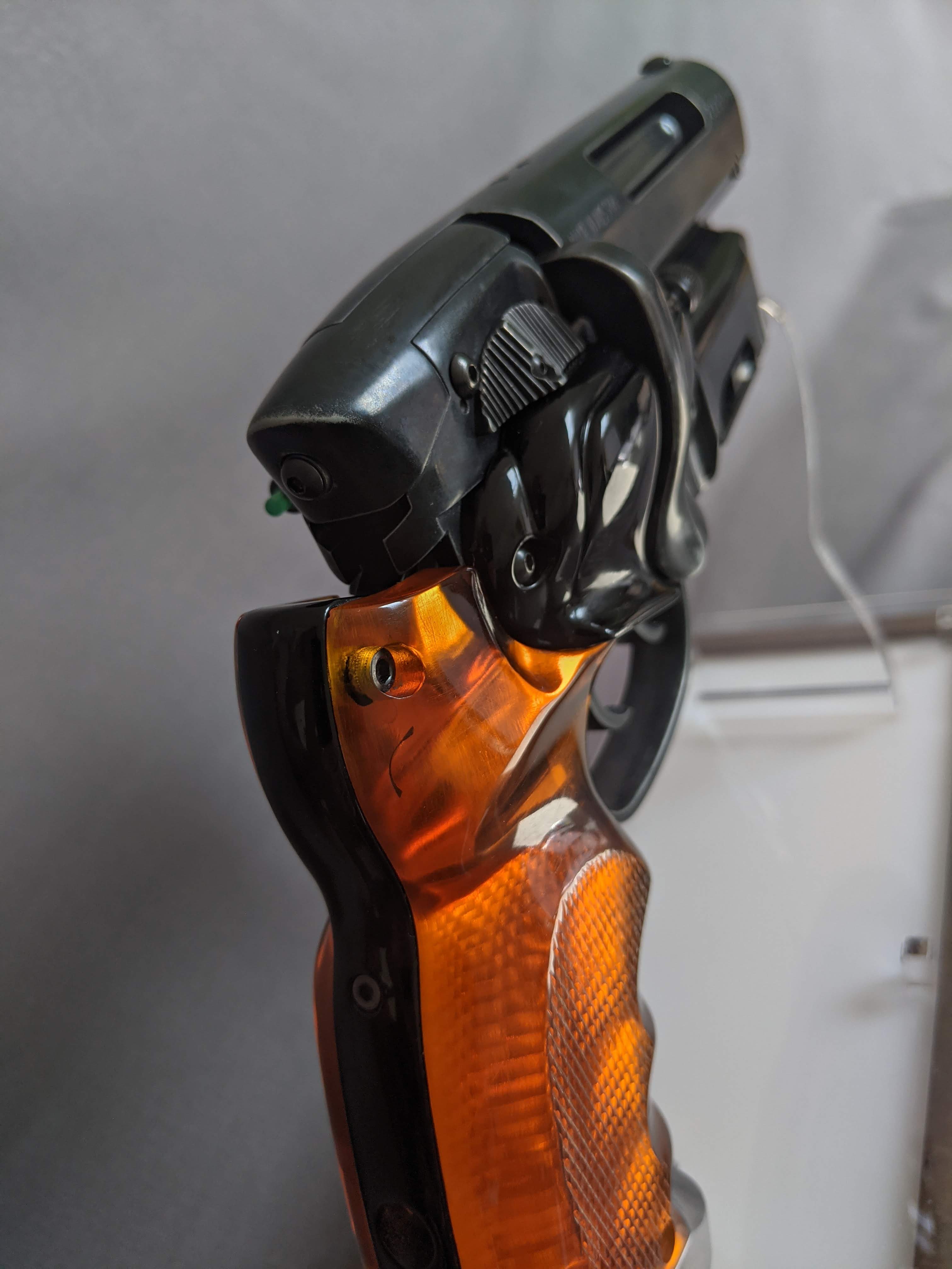

Tomenosuke Blade Runner Blaster - Akwalek RPF
This one really reminds me of a Rick Ross PKD promo shot.
Plus one for laughs, if just one person gets this it will have been worth it! ;)
Akwalek
Congrats on the awesome result! your blaster looks amazing :)
Thanks so much eethan!
Amazing journey and results :cool: :cool: (y) (y)
Cheers joberg, It's only taken 27 odd years to finally realise that dream of holding a Blaster that feels just right!
Lovely blaster and I really like that stand too.
Thanks so much mrwax. I'm really please with how it came together.
With regards to the stand, I'm currently putting together a Project Run post to offer them for sale. I already have a few made, just working on the packaging.

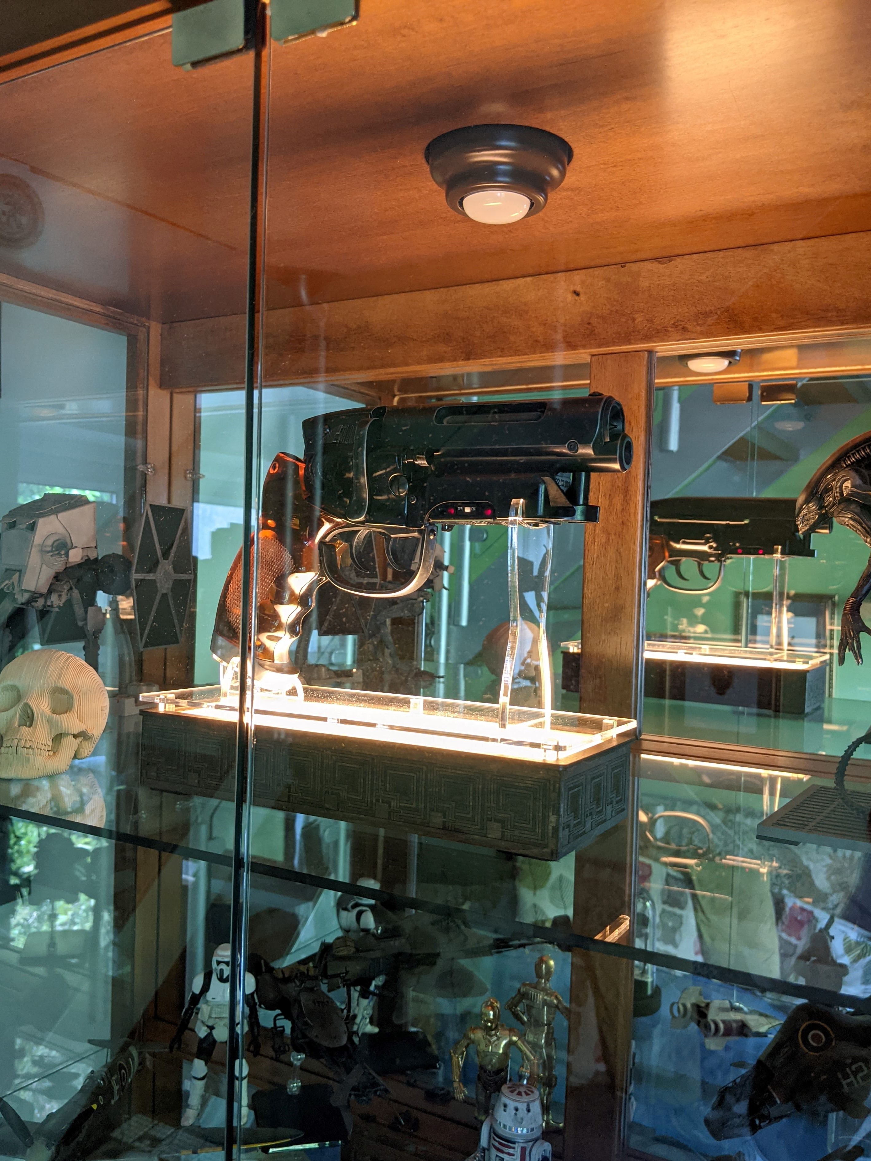

Here's another pic of the Blaster displayed in my Cabinet of Awesome!
I really need to dust those doors.
Neon Nautilus' Blade Runner Blaster Display Stand
