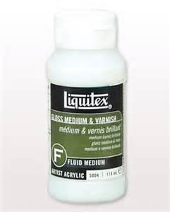

Okay, thanks. I've read on here of people using that. How does it compare to Perma wet? I'm assuming it's not susceptible to freezing .
its an acrylic sealer ..a little thinner then permawet ..you can also order something called V-gloss ..its basically the same stuff. if you are looking to seal the paint ..get a shiny look on it ..Gloss Medium will work just fine ..apply thin layers ..and if you need to speed up the drying ..just use a hair dryer
Is this what you're talking about?
