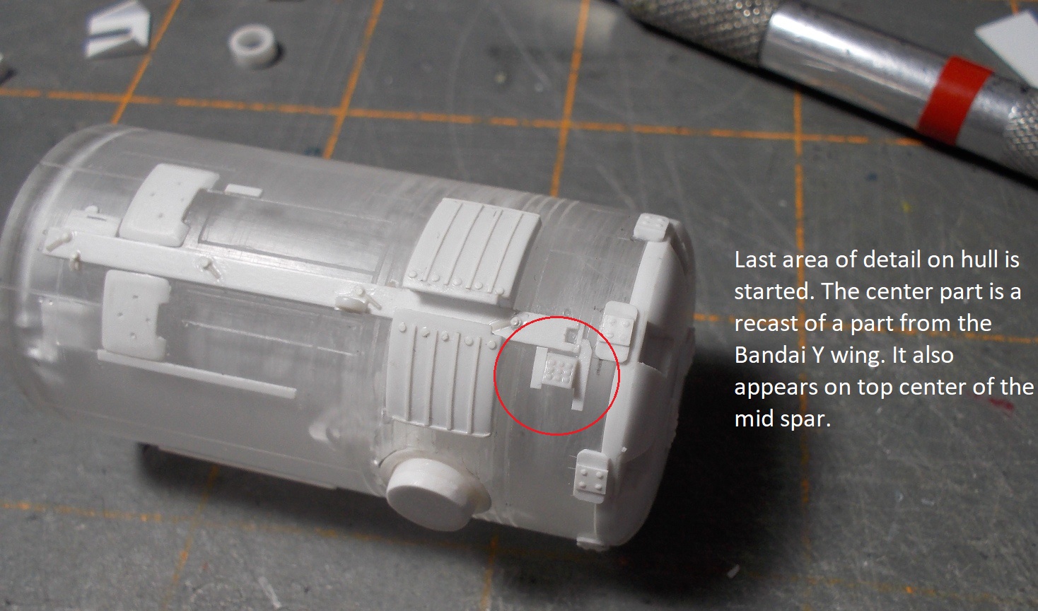

Minor updates on a Thursday night. What, weeknight modeling? I guess it was always theoretically possible...until now.
Attempt #3 on the missile guides is satisfactory and I'm starting to work on the final underbelly detail and the many semi-circular curved parts that go astern of the chair back/Band-Aid pieces around the fuselage.
Cheers all!
K.

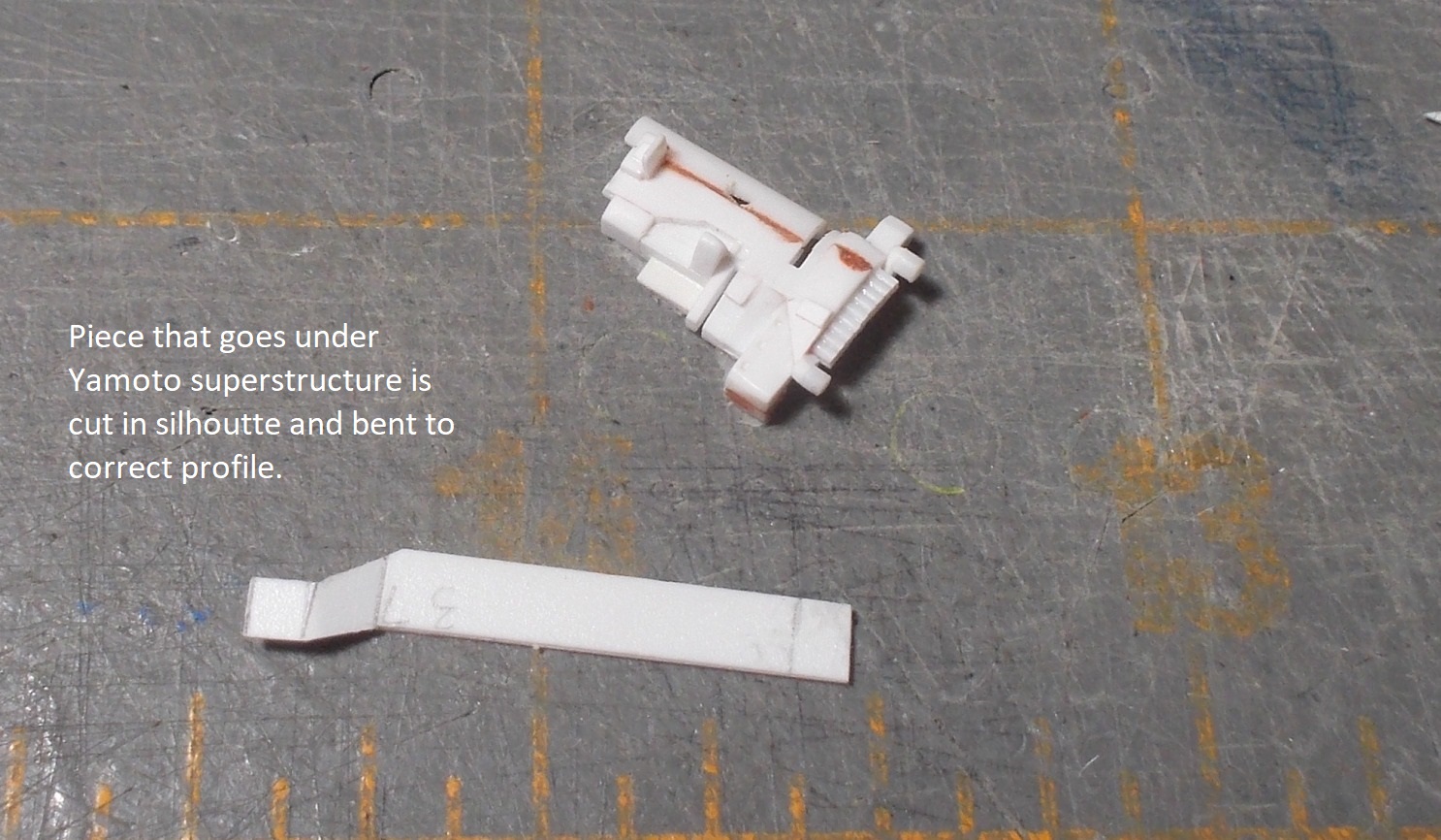

The Yamato superstructure piece that goes on the underside of the weapons fuselage has a funny part from a German 20 mm flak gun sticking out. Darth Daniel took a bunch of excellent photos of his studio parts that allowed me to precisely figure out all the details of these components. I'd been procrastinating on the last part that sticks out from underneath for some reason and finally did it tonight. (Though I drew my scale drawings of the part last night) It was perhaps the easiest part of the whole build to date. I guess it's the little things in life! It took perhaps 10 minutes, including taking the pictures.

Meanwhile, a few more pics showing that last little bit I just did this evening.
Cheers and thanks for looking.
K.

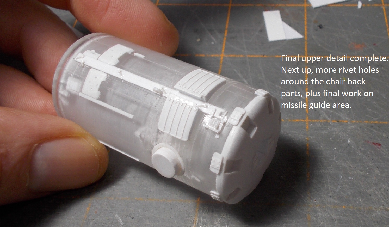

It's 10 a.m. Saturday here and I've been tinkering for a little bit. Nothing major, but still progress. I've got the remaining seat bottom parts for the circumference of the weapons fuselage dialed in and an acceptable prototype made. Now I just need to make 7 more, plus the 2 that go in the slot on each of the missile guide parts. Those last 2 have more of round arc than the ones on the sides.
I also took some time to modify the part I built last night. Thinking ahead to my assembly procedure when I actually build the thing, I decided I wanted to be able to put it on first, so I came up with a locating pin for ensuring accuracy. The pictures will explain it better I hope.
K.

Another minor update for this morning. I've finished all 8 of the arc sections that connect to the seat back parts around the circumference of the weapons fuselage. I test installed them with white glue to check for clashes, but also because I was excited to see how they looked. I'm pretty stoked with the result. Now that I think of it, there are also a few drilled rivets that go in the vicinity of the arcs that will be better located with those parts in place. Good....gooood.
I did observe a few clashes too, but checking ILM references shows they had the same ones, so I'm happy with that too.
I white glued the missile guides back in place again so that they will be there for test fitting against the remaining arc pieces that go through them. That and a few other minor details on the upper hull, plus a rebuild of the bomb chute and it's rubber time.
I'm off to town meanwhile to run errands and maybe find some Microweld. Hopefully I'll get back at it tonight.
Thanks for looking as always.
Cheers,
K.
