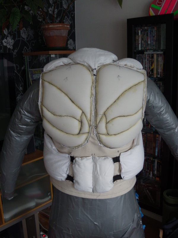

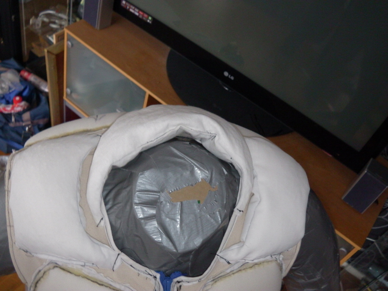

Added a few pieces to the muscle suit today.
Made a little video on how it looks , My shirts are now too small to fit my body. Looks like the Hulk is going to burst through.
