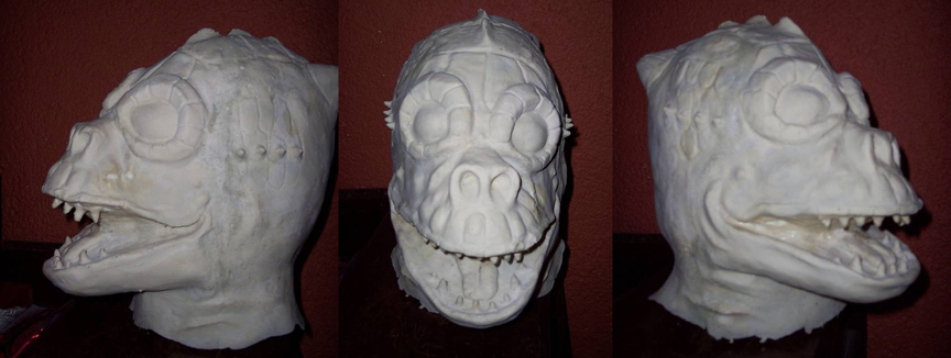

Here is a pic of it before painting:
The mouth hung open too much, but with adding fabric soaked strips of latex I was able to bring it up more. I did thickened a the front and mouth and let that dry. I can really feel the difference already. But boy...I'm going to have to find an old long sleeve shirt! I had latex in my arm hair and OUCH! I ended up just cutting it off with scissors!
