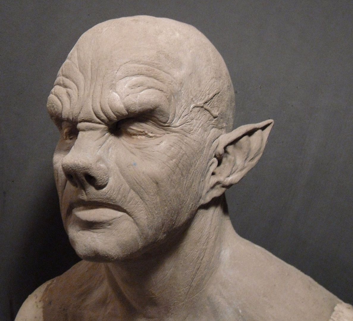

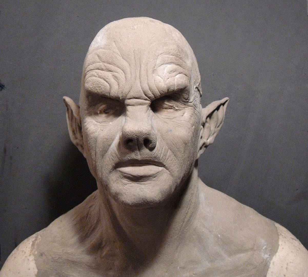

so it was not like i had enough to do i decided i wanted a wolfman costume based on the one in the 2011 film. the movie rocked!! this will take awhile....
i have the head,teeth and digilegs started.
i have to make a body cast for the torso sculpt.
here is the head sculpt. i am almost done with it. it will be pulled from ecoflex as one piece. then trimmed,seamed, painted. then i have to punch a ton of hair. the mask will be glued down so the i can wear dentures that protrude outward from the bottom jaw.

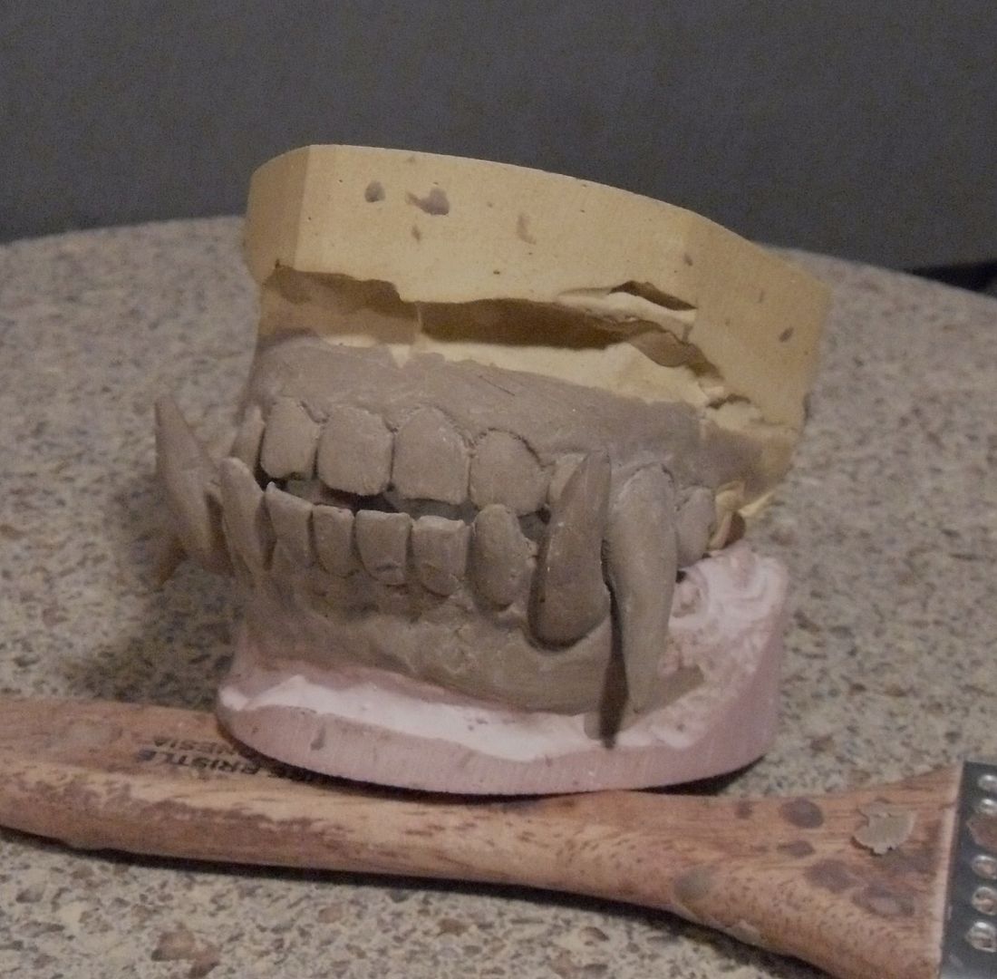

here is the rough sculpt for the dentures. the wolfman in the movie, the bottom teeth over laped the top teeth.
i will not be able to talk or drink with the dentures in.

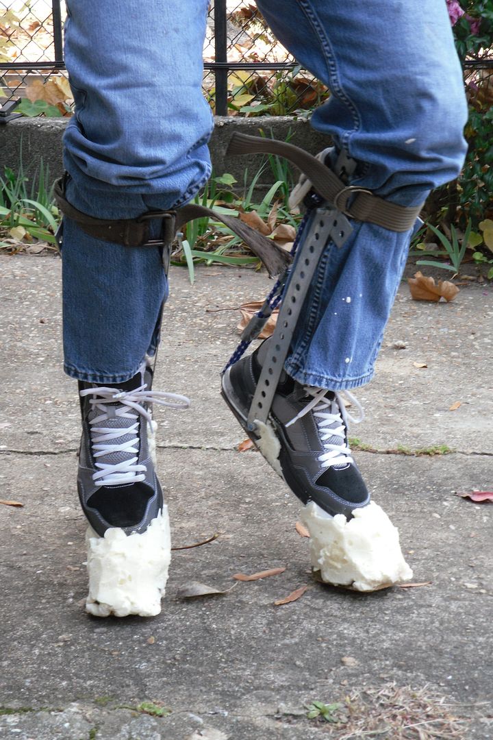

the cool thing is i had to build digilegs. took me a little while to figure it out but i got them to work. i need to trim off the excess metal and screws tips. i plan to sculpt right over these. takes alittle time to get used to the legs. i also wear knee braces but forgot to put them on for the pics.

here are my dentures that look like crap on a stick. :angry luckily i have a friend who is a dentist that makes dentures for a living. he goes by SithariRog on a couple of forums and he said he would redo them and make them look awesome! YA!!!!:love
here are the sorry pics of my sad dentures......:cry:cry

This is gonna look great! Can't wait for the finished piece. I've been wanting to do a werewolf with digitgrade legs for a while. Could you share how you made them? And do you have any other pictures of the 'feet', possibly showing the part under the shoe? thanks
mrbungle
Re: "the wolfman" costume......WIP
thanks. all i am standing on is 8th of an inch steel that is as wide as my foot. bent into the leg shape with wood bolted to the steel and the shoe bolted to the steel. then i took spray foam to cover the steel so i could sculpt over it.
there is not a whole lot to it.
i just watched several vids on youtube
here are a couple.
Digitigrade Werewolf Legs / Stilts - YouTube
Arbiter Digitigrade Stilts test, June 2008. - YouTube
WETA Legs stilts at Maker Faire - YouTube

I'm in the process of planning my own WETA legs as well. I noticed your stilts do not have support past the knees (thigh area) as WETA's does. Do you think this is not necessary?
Here's a link of this guy who pretty much copied Kim Graham's WETA legs design and it's pretty elaborate to build.
http://www.youtube.com/watch?v=a9QfAJeO2R4
