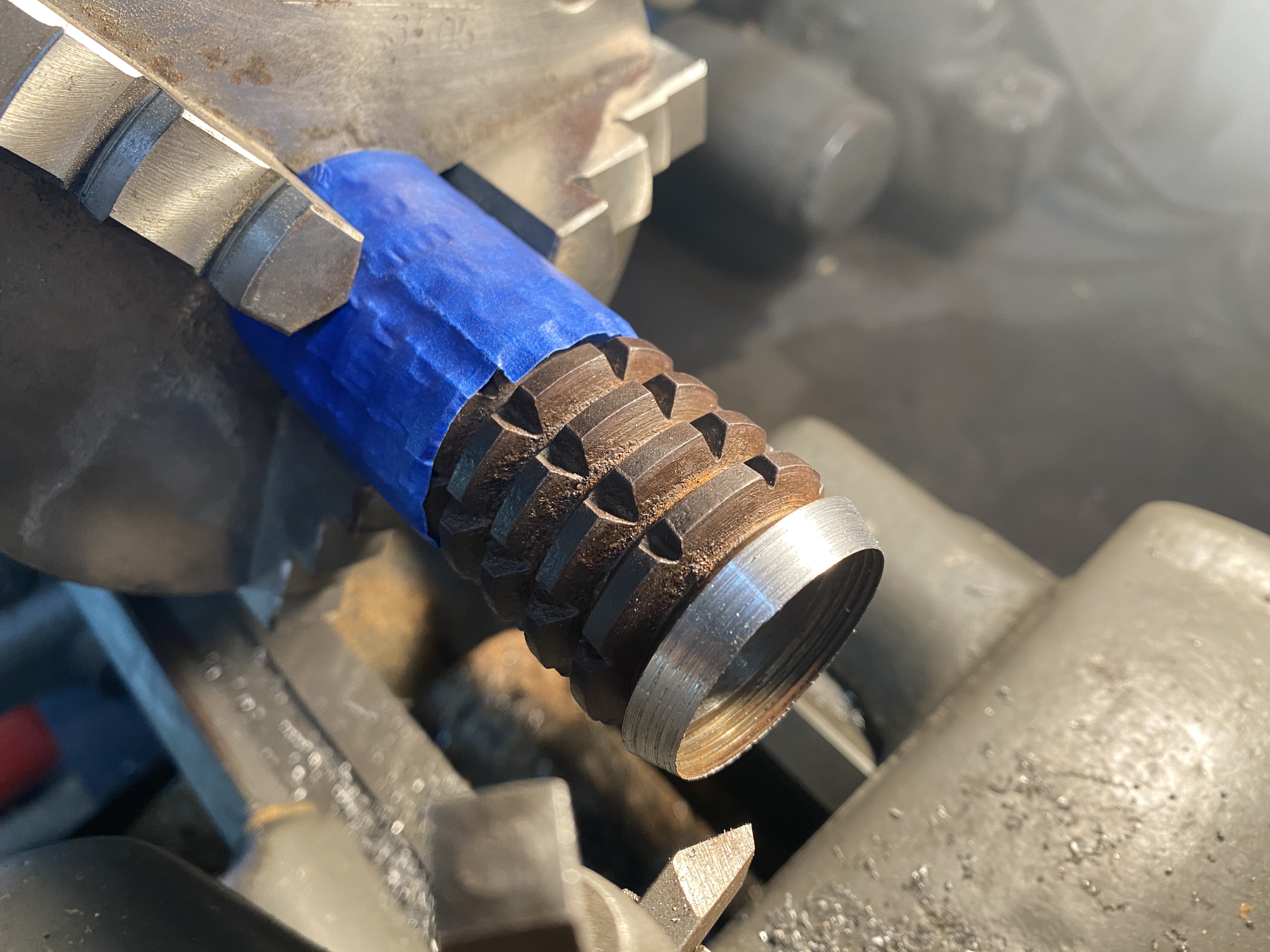

I recently got the inspiration to machine the slope on my grenade down to make it accurate to the original prop. I then aged it again so it was like before the operation.

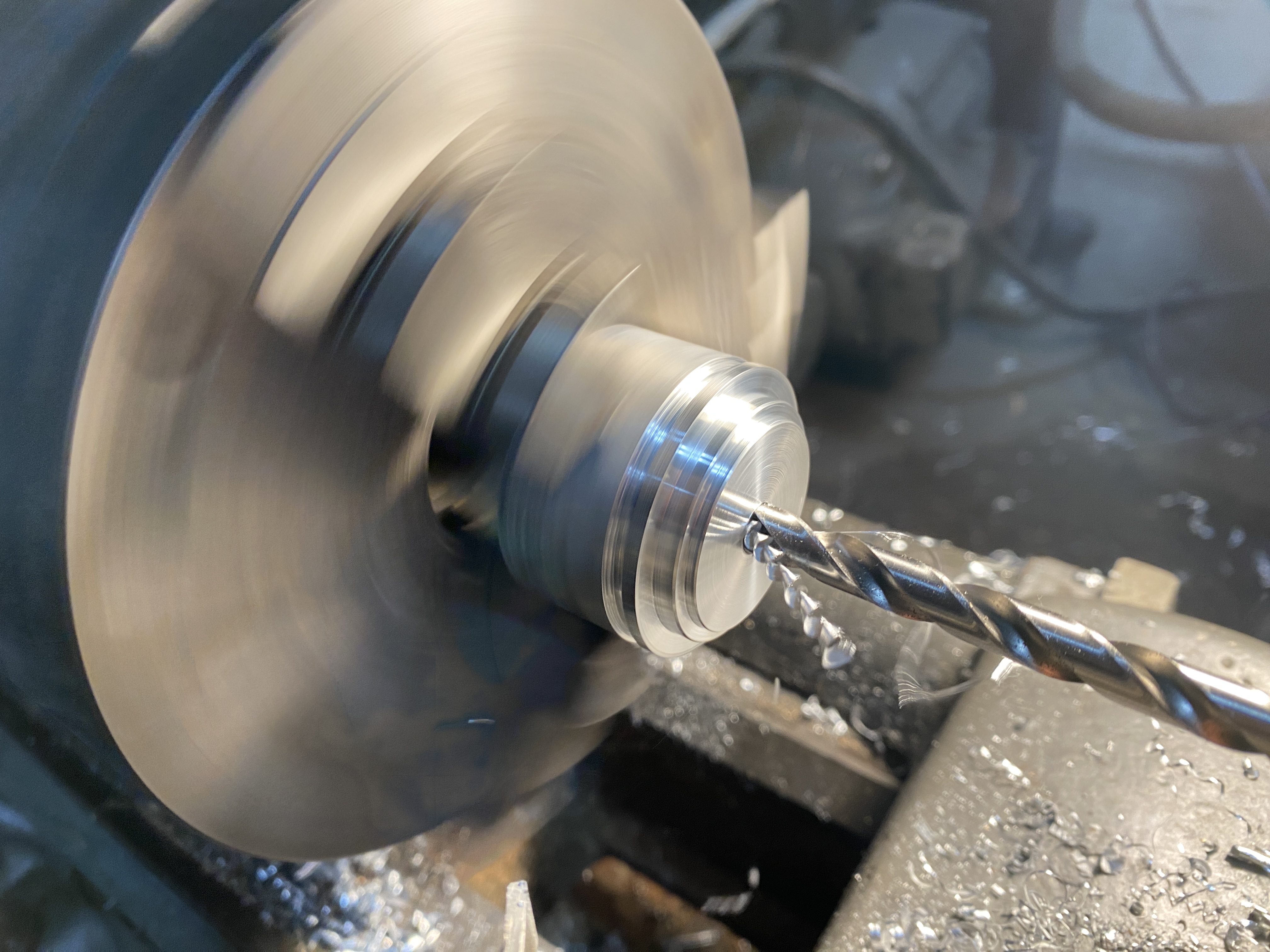

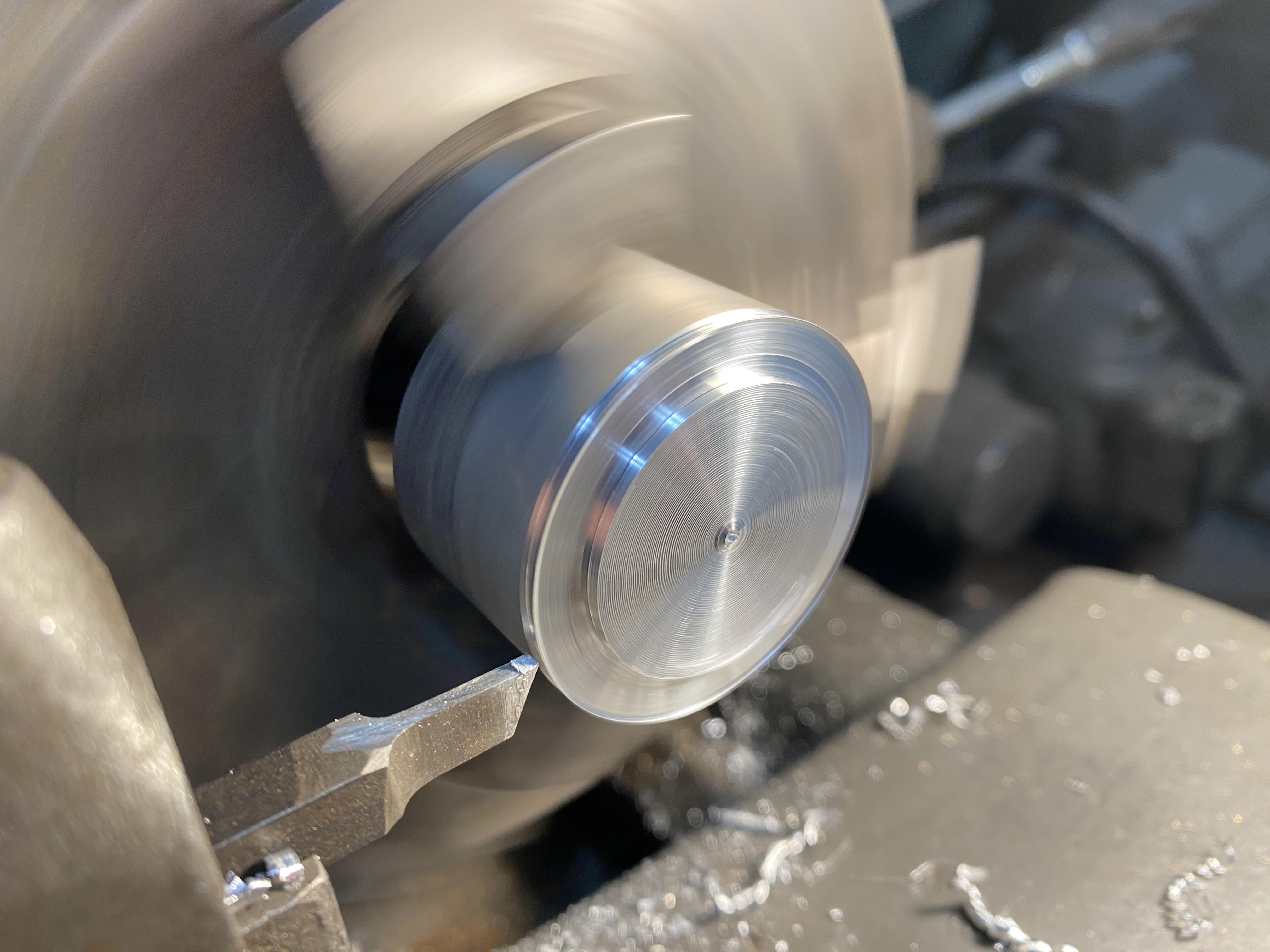

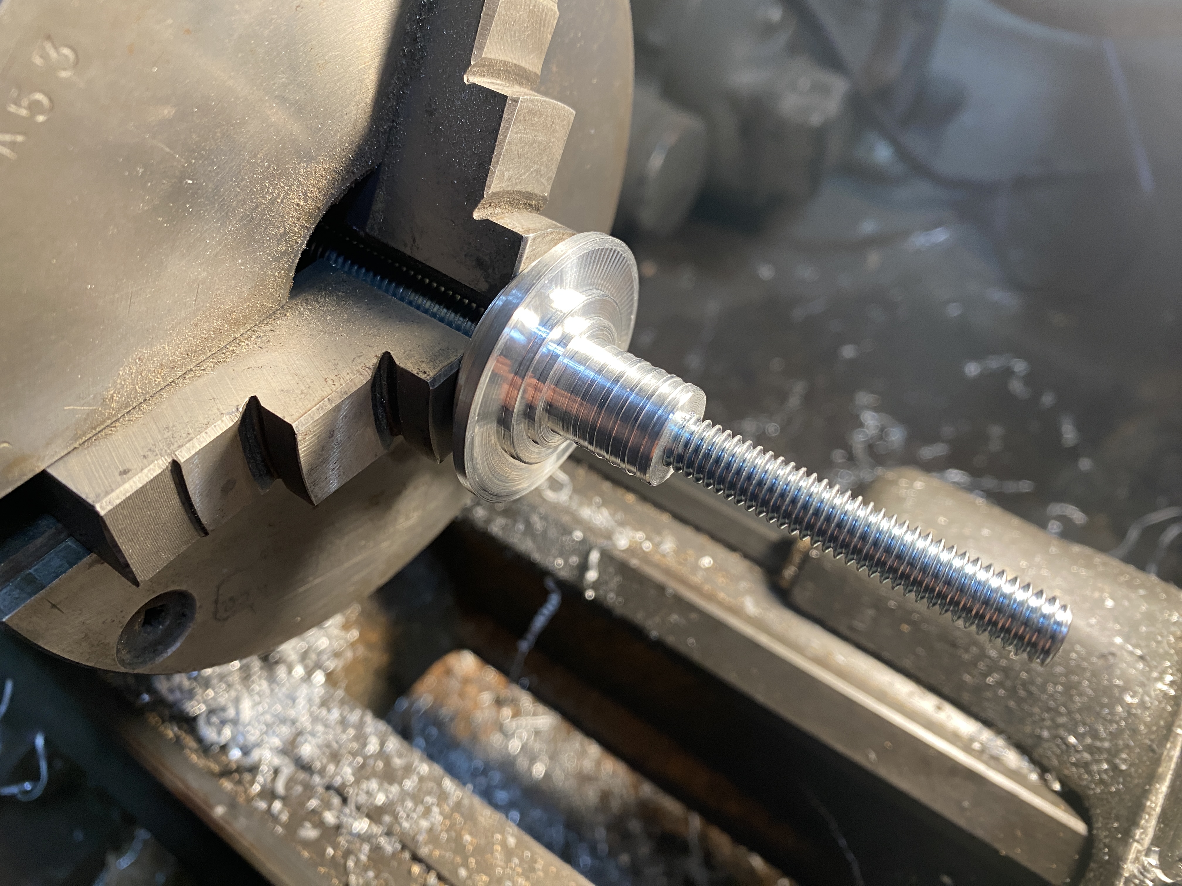

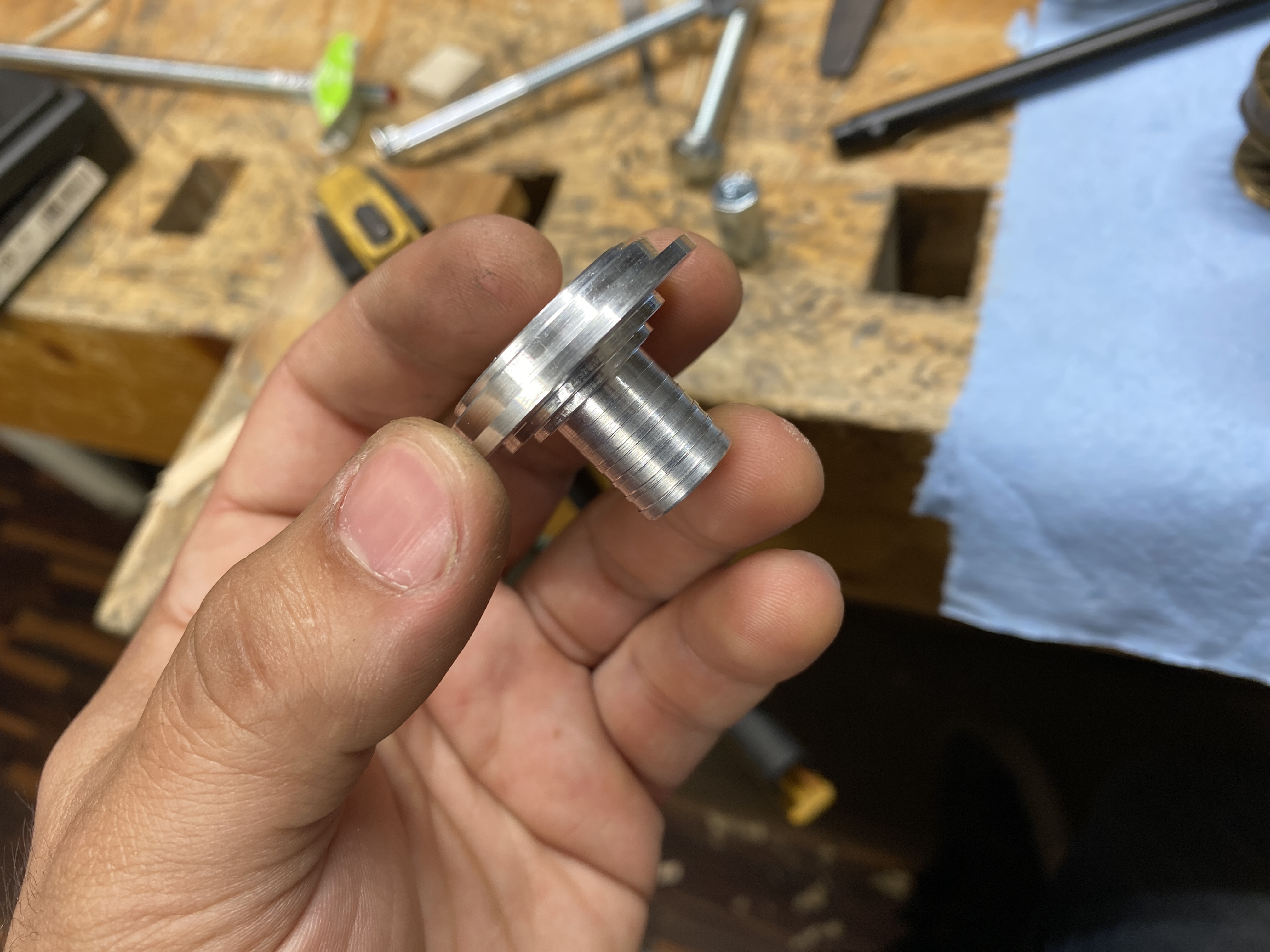

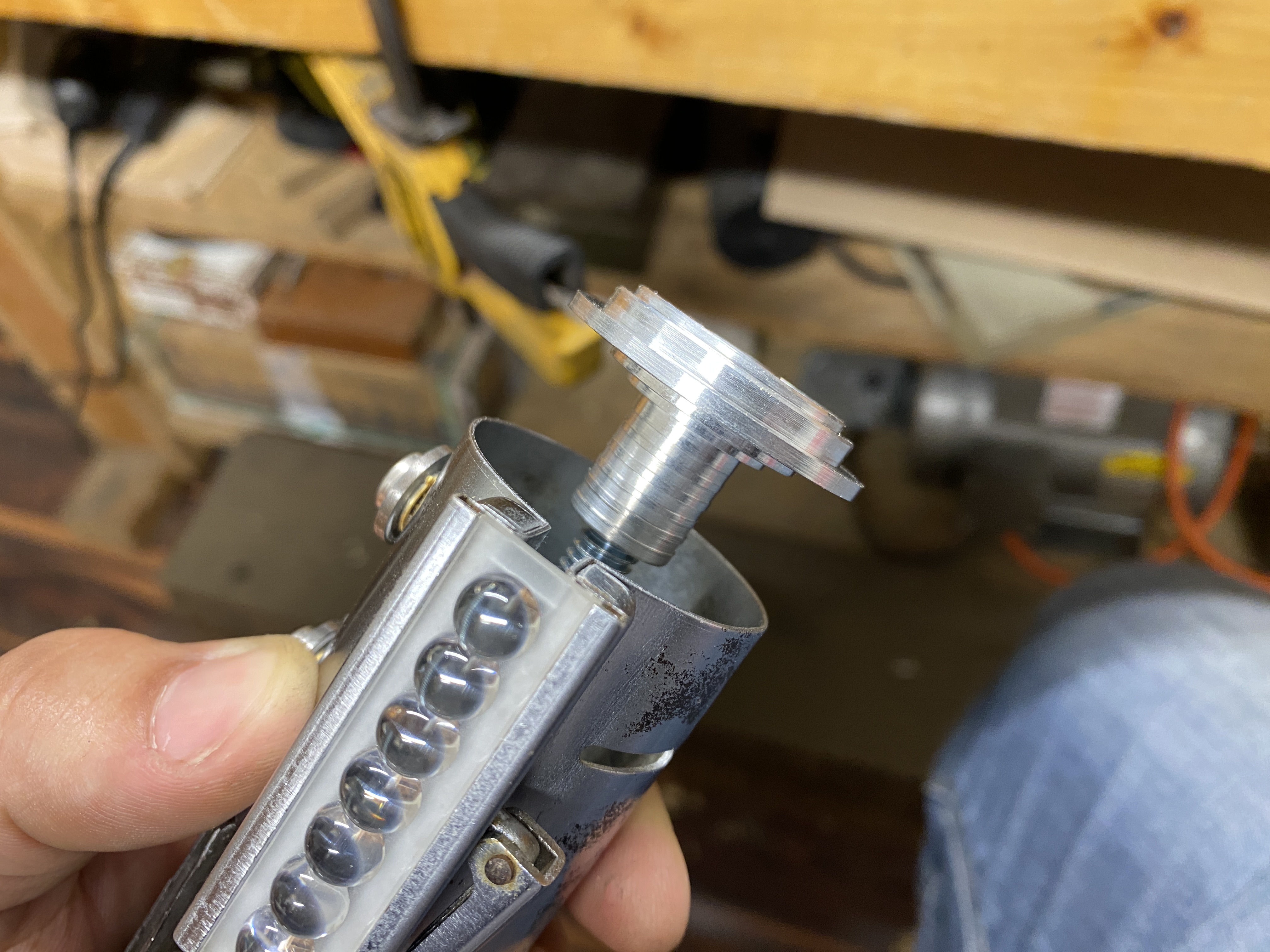

And then after a little while of messing around with all the parts one of the tabs that held my grenade in place snapped recently and the whole assembly started to not hold together properly. When I would screw it together it was very lopsided and didn't feel sturdy. I figured machining some sort of spacer would allow the grenade to sit in the correct position according to the Chronicles reference and also take the stress off of the remaining tab. The idea was that this would allow the long threaded section to support the weight of the grenade and add stability side to side.

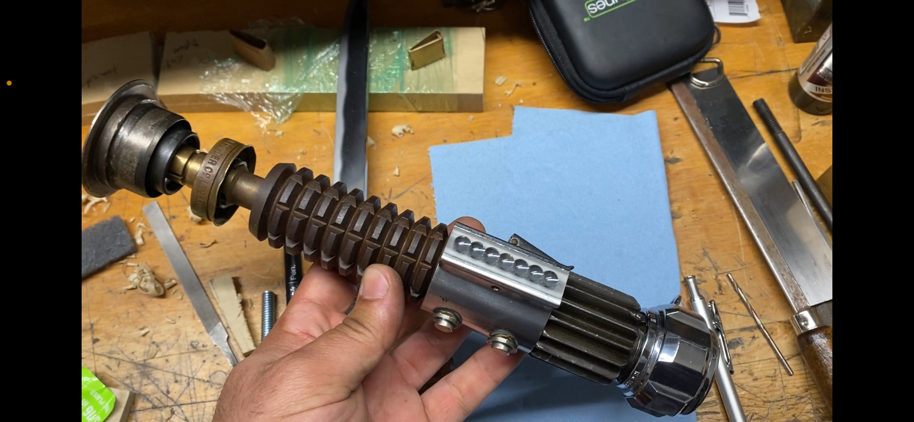

I realized I didn't take a photo of the whole thing assembled yet... but here's a screenshot from a short video I took of it together.
View attachment 1821104View attachment 1821106View attachment 1821107View attachment 1821108View attachment 1821109View attachment 1821110
I would never know it had been altered. Looks really nice :)
Thank you! That was the hope! I've been doing this type of iron aging for years in my regular work, so it's nice to be able to apply it to the hobby!

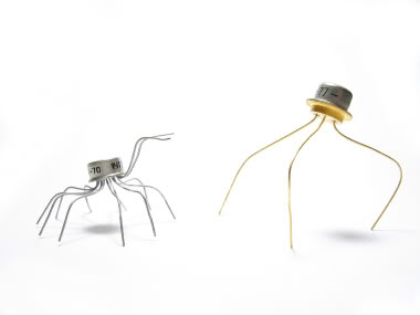

Has anyone attempted to embed rare earth magnets into the Anita transistors as a means to mount them to the clamp?
It’s an interesting concept.
I have seen people shave down bolt threads and mount them to the back.
I want to attach them in some way personally that doesn’t damage them.
I figure you could bend out the legs and maybe hot glue them to the inside of the clamp maybe.
Yeah with my other transistors I did the epoxied bolts but I never liked that solution. The splayed legs idea is worthwhile too.
Thank you that’s really helpful :) I know I ideally don’t want to damage mine.
So I will keep at it for now and see what I can do.
I found the most straightforward method (and how I currently have my transistors attached) was to snip the legs flush under the transistors and glue them directly onto the Graflex clamp with E6000. That method was recommended by 3251bimmer, and he has completed several of these builds.
I may just do this as I'm not feeling like ******* up drilling out mine.
