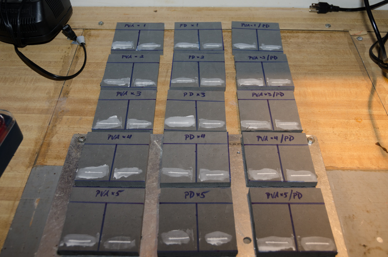

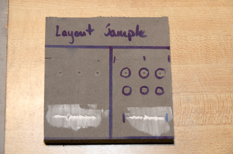

Identical foam pieces were prepared with the following attributes:
  • The pieces were divided in half with one side being sanded with 320 grit sandpaper and the other side not sanded at all;
  • "Damage" was created on each side including: 2 x razor knife cuts, approximately 1" long (one starting on the edge and one in the middle), 3 x gouges similar to the pock marks found in the EVA foam, 3 x pin holes to simulate how some people hold down patterns with pins, and a 1"gouge that is repaired with flexible caulk.
  • All pieces were painted with 2 x coats of spray primer and 2 x coats of blue, Krylon spray paint after the designated sealing method.
Four sealing methods were chosen:
  • PVA (2:1 PVA to Water Mixture) - Iterations of 1 to 5 coats
  • Plasti-Dip (PD) - Iterations of 1 to 5 coats.
  • PVA, then Plasti-Dip - Iterations of 1 to 5 coats of 2:1 mixture, then 2 x coats of PD.
  • PVA (3:1 PVA to Water Mixture) - Iterations of 2 to 4 coats. This method was added after the experiment was started and was reduced based on experience from the first three methods.

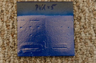

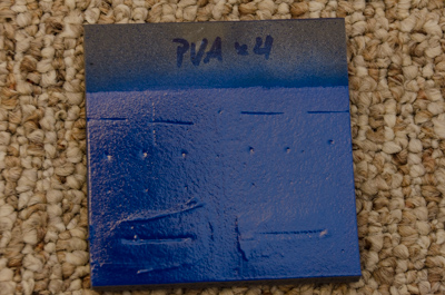

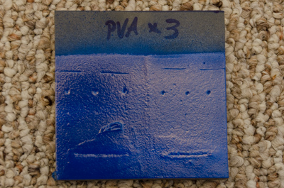

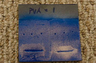

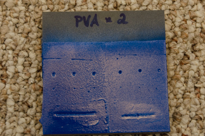

PVA (2:1)

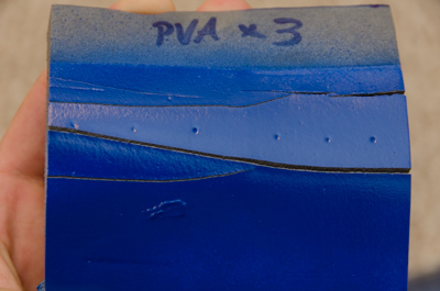

The PVA by itself is not able to fill in any of the marks or gouges, and the damage becomes more pronounced the more layers you put on. Even the pin pricks are still noticeable. I started sanding the surfaces with 1000 grit sandpaper from the second coat on, and the surface was relatively smooth. However, both visually and to the touch there was a noticeable pattern from the foam. Past 3 coats I couldn't see any significant improvements, so I would say that if you were only coating with PVA that anything above 3 coats is just a time sink.

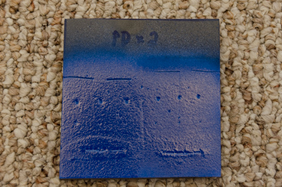

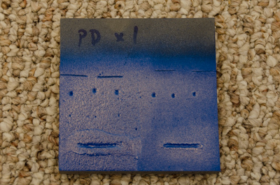

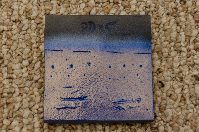

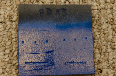

PD
The results of the PD squares were about the same as the 2:1 PVA. The PD was unable to fill any of the damage by itself, so the gouges and cuts were still very noticeable. PD also has a very distinct texture, even when sprayed on the smoothest of surfaces. It can be sanded with high grit sandpaper, but the results are not that great since PD still maintains its texture. Just like with the PVA there was no significant difference with more than 3 coats.

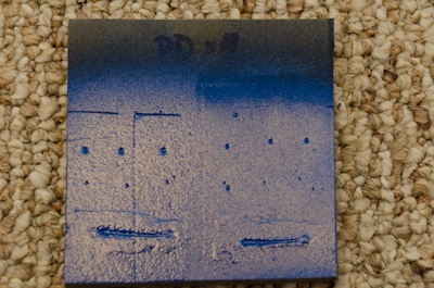

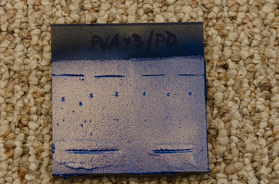

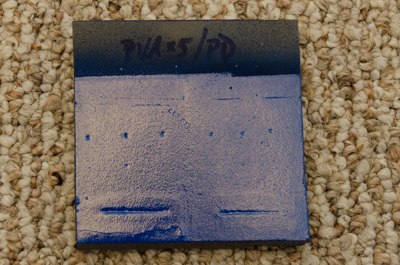

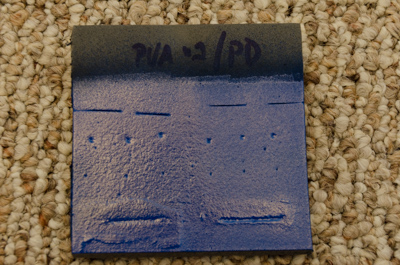

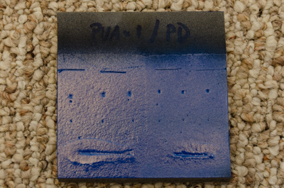

PVA (2:1) and PD
I know that the PVA/PD combination is extremely popular, so I had high hopes for this combination. Unfortunately I was disappointed to get squares that looked identical to the PVA and PD squares. Since the PD sits on top, the squares all get the PD texture, and unfortunately the 2:1 PVA is unable to fill in the damage like I had hoped.

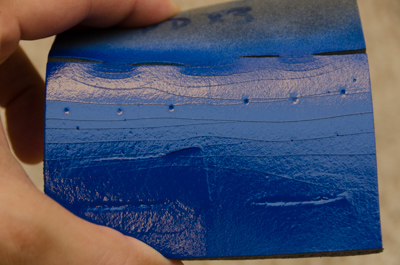

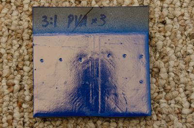

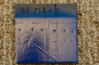

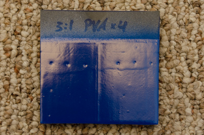

PVA (3:1)
My original scope was only for the first three iterations, but the disappointing results pushed me to look for another option. I knew that some people were using either straight PVA or PVA that was only slightly thinned, so I decided to go for a 3:1 PVA to water ratio. I also switched to using a foam brush instead of a bristle brush. That change proved to be much more significant than I thought. Finally, I didn't make a gouged area and fill it with caulk since by the time I got to these squares I didn't have any caulk lying around.
As you can see, the results of the thicker PVA are significantly different. The PVA was much smoother and it managed to fill in the damage much better. The larger gouges were still visible, but they were significantly lessened. To the touch the surface was completely smooth and it took 1000 grit sandpaper without any issues.

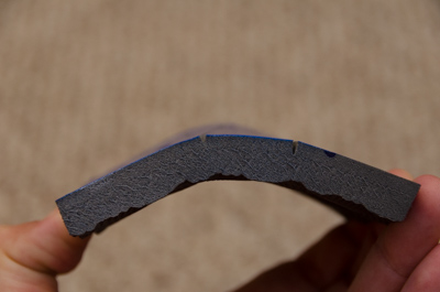

To test flexibility I decided to use the squares that had 3 coats of PVA. This test was fairly simple - bend the square in my hand and see what happens.
PVA (2:1)
I did NOT expect this to happen. When I bent the PVA I was greeted with a loud CRACK. As you can see the cracks were actually fairly deep, and the foam split in areas that were not cut by me.

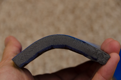

PD
The PD didn't have a resounding crack, but you'll see that a lot of small cracks appeared across the square. The cuts that I made in the damage area were also widened when I bent the piece.

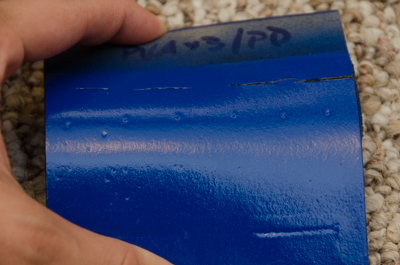

PVA (2:1) and PD
This square did much better than the lone PVA and PD panels, but the cuts in the damage area still split.

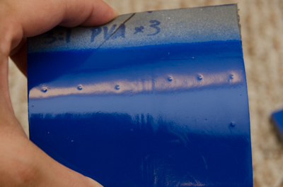

PVA (3:1)
Given the results of the other flexibility tests I wasn't very hopeful. Much to my surprise the 3:1 PVA did not crack at all. I bent the square much further than all the others and it held up. Thinking that maybe it was a fluke (glue not fully cured, etc.) I bent the other 3:1 PVA squares - no cracks!

  • If you want perfectly smooth 3:1 PVA is the best choice - Some people may want a rough texture, so they can stick with thinner PVA formulations. However, if your goal is to achieve a perfectly flat surface you will need to fill any gouges with caulk or some other flexible material (remember, we're shooting for flexible pieces), sand the surface with a high grit sandpaper, and then use 3 coats of 3:1 PVA. This will get you the smoothest surface possible without plastic coating your pieces.

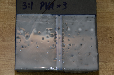

  • Don't worry about bubbles in the PVA - Originally I worried that all the bubbles would ruin the finish, but as the glue starts to dry the bubbles will settle and smooth out. Just brush the PVA on as smoothly as you can and the bubbles will work themselves out.
