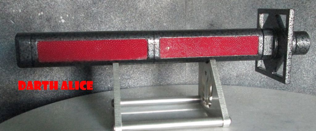

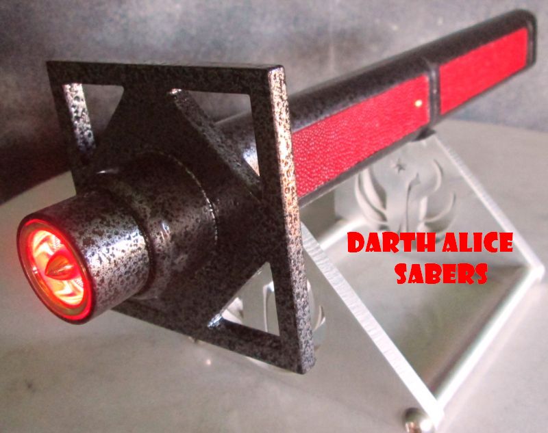

Here is a saber that I have been engineering for quite some time. I have been watching the anime Bleach and have gotten into the different sword and outrageous weapon designs on the cartoon. This is what I envision a Sith Acolyte would wield if he built a Katana for his saber. Yes there has been a few different versions of the crystal chambered Katana done before, and I took much inspiration from Madcow's MHS Katana and also AMNRA's MHS saber with rotating crystal.
Since getting my hands on more Oval stock, (and a real milling machine) I decided to put a different spin on this one in that it is what I call a "cantilevered reveal system" in that the lower section of the hilt slides open for the reveal with a hidden latching system, with the main support rods machined from Stainless steel rod. I also dreamt up a design to keep all of the fasteners hidden with no exposed screw heads. I must say as simple as this one looks, it is by far the most precise saber I have yet to build and I would not hesitate to duel with it, chamber open or closed as this one handles like a dream. Hope you guys enjoy!
Specs; Main hilt length, 13" x 1.00" x 1.50" Oval pipe and billet as built from scratch
Powder-coating; Silver-Vein done by local vendor
inserts;Blood Red dyed Sea-ray skin
Main Led; Naigon's Z6 RR, GG, RbRb
Board; Igniter 2
Battery; Solo's Hold 10amp High discharge 18650, with 1.3mm RC port
lens; Solo's hold 5 degree custom
Speaker; 23mm 8 ohm 2 watt
ARKM/Caz style razor plug (thanks again guys)
Crystal chamber; Grown quartz with 5mm RGB blade matching led
