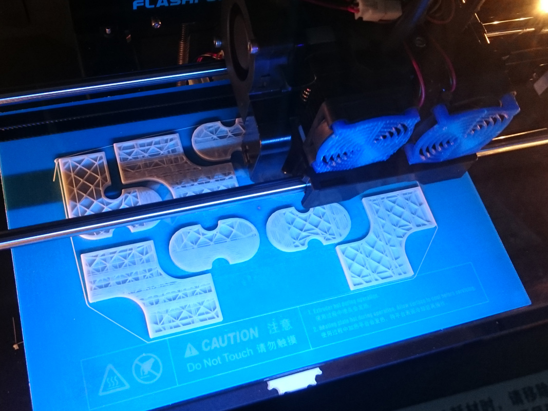

    The print was done in ABS. Simplify3D provided the best slicing results.

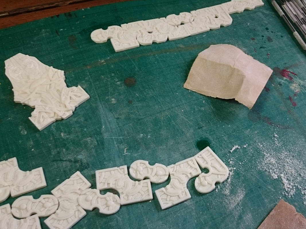

    Sanding and filling… I think every 3D printer should come with a phone book sized wedge of sandpaper. I also dremelled some extra texture into the front of the crown.
    My initial plan was to weld the joints together with acetone, but then I had this bright idea about using wire so it was flexible… which went really badly and I ended up having to print the whole thing out again. After sanding all the pieces for the second time I went back to plan A and pinned the joints with ABS filament and acetone. Used a grid to help get it all symmetrical.
