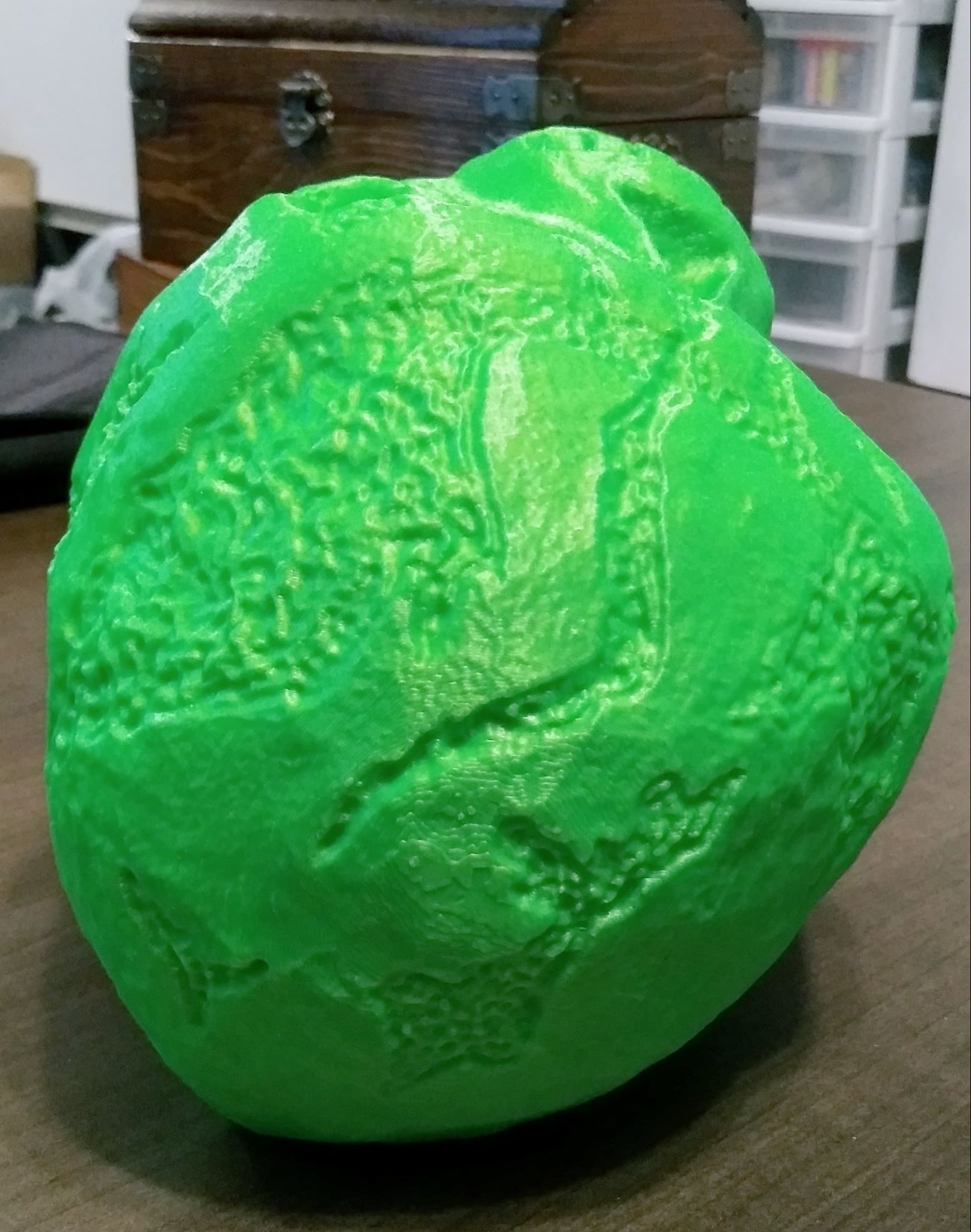

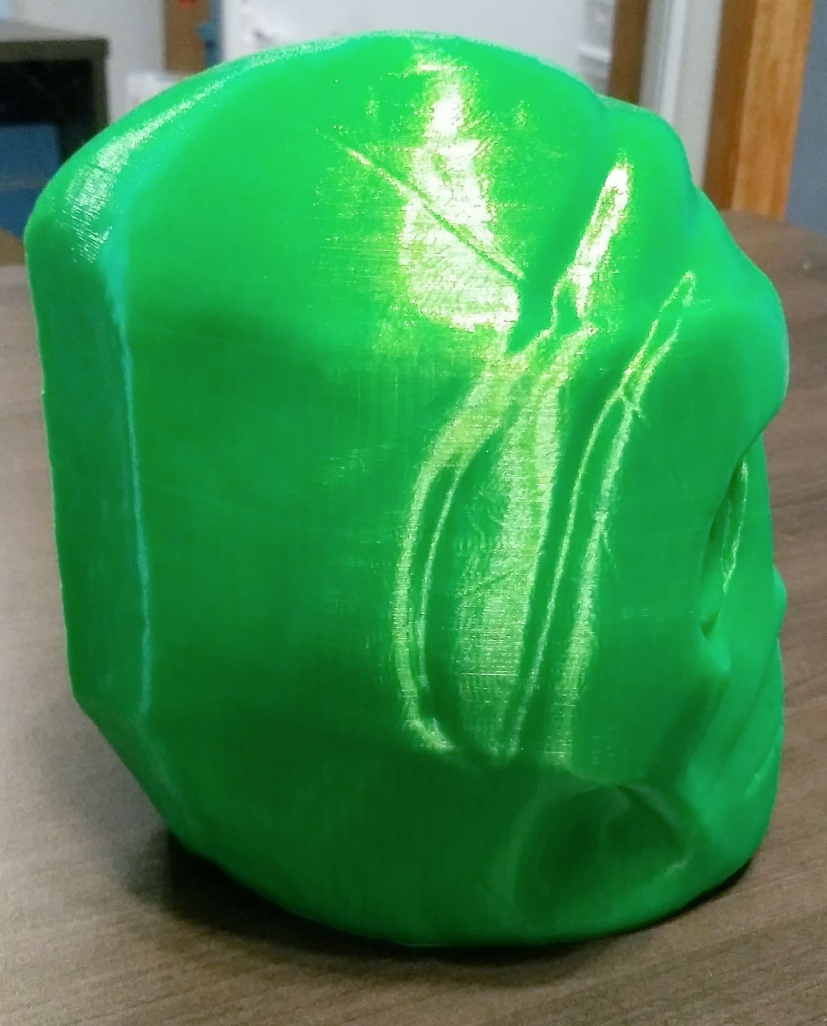

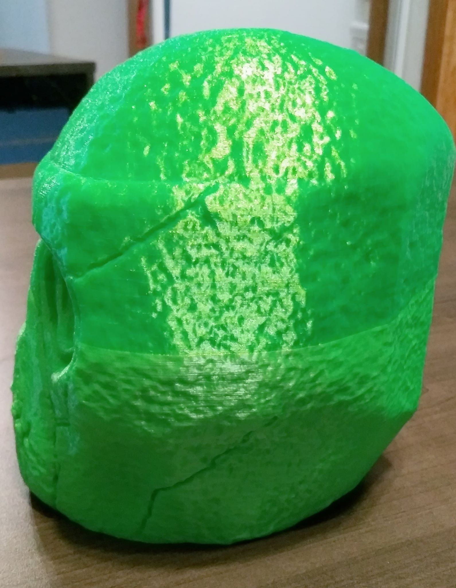

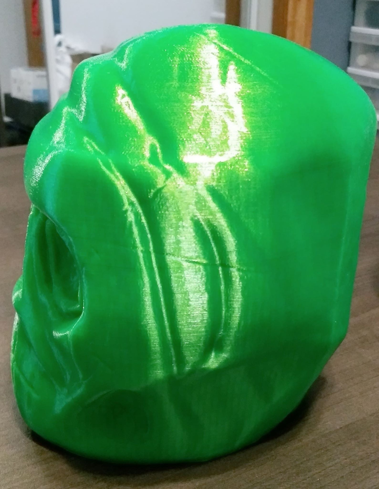

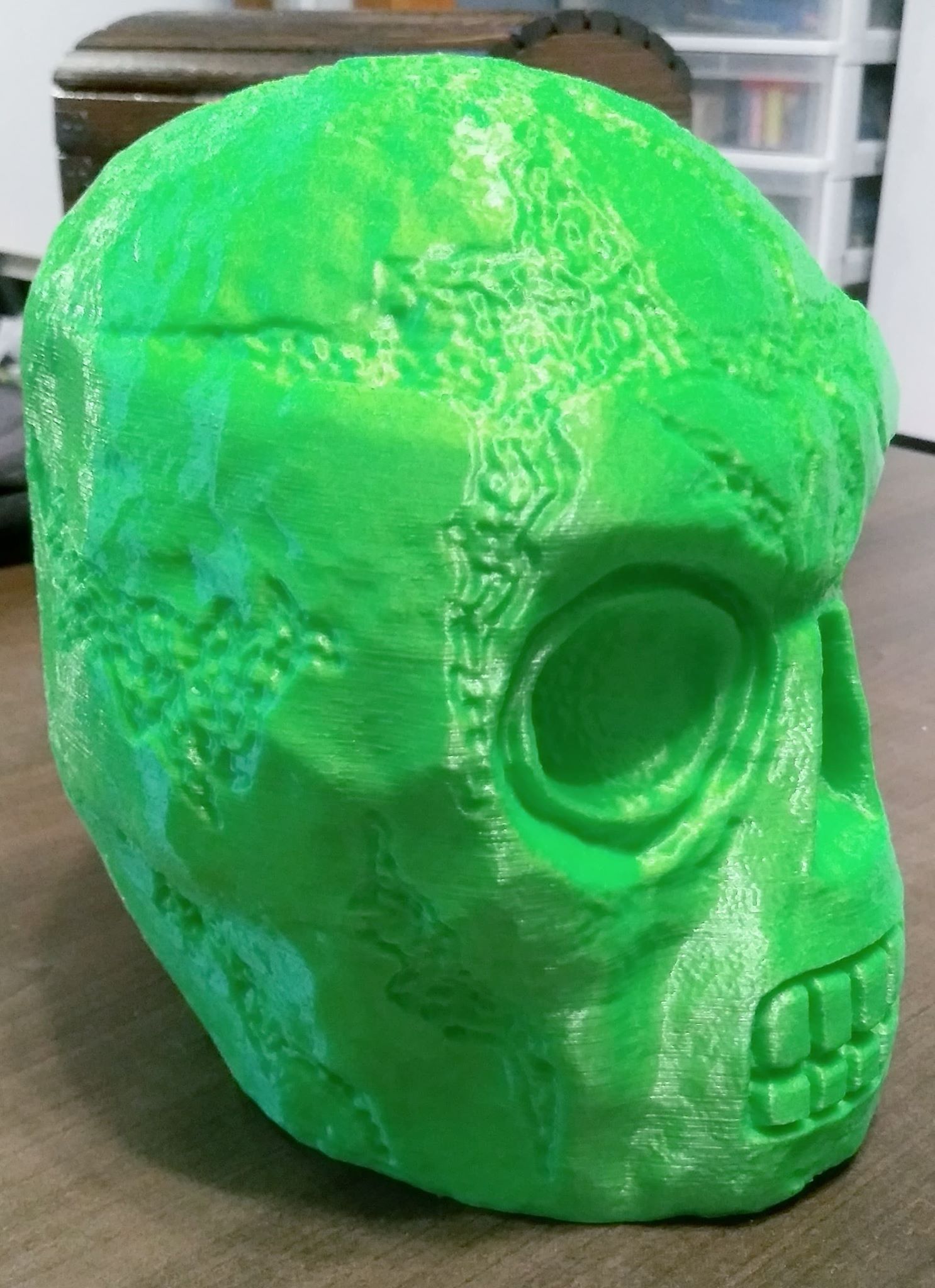

I started by getting the Jade skull printed in PLA:
It's hollow and looks quite nice.

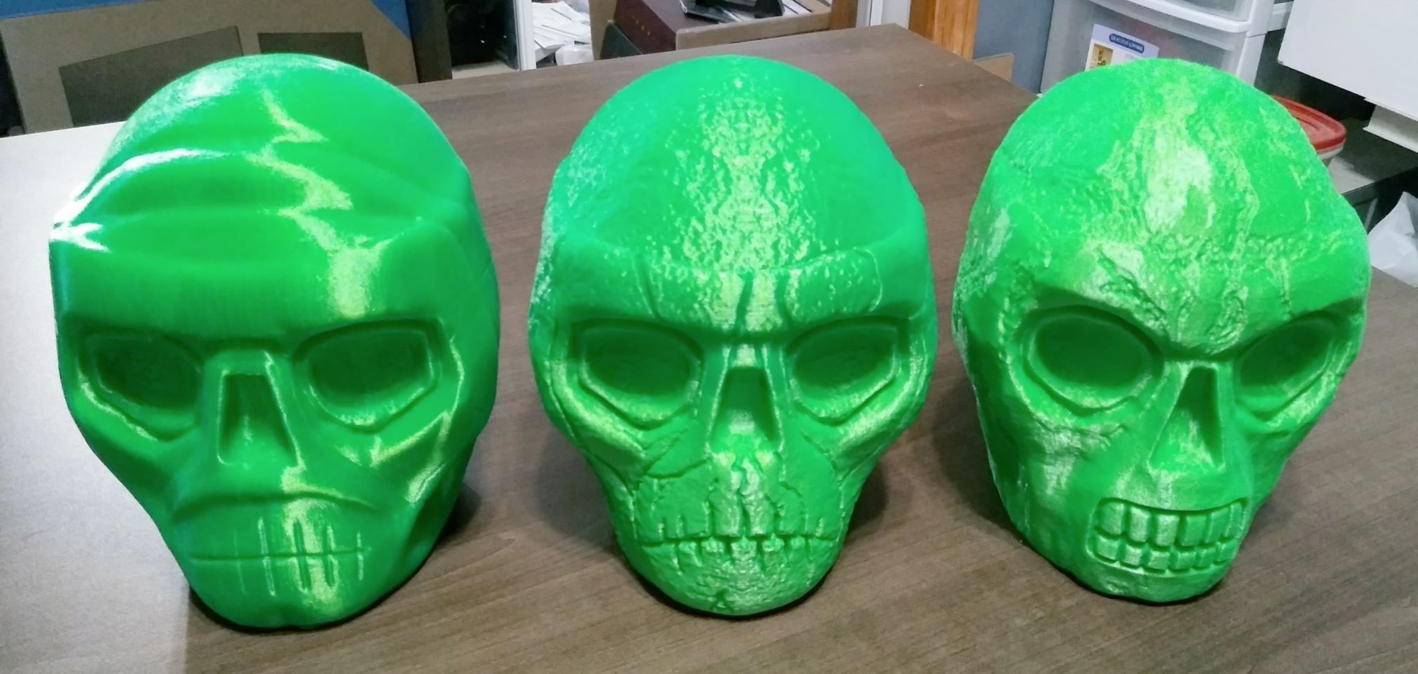

Since this came out so good I decided to have the other 2 printed.
Silver skull:
Gold Skull:
All 3 together:

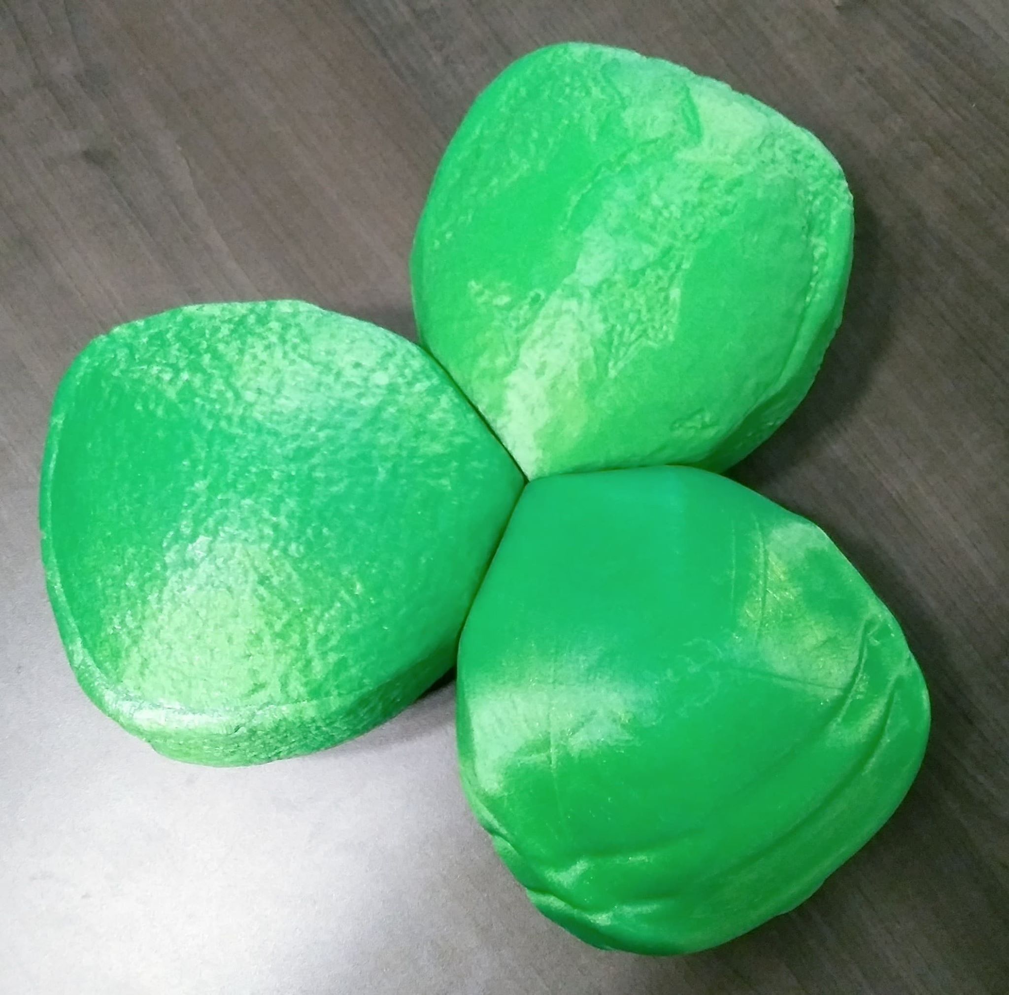

The Skulls all fit together as such:
I love them, but the printed 100% size is a tad too large and might need to be shrunk by 10%.

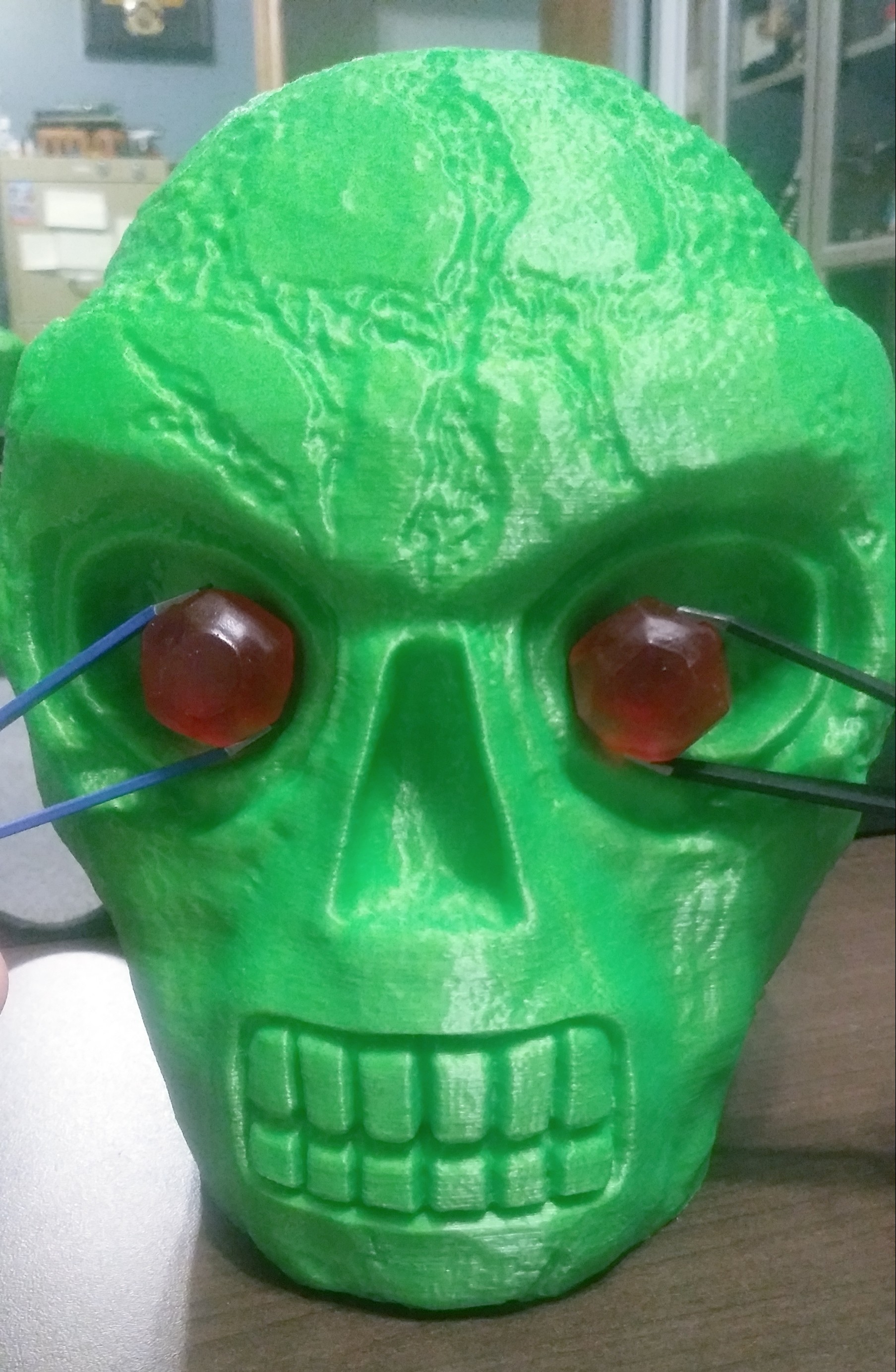

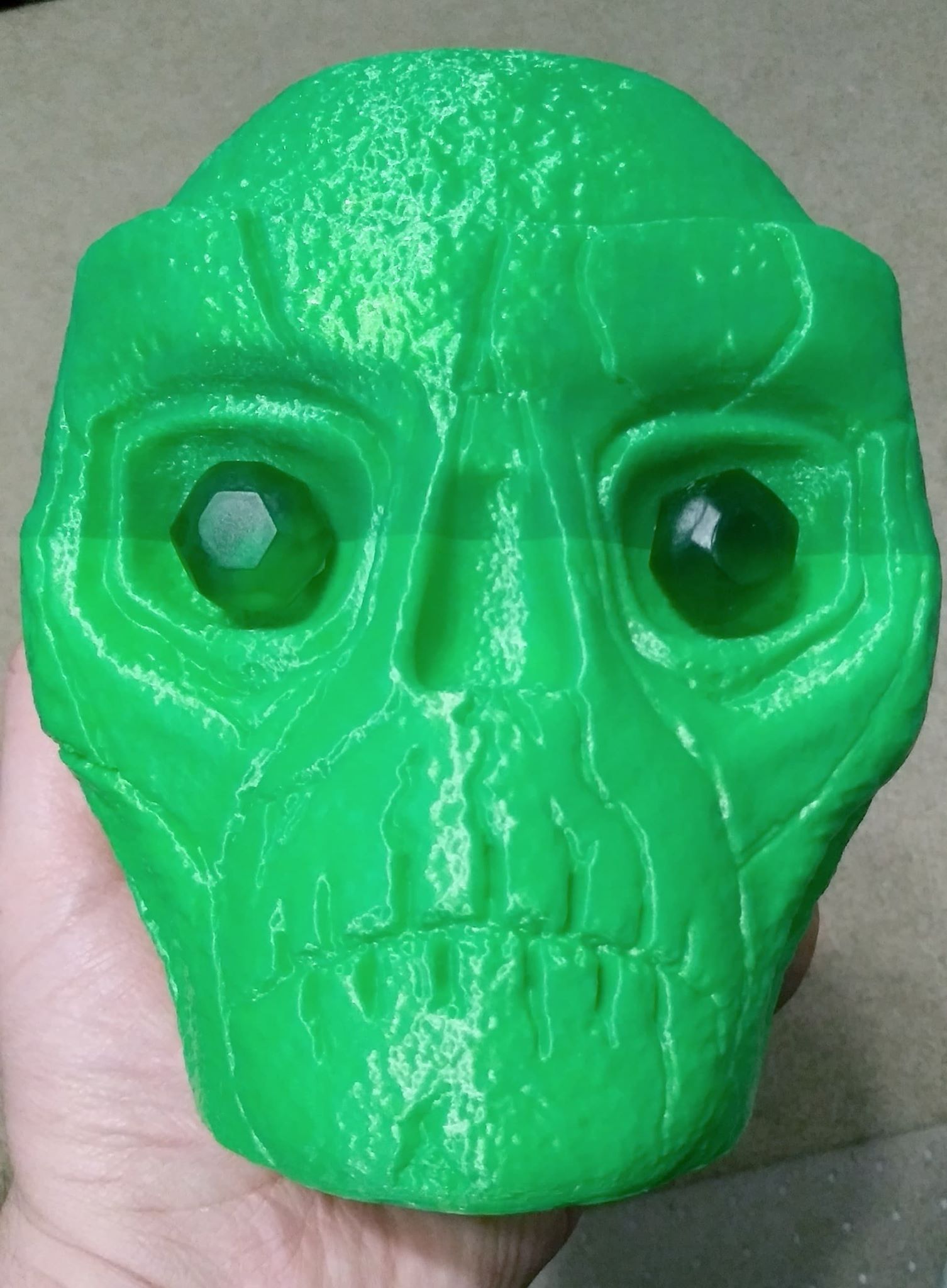

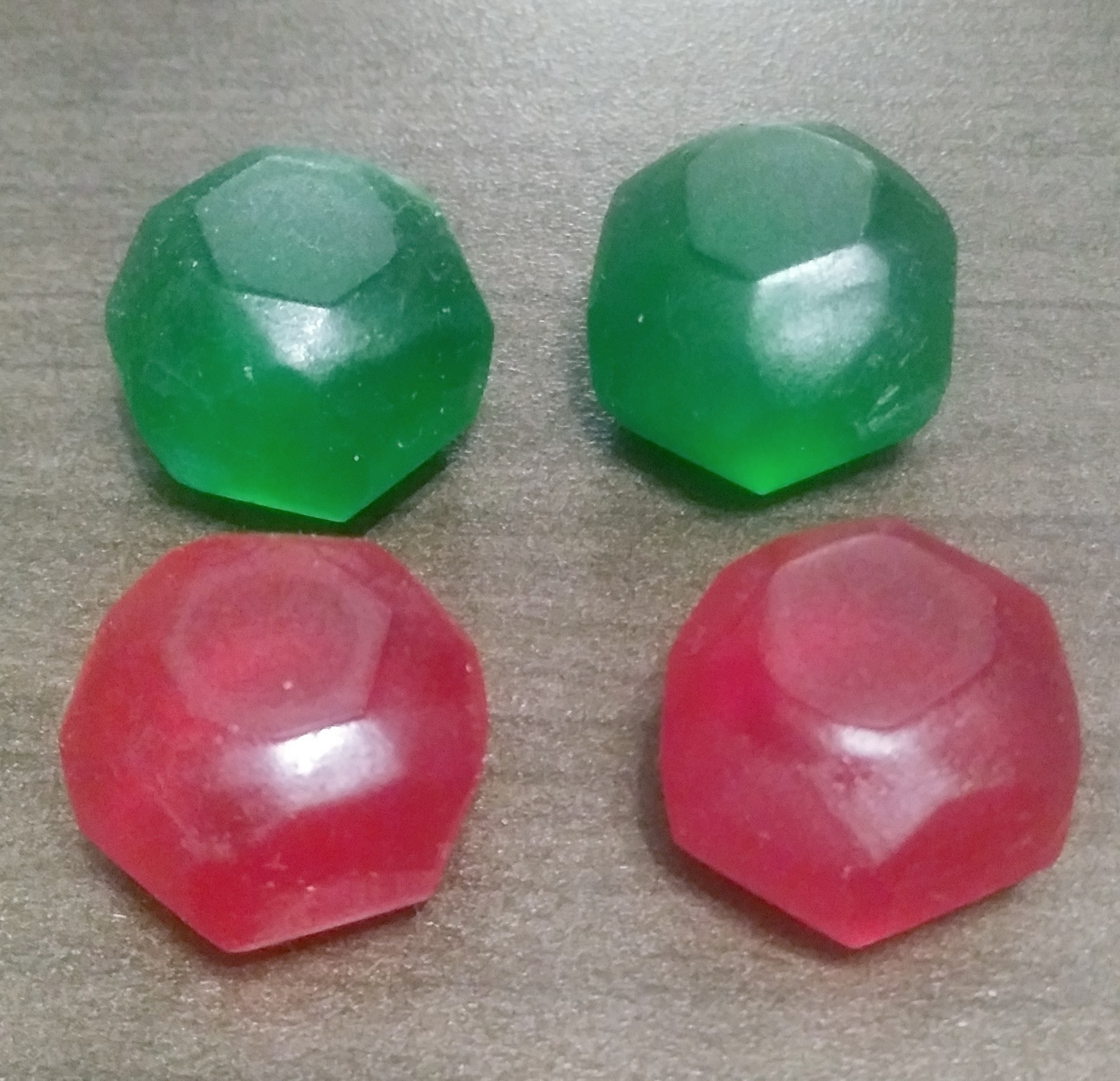

I have also had the eyes printed in resin as I want to cast them and cast them in epoxy in the correct colors per skull. They came out really nice:
I also used some stickytac to place the eyes in the Gold skull for a photo though.

Now I need to look at some smoothing.
I'm trying to find something I can use so I don't have to fill and sand as the surface finish is already quite smooth. Also would love some suggestions of gold or silver paint I could use, or maybe i should just paint black and use rub and buff?

What I use to smooth my prints out is the very resin used for 3d printing. Get the Elegoo ABS-like resin and a UV lamp ($15 & $35 respectively). Brush some on with a small paint brush and spread it around until it doesn't run anymore, then hit that area with the UV lamp. By spreading it thin you'll keep a good 80-90% if the details that would be lost using regular bondo/spot putty. The UV light cures that layer is about 2-3 seconds as well so you can get the entire thing covered quickly. Repeat 2-3 times until you are satisfied with the lack of feeling the layer lines. Give the entire thing a full 2-3 minute cure in the UV after you're done and then use a toothbrush with IPA (70% or higher) to get the tacky feel removed. Then let dry for a 24 hrs and paint as you'd like!
