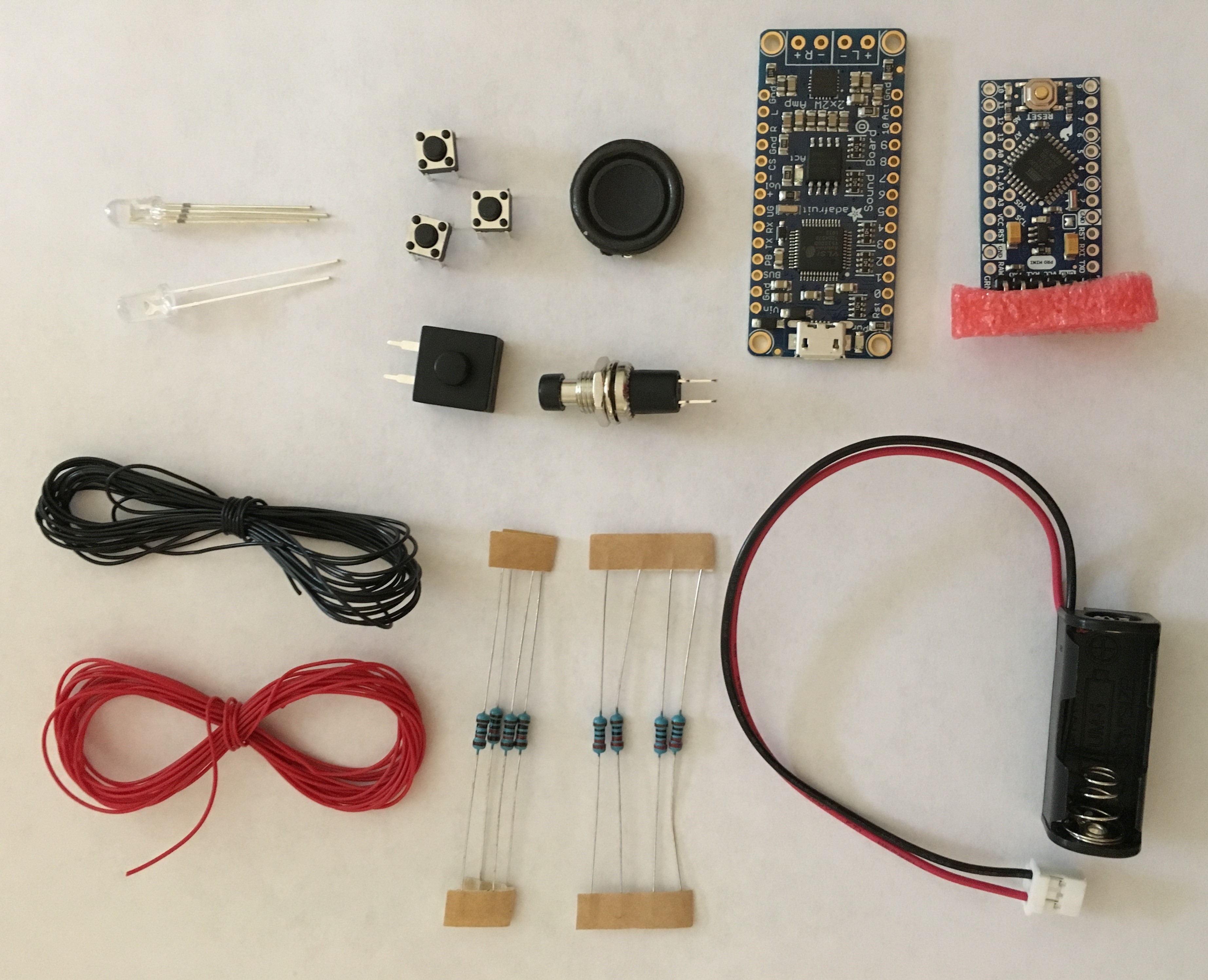

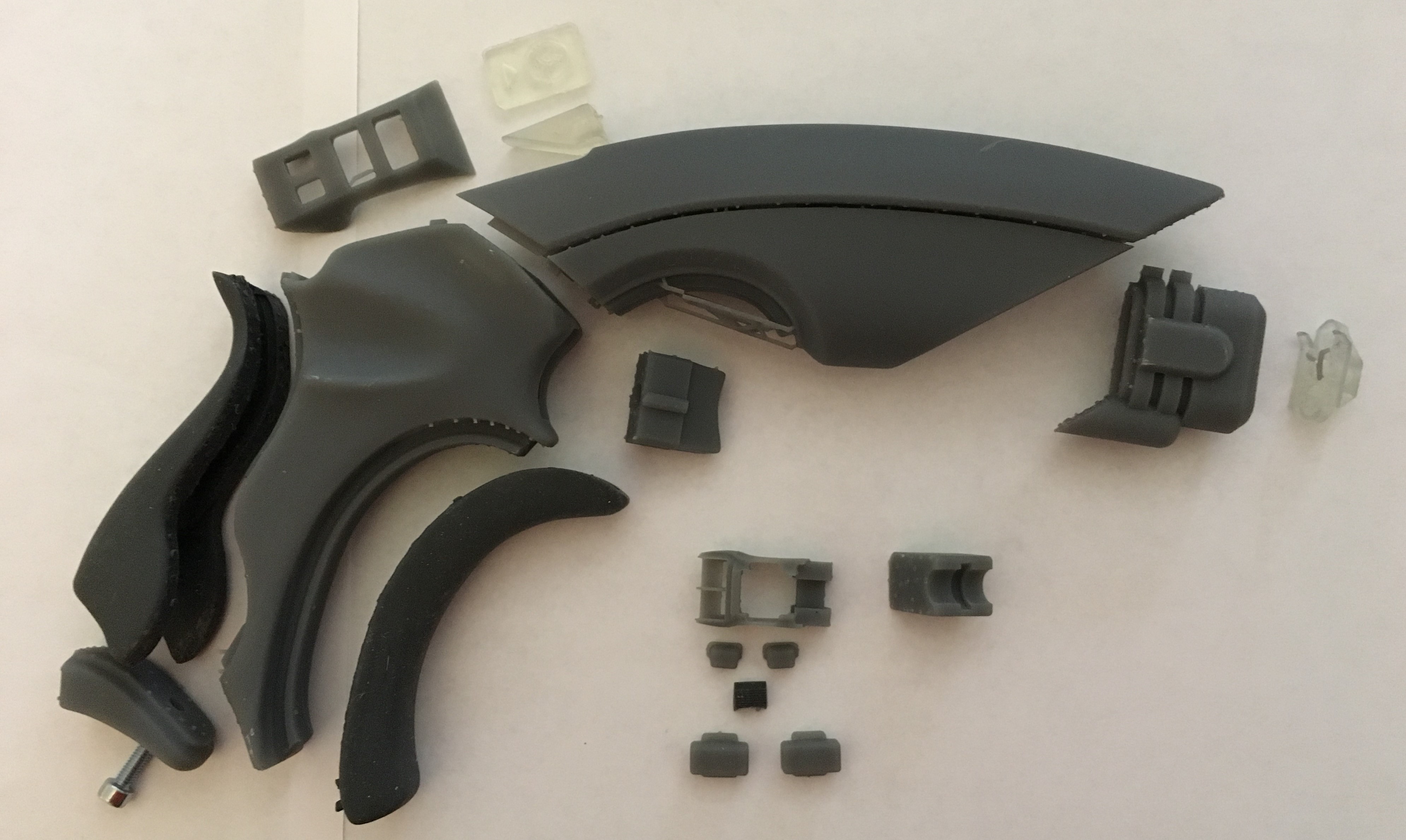

...got the much anticipated delivery from the post office today!
Here are two photos showing the parts all laid out. This will make a great addition to my Sci-Fi laser/phaser collection.....superb work!
Definitely time to review the build/creation thread to figure out how this thing gets put together!
Joatrash - any advice on the best way to do the clean-up of these parts? Also, is there a wiring diagram for the electronics?
-tnx,
Jeff

Wiring diagram attached. Note: ONLY use terminals on the "long" side of both boards. The diagram is not a 1:1 image. Also, you might want to remove the programming pins from the Arduino (small board) to save space. Also, I've searched for ages (and wasted a lot of $ trying to find good wire and trying to understand gauge sizes, insulation and so on, but it seems I can't wrap my head around it. The wire I have supplied is OK, but delicate, since it's only got one solid core. If you have an old USB cable lying around, gutting that might be preferable.)
Note: the hollowed out areas of the buttons should be filled with epoxy or something. Also, some buttons have very shallow "indents" on the underside- for the small buttons this indicates they should be towards the front, and one of the two the larger buttons it indicates the foremost button. (If that makes any sense.)
Use 400+ grit so sand... lightly. You can use rougher on the "support nub" leftovers. Use a scalpel to carefully cut the remaining nubs off the rubber grips. You CAN sand the grips... even though they are rubberized. (No idea how it works... it just does, defying the laws of physics Ed!)
IF there is any resin residue anywhere, use rubbing alcohol (isopropyl / IPA) to clean.
I have supplied a M4 screw for the buttstock. Tap the hold SLOWLY and VERY carefully.
Glue with 2-part epoxy for best results. Use hot glue to isolate terminals in the boards once soldered. (I used epoxy, but hot glue works too.)
Note: the two square "guide nubs" on top of the muzzle need to be filed down. A tiiiiiny bit of shrinkage during printing stops them from lining up perfectly.
Hmm... I think those are the important bits. If anything is unclear, just ask. (Maybe ask in the build thread since that will not get deleted.)
Use some grease on the trigger. Seat the trigger with an "underbite" (sticks out more at the bottom). Also, when you glue the trigger assembly test, test and test the fit and movement. Then test some more. This is one of the more fiddly bits and it's easy to get it slightly misaligned, which might cause the trigger to stick.

I've already cut away all the 'nubs' and did some trial fitting. ...just *had* to get an initial look-n-feel for what the PM-44 was like while holding it in my hand. :)
Glad you mentioned the 2 square nubs on top of the muzzle, after fiddling with the parts for a bit I had already tentatively decided to chop them off to make assembly easier and didn't see that anything would be lost....plus it allows the top and bottom of the barrel (?) to align better with the grip core.
Many thanks for the wiring diagram. I have multi-strand wire that's (I think) 22 gage which should be perfect for this. Oh....button assignment - can you tell me how you mapped S1, S2, and S3 to the 4 buttons on the top keypad? S4 clearly gos to the trigger. :)
