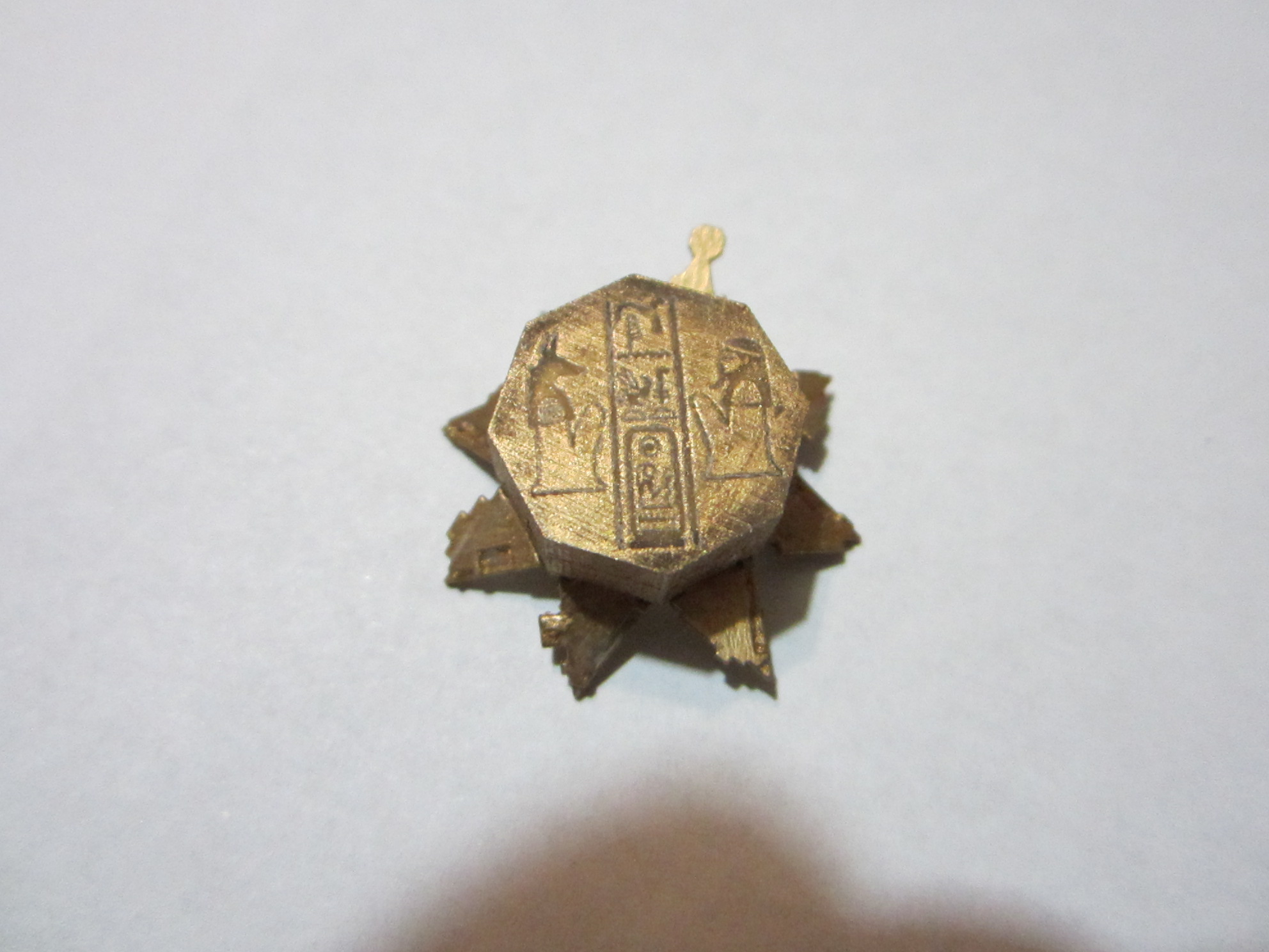

Okay, I did what I said in the last post.
I made a single object shaped like an 8 pointed star with one FLAP on each point. I'll need to snip them and sand the edges when they arrive.
If all goes well, I'll have a 1/6th scale Hamunaptra key made of stainless steel. Hopefully I can then get it gold plated.
Okay, that DIDN'T work. They rejected the combined object, so all they'll do is the base. They said they'd do the 8 flaps as 8 individual files.
I upload 1 flap and it would have been $15. So, $120 for the 8 flaps. That's annoying.

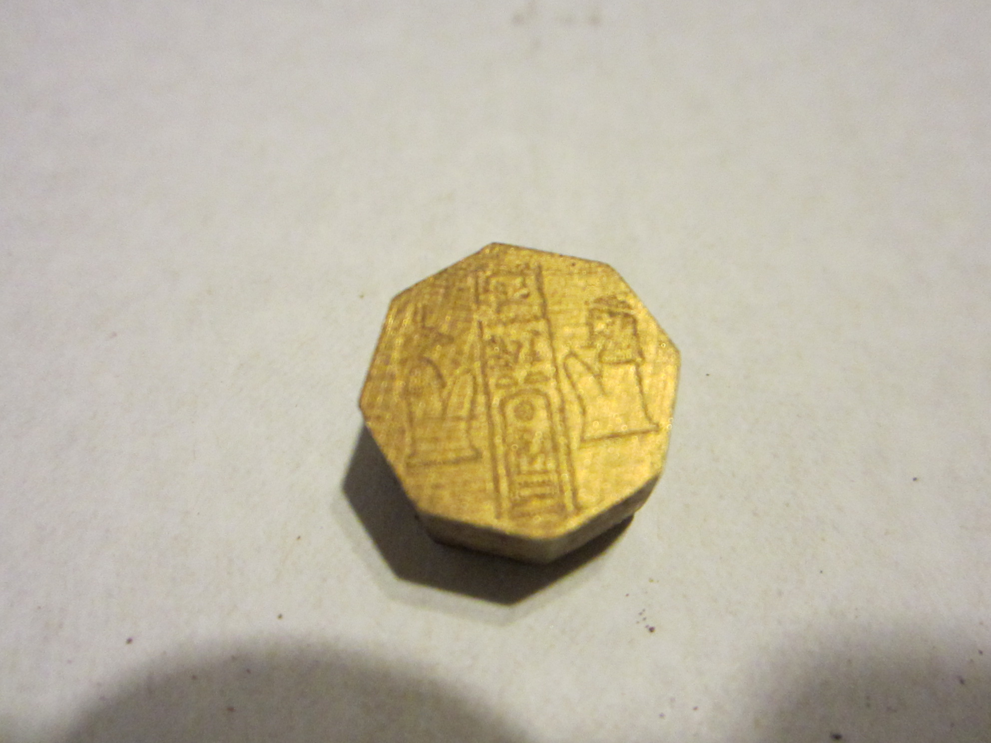

Here's my most recent key. Sorry for the blurry video, I had to get real close to this because of the size.
I lightly sanded the sides with 1500 grit sandpaper and used Rub-N-Buff.
I'm happy with the result.

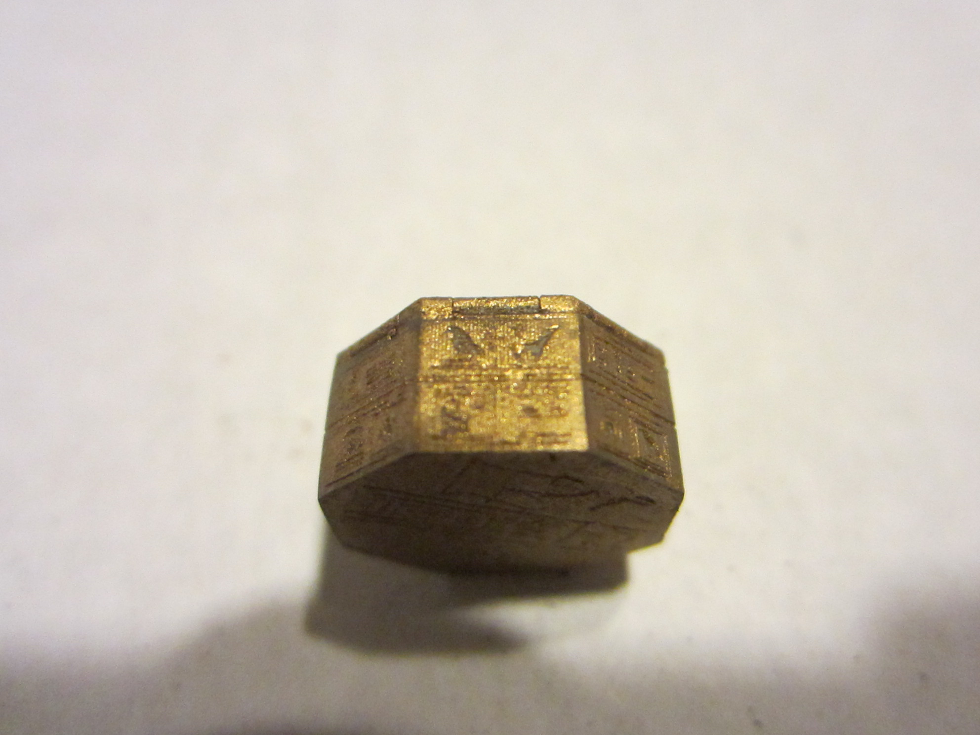

This is the high def acrylic from Shapeways. The base and the flaps. The flaps now WORK. :)
The high def steel from imaterialise hasn't arrived yet, and only the base will be steel. I ordered an extra set of acrylic flaps for the steel base.

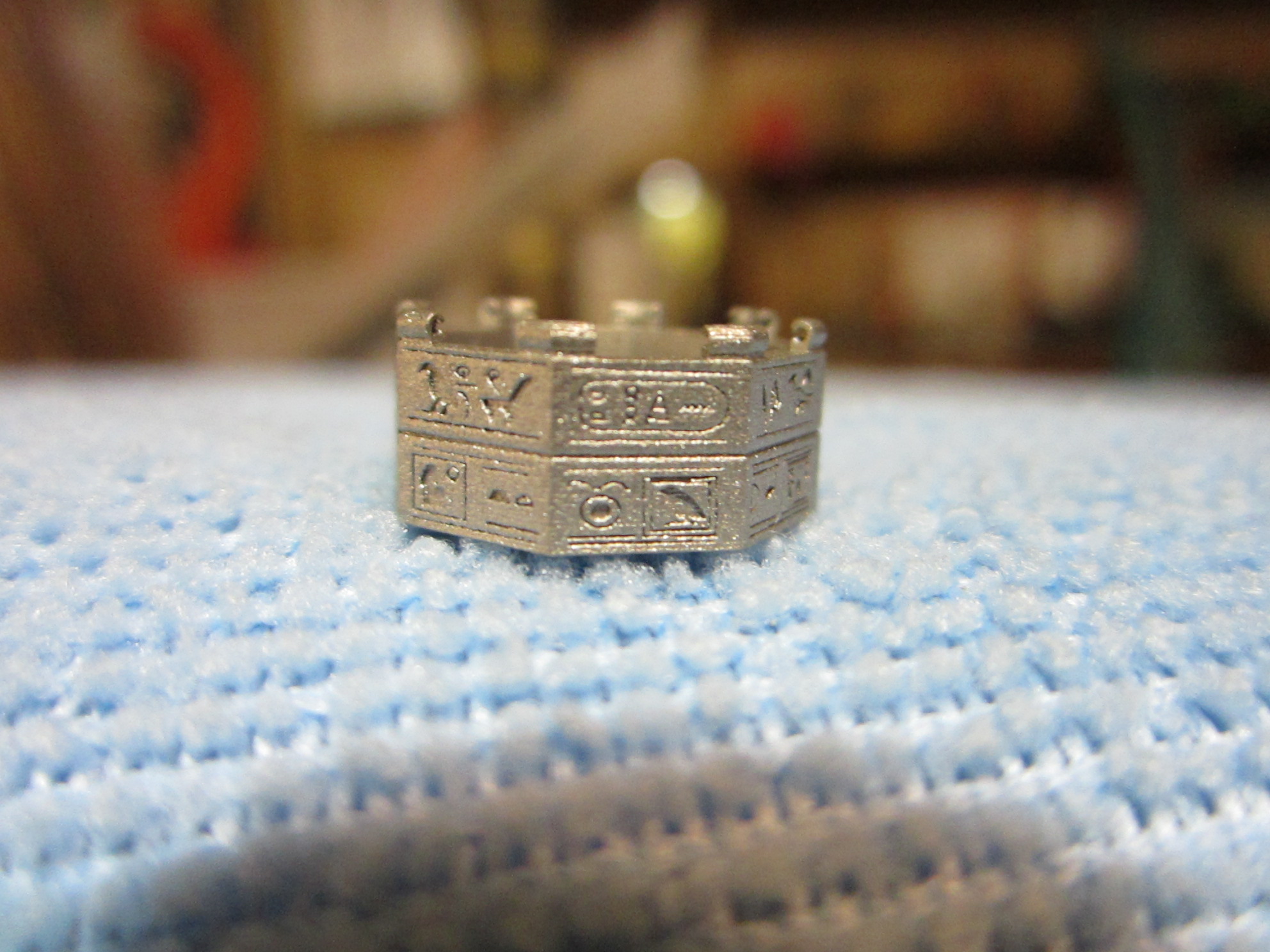

This is the iMaterialise High Def Steel 1/6th scale. Surprisingly good quality. These are raw pictures, not even any sanding. I just wish they would have let me do the flaps in High Def Steel also.
